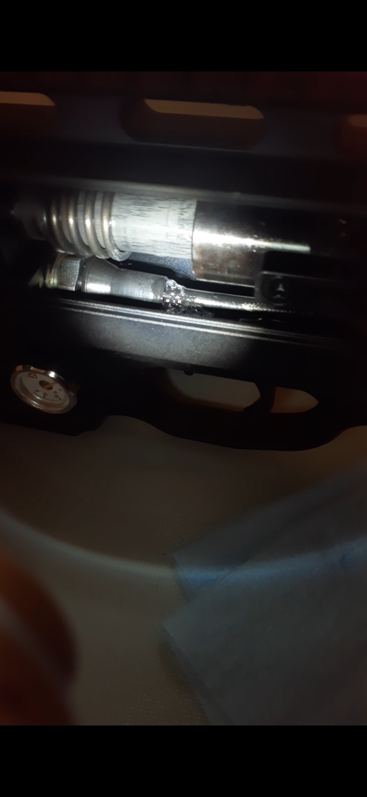

Here's a pic
Reactions: Ezana4CE

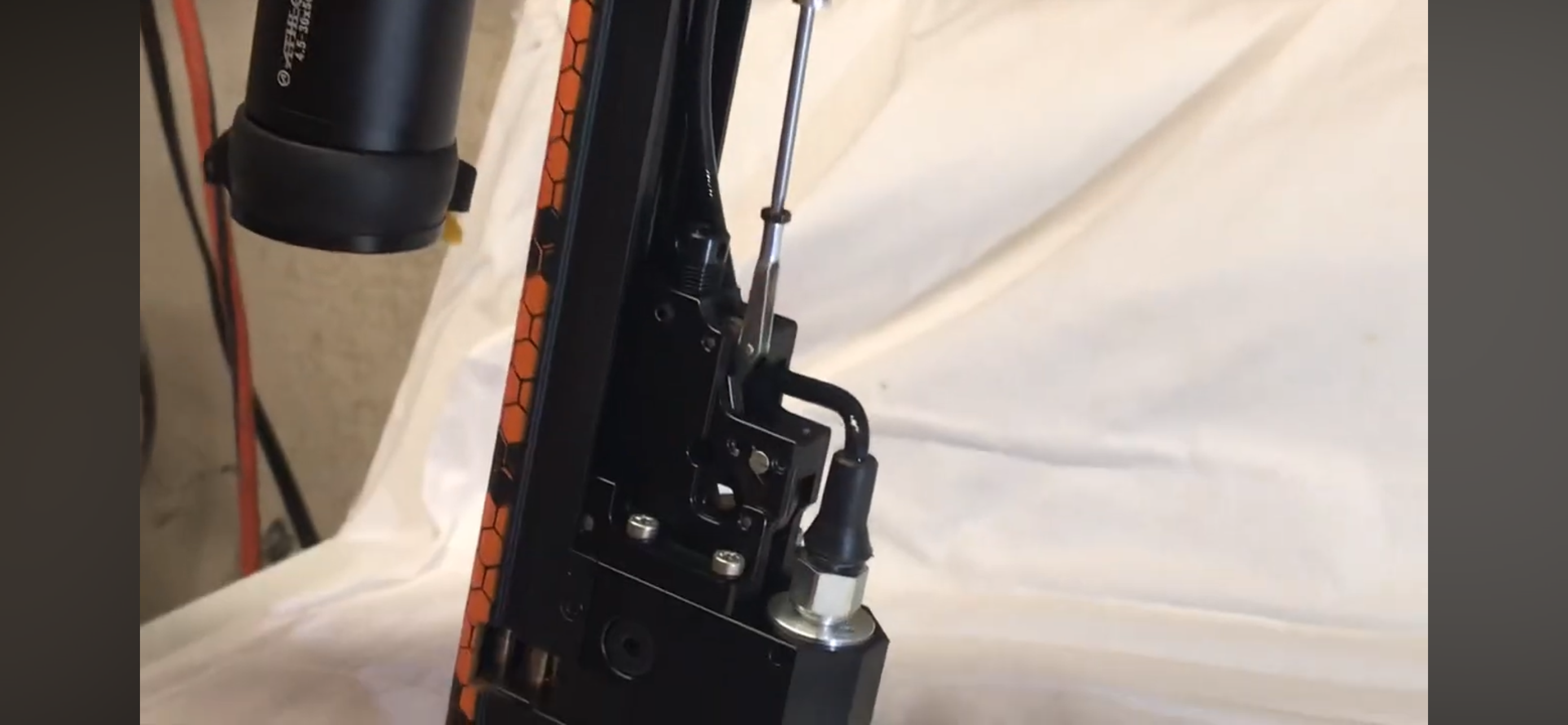

I have an Uragan 1 with the hose. I would degas the gun & see if I could just tighten the connections a hair more & see if that stopped the leak. If that doesn't help then there is a spare hose that was included with the gun with an attached shut off valve. This hose can replace the original & is rated for 630 Bar. Mine states it was made in Italy.
I read about the extra hose in a previous thread when I did a search. The air is leaking at the end that connects to the "bottle side", opposite end of the hose shown in post by bchannell above. My research shows that I may have to remove the barrel to access the connection. What I need is some uninterrupted time to try and work on this. I don't want to mess this up.
Reactions: Chasdog
Update: got a chance to tear into this and found there may be other issues regarding the leak. Where I thought the air was leaking from the hose, I just tried to locate the source of the leak and now hear air coming out of the barrel. Not sure if the hose is really the problem. Need to determine what the cause of air coming out of the barrel is before proceeding.
