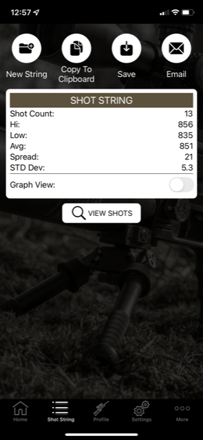

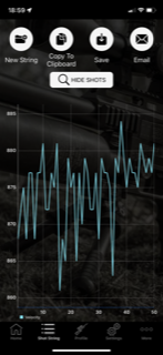

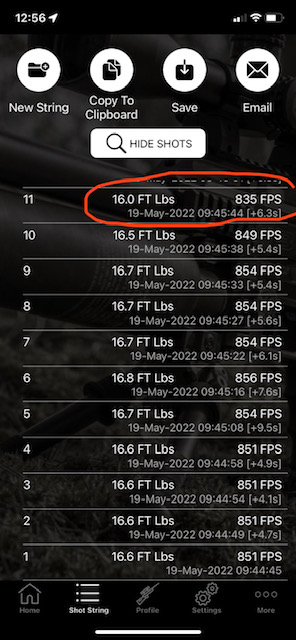

I wanted to see if the regulator was settling in with the shot string of a magazine, it was ups and downs see screenshot, labeled accordingly.

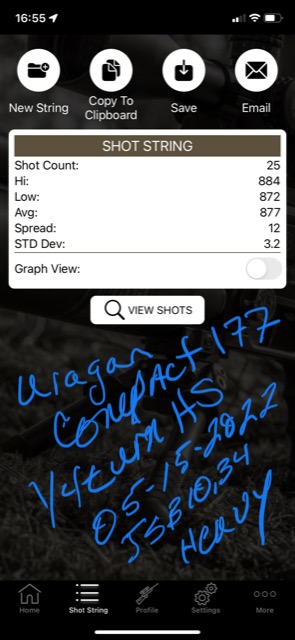

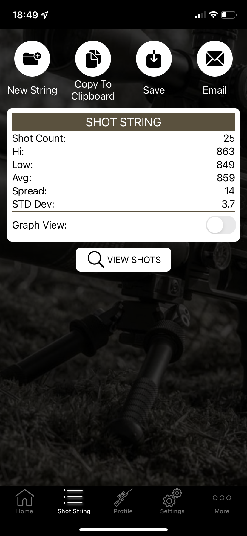

Then I thought, "Let's do a 1/4 increase and see what we get (me, myself and I) FPE and things tightened WAY up in the STD range. I started with 10 shots was like "hhhhmmm" then ran a full magazine and things got even better after another 15 shots.
Okay, I am no expert at tuning a gun by any means. However, my understanding is that the harmonically tuned your hammer spring and regulator are, the tighter your shot string. Is this correct or is my Cheeto high messing with my brain logic?
Could have my Uragan come with the regulator and hammer spring a bit out of wack, and now that I tightened hammer spring up things are where they should be, harmonically speaking?

    Update:

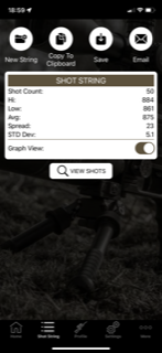

    Curiosity got the better of me so I am decided to do a 50 shot string and things opened up. However, the base seems to be in a 875 FPS at around 17.5 FPE. I will be interested to see how it performs on groups later in the week when I get a chance to try a 25 and 50 yarder.
    Here is the 50 shot string using the FX Pocket Chrony:
    If you were able to raise your FPS basically 80fps yeah the HS was definitely out of sync. Ideally you want to find the max speed then back it down 3-5% off your max speed. That's where you'll usually get the best strings.
    Also @TMH you might need to back off the HS even more to see what your looking for. Having basically the same gun as that you'll need to back out the HS essentially out the back of the plate.

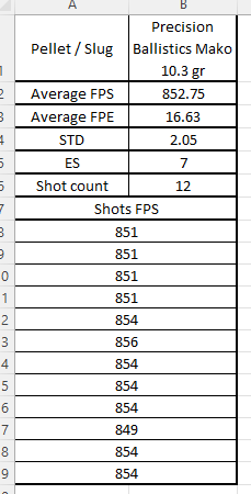

    So I decided to do another shot string with the Precision Ballistics 10.3 gr Mako Slugs. I have a limited number and so I only did one magazine: 15 loaded, one got FBARed, 1 not read and I would up with this with the lowest removed the buggered up the whole data string. However, I will post the original numbers for transparency sake, screenshots.
    Lastly, with the type of consistency and if Shadow can shoot slugs (maybe maybe not and I have 4 types to try (2 look #s wise promising) without having to adjust anything to screw up the pellet "setting" then I will try for dual purpose depending on conditions.
    Now for the data:
