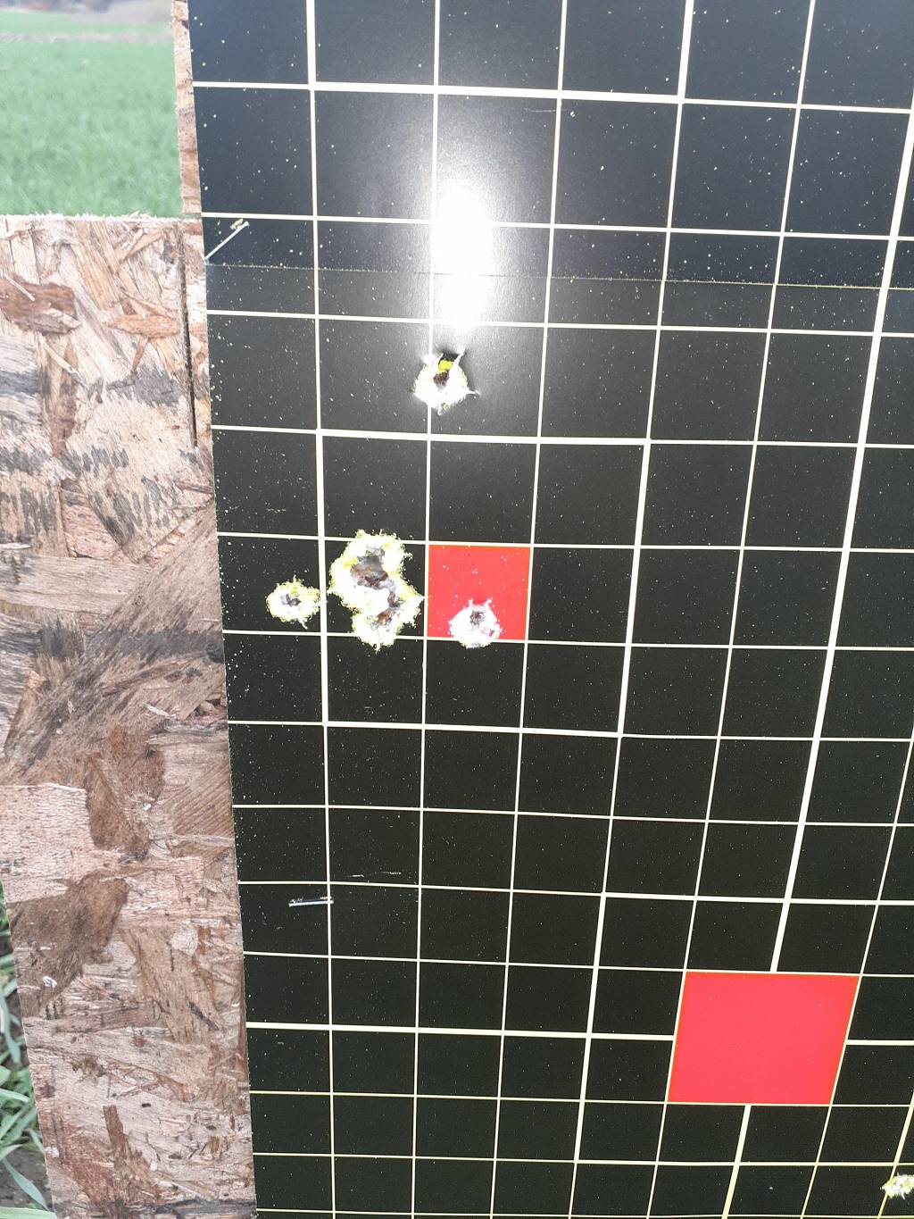

So!!!! Yesterday I go mount a swfa SS scope and sight it in for 0 @ 50 yards. This thing shot ALL OVER THE PLACE. I'm talking like sometime 4-8 inches sometimes in any direction. The only way I could get a tight group is if I rapid shot it and I would get like a 2inch groups. Ummm friken HORRIBLE!!! And then if I put a fx hybrid slug threw it ,the shot would literally drop hitting dirt 15feet infront of the target. This is no exaggeration.

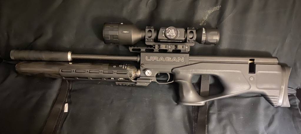

I believe from what the guy said is that tje shroud was removed and carbon fiber er sleve was installed as pictured. This is the gun. Not the scope that's is on it. It's a swfa ss. This was a photo from to guy a purchased from

Like the others have already said, when you take off the shroud and use carbon fiber sleeves, sometimes they don’t center properly causing clipping, while tension on the barrel can cause crazy inaccuracy, too. Take it off and just shoot the air gun with no shroud or moderator. You’ll know instantly if that was the issue. Then you can decide what shroud or carbon tube/moderator you want to use.

So when i got home i took of the moderator and opened it up. Pellet were hitting the inside of the moderator. So i then went outside ,minded a taget @ 50 yard and waalaaah ... shot group was tight. I then looked at the carbon fiber sleeve and it apears it was not cut perfectly. I cleaned out the moderator and tomorrow im going to fire it with just the moderator on it. If it groups nice i will bring the carbon sleeve and riflebto work and put it in the lathe and cut it properly. It also seems that the sleeve gets tensioned before the moderator is screwed all the way down.

So I ended up taking off the moderator and carbon fiber sleeve and it shot with a decent group. So then I discovered in fact the pellets were smacking the inside of the moderator. So I then screwed on the moderator and measured from the body to the moderator. Then I measured the carbon fiber sleeve. The carbon fiber sleeve was a out 3/16th to long. So when u tightened down the moderator it would twist it as it was not able to fully thread on. I cut down the carbon sleeve on my lathe.I Reassembled and I got a pretty good 9 shot group.
