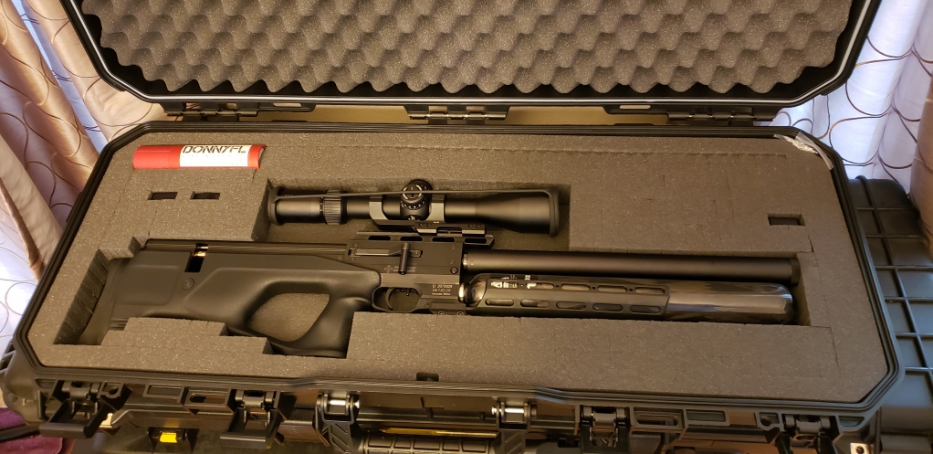

I received this Air Gun Technology (AGT) Uragan .30 from Charlie Frear of Georgia Airguns the first week of April this year. Here is how it was received, less the scope mount and scope.
3 magazines, a Donny Sumo moderator and a box of goodies, fill port, fill hose, etc. Pretty much everything you need to get started. Charlie includes a Plano, made in the USA foam lined case which protects the gun quite nicely. So lets talk about this gun and how I became it's new owner.

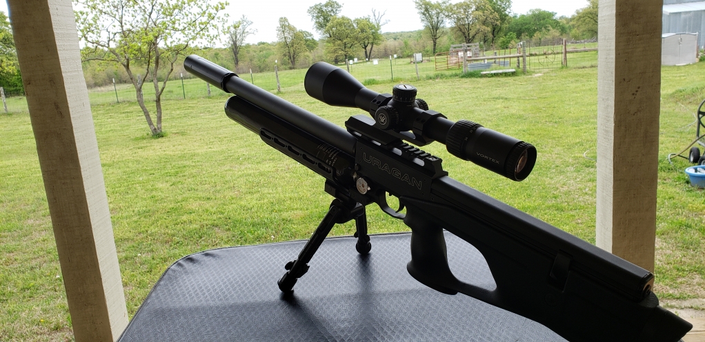

The Stock is a very tactical feeling polymer composite material, very nice to the touch and secure. The stock also is very ergonomic in how it can be picked up, carried and brought to a shooting position very quickly without it feeling awkward like it might slip out of your hands. I like carry points on a gun that I can get my hand around or into. The thumb hole brace material that runs from the bottom of the pistol grip to the stock, is the perfect size to get my whole hand around to carry or move the gun. I just like that!
Cheek weld!
If you have ever had a Vulcan like mine, the top of the cheek weld was metal, probably aluminum? Not sure, but it was metal, it was cold, it works. The Uragan has the same type of cheek weld but it is not metal, it seems to be a polymer type material and is very comfortable but yet is secure and feels solid. Nice going Evgeny, very nice touch. Sometimes it’s the little things that matter.
Picatinny rails top and bottom.
That’s the way to do it in my opinion. If you want some capabilities to add any accessory, it’s a great feature when the manufacture builds in attach points whether it be Picatinny or Mlok or some other widely used interface. The pic rail on the bottom is perfect for a bipod in my application. A light could be added for night time hunting as well. Nice touch on the pic rails!

We all know that there is a need on occasion to add a moderator. In this case the M14x1.25 threads are ready. The gun comes with a screw on and off thread protector that is well made and knurled perfectly for hand tightening and removal. I have a DonnyFL Sumo moderator on my .30 cal and it is truly a very effective addition. I also think the addition of the moderator has a positive impact on the natural harmonic of the gun at this particular tune. It seems to be much more settled in its post trigger pull movement than without. With that said, I can’t say it’s not less accurate without the moderator in some situations.
