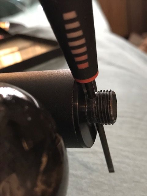

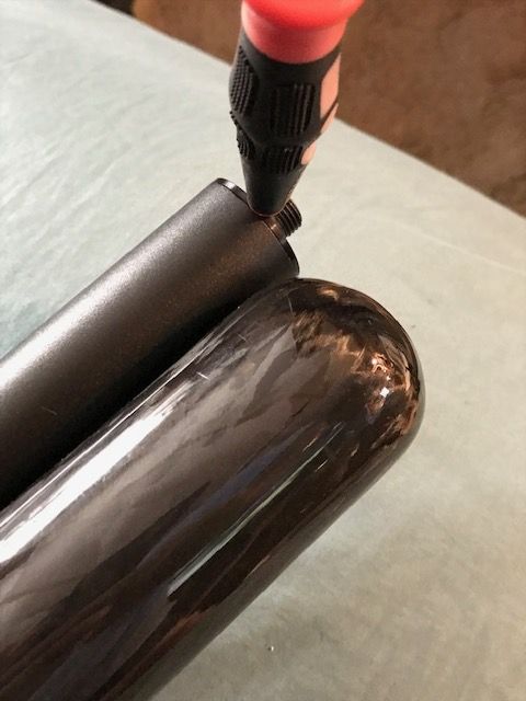

My 30 cal Uragan is pellet clipping. I removed the section that has the baffles in it. How do i get that section apart to address each individual baffle? Pearl
Hi I had same problem so i reamed hole section? but i have no idea how to take it apart?? I can say nsa slugs did not clip and mine hates jsb 44 gr good luck? paper p
take the end nut off and insert a small screw driver or an allen wrench in the hole through the end of the shroud, turn counter clockwise while holding the shroud firmly.
