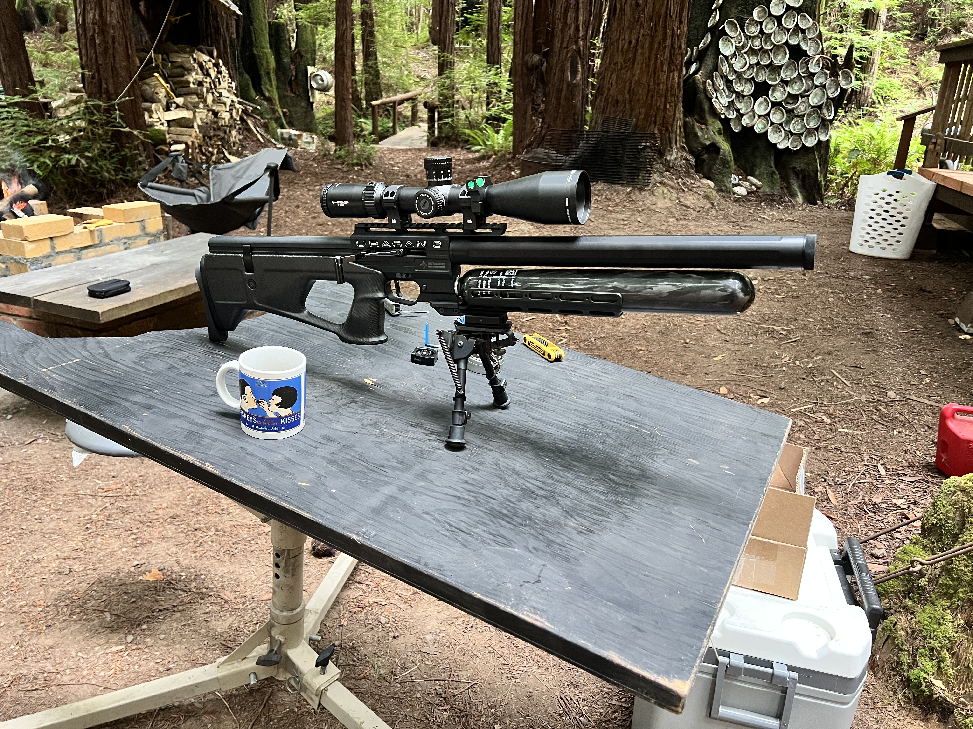

Got a new rifle and it came to me doing 1029 fps, ~24.5fpe. I got it to hopefully shoot silhouettes and HFT so it needs to be >20fpe. I probably should have gotten a different gun but here we are. I’ve been reading a bit on tuning this type of rifle and have had some input on where to start with it by some helpful members. My initial testing has shown JSB exact 10.34 are really accurate and stable at 46yds. 10 shot groups at that distance were a touch over moa, using my fist as a rear bag, forgot my sandbag….
I started tuning today. My plan was to start by cranking the HS out 3 turns and the fps dropped a whole 7 fps on average. Next I pulled the valve and did 1/8 turn in, regassed to 250b and took another 1/2 turn out of the hammer spring, fps dropped down to 906fps. After a 10 shot string I had an es of 15. I put a 1/2 turn back in on the HS and the velocity shot up to the 940’s. I decided to get back into the valve and lower the setting a little more, though I started to turn the valve OUT (ccw) by accident then turned it in another 1/8 turn. After putting it all back together my fps went up to the high 960’s, I didn’t bother shooting more than a few shots and had to put it away for another day.
My initial impression is that I can get to >20fpe, with a stable enough shot string, es and sd, hopefully with no more than a little fiddling with the valve and HS. I was shooting at 12 yards and everything was going in the same hole but that’s really no indication of accuracy ime.
My plan is to get the speed down some more with the valve and then tune the HS tension over the course of a few days, letting the rifle sit between adjustments.
I have zero experience with a balanced valve and only slightly more with a Mrod from about a decade ago, I’m green to say the least. Any input is appreciated!

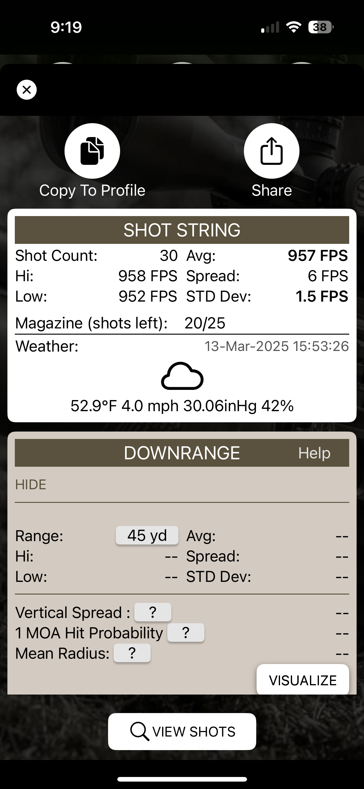

This is what the U3 is capable of in terms of ES/SD:
Not sure whether you can get that right with a very low reg setting but you should be able to get somewhat close. For that to happen you have to accept how a balanced valve works though, which means you can’t use the hammer to fine tune the speed. You want the valve to open fully every single time, everything else is not going to be this stable. To find the right hammer setting doing this for a given reg pressure, turn the adjuster out until it doesn’t open. You’ll hear it and note a significant drop in fps once that happens. Then turn the hammer adjuster back in a 1/4 turn at a time. Once speed doesn’t increase anymore you’re there, maybe give it another 1/8-1/4 turn beyond that point to be safe. That’s it. FPS are 100% controlled by reg pressure.
