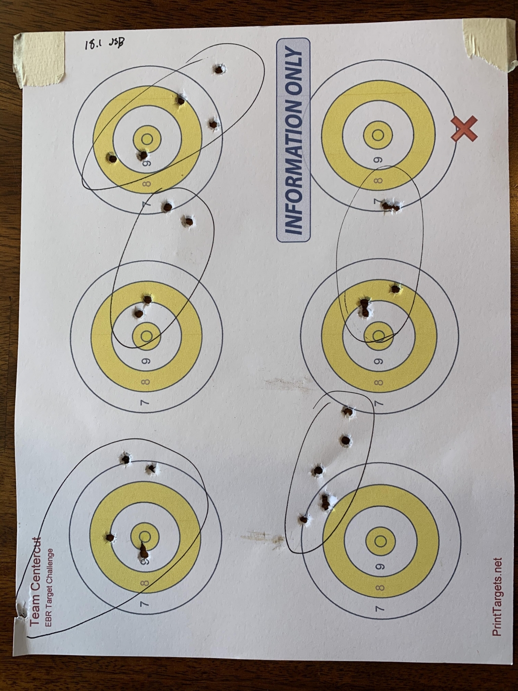

  • 18.1gr - I like how inexpensive it is to shoot these pellets after coming from .30 pellets. They can group well at 50 and usually stay around 1MOA, but are more susceptible to the wind than I was used to with the .30. That is taking some getting used to, but I enjoy that it will also make me a better shooter. At 50, it can keep the pellets touching, but as the wind moves around, so do the groups. I didn't really group with them today at 50, only set up my new scope, so I could try out the other ammo and longer distances.
    • So how did I do today at 100yards with 5-6mph wind? Not that great. The groups were around 2-2.5MOA, but had a pretty sizeable vertical spread even with a tight tune with minimal spread and SD. Not that impressed, but I didn't expect to be with 18gr pellets. There was some potential, so I'll keep testing it out. I expected these to be the hardest to shoot well at 100.

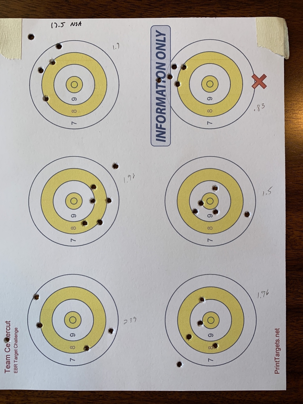

  • 17.5 NSA .2165 - I had heard these do well in the Uragan, so I picked up some from another fella on here to try out. My Uragan, with this tune, does not like these slugs. They had the smallest spread and tightest SD of everything today, shooting 925FPS, but they could not group at all. At 50 and 100 both, they were consistently 2MOA. At 50, most of them were not touching but stayed around 0.9-1", and then stayed right at 1.9" at 100 across most of the groups. That being said, they did have one of the best groups at 100 on the day of 0.83, but it was a fluke. they just didn't were not consistent.

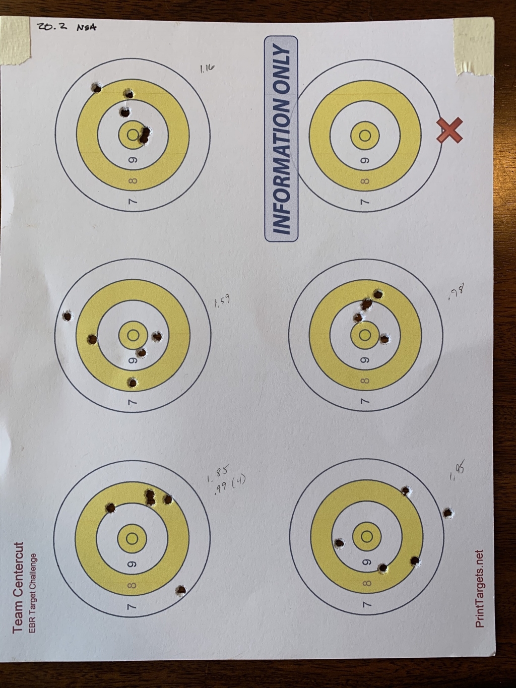

  • 20.2 NSA .217 - I like these A LOT!!!! It didn't matter if I was shooting at 50 yds or 100 yds, these babies really wanted to stay together. The spread and SD like all the ammo today was very nice, and it didn't change with these. They averaged 868 FPS. At 50yards these were a touch tighter than the 18 and 25 gr pellets and at 0.23", had the best 5 shot group at 50 on the day. Like the RD pellets, the groups stayed tight and barely seemed to move.
    • At 100 yards, with only 1 card, the measurements didn't jump off the page as amazing, because the last magazine blew up the average, but it was obvious that these have potential! I had the best group at 0.78" and until that final mag, they had the potential of being very close to 1MOA at 100 across the groups. I saved these for last after seeing how well they did at 50, and it was nice not have to look far to find the holes. The first group was 1.16" and it put a big smile on my face! The next group was 1.59" and I'm not sure what happened there. Then I came back with the small 0.78" group. Fourth group was sitting at 0.99" until the 5th shot took the group to 1.85. Where did that shot come from!!!! And then the final group was bad at 1.95" I should have paid more attention to which magazine I was using there at the end to test it out some more.

Here are few pics of the 100yd groups. These were shot for groups, not for score, as I was testing out what the ammo would do for the first time. I put the reticle on the center and pulled the trigger. I didn't take any sighters, and just pulled ammo straight from the can/bag, good or bad. I did adjust the scope shooting the 17.5gr after the 2nd group and after the 3rd group, but didn't make any other adjustments on the other cards. I forgot to take a new pic of the gun, so I'll attach an older pic with the previous scope. Need to get a new pic of her.
