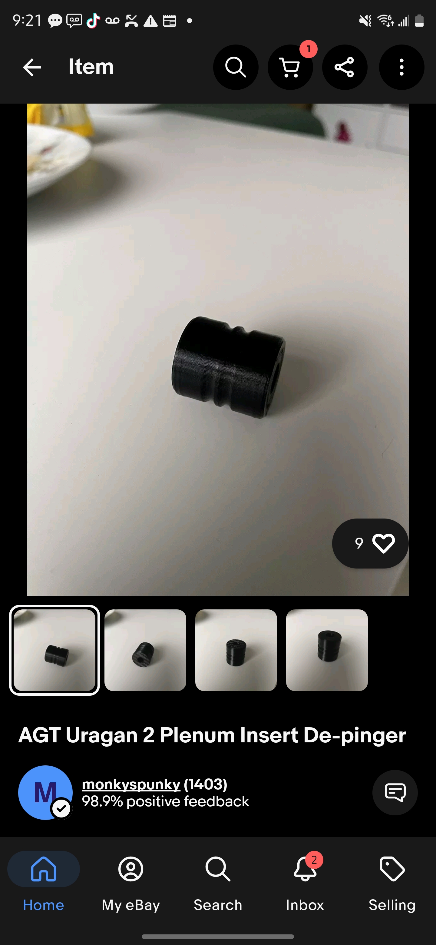

I finally took my gun apart and the plenum was missing the depinger 🙃 fortunately the depinger arrived today so ping begone!
