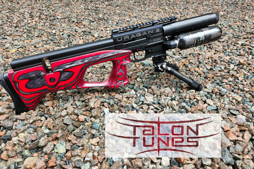

Is this what you are after? Perhaps there is a readymade solution. Contact Talon Tunes:
If you take off 6" of barrel you will have 78% of the original length. You will likely have 90%+ of the original power because the valve closes well before the pellet travels to the muzzle. You could even get the power back, at the expense of air use and a louder sound. Or lose a little power while still keeping it quiet.

The one in the picture has 2 shorter tanks. What I'm looking for is more along the lines of 600mm version but with a slightly shorter barrel. 90% power is still more than enough considering it puts out 70-75 fpe right now.

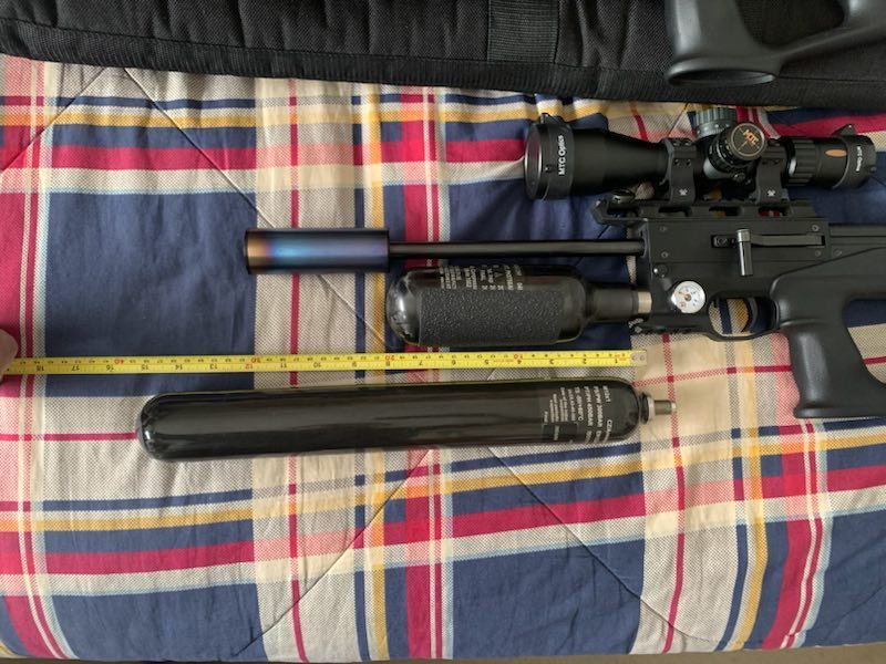

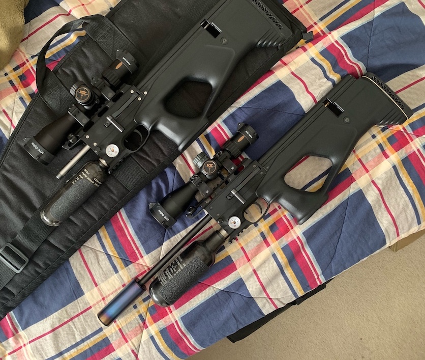

My 25s.
Top Uragan compact has a 25 LW stainless barrel. A bunch of machine work to make this happen.
Bottom Uragan had its barrel shortened about 3 inches, 300cc FX bottle with adaptor, 1/2x20 direct thread moderator. Adjusted the reg and hammer spring to shoot 26gr slugs at 880fps. Removing the factory shroud and baffles it can be shortened quite a bit.

Who did you have do the work for you?
Bullysyclone(on AGN) is a machinist and did all the work. He made the titanium bottle adaptor. The can is also his product but are now made with carbon fiber.

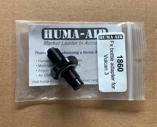

A more economical route would be getting a 300cc cf bottle w/valve and the Huma bottle adaptor. And have someone shorten and machine threads on your barrel.
