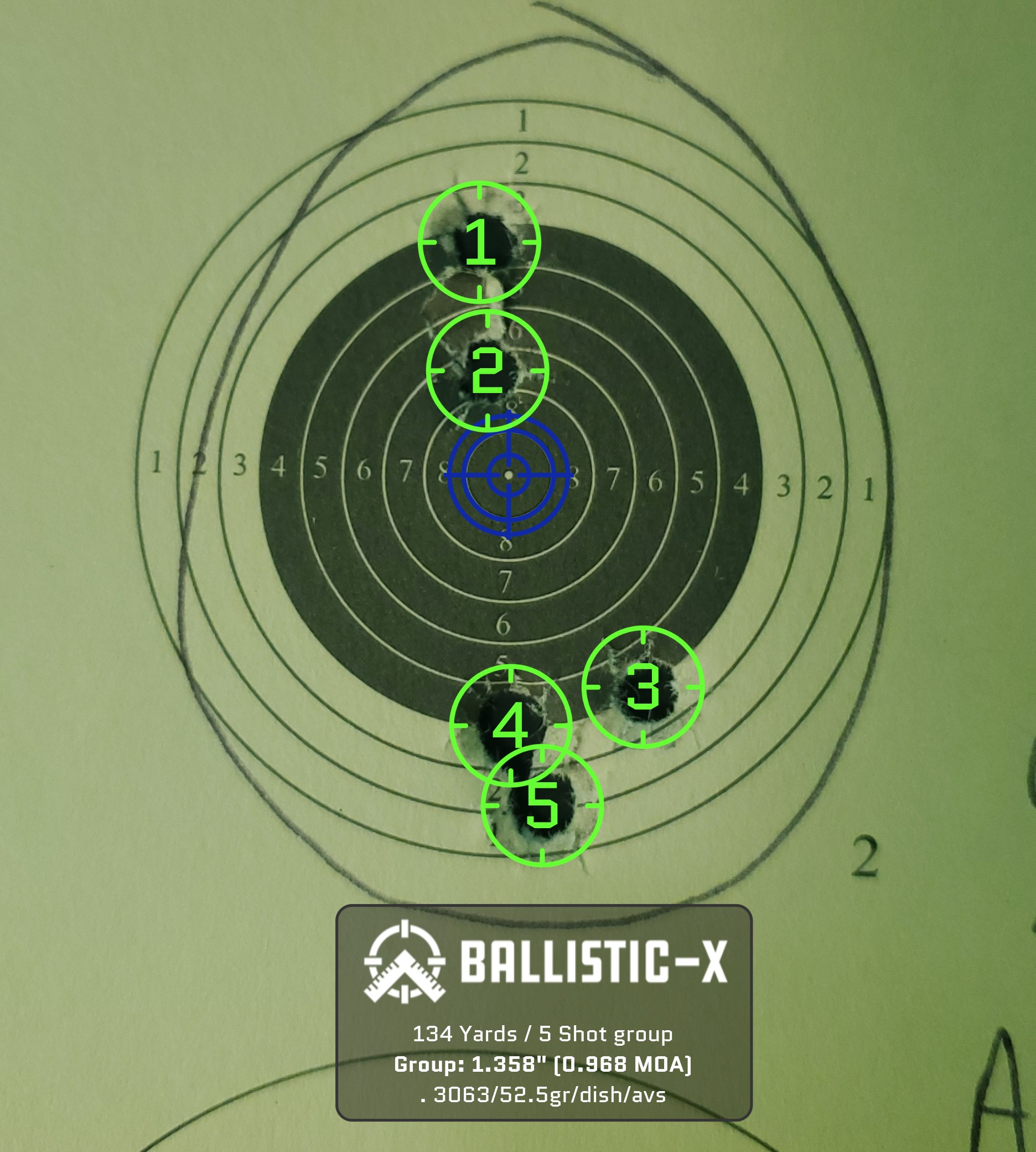

I got all my ammo in and did some testing today. I'm only posting the slugs that are the best in my setup. I placed another order for more slugs so about to do some more testing. I will be shooting 5 shot groups in the second test. I will start labeling the groups also so you know which is which. I will try to get back out in the next day or 2. Hopefully someone finds this helpful.
Speeds using FX pocket chronograph "FPS" using AVS brand slugs.

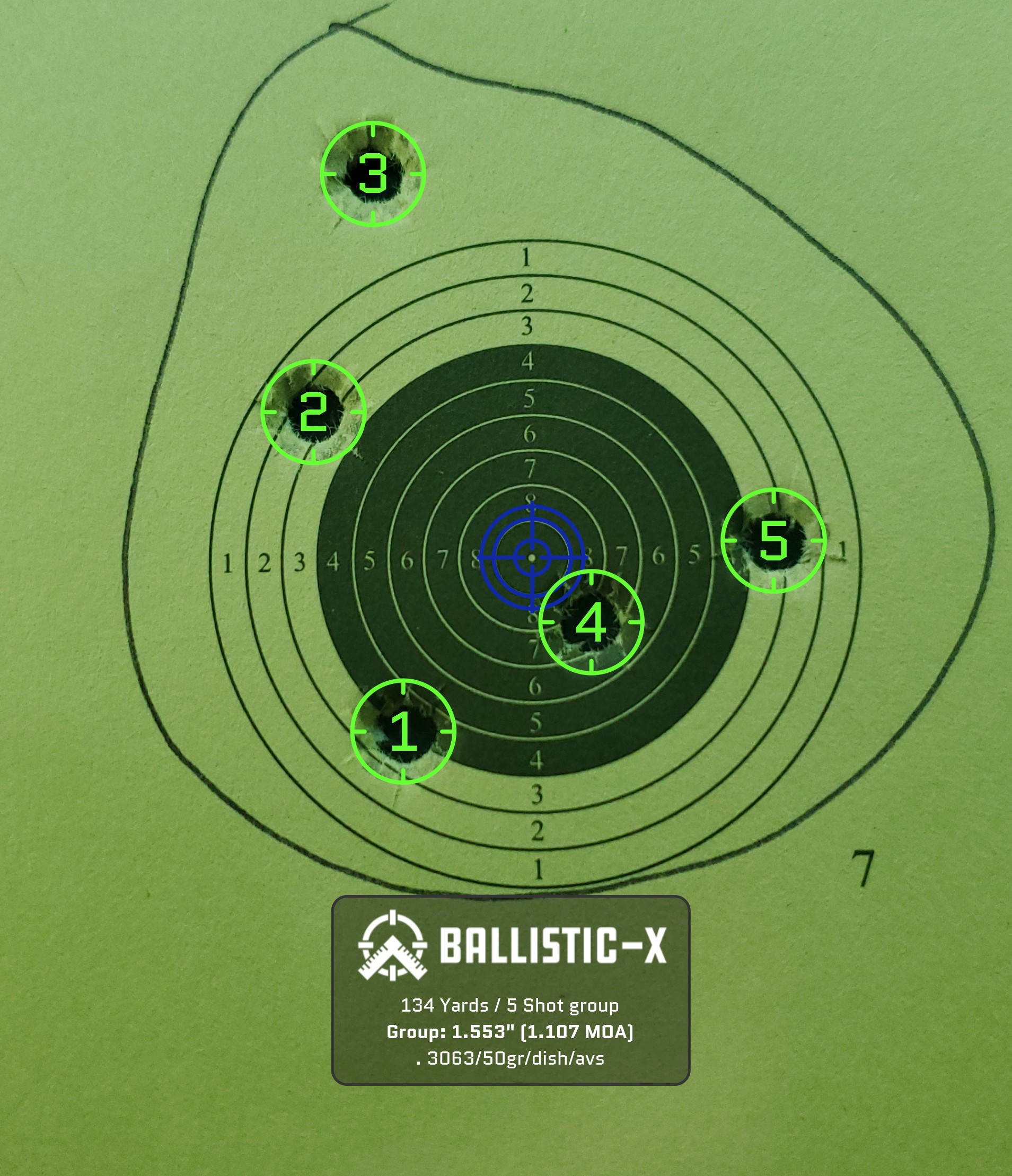

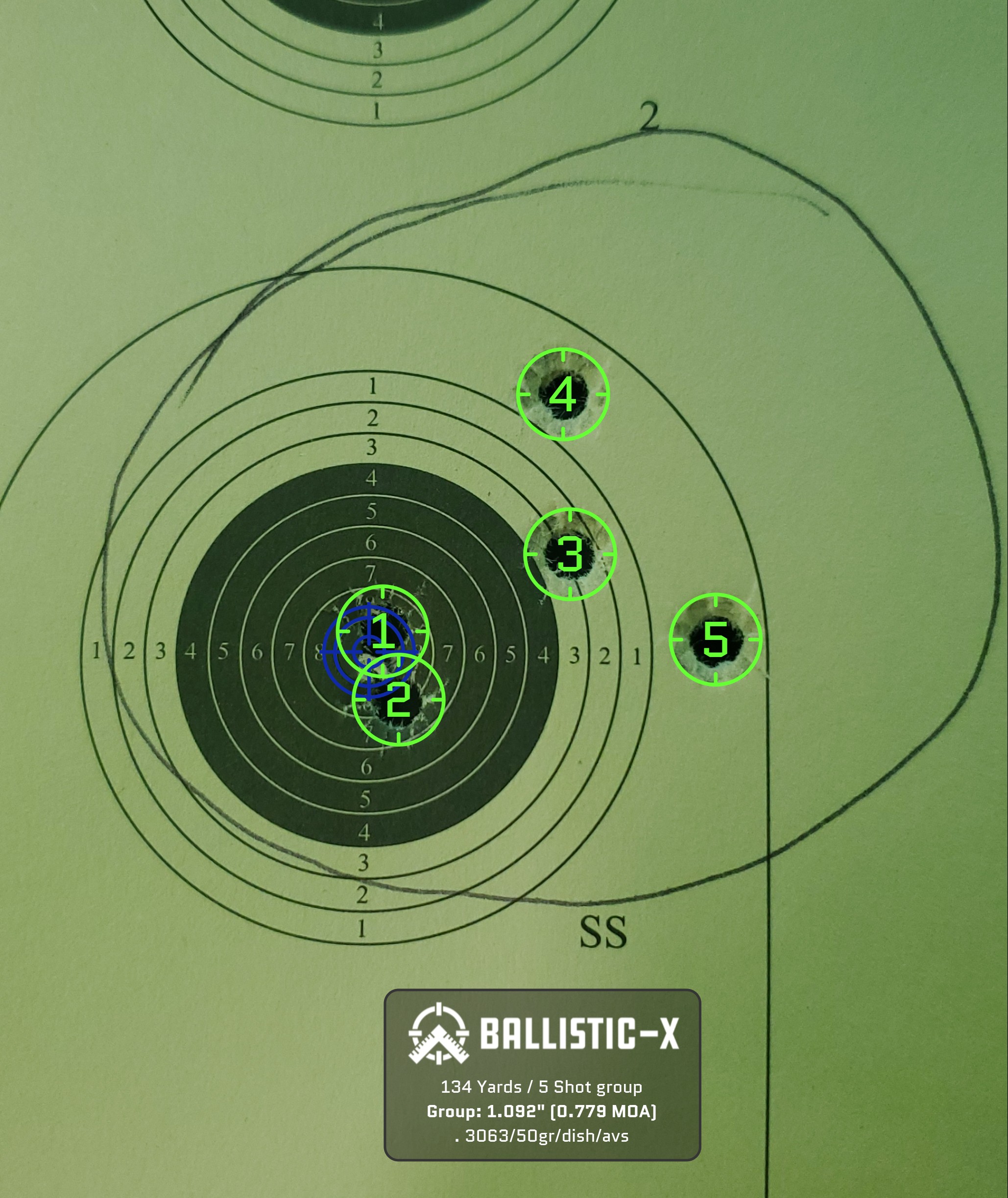

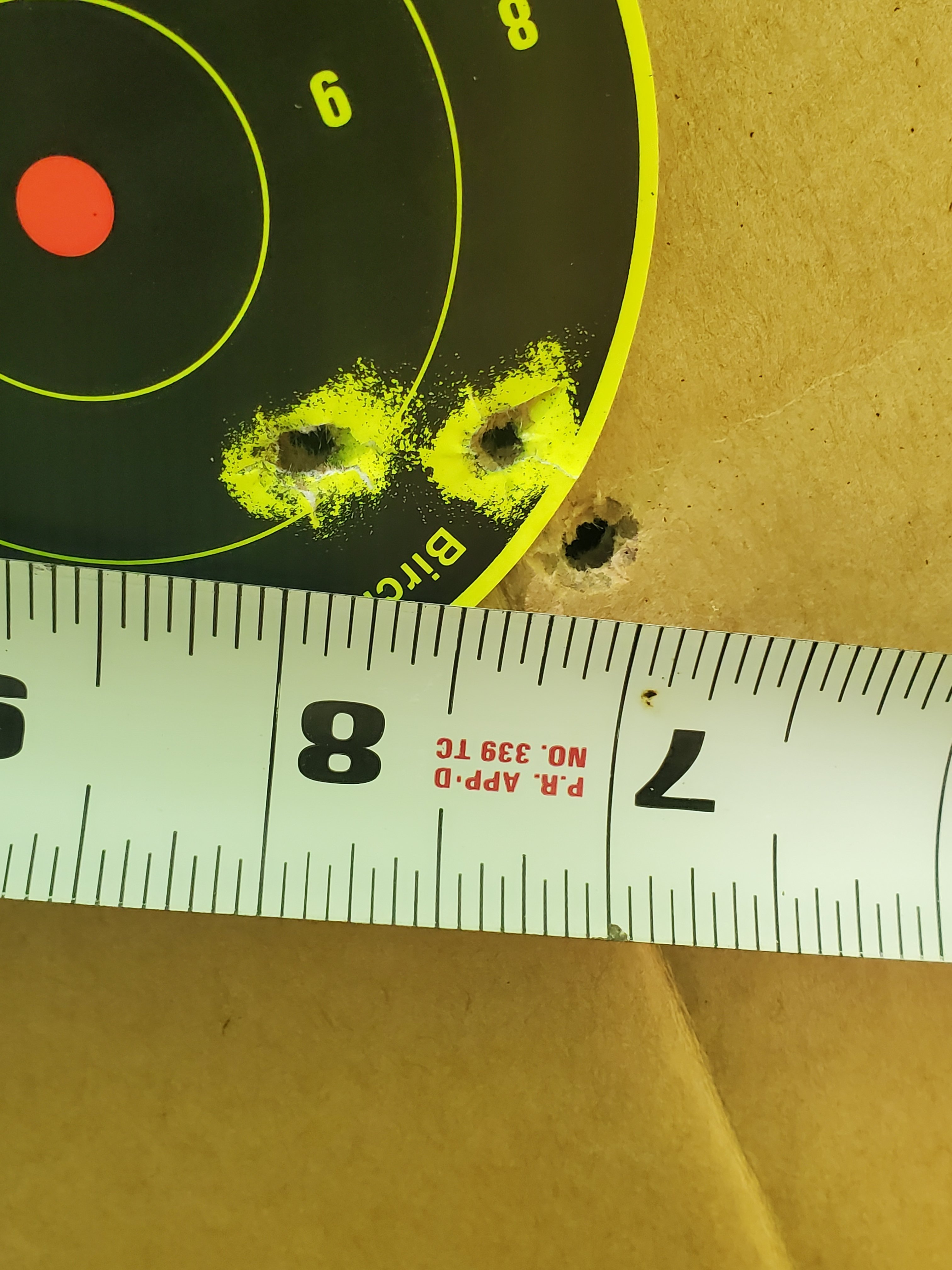

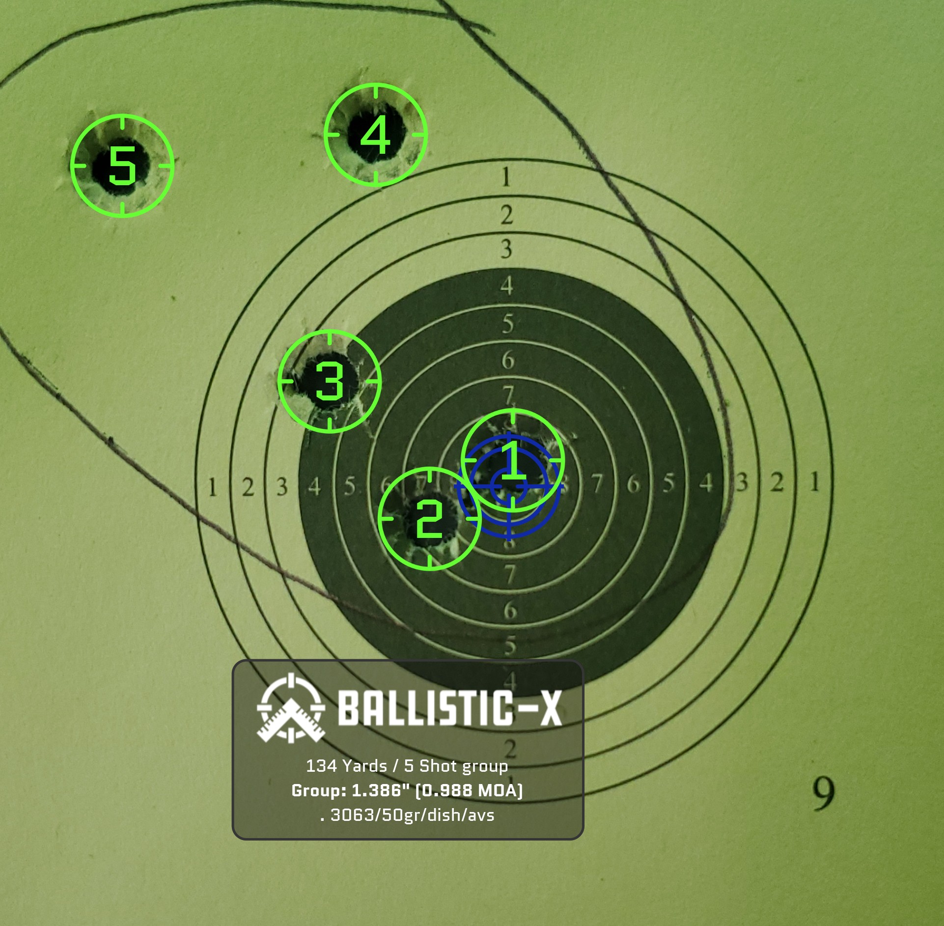

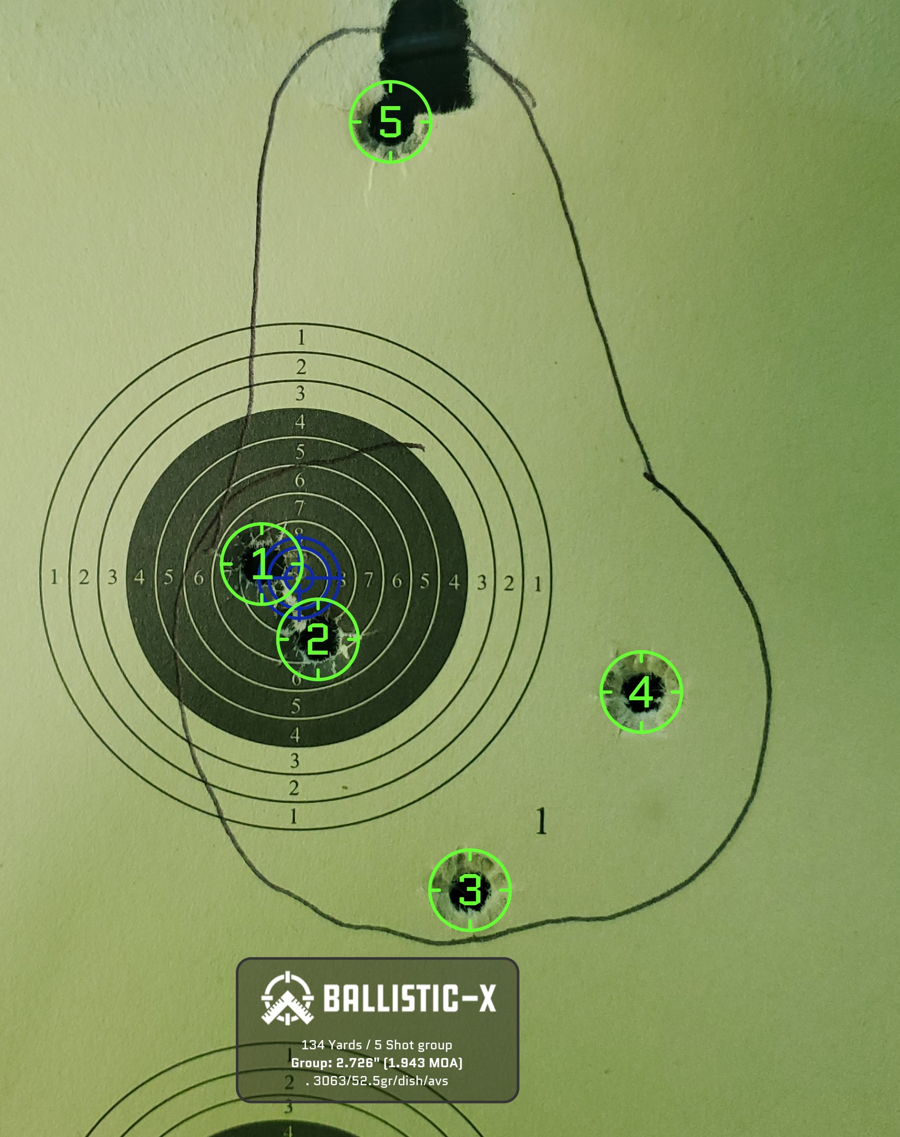

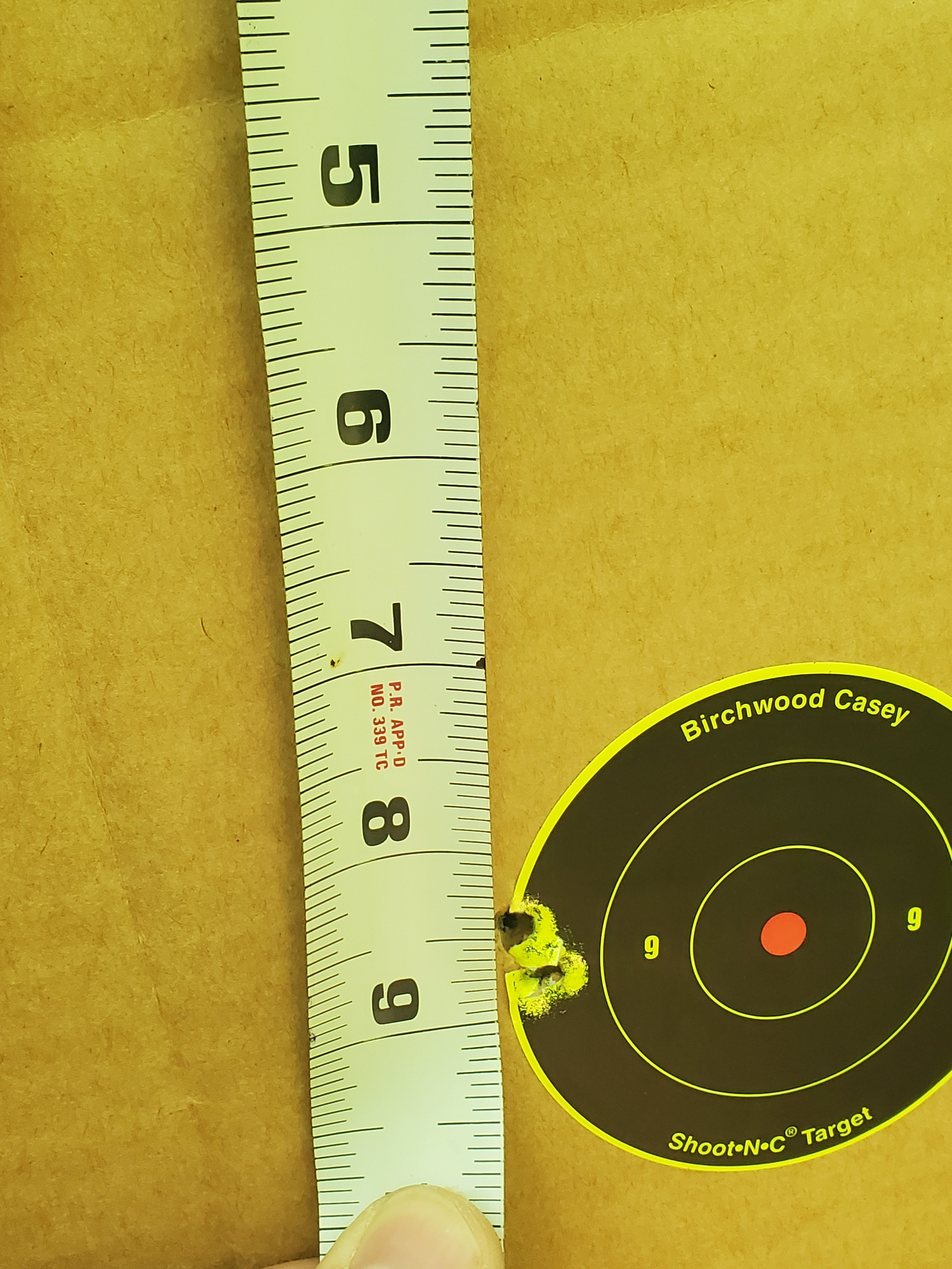

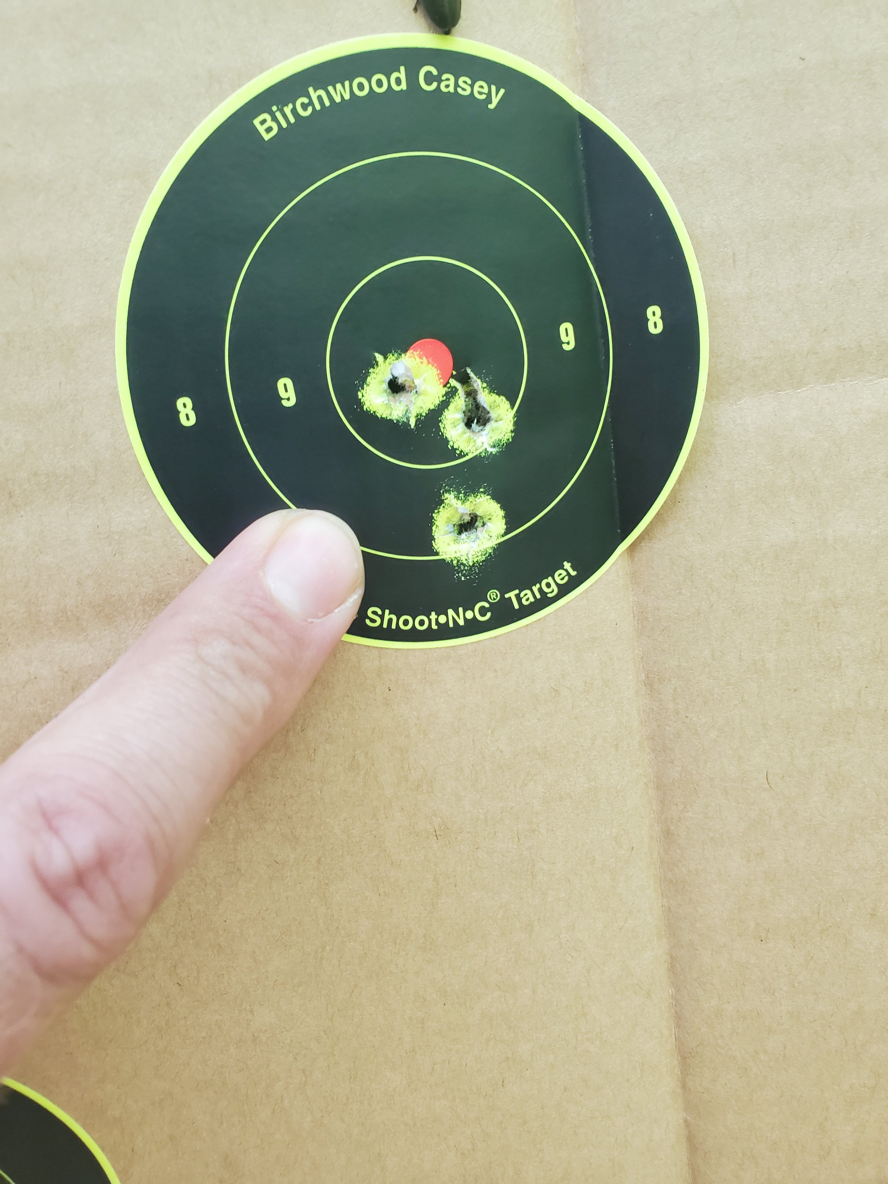

All the .3063 slugs I tested did well. My gun came shooting 50 grain jsb mid 900s so I purchased 50 & 52.5 grain dish and 55 & 62.5 grain flat base slugs from avs slugs. I am sticking with the 50 & 52.5 for now but wouldn't hesitate to run heavier slugs either. These are some groups at 134 yards. Slight breeze but in the woods it's mild.
i will post some more when i get back out to shoot. Hope this helps someone with getting the right ammo to begin with. Ill say anything dish base in 0.3063 will probably shoot well. The flat base didnt do bad either. The pellets didnt do as well in my test.
