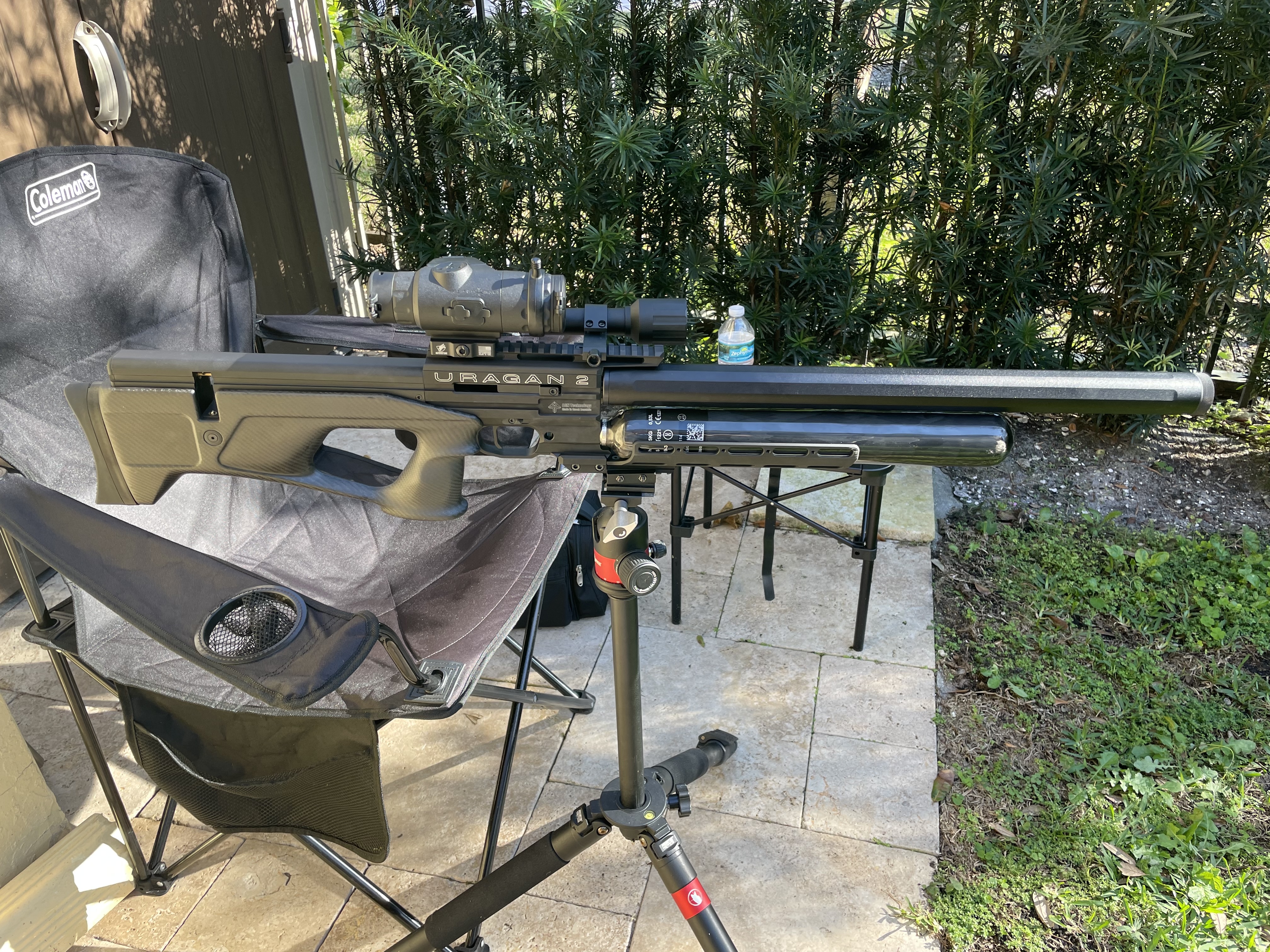

I just got it today. Exactly like you have said. Very well packaged. Actually I kept the packaging.
He tuned this down for me to shoot .22 18.51 grain Barracuda Hunter Extremes at 920 fps. So around 34 fps. For that he had to install some custom pressure restrictor (?). So far it is accurate at 20 yards. Same as the M3.
The rifle is louder than I was hoping for at this power level. I can shoot it but the quieter the better. I also do have the ping. Not horrible but I will have my local shop install the kit assuming I can quiet this rifle down. Because if not, it doesn't matter. I have a hugget snipe 1.2x20 UNF but I will need an adapter it seams.
Rifle looks great and for its size not all that heavy. Subjective, but probably my best looking rifle so far.
