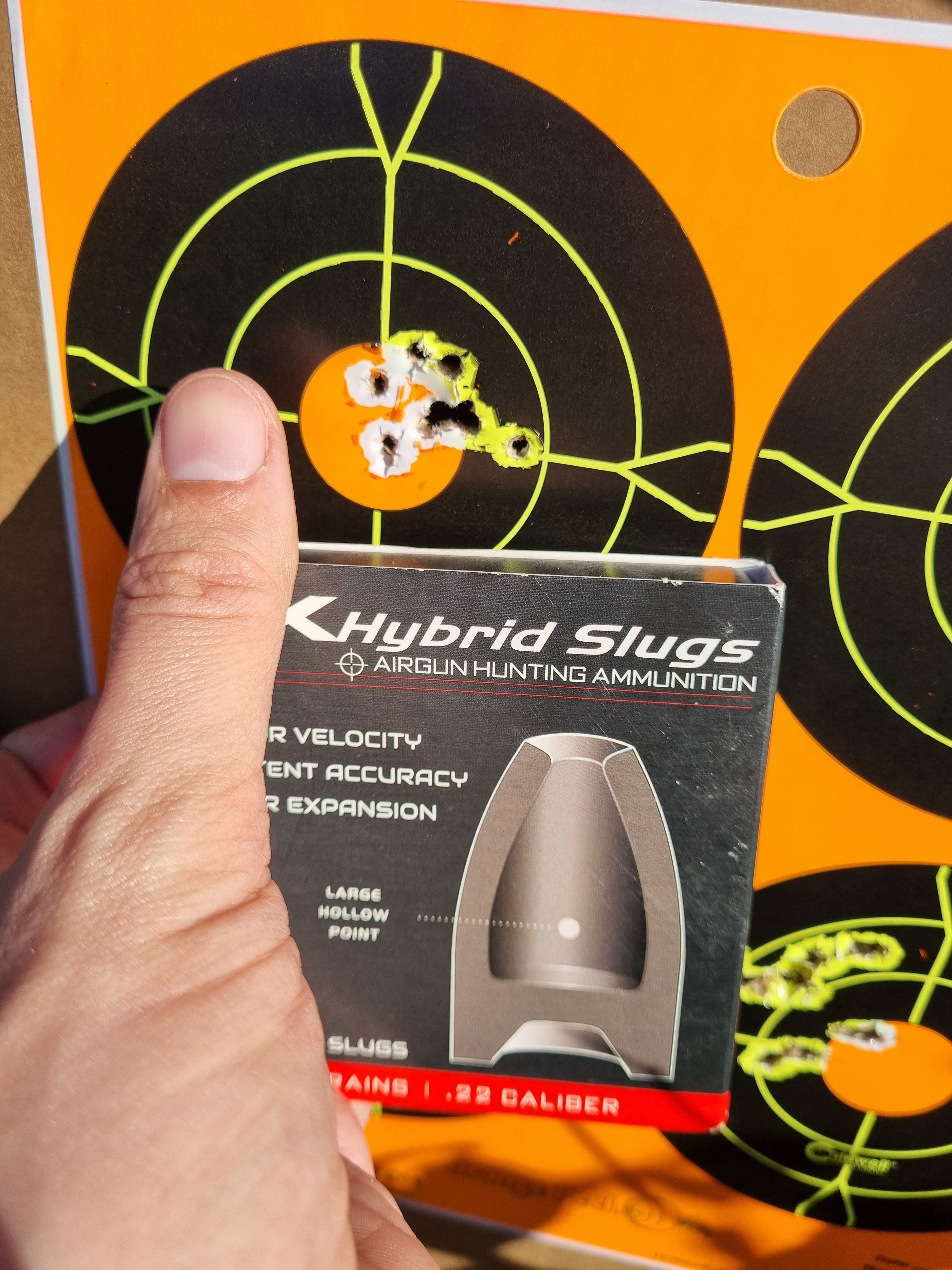

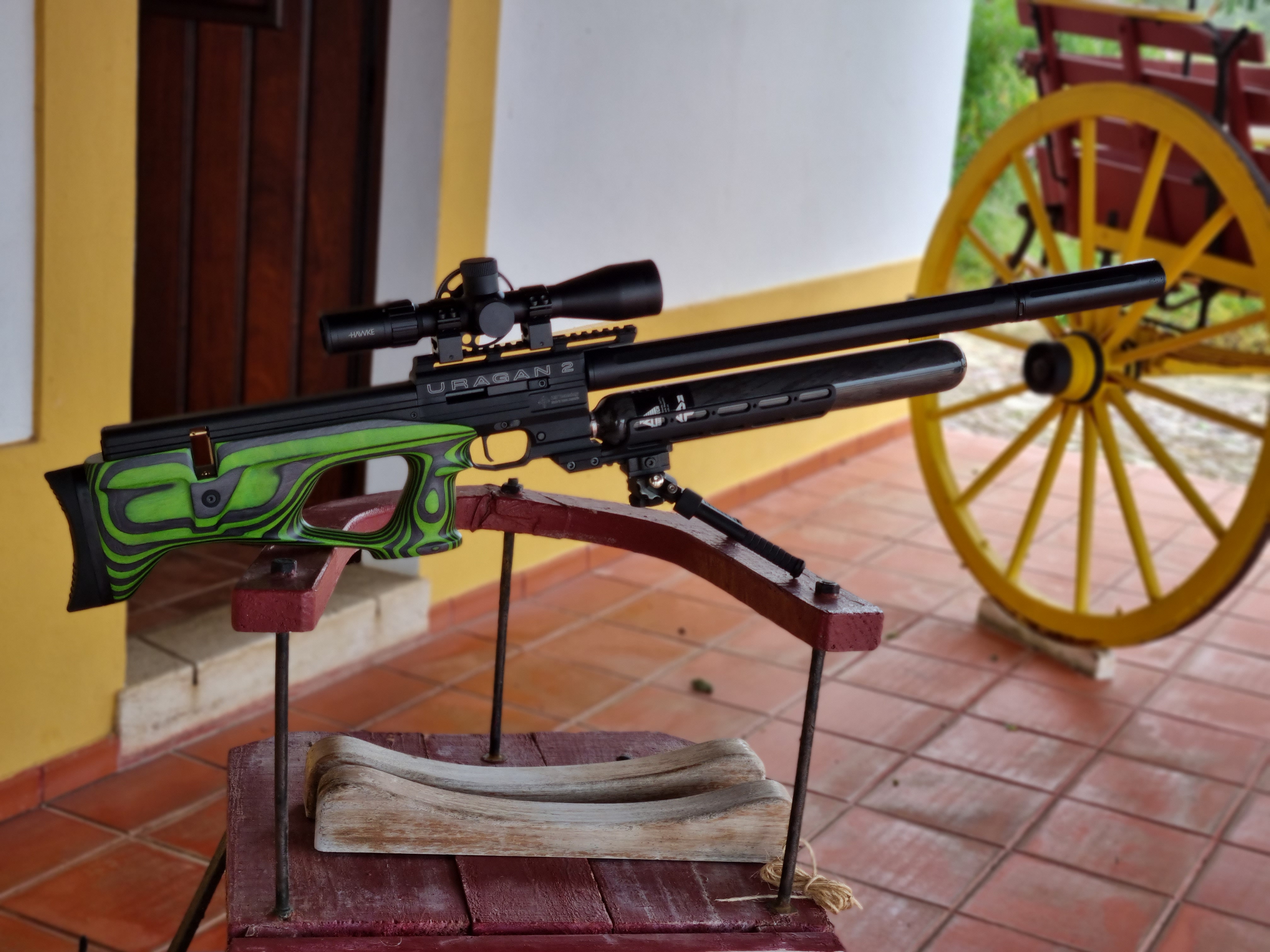

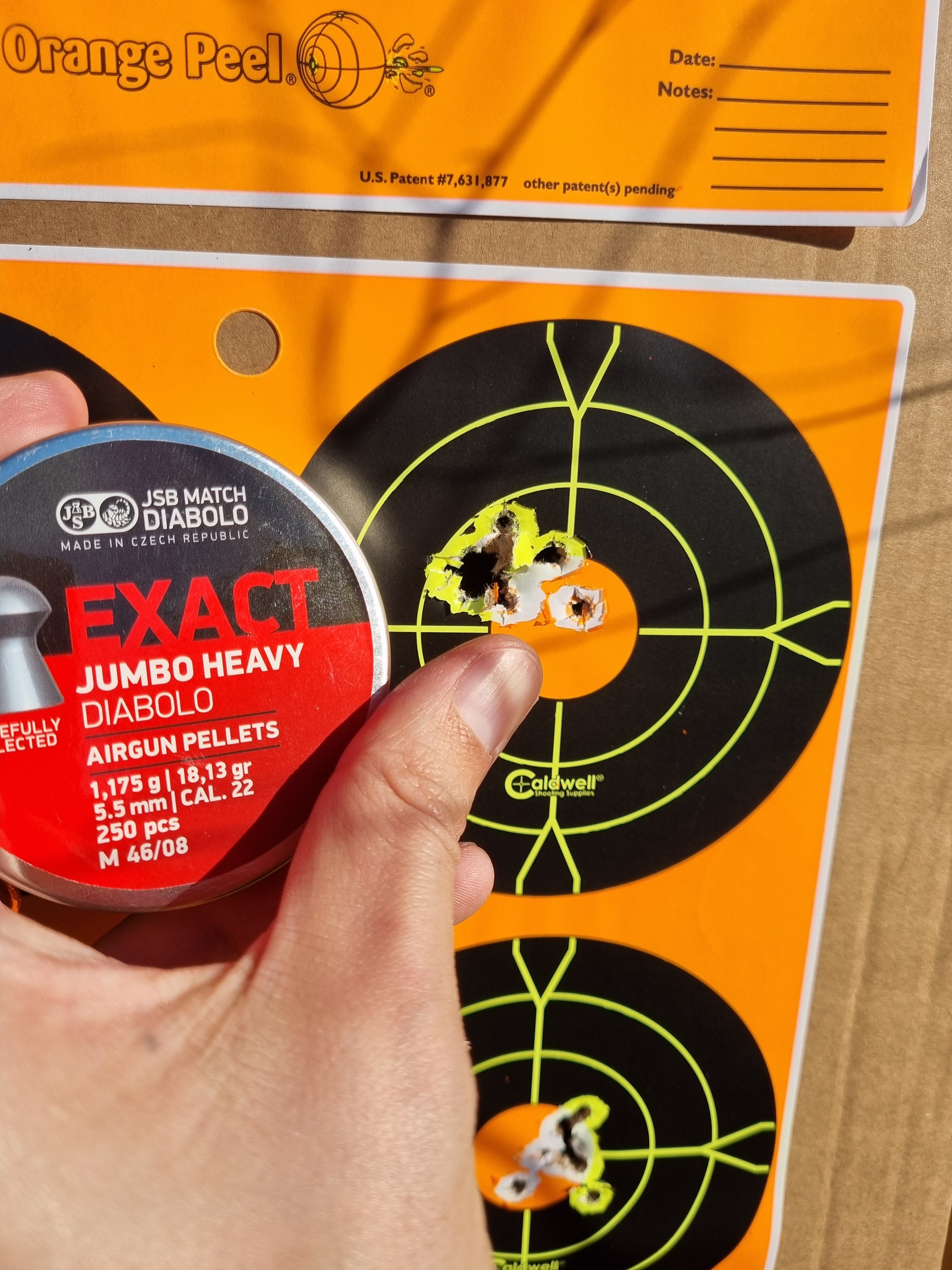

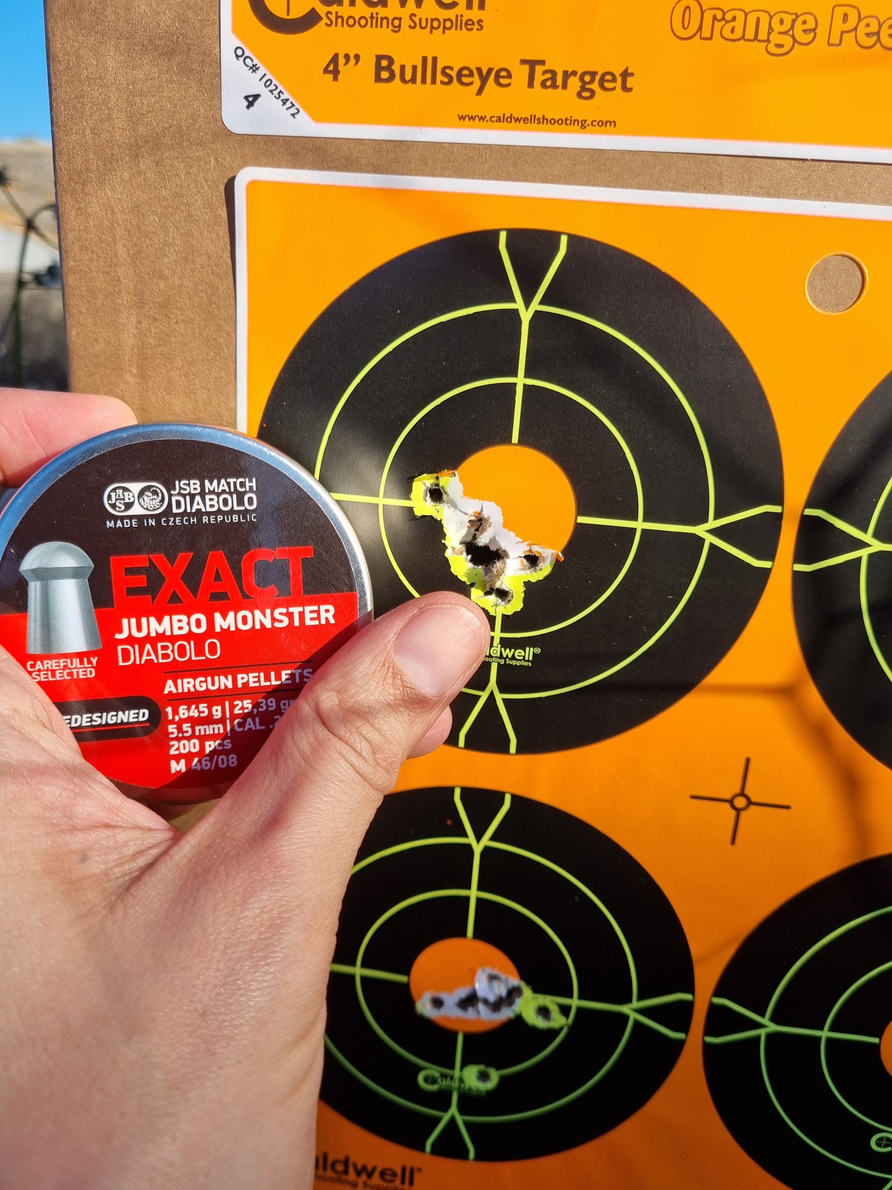

So, finally I had the time to test my Uragan 2 600 5.5mm (.22) in a mostly windless day with several ammunition I had laying around. The gun is completly factory. The reg should be stable by now and the barrel leaded (500+ shots taken).

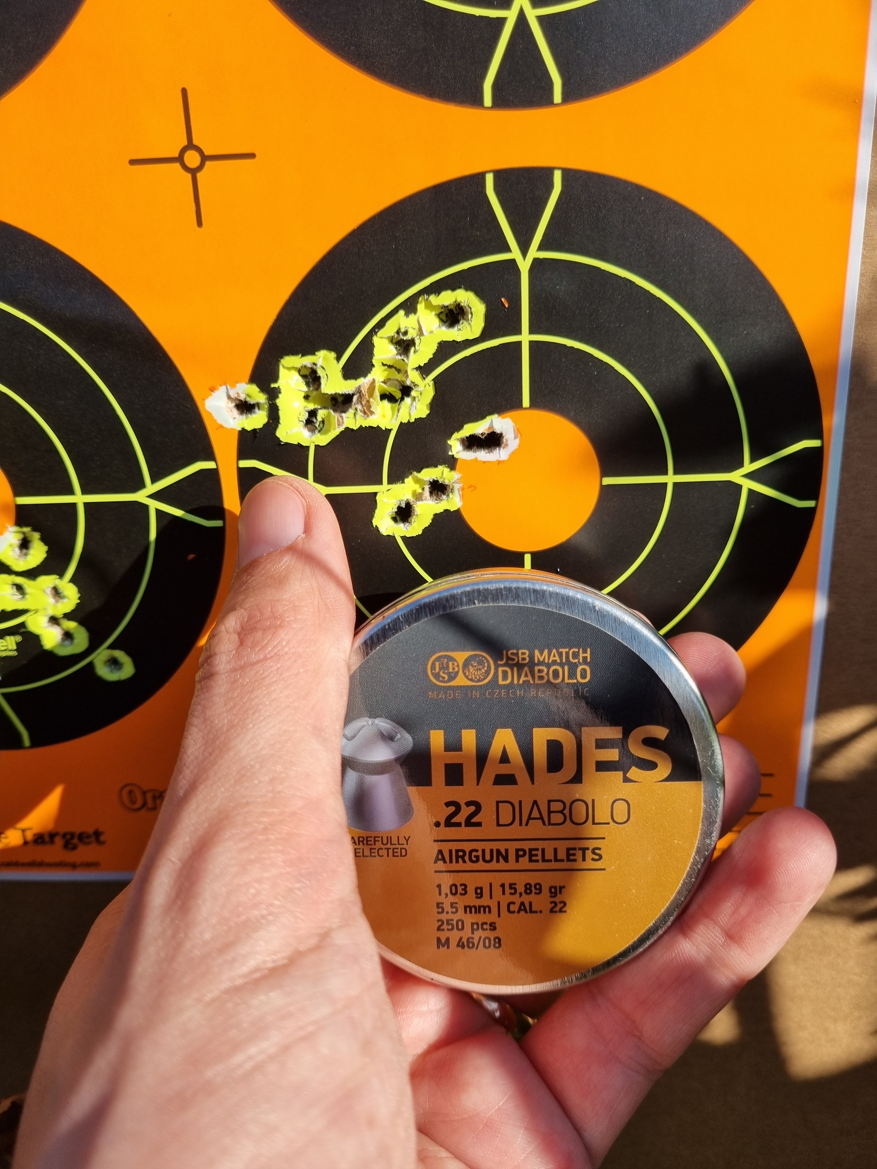

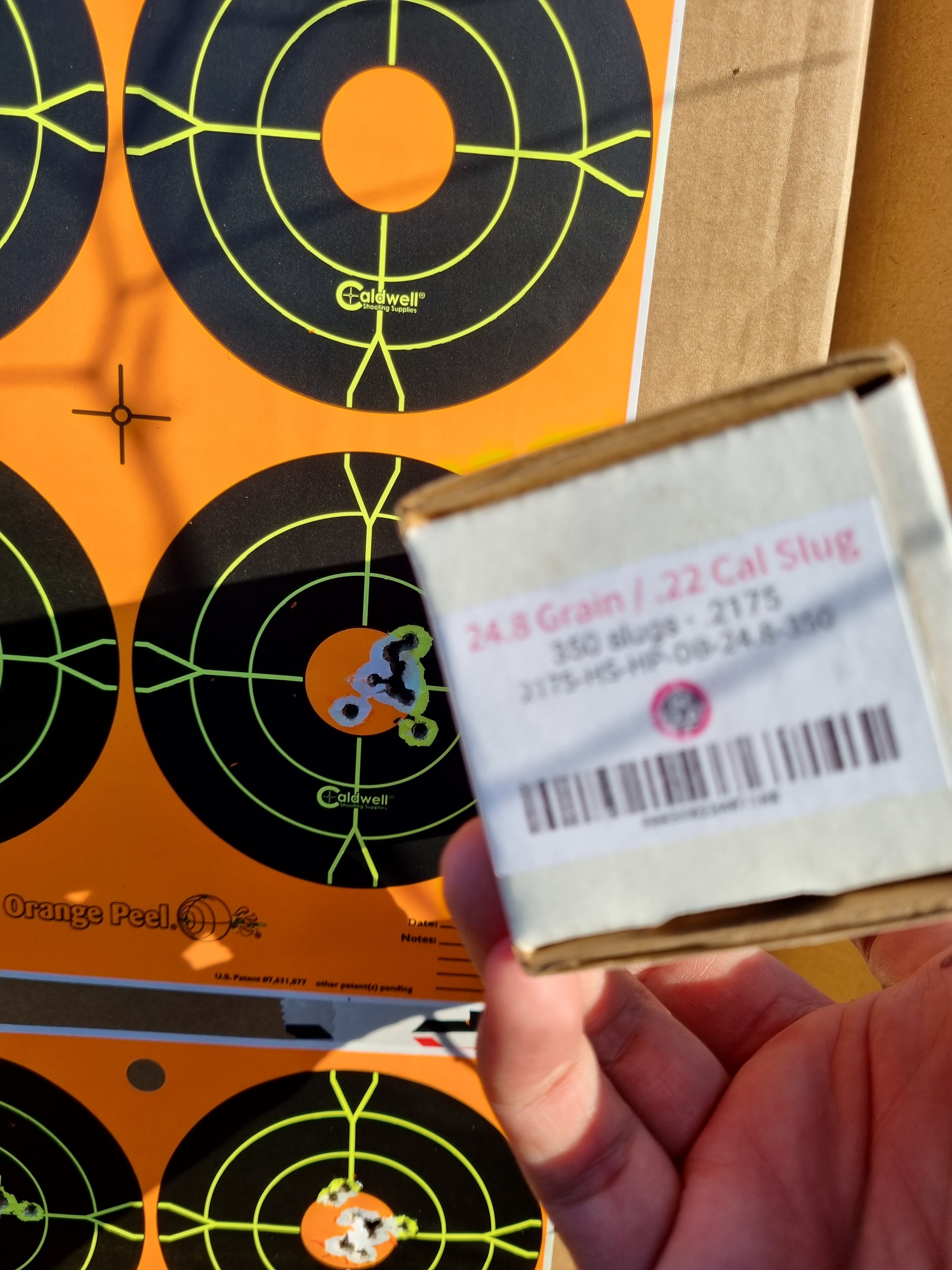

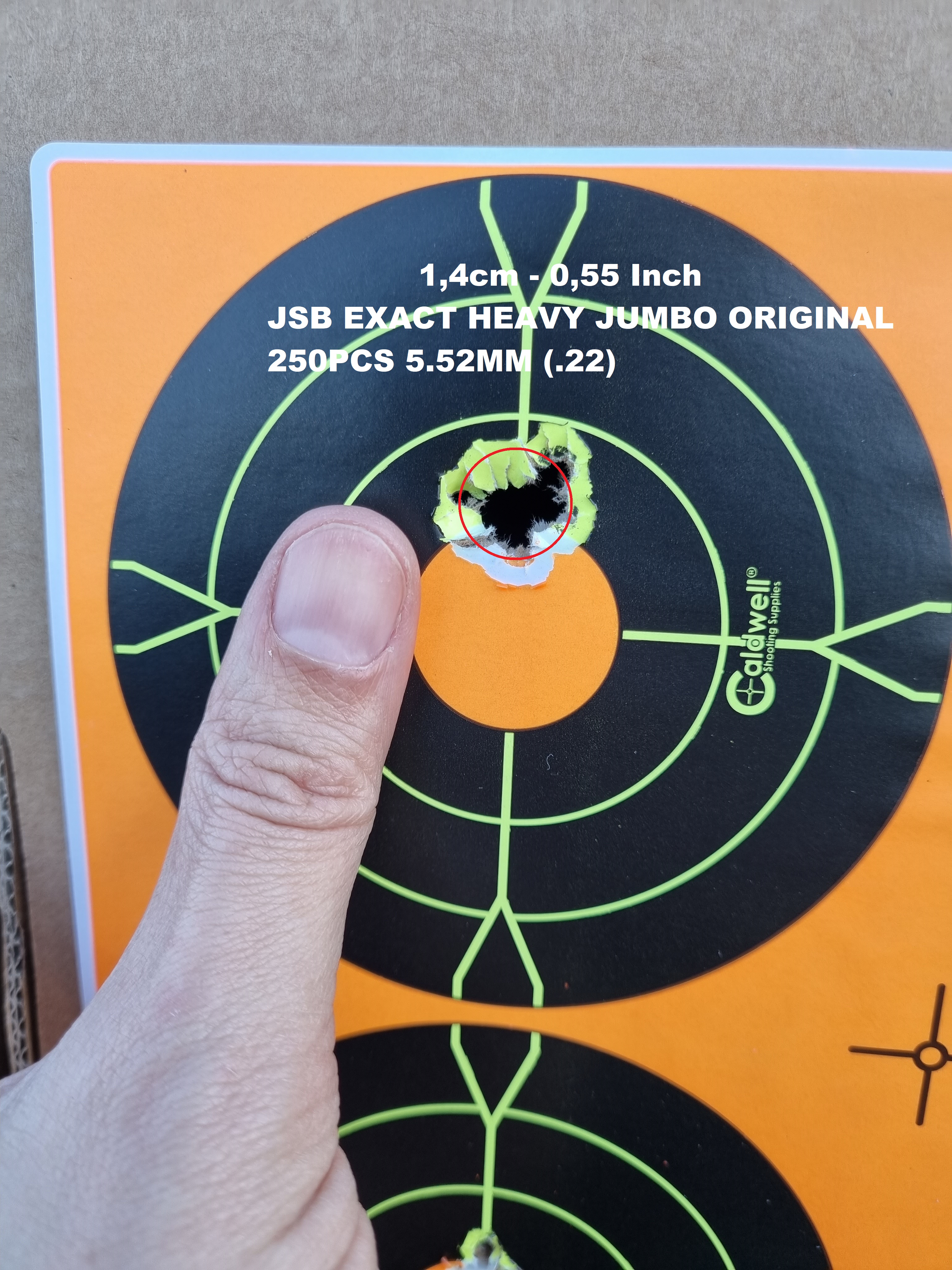

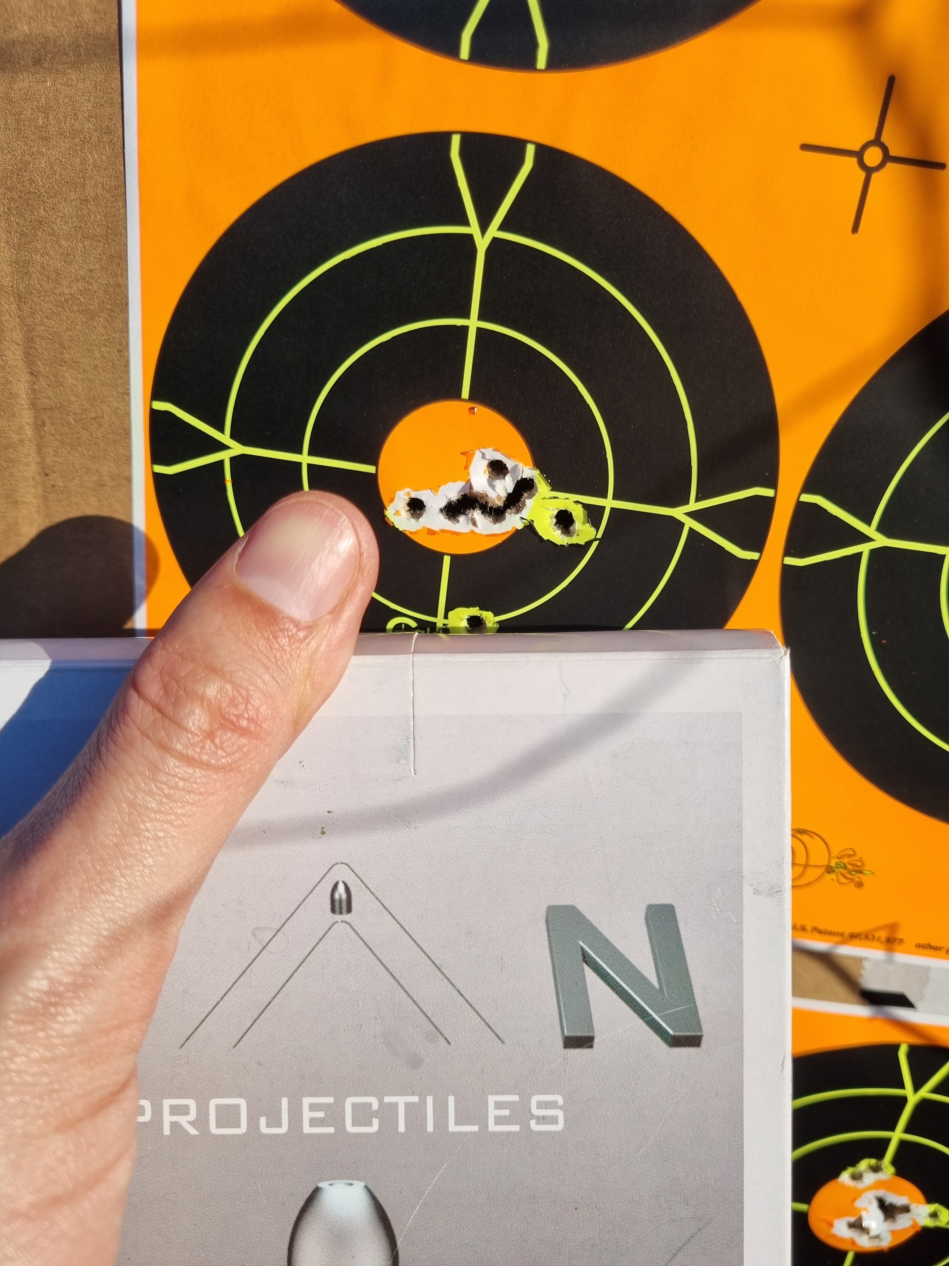

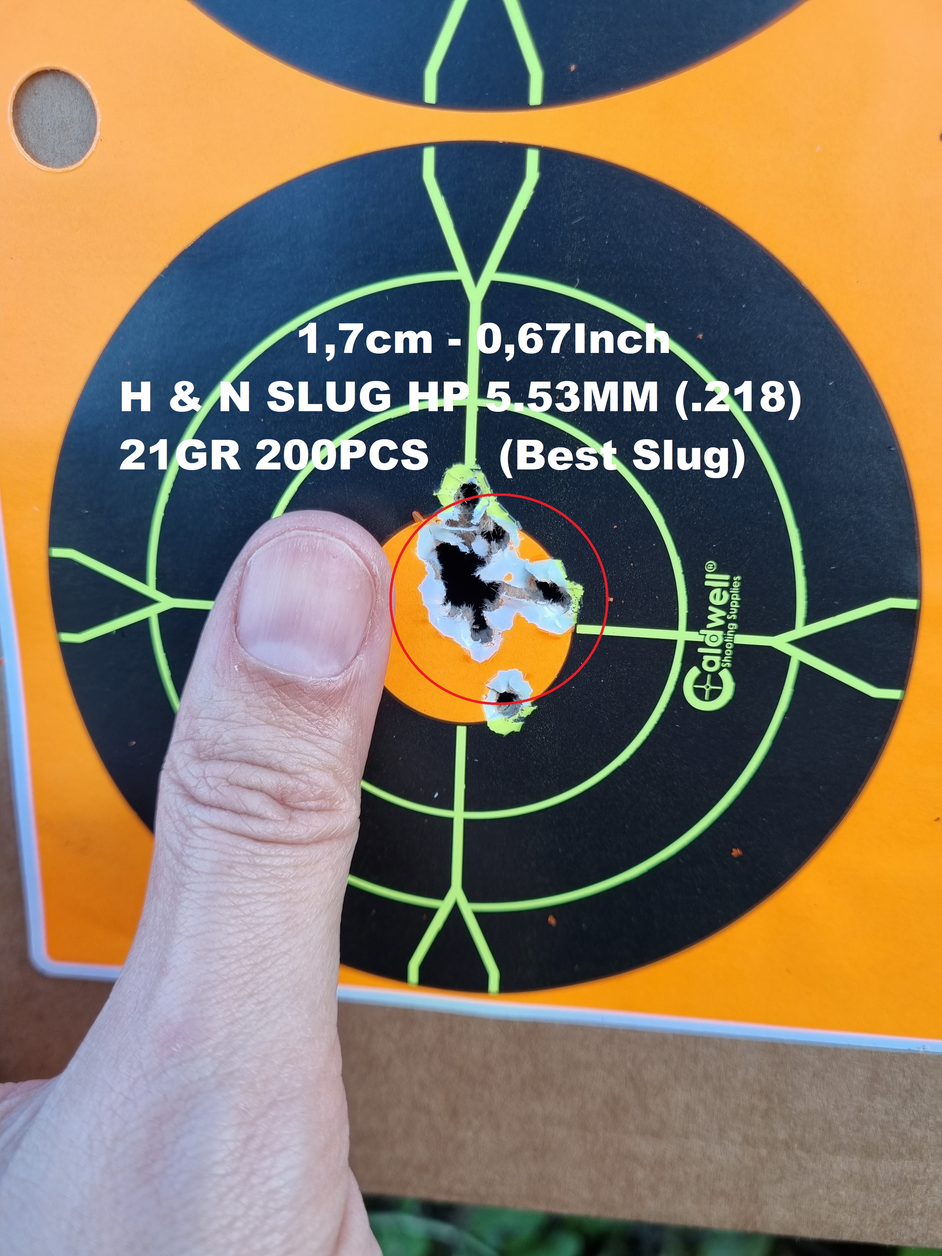

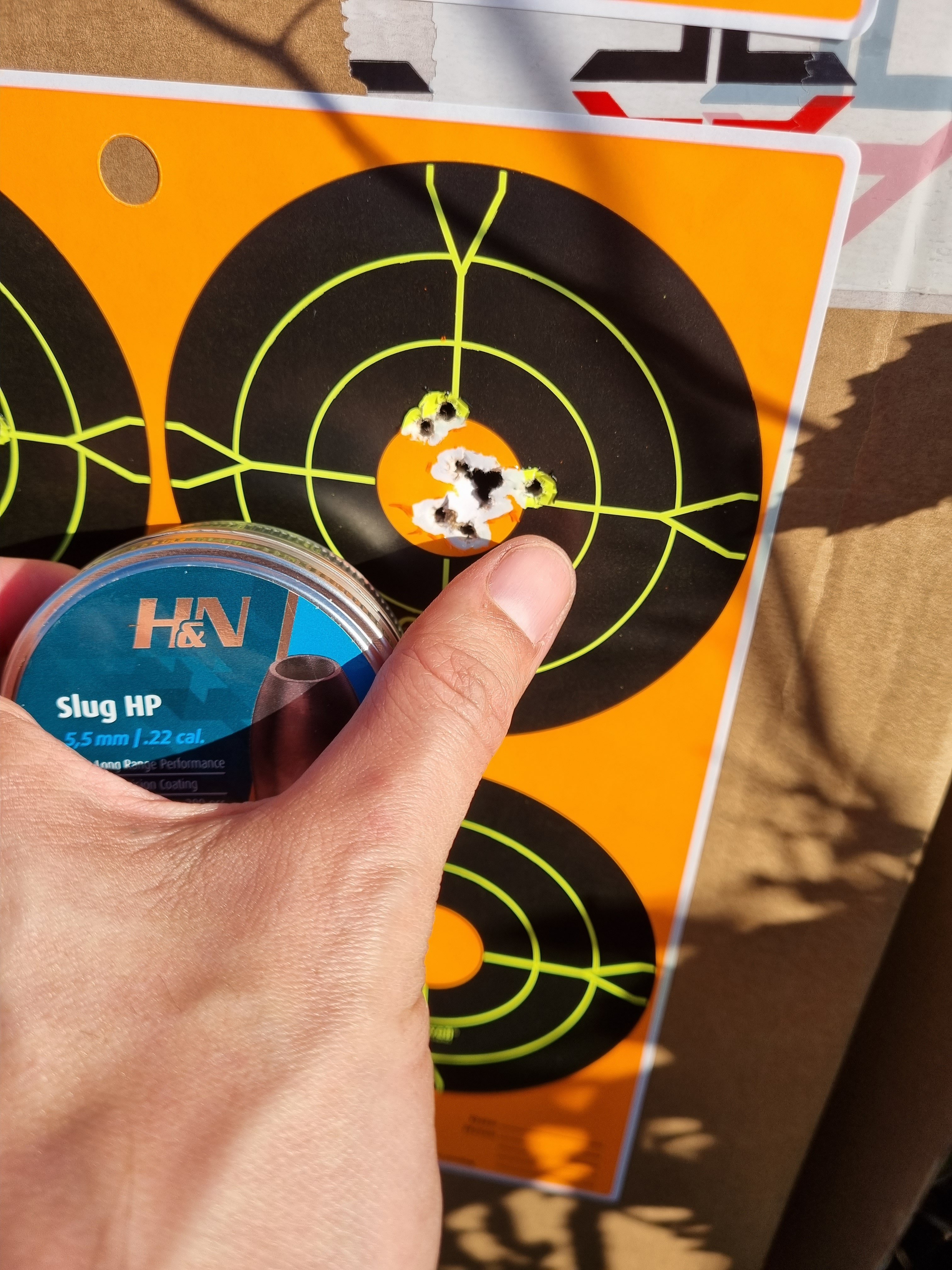

Here you can see 8 different kind of ammunition, 10 fast shots each (i'm not that good shooter). The best 2 (one pellet and one slug) were shot again (12 each) with more attention and "measured". You can see the results in the pictures. All shots were from an improvised table with sand bags. The distance was around 40-42meters (~44-47yds).

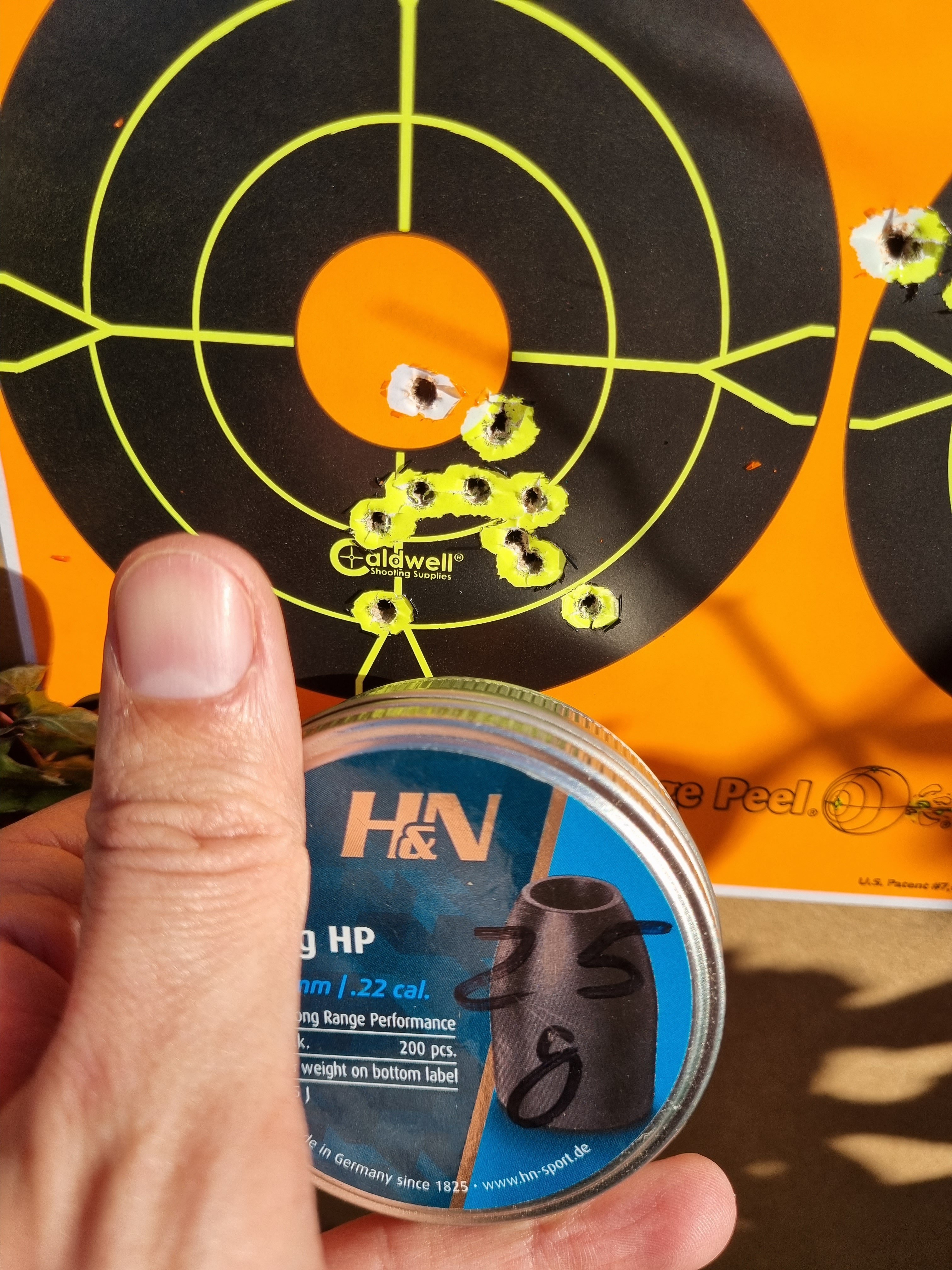

Really pleased with some of the groups. The JSB heavies were great on this gun and more reliable then the slugs, even though it really likes the 21gr H&N HP slugs. The 25gr H&N were awful, as were the Hades. I guess its too hot for the Hades.
If my chinese chronometer is anything to go by, its shooting at around 51Joules (38 Ft/lb).
I think I wont be messing with the reg, I'm happy with power and shot count. I use the gun for some fun on the bench and hunting. Now I'm really unsure if I should just zero it for the JSB heavies or the slugs. I wont be shooting longer then 100yds, but I'll have to try both at longer distance to make my mind.
