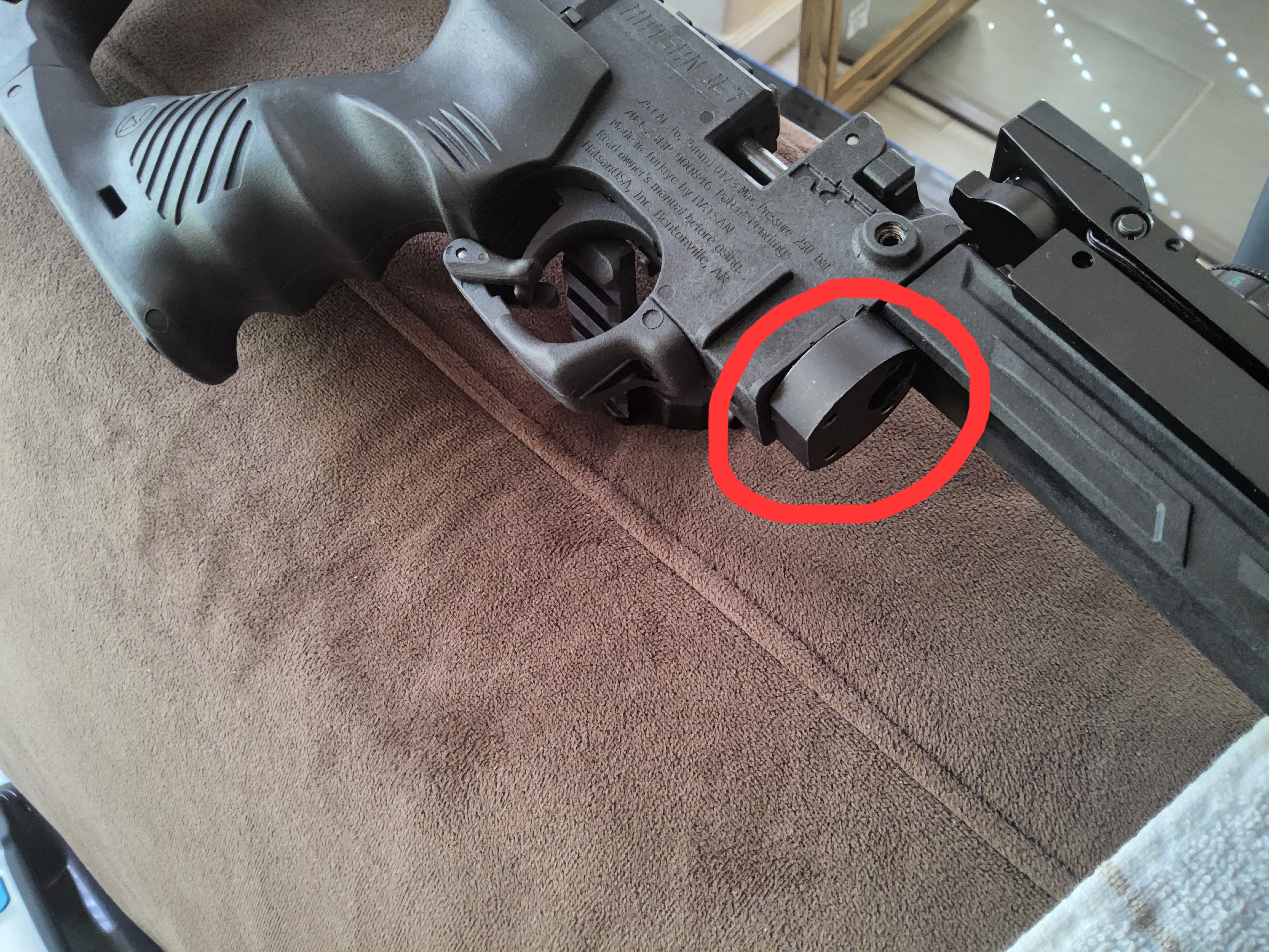

So I think you mean after I take out the first screw the inside there there's this grub screw and I managed to unscrew that with an Allen wrench but now I can't seem to pull off the part I'm supposed to take off. Should I pry it out or how do you get it out it just seems firmly entrenched there
I tried removing the the single cylinder block for upgrade to the dual cylinder. I can not budge it, both screws and all air removed.
No way short of a pry bar will get that off. The most I can get is a small gap, then no amount of pulling, twisting, etc will budge it. I think I am
going to send the dual cylinder back and stay with the single, too bad.
Reactions: Raptor72
Finally got the single cylinder block off. I kind of feel like a dope. There are two not one, set screws holding the block on
The first is under the screw holding the bottom pic rail, as explained in a previous post. The second and the one I was not aware of
is under the screw holding the front of the trigger guard on. I was fighting against the second until I realized there was a second set screw.
With both set screws removed the block slides right out. Live & learn, LOL.

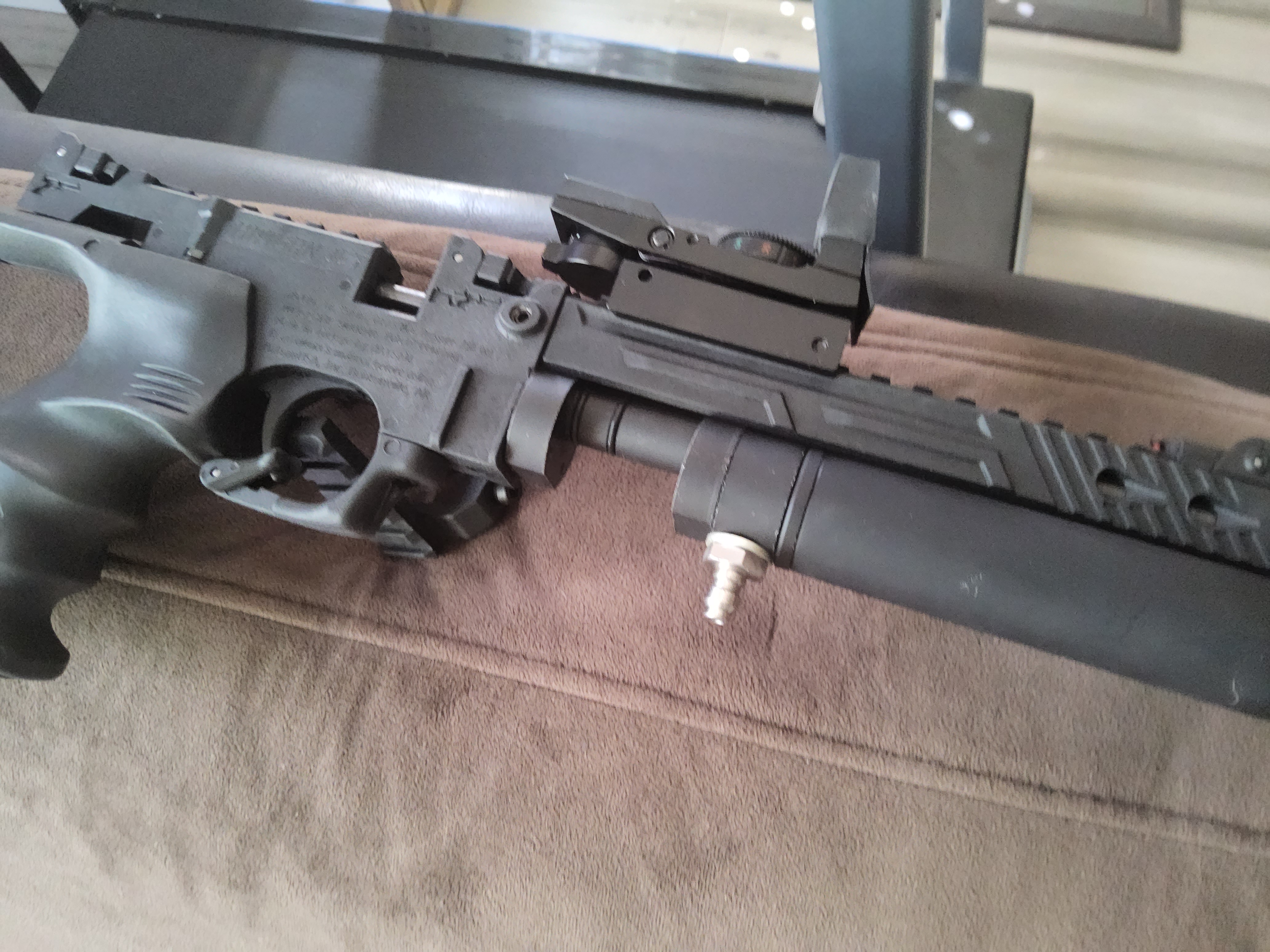

I can't get the block off of the gun to put the single tank back on. It was easy upgrading to the dual tank but now the single tank won't go back on because of that block.
