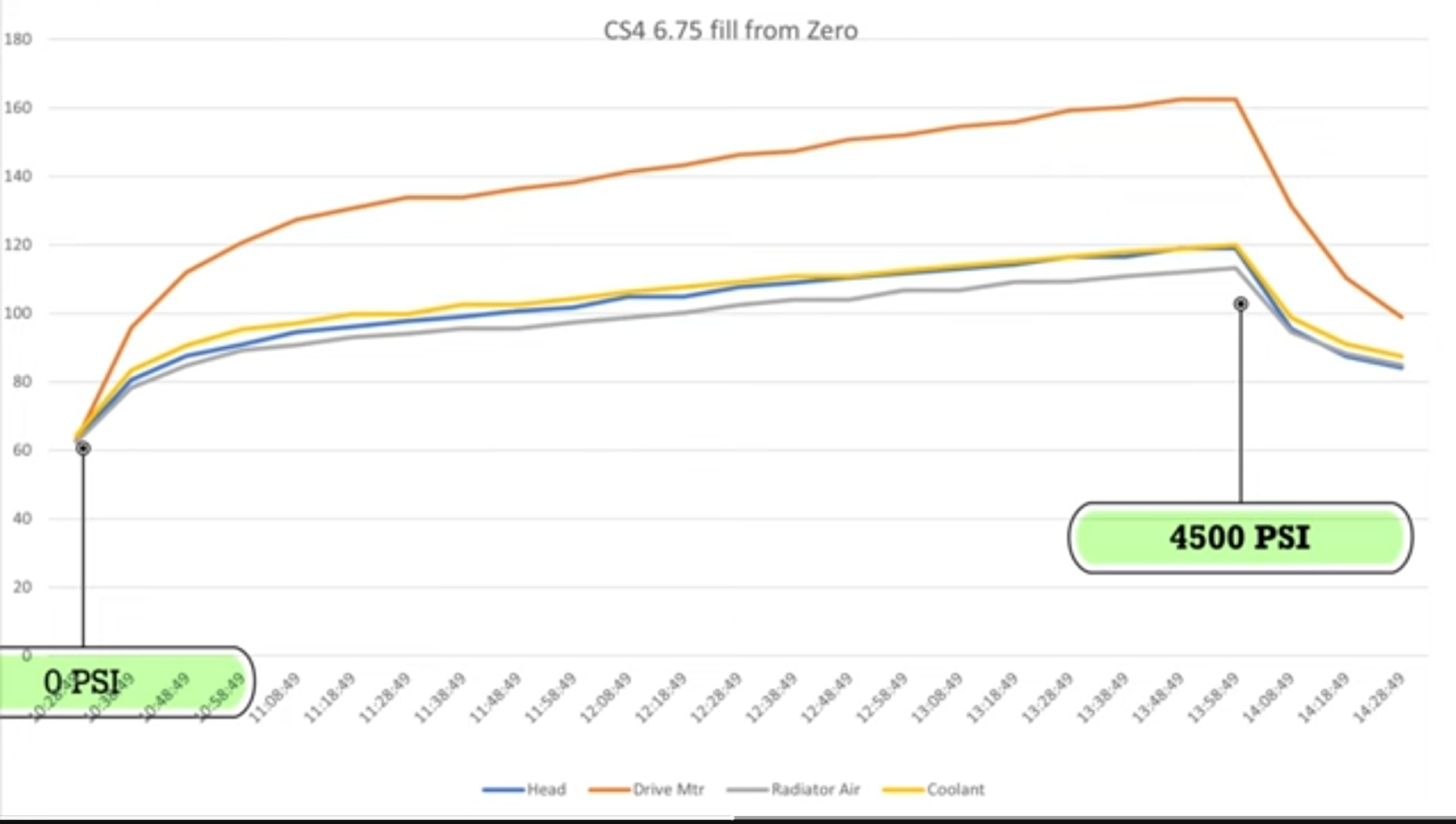

So looking at this graph by Target Forge:
The temperature never reaches an equilibrium.

It's your time and money, so do what you want, but I feel it is a waste of time. I measure the temp in four places, and have never felt the need for better cooling. Using a proper AF/DW mix of 10/90 or 20/80 would probably have more of an effect on cooling (or better yet, DW plus 8ml of Water Wetter, as I am doing).

I just realized and posted a reply on the Target Forge YouTube video that Bill might have reached a temperature equilibrium during his testing. The temperature of the pump only went up about 20 degrees after the initial 40 minutes of pumping. But according to Bill, the ambient temperature went up nearly 20 degrees during the pumping session. If you correct for ambient temperature, the equipment didn't get any hotter after the first 40 minutes.
That is, if I understood it correctly.
