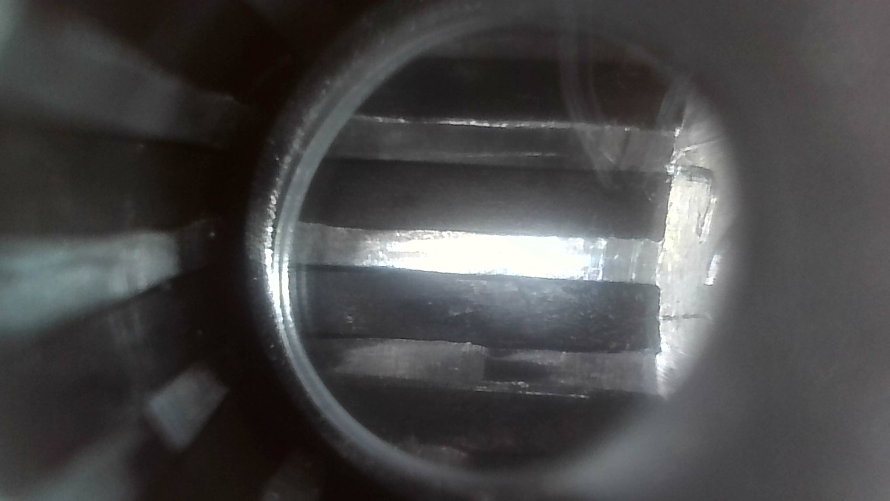

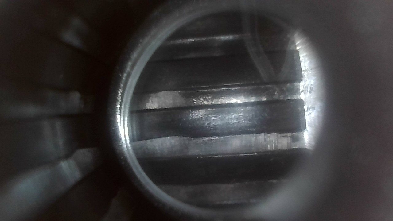

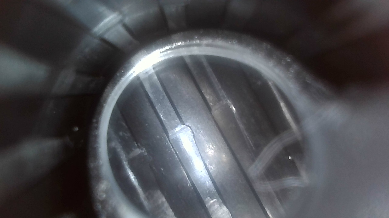

Received my new Bullshark yesterday. Sat down to clean it and go over it this morning and found bad tooling just inside the muzzle, last 1/4 inch.
I believe that I must have the worst luck with barrels as possible. (Still working out buying a new barrel for my big bore because I didn't get a bore scope till after warranty ran out on it.)
I won't mention where purchased yet to give them a chance to reply. But paperwork says contact Stoeger directly for warranty issues so I'll be doing that also. Guess I'm the one that gets to see how well they stand behind their 5 year warranty.
Frustrating because I've got a new toy and don't get to play with it.🤬 I haven't even put a scope on it and tried it yet. Simply not doing anything else with it till someone addresses this.
Could shoot like a laser but I doubt it since this should be the last of the choking exiting the barrel. (If they are choked, can't find info on that.) But feel this would definitely be damaging the pellet skirts upon exit and is a defect in workmanship that should be covered by warranty. (Rest of the barrel is good; maybe some polishing, but would see how it shoots first)
I do tend to panic over issues like this so feedback on what everyone else thinks would be appreciated.

The manufacturer that makes the Bullshark has been wrecking barrels since I bought my first one from them eight years ago. There are a ton of guns out there from them that the owners didn’t take a scope to the bore and are shooting good enough. Bore scopes can make a speck of lint look like a boulder in your barrel. So a lot of times it’s not as bad as it looks when it comes to performance. Good luck getting a barrel from them that you and your scope are going to be happy with.

Just in from shooting 12 mags out a shed window. Was actually hitting a metal drive in fence post at 25ish yds some without a scope. Anyway bore scope doesn't show the bad places catching lead from that. Hopefully wind will be down tomorrow so I can actually test for accuracy or at least consistency. Got several pellets to try.
But even if it's a laser I'll probably contact them anyway just so it's on the record incase there's a future issue with it. Never hurts

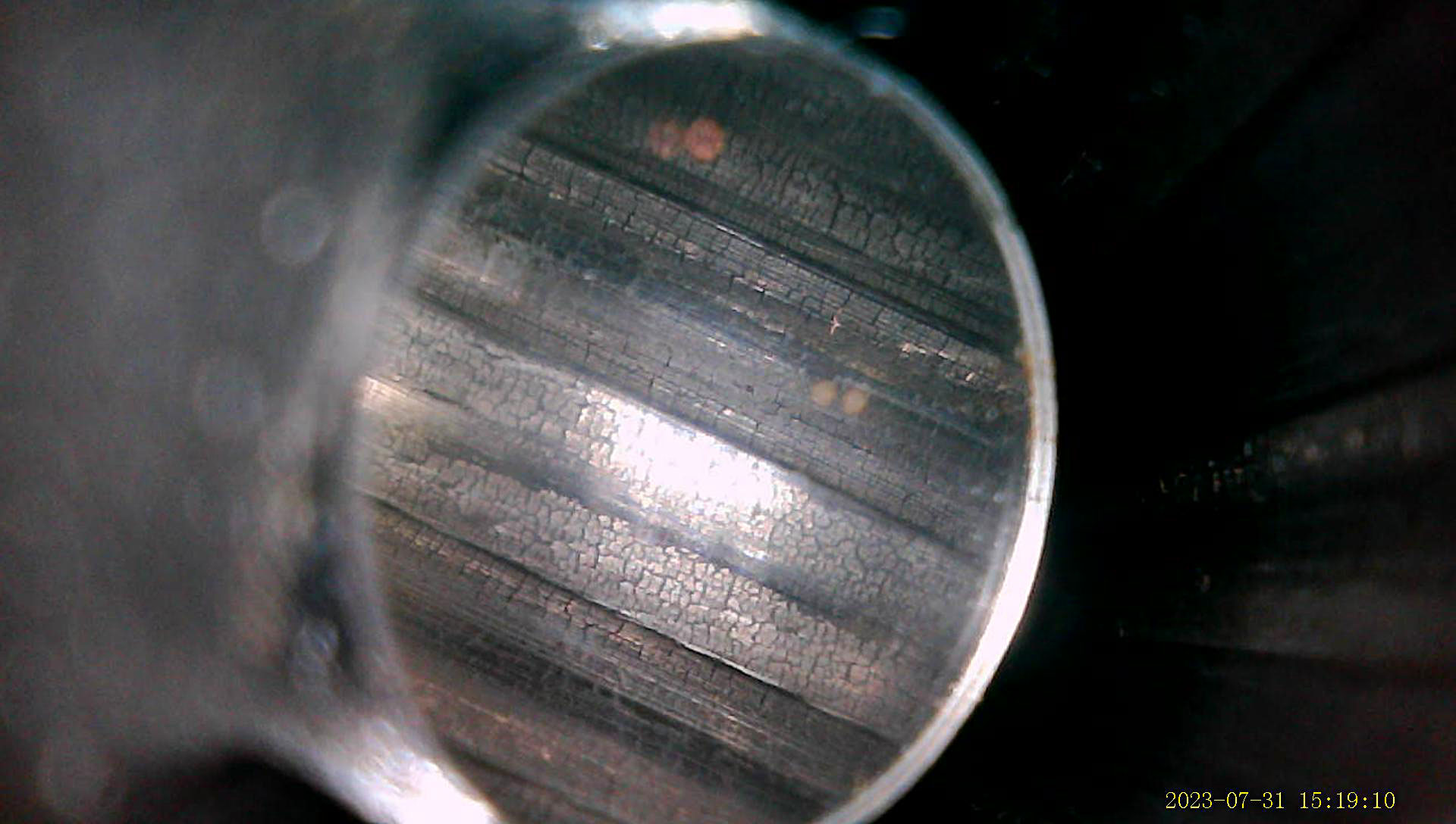

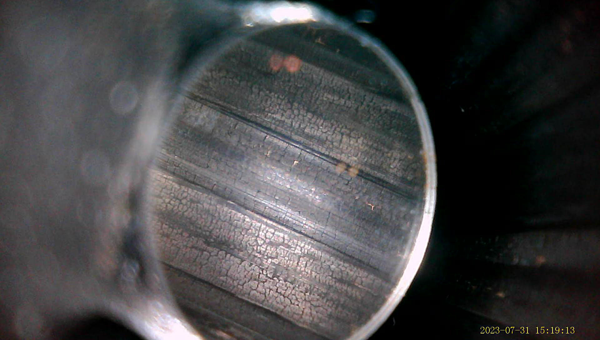

Yep a barrels accuracy isn't deemed by what a bore scope shows...
This is one of my 375 CheyTac barrels at approx. 2000 rounds....looks like crap, BUT still shot 1/4 moa!!
Target is 2500yds ....shot with the "Crap" looking barrel..
Yep. The inside of my Taipan barrel would send a bore scoper into cardiac arrest. But I’ve never shot a more accurate or consistent .22. And it never needs cleaned.

I agree the subject barrel looks bad but I'm happy you have started shooting it a little. If it shoots well, who cares what it looks like inside.

Just finished filling my tank, and mounting a scope. Looks like the wind is starting to lay down finally, so hopefully can get out tmw. Just by it's feel if it shoots constantly I'm going to enjoy it.
Despite what ever was done to the lands just at the muzzle it shoots fine. These are all 8 shot groups.
For now looks like I'll be going with the H&N Baracuda 30.86gn, the H&N Extreme Hunter 28.24gn did almost as well. 45 yds is where everything starts opening up. Might improve if I polished the barrel, and increase the potential of the JTS Dead Centers, but not rushing that decision.
Didn't like JSB Match Deobolo Exact Kings 25.39 or Harpex Deobolo 32.4.
Well finish sighting in when wind isn't gust 10 & 15 mph. Also noticed breach o-ring is getting blow by so need to replace that, might change things a little. Couldn't crono to because of wind.
