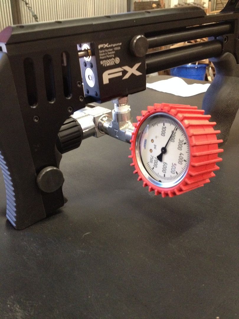

My Impact refills in about 1 second. I know this because I actually shot a video of it to share with you all. I took out the reg gauge, added a fitting, a tee, a bleeder valve on one side and a 2.5" gauge on the other. (I would NOT recommend doing this as it is a lot of strain on those fine threads and can EASILY destroy your rifle if knocked around!) Then I set up the camera to watch the gauge and started shooting.
The first round was shot slow to see if the reg was actually filling back up to the same spot, or if there were fluctuations. Result: it's doing its job!
The second round I let loose and shot as fast as I could which was about 1 second between shots. I could probably shoot a little faster but, I had to aim or risk shooting through the garage wall. Result: It certainly looked like it was keeping up to me! It's a little tough to see with the card table moving all around.

Here's a pic. Mind the pressure, it was during tuning and that's not what I'm set at anymore.
Wow, detailed experiment that is exactly the kind of information that I'm looking for, thank you for posting that Tom! I'm inclined to think after the chrony work I've done the last few days that my experiment tomorrow will likely tell the same story. I can't wait to see the video you post about it, I'm subscribed to your channel so I'll keep an eye out for it.

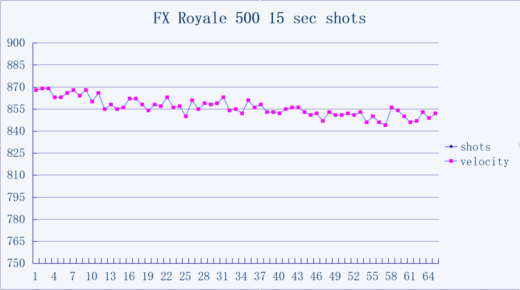

OK well here are the results of the two strings I shot this morning. 1st string shot with me timing 15 seconds between shots on a stopwatch. The second string almost as fast as I could cock the lever and shoot the gun. Both strings were shot with the starting pressure at 220 bar. Each string was 66 shots, six full mags.
I have 4 mags for the royale so I was able to shoot both strings pretty consistently with a pause after shot 44 to load two empty mags to keep shooting. I accidentally deleted the first string (15 seconds between shots) from the chrony before writing down the stats, i.e., SD, Average, etc.
Also, it did occur to me that because I was shooting so fast on the second string I was able to hold the gun more consistently between shots. I was stopping to write down velocity of the shots on the first string (15 sec intervals) because I knew I was going to have to delete the first string to record the second one. I wonder if that had any impact on the results.
First string - 15 seconds between shots
Second string stats, 1 second between shots

I would say by the looks of the two strings the reg needed no settle time. Thats the way it should be. Anyone who has to wait to take a second shot with a regulated rifle has an issue with the regulator or tune. This is just my experience and I could be totally wrong but it doesnt make much sense to have a regulated rifle that you have to wait 6+ seconds between shots to keep it regulated.
