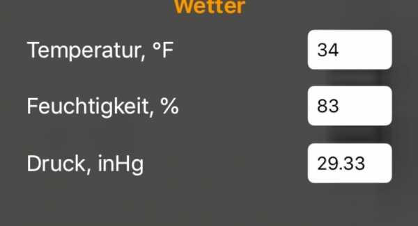

first picture shows the weather conditions
1545583432_17862782415c1fbb482653b7.78966825_14A8E1C0-29C7-4C79-A7CD-0790FF9CD131.jpeg

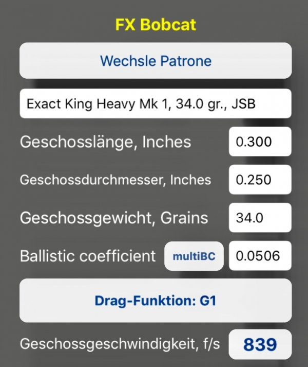

Second picture shows bullets info
1545583475_18461380515c1fbb733ea840.45034285_408751F0-7623-4DAC-84B1-06F52FFAB2B1.jpeg

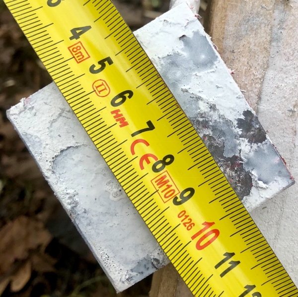

Now here are the comparisons.
this picture was shot with the resized ones
1545583626_18951003975c1fbc0aee3170.89596046_F04AF02D-8D52-46C5-99EE-F16CFFA9B85B.jpeg

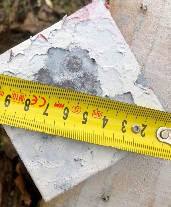

now with the original ones
1545583702_20967364615c1fbc562341b4.99124779_7090F6B9-8E04-4A09-8EF1-562DA637870F.jpeg
