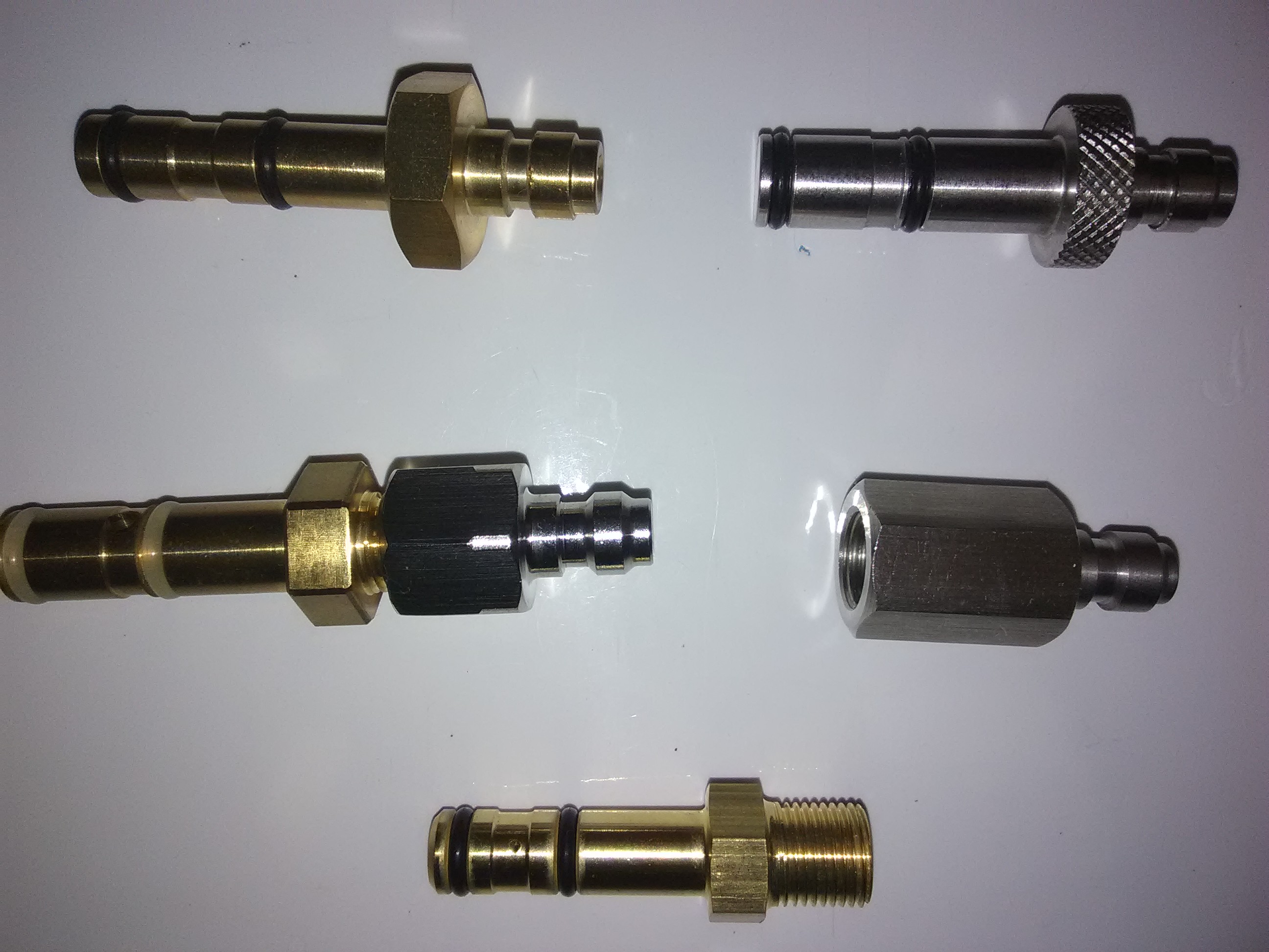

Starting with "Getting Air" questions, SCBA, preferred over SCUBA, is a valid air system, provided refill sources, firehouse, paintball, dive shops, are available. Many begin with hand pumps, most quickly move on to tanks or HPA compressors. Owner's Manual will cover "how-to" fill, gun will have foster fitting or fill probe. If probe, picture shows what adapter you'll most likely need. Refill when gun tank/bottle pressure falls to set pressure of regulator, if gun un-regulated, accuracy will fall off, indicating refill needed. Never take high pressure air for granted, but usage can be safe, if proper precautions followed. Owner's Manual should offer important information. WM

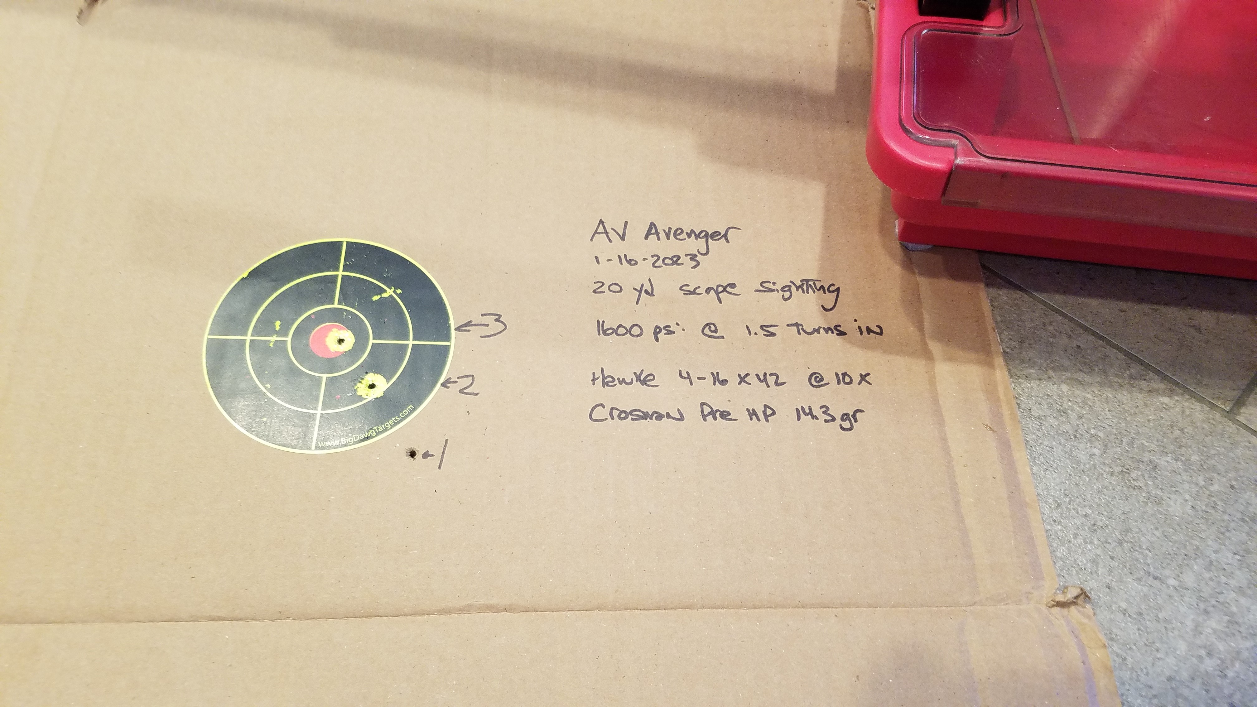

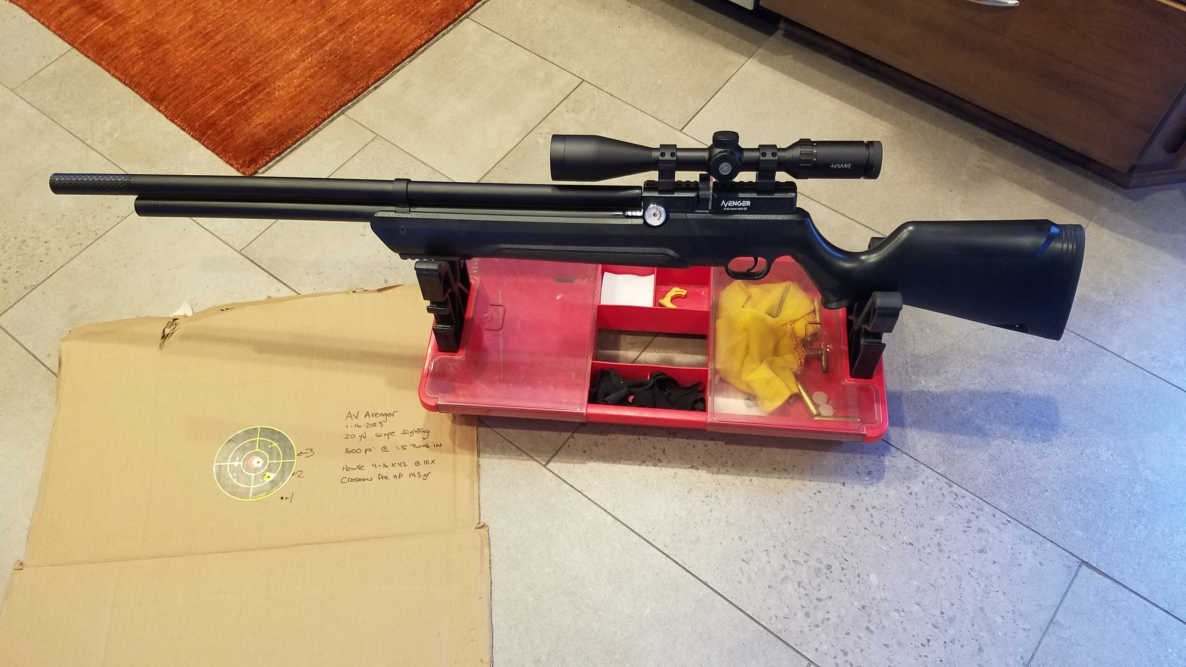

Ended up with a new Air Venturi Avenger in .22 cal. Bought a Hawke 4-16x42 and the correct height rings (1" center to base). Mounted everything last night but too dark to fully torque and set. Went home at lunch and set eye relief and leveled the scope. Put a Buck Rail moderator on the end (big difference) Set up a carboard target as I thought my pellet trap might be a bit small at 20 yards for a new scope.
Nope... Three shots and I hit the bingo. You can see the settings on my target. Running an Eco-Tune right now but at 1600 psi vs. 1400 (Can't dial back down on this gun with regulator charged). Steve's from AEAC has a great "how to" video on this PCP.
The Avenger feels a bit "plasticy" but it's my first and it's light. I will add another PCP for certain. Really like the "tinkering" aspect of this gun with a regulator and hammer spring. Hand pumped to 3000 psi took about 45 mins of very casual pumping (Four Uncles). Topped off today took just another 15 minutes of casual pumping while making lunch (tool breaks per Mfg. recommendations).
After my first fill, I bought a Yong Heng compressor... Reading up on how to properly set up and maintain.
Appreciate everyone's input. Pics or it didn't happen...

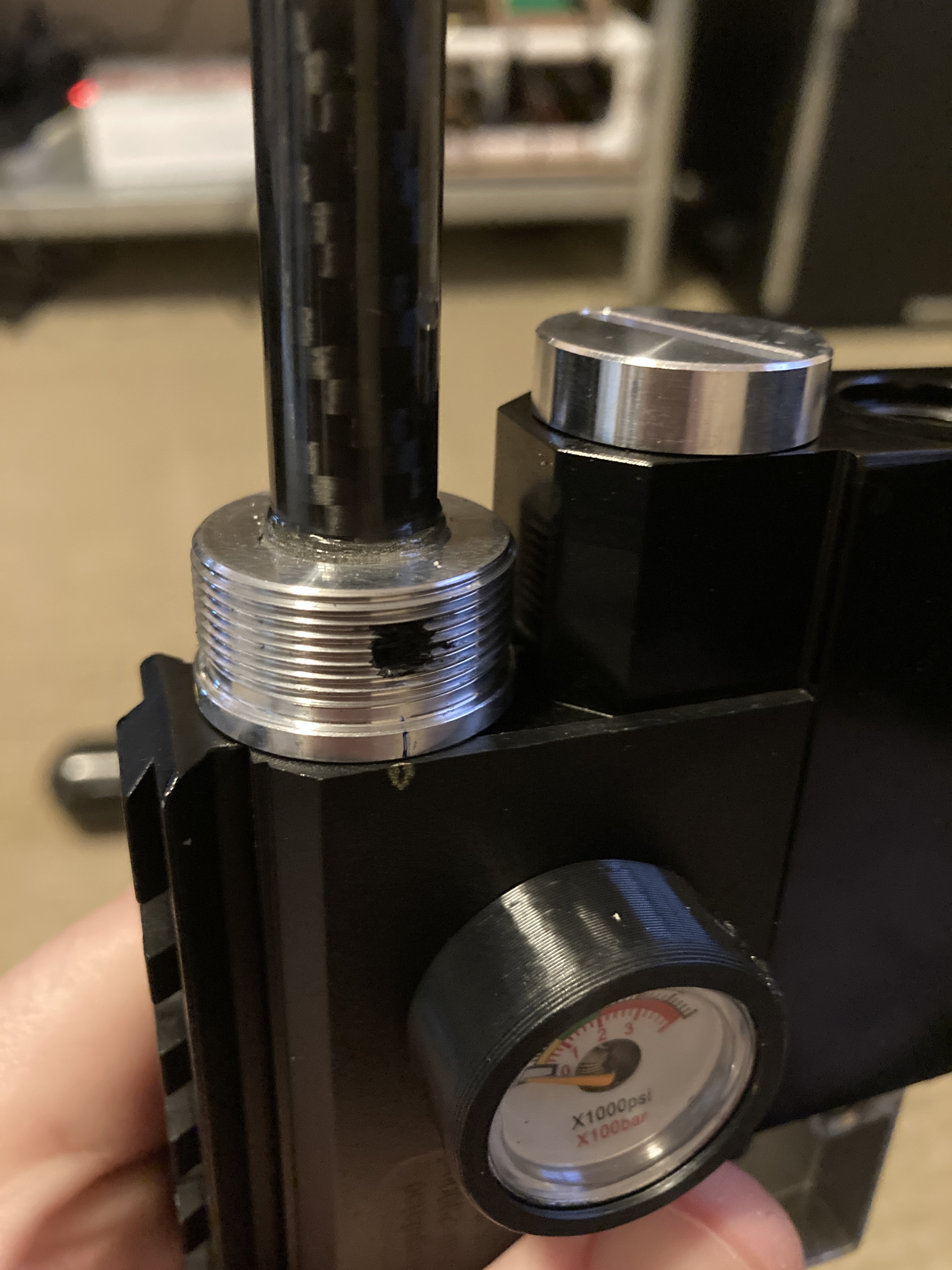

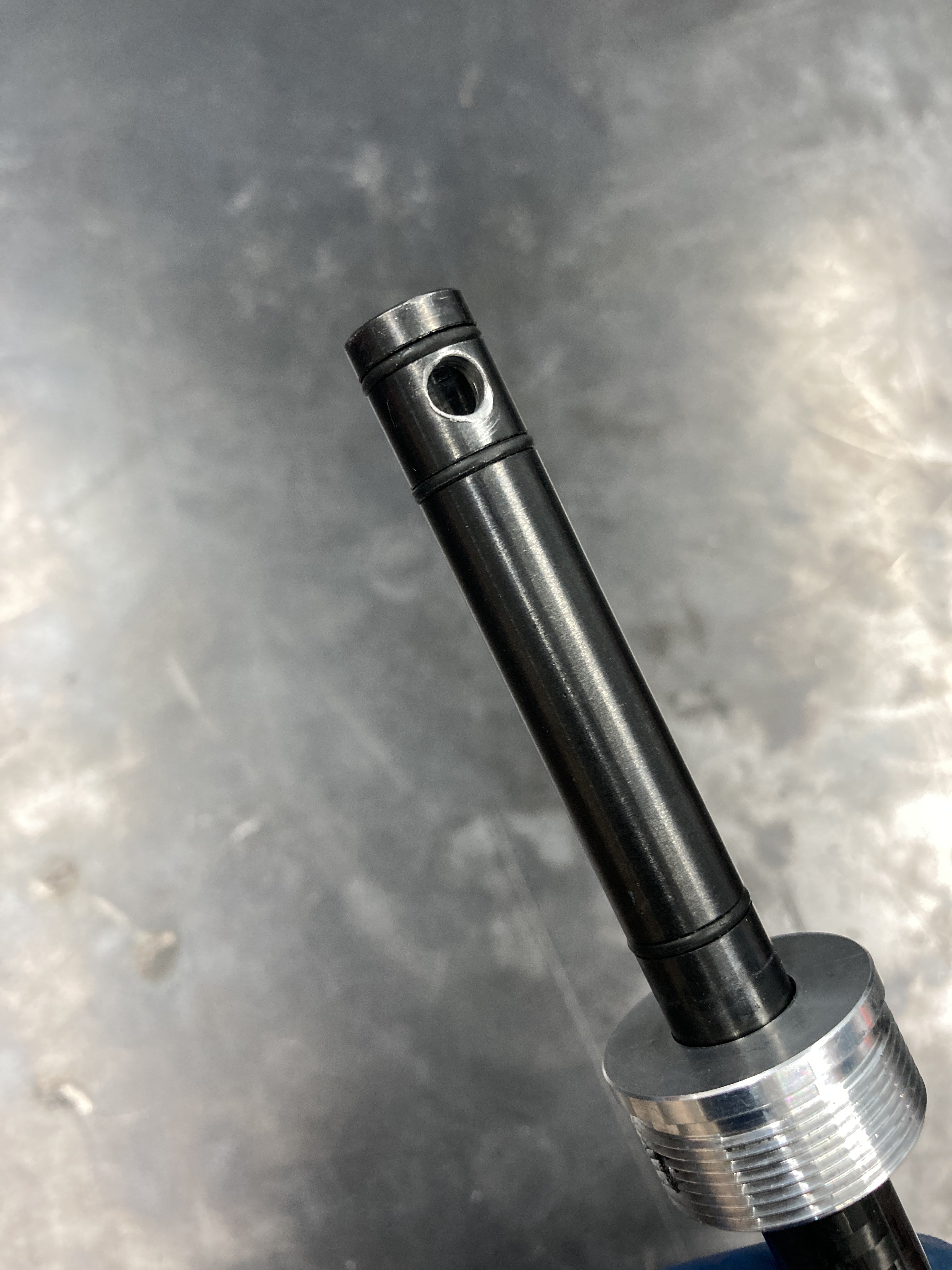

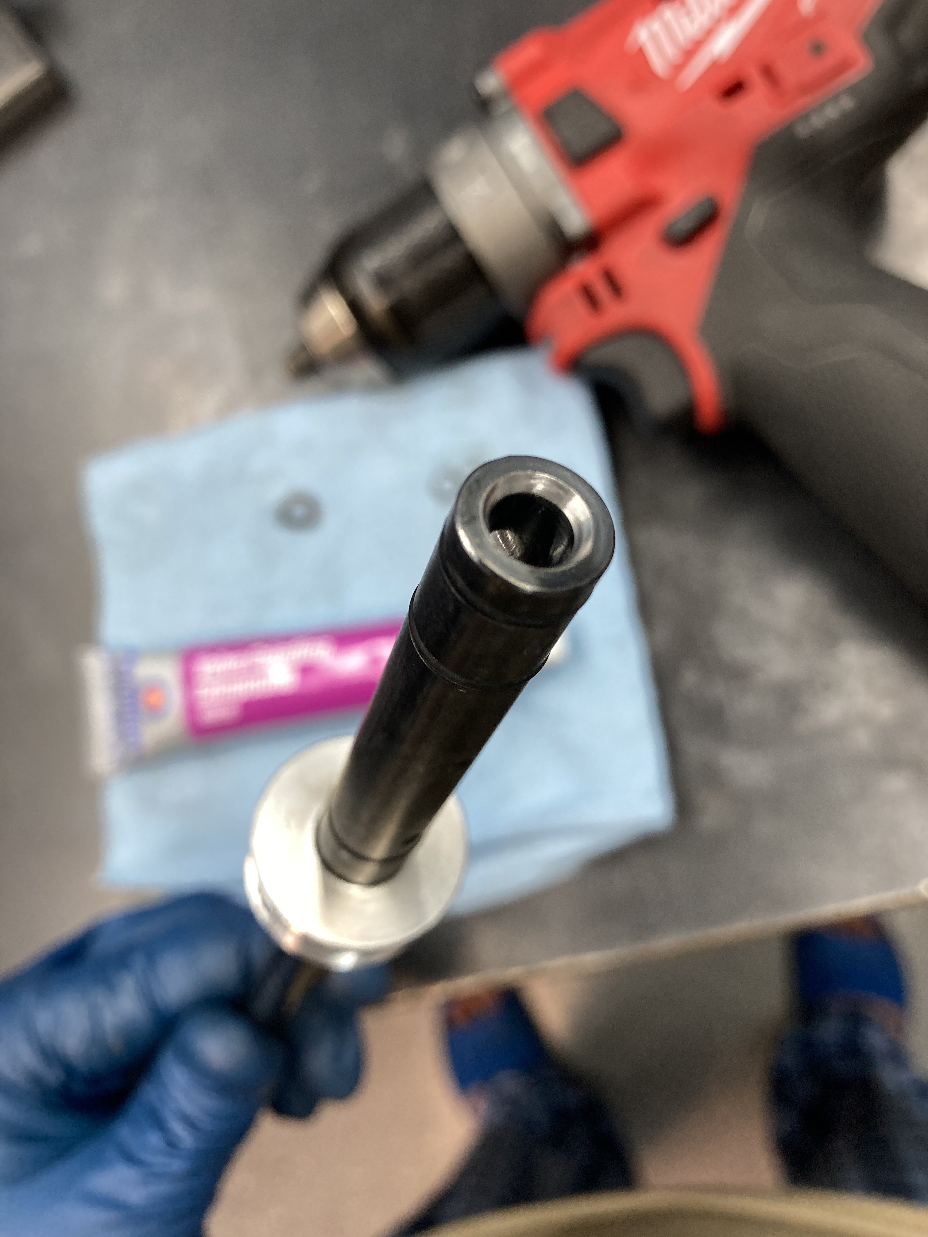

Just port matched and crowned my barrel today. Hope it will make some difference.
