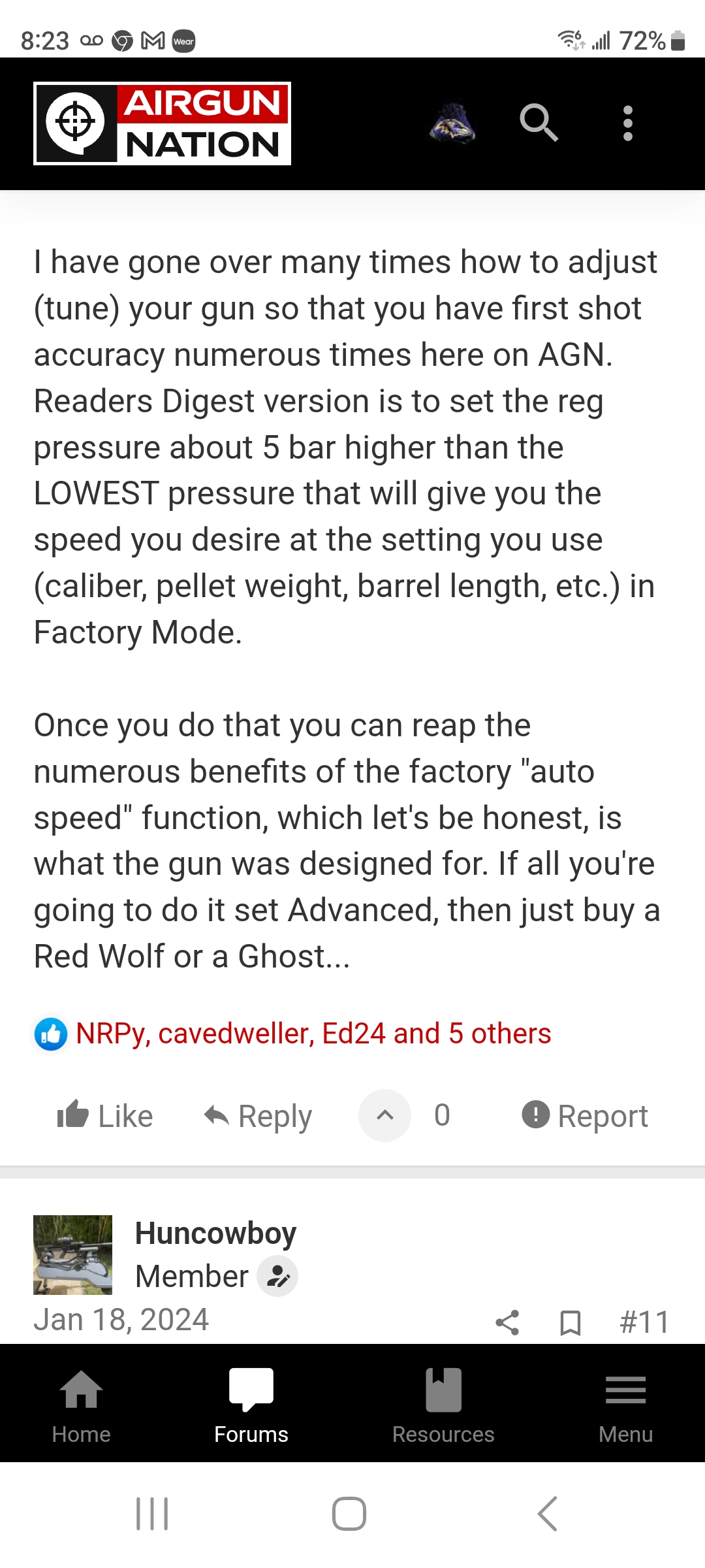

Centercut has covered this in detail a few times. Remember to degas gun before lowering reg pressure.
