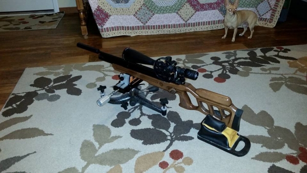

I have an S510 Carbine Xtra in the fancy walnut stock and it is my go to small game hunting gun. I’ve taken countless squirrels, rabbits and grouse with it and it never fails me. I keep my power wheel locked at 75% and have dialed up the screw tension so it stays there.
For those of you northerners, this gun seems to be very very very cold resistant. I’ve had frost form on it at -20 Celsius and it always gives reliable performance.

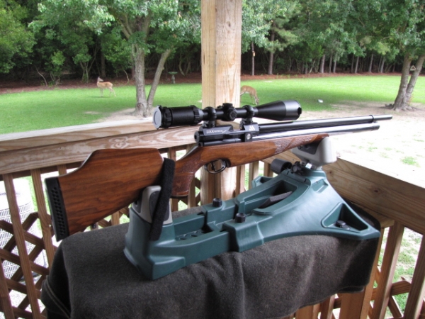

Thanks for the video Jeremy. I had an S500 with walnut stock and it was the most beautiful rifle I've owned to date. Once I got it, I hardly ever wanted to shoot the Marauder anymore. Then I bought a used .177 Cricket Carbine and it just blew them both out of the water. Sold the S500 and the Marauder.
That being said I have bought a very expensive .177 Thomas FT rifle and the Cricket rifle is riding it's heels. Not as consistently accurate as the Thomas but only misses it by a hair. I don't see myself selling the Cricket. Another reason for keeping the Cricket is the 14 round magazines. It comes in handy for plinking and when I get new shooters over they can concentrate on shooting more than loading.
