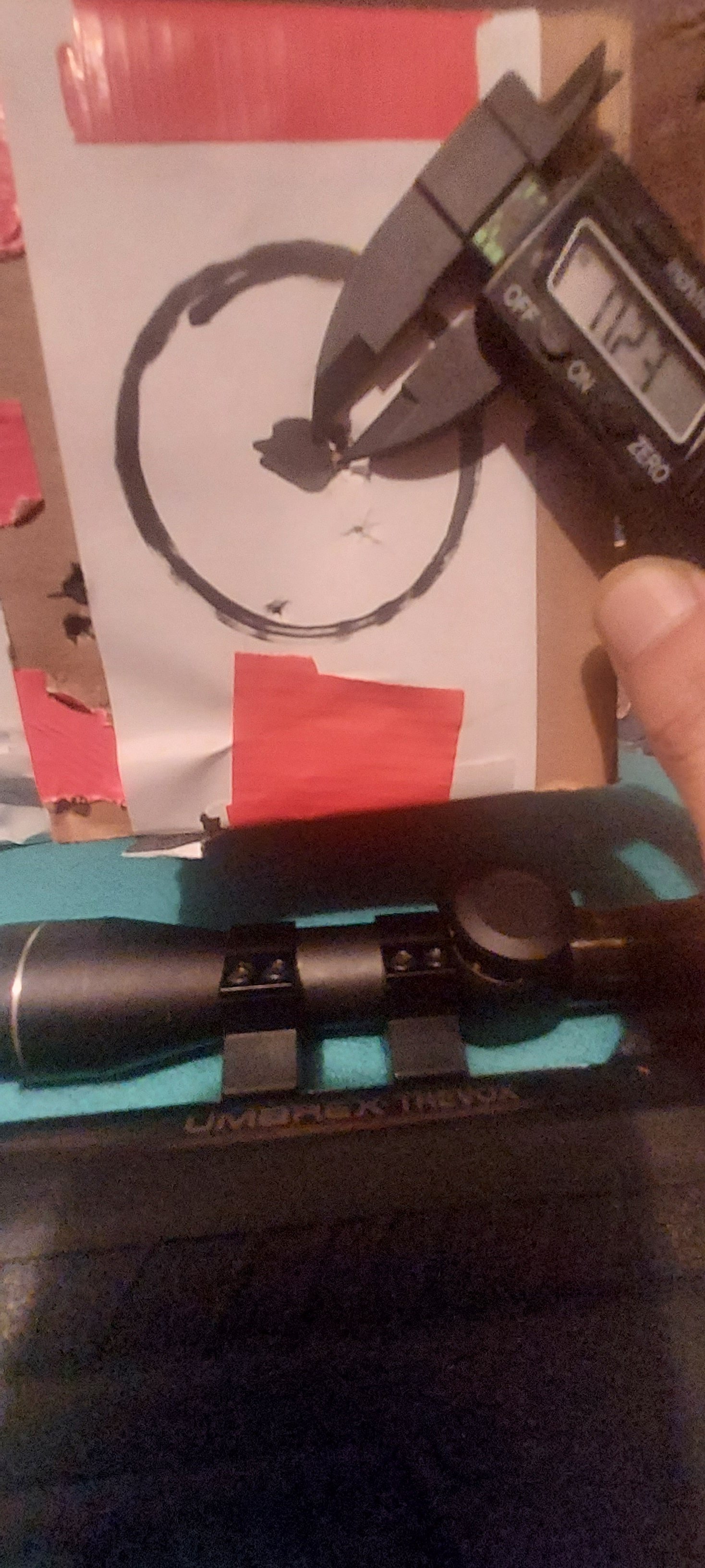

Right now she is setup with an NcStar pistol scope, zerod for 15 yards(pistol target format?..anyway). Fixed magnification. So I figure I'd find my holds for closer than 15. Got enough space for aaaalmost 7yrd...so I just scooted forward and made it a sweet 5yrd short shot. Setup my target.
Fired....
Ooof low and left...
Adjust a bit on turrets...
Ready again and fire..
Hmm...ok left and right are good...aaaand I think I got .y holdover...
Ready.
Aim just over half way on bottom post of reticle.
Fire!👀
Not bad...not bad...
Then thought...
I'll leave it there and...
Sling a group!!🤗
Wow!!
That's ten shots in that spot🤯😱
Oh I fear for any tiny pest within 20yrd that gets in my way when I'm toting this thing around😎🤙

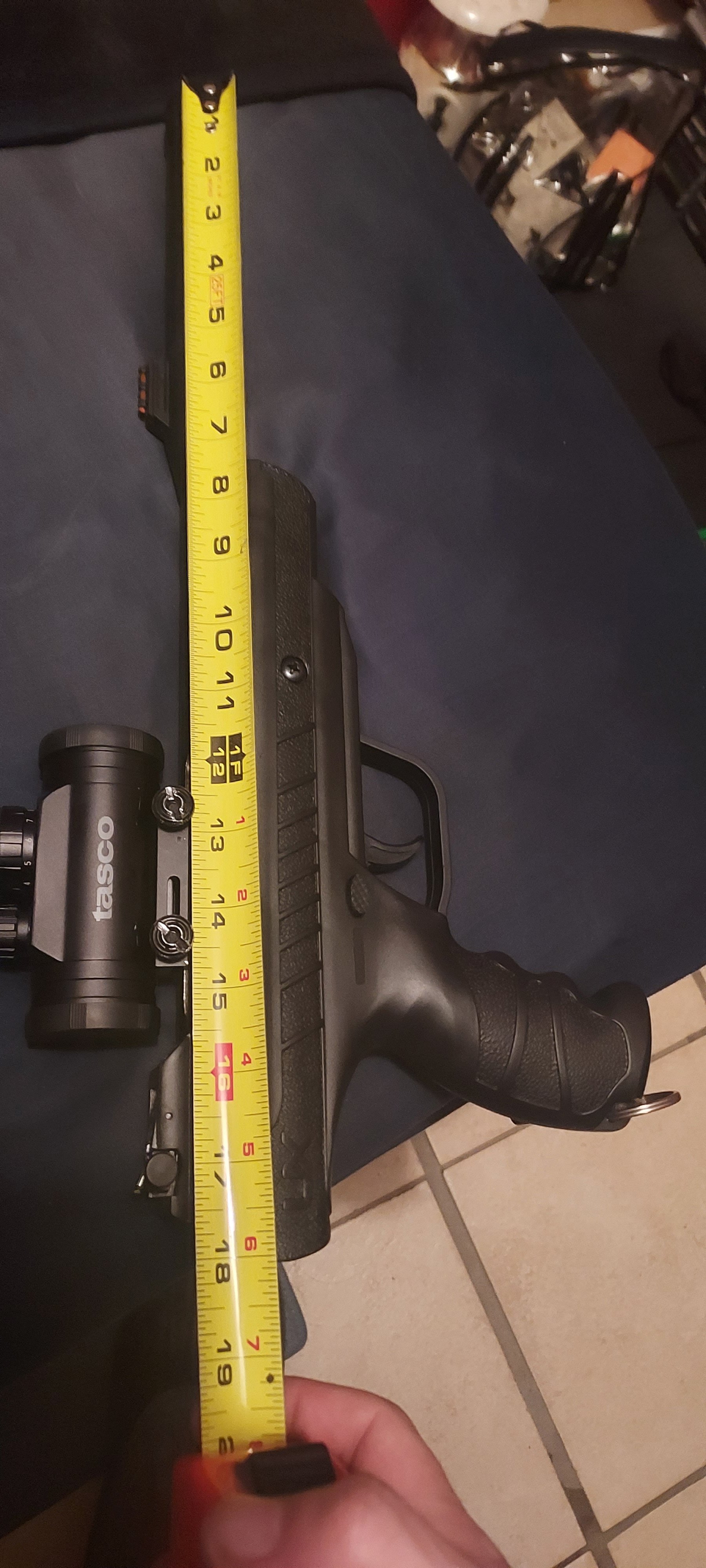

does it say where it is made
and yes, it is a big and heavy pistol, like the Hatsan and the Browning 800
trigger number look a little heavy on paper but it appears to shoot okay
