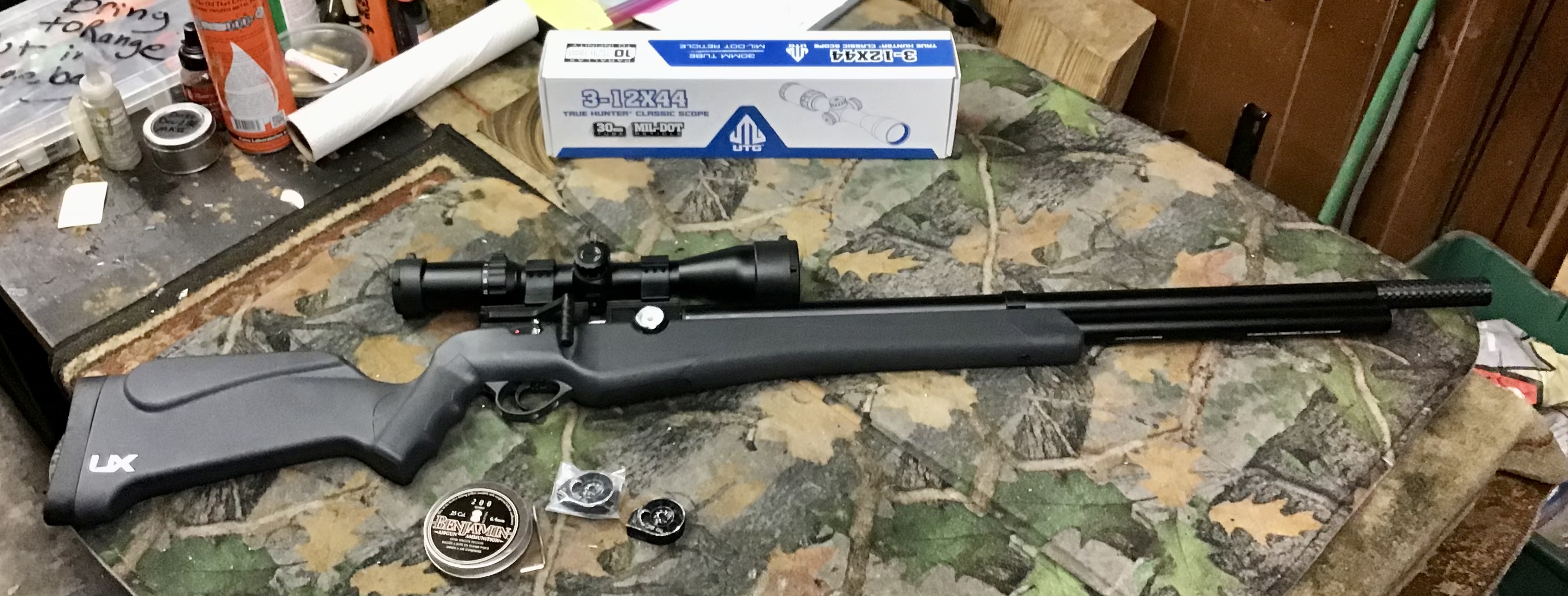

On Monday Umarex had the .25 on sale for 283.00. Could not stand it and ordered one.This is my first .25 air rifle, hoping my Standard Airacuda in .25 gets here next month to join it. I’ve owned a Origin .22 for nearly two years and really like it. The barrel was filthy as expected got it clean , two .22 patches stacked on my weed eater pull through for .22’s worked. It came empty, charged it to 3200 and fired one shot as received with the hammer spring at 1.5 turns from tight. With the factory “baffle” it is LOUD. Just checked my Mail and my Buckrail Moderator just came. Tomorrow morning I will mount a scope and the moderator and play a little.My best tune for the .22 is at 3000 to 2000 PSI so I will with that..

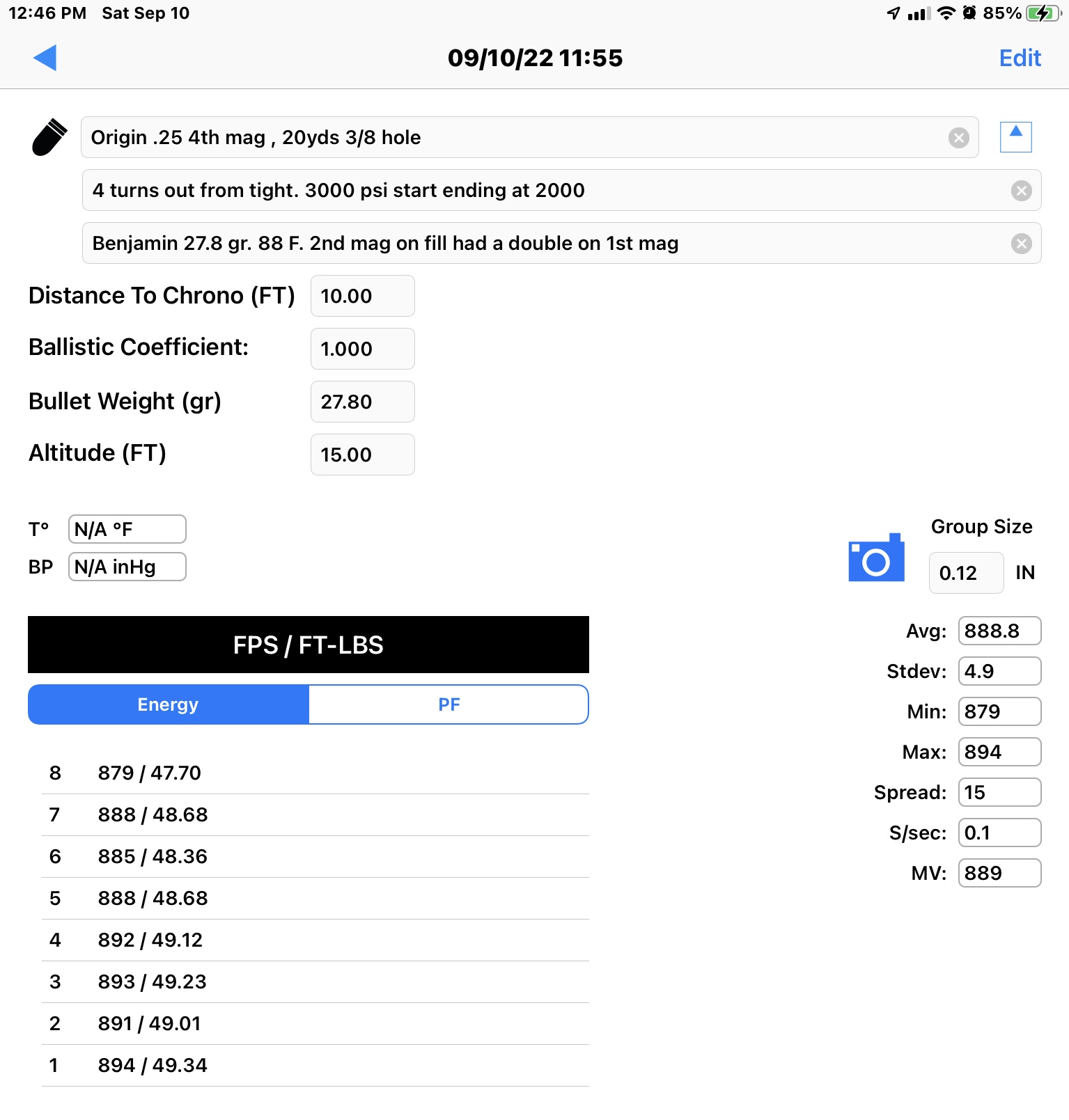

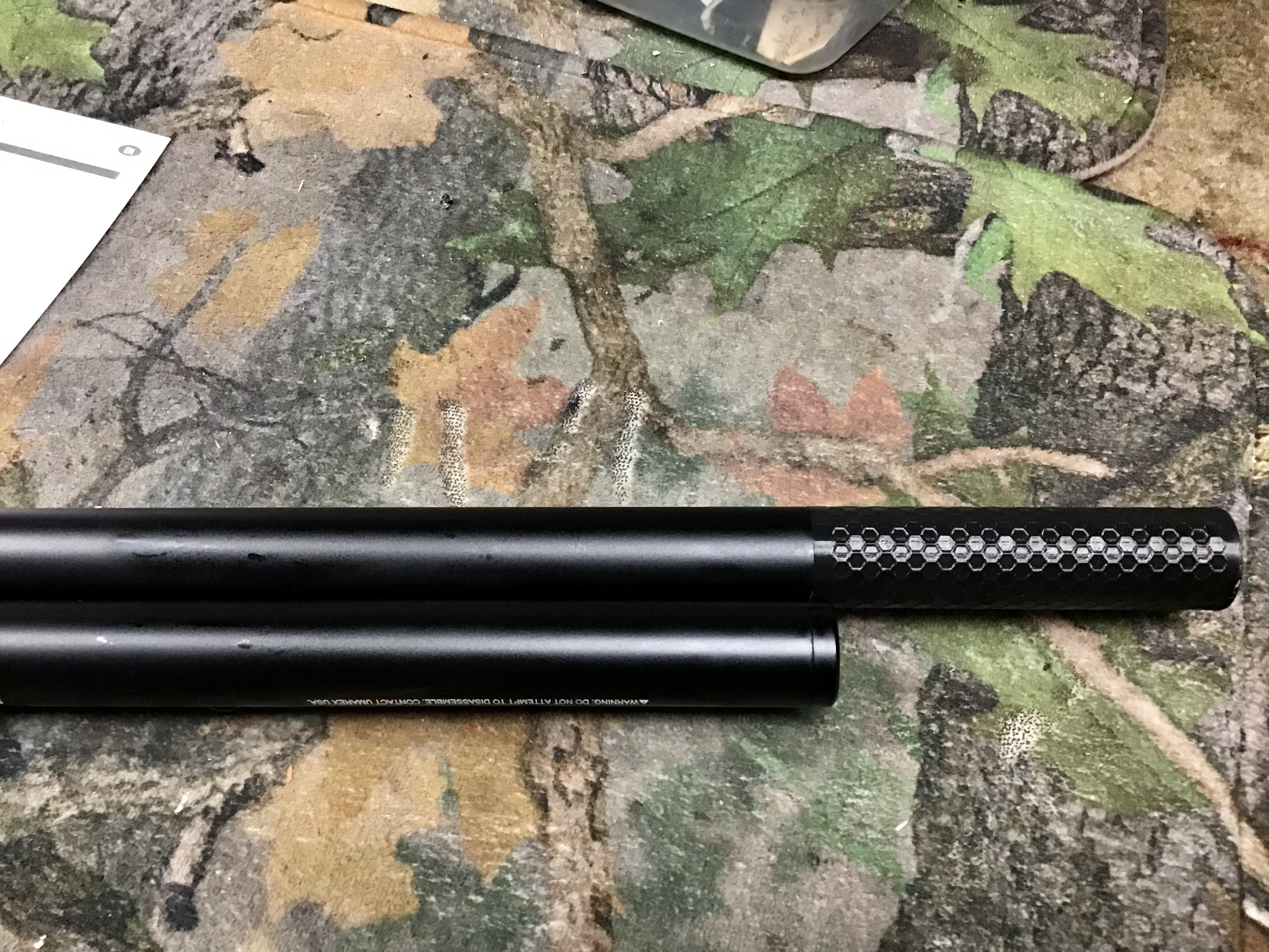

Four turns out from tight on the striker spring is the sweet spot on mine. First mag on this setting I had a unbelievable string going consistently wise then double clutched a cycle(chambered two). The image is of the second mag string. I am very pleased. It worked out to 16 shots 3000-2000 PSI and it should only get better. At this setting the Buckrail moderator does an excellent job for backyard quiet. The buck rail moderator threads into shroud as the factory baffle insert does and has baffles inside and outside of the shroud.
