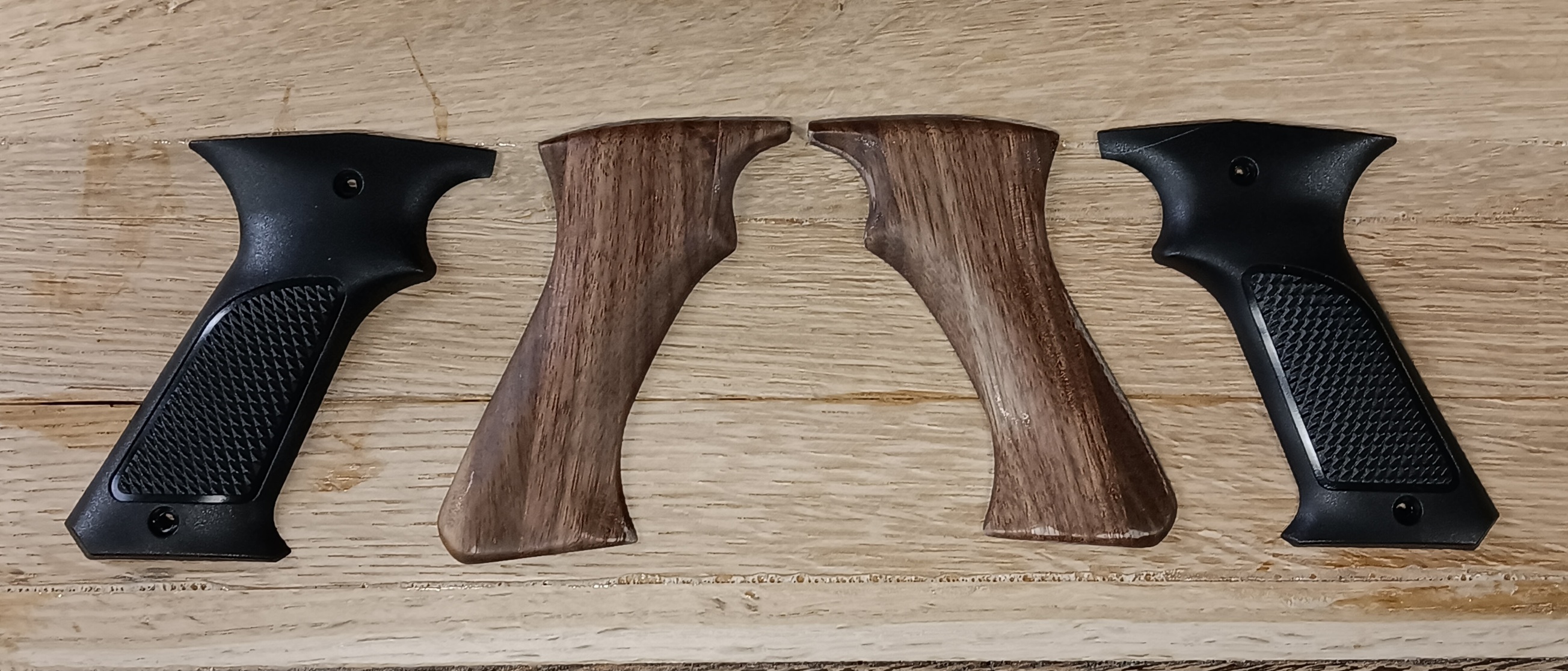

I'm just waiting until I have the cocking handles finished before I get back to the pistol. I got two sets of grips in the mail today and have a few sets of black walnut grips patterned out.

id be interested in a 12" one.. I could do everything myself except for shortening the air tube because I don't feel comfortable working the air tube, so if I could even buy it from you with just the air tube shortened I can do the rest, as I would want the factory open sights on the picatinny rail and 12" overall with a bushing in the end with internal 1/2x 20 internal threads for a adapter for a moderator but keeping it as short as possible.. another thought is shorten the barrel more and 3 d print a moderator to fit inside the picatinny rail/ shroud..
also wondering if you have ideas to make the pistol grip smaller as it's big for my hand?
