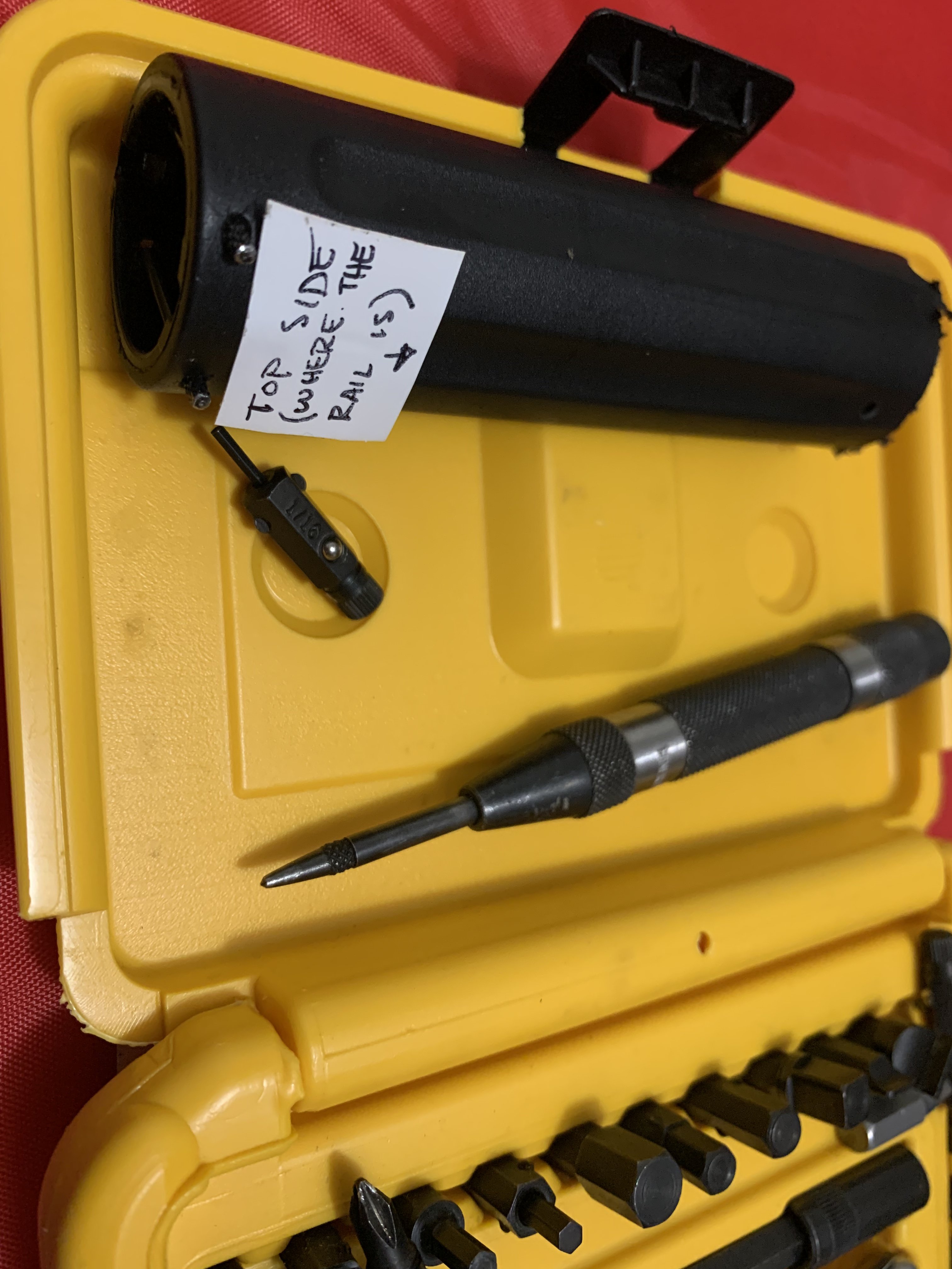

It’s held on to the barrel by 2 clips that are molded into the plastic of the mod. You would need to carefully cut it off to remove. If you wanted a mod after that, you would need to buy an adapter from donnyfl that fits the barrel and clamps down on it to give you 1/2-20unf threads for you choice of mod. OR, send it off the @Firewalker and he rethreads the barrel for you, and also addresses the crown to make it useable with a moderator without the adapter. More like the pp750 sister.
the pins insert from the top to bottom. the top of the pin is knurled and the plastic from the moderator tube can be slightly over-molded to lock the pin in place. you can use a hobby knife or razor blade to remove any bit up the plastic above and around the pin to give it clearance to back out.
that’s a 1/16 hex bit to push or tap out the pins. tap from the bottom (non-knurled) of the pins. you can also use an automatic center punch to back out the pins.

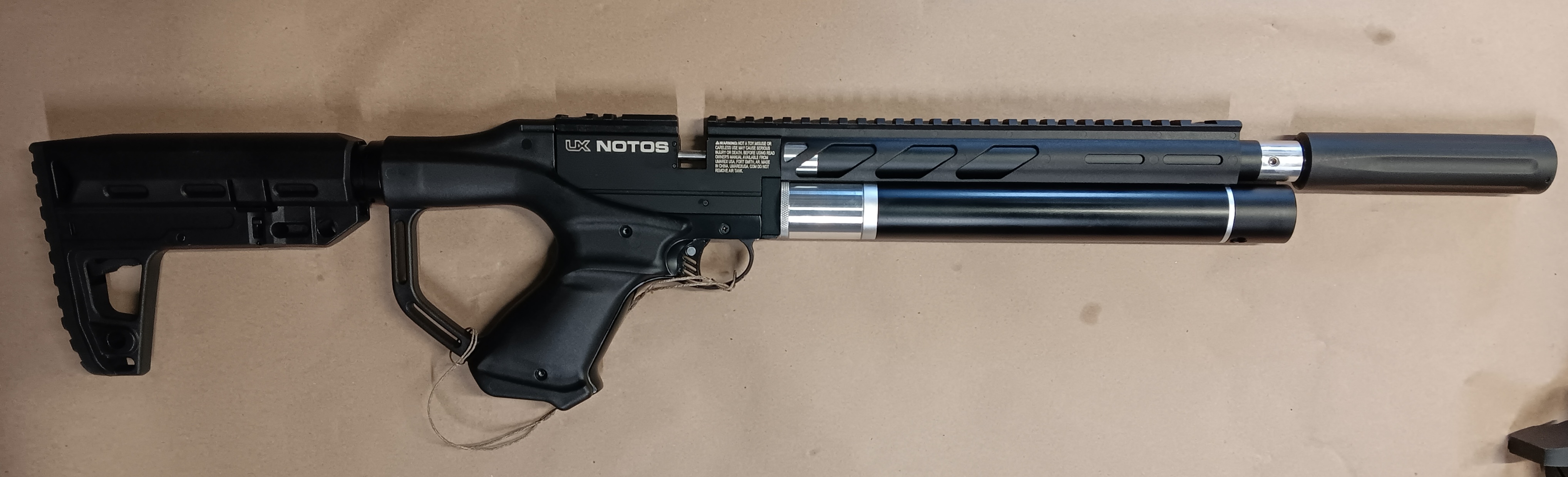

I just ordered a Notos & am considering that plenum kit from Ebay since I already have the stock M3 moderator i'm no longer using.

Yes. The Notos needs a mod without it it is loud. But I was very surprised at how quiet it is from the factory! I just wanted to do the plenum and that requires you to remove the oem moderator and then the plenum kit has a threaded end cap/shroud retainer and then you screw on a moderator. I currently have the Buck Rail non tapered on mine and it works well. If I shoot without it... neighbors definitely know. Like a .22 LR going off.

Yes I did. The claims of the plenum manufacturer are accurate I did increase shot count and FPS I did 28 shots on reg before (Out of box Notos set to ~1900 psi ) I think I got up to 36 after plenum but right after I did increase hammer spring so I gained FPS over shots/fill but you can tune either way obviously. Still easily get 24 shots / fill at ~20 fpe now

How did you get the oem ldc off clean enough to reuse it?
I chuck up the barrel in the lathe and use a carbide insert for aluminum, measure 5.5" back from the front of the moderator and make passes until I hit the 2 clips, I then just break the last few thousandths of plastic off and put the saved housing aside.
I then change tooling and use an insert for hardened steel and cut the clips off, clean up the barrel end, rtc.
Remove the barrel and chuck up the front of the moderator and face the back I cut off, shape it as needed and drill it out with a 29/64" drill bit, blow it out, chuck up a 1/2"-20 UNF tap and run her in!
