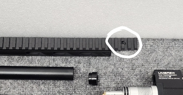

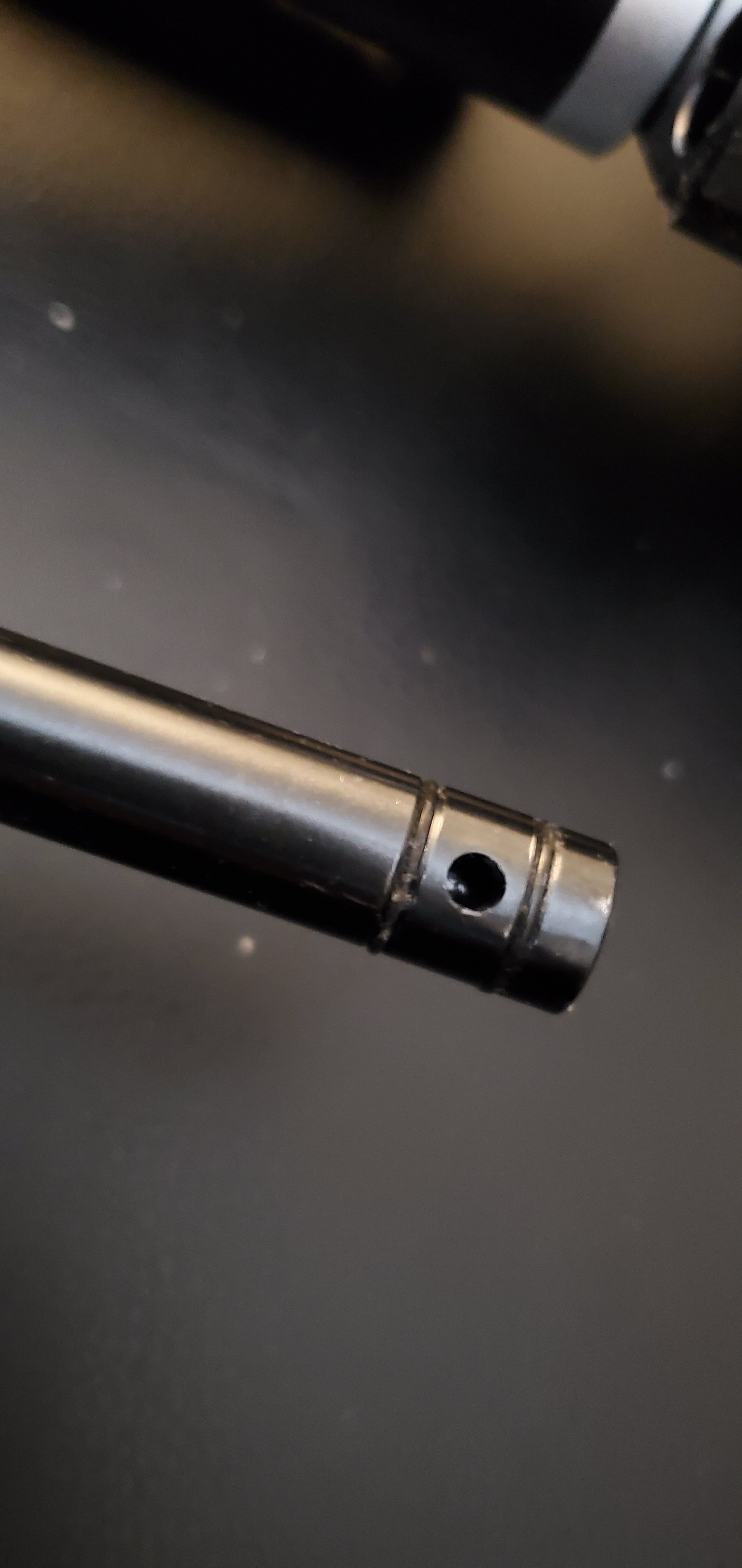

Awesome thank you boomstrike for the info!! I did take off the barrel, you’ll need a 2 mm Allen key!
Wait so there is only bolt and it's the bolt that also holds the picatinny rail on?
This one? Maybe I did not pull hard enough?
Allen
There is the bolt that holds on the pic rail then a 2 mm grub screw under it that holds the barrel.
OMG! Here I was looking for another hole and grub screw! Same hole! And I even looked as hard as I could in there the first time! 🤪
Boy this is a funky way of doing it. Those o-rings are so thin!
PLEASE NOTE: the barrel is not keyed in any way and the set scew is full of locktite. Mark for ease of reassembly and use heat as necessary for removal to prevent rounding of set screw.

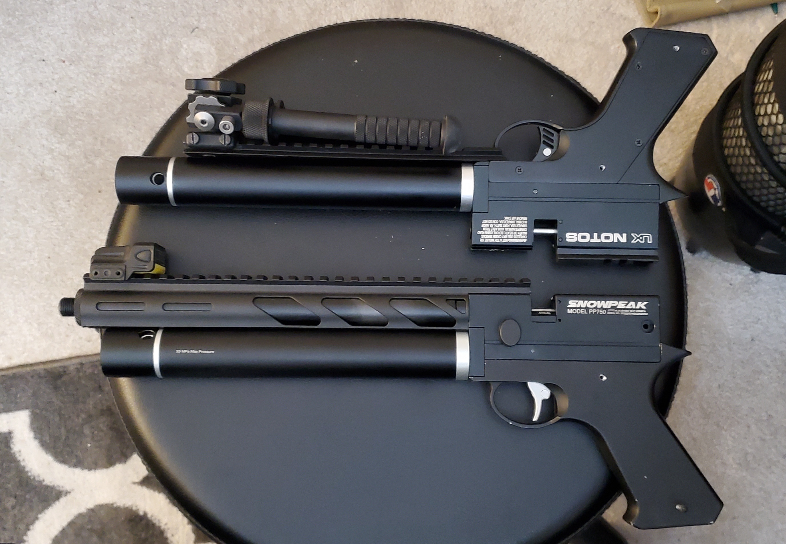

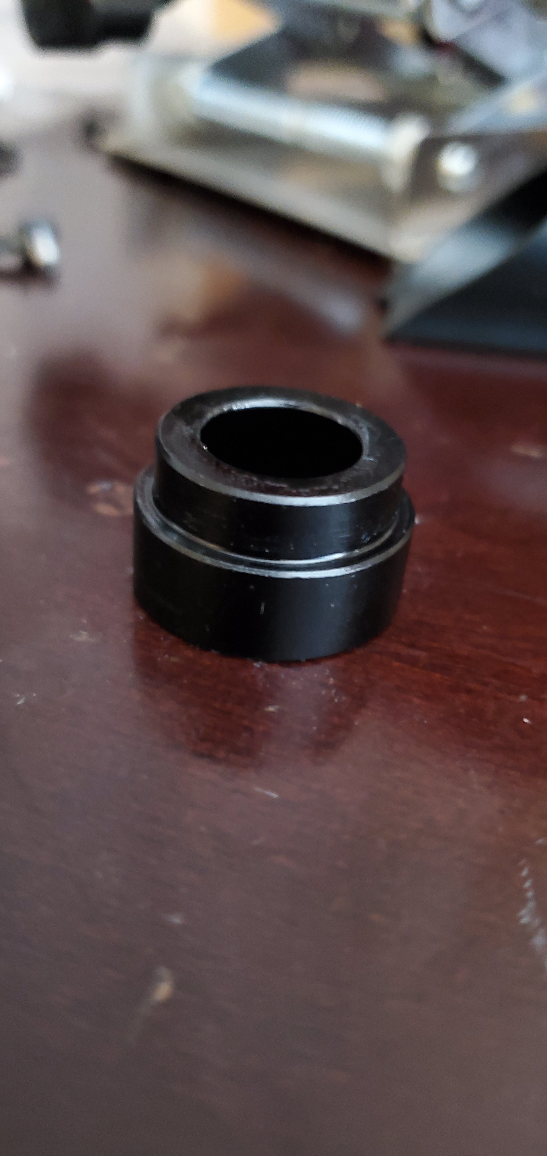

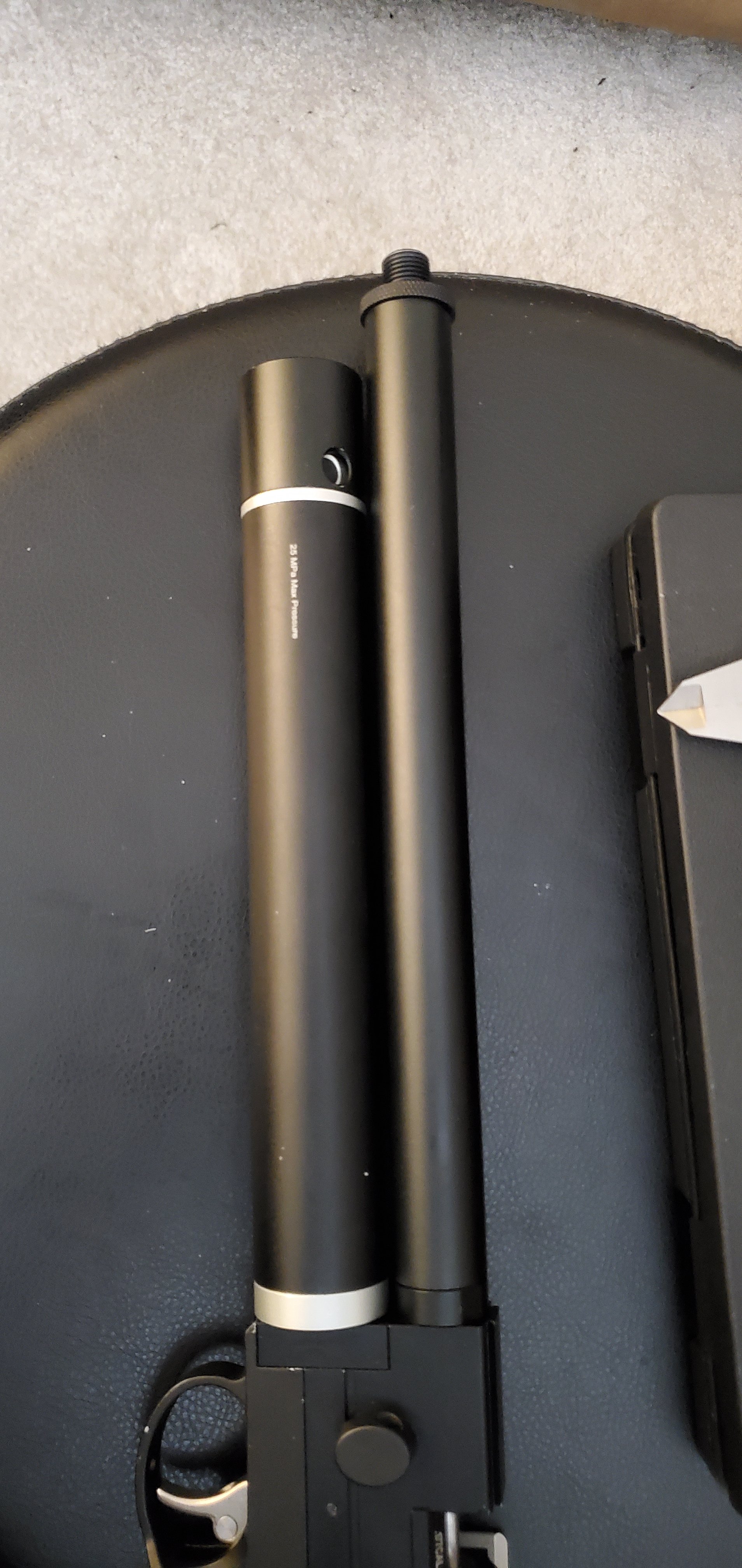

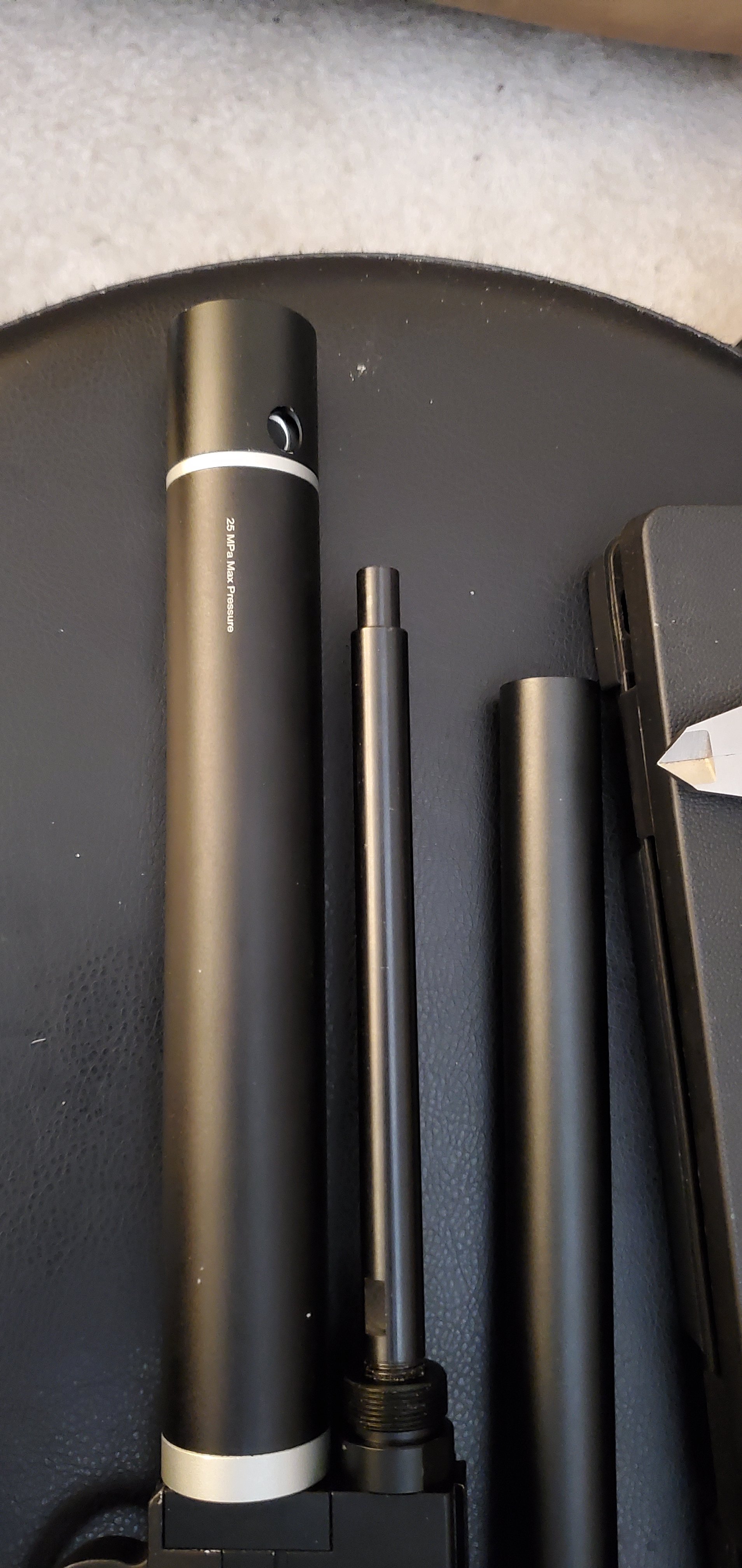

Oh wow, duh, so. This is the length of the .177 barrel...
This is the shroud on.
The moderator adaptor threads onto the shroud not the barrel.

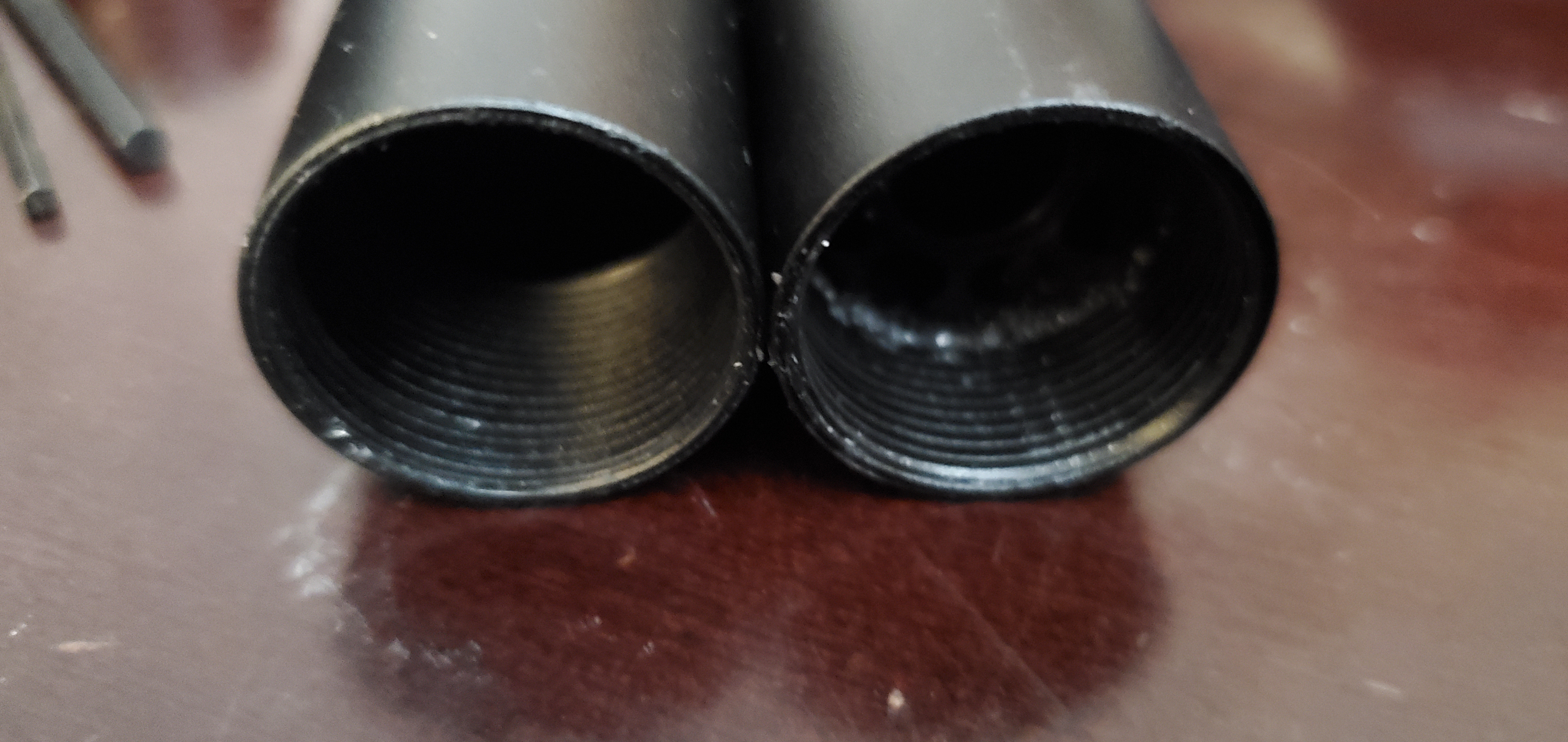

There is a centering cone inside the .177 shroud. But the problem is the base of the Notos is a bushing not threaded.
Which is funny because the Notos shroud is threaded AND will swap out with the pp750! 🤪

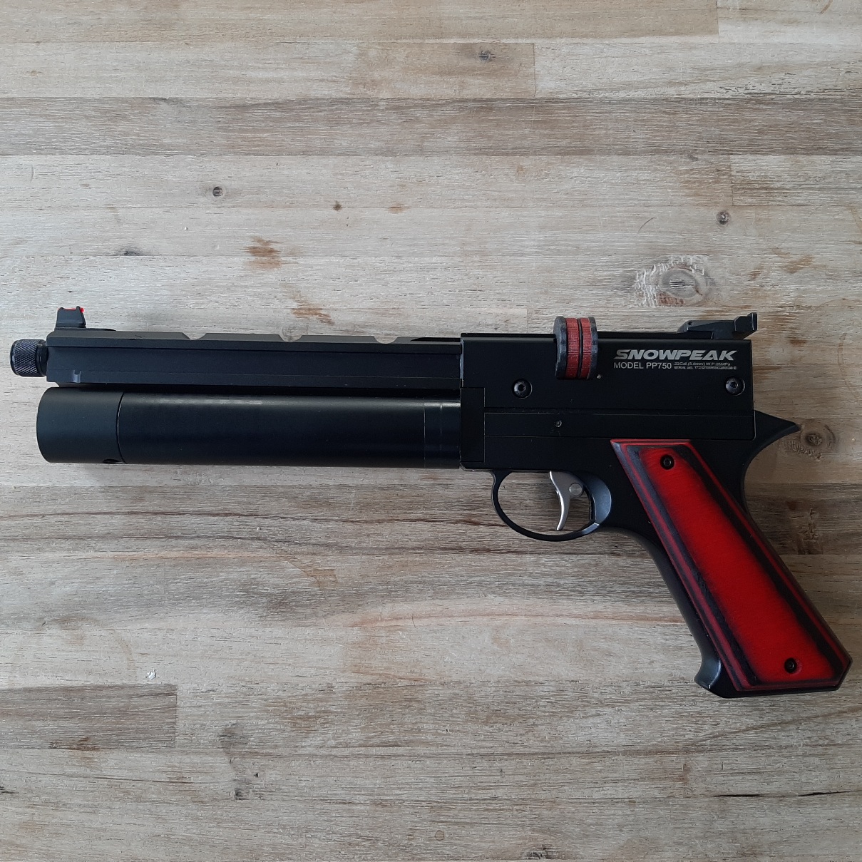

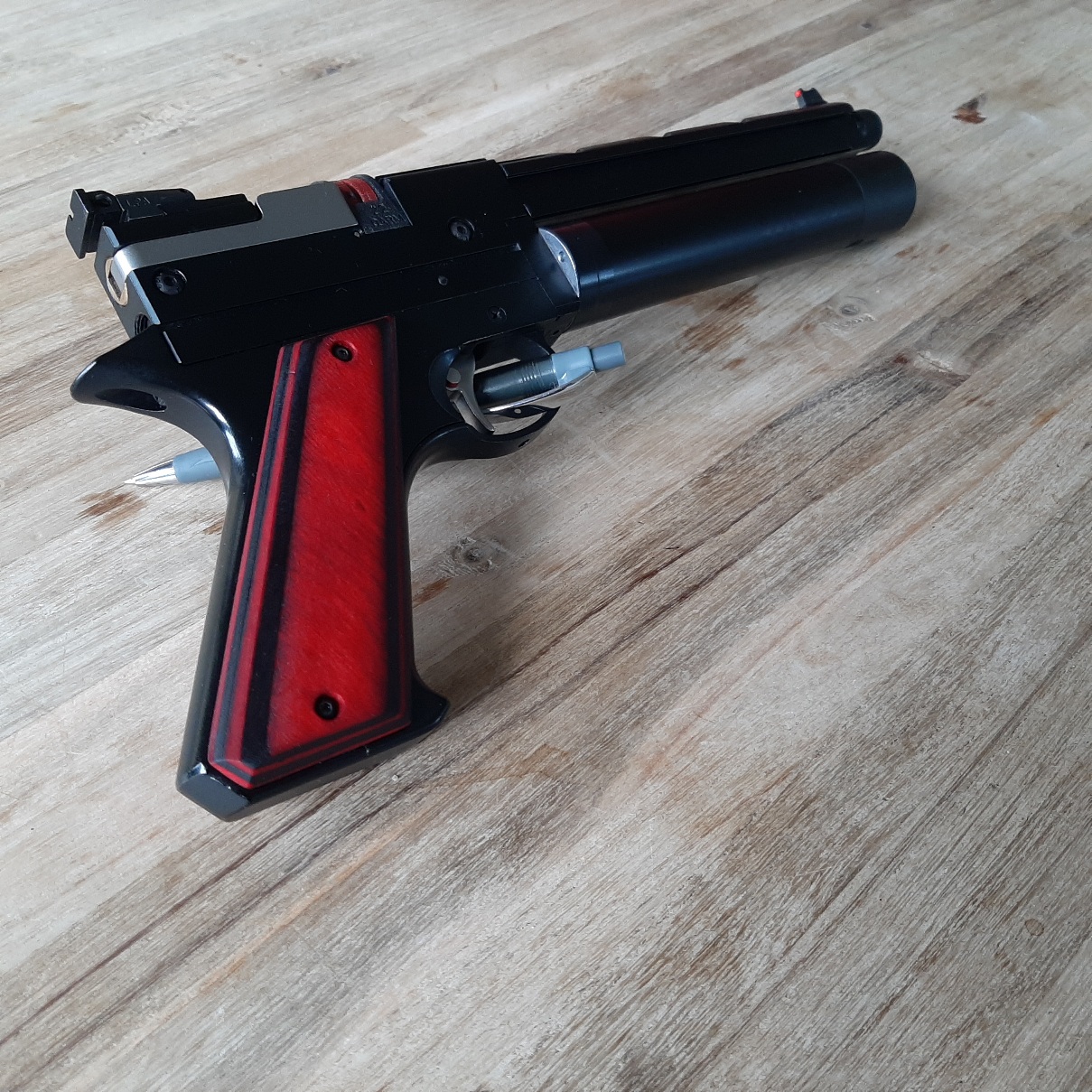

Hi
This is mine converted PP750. It is shortened by 5CM and has the shroud of a PP700SA.
The open sights are from LPA and are fully ajustable.
Carm magazine and home made laminate grips.
Does make 26,5 Joules with H&N Baracuda .22, Total of 12 shots.View attachment 326130View attachment 326131

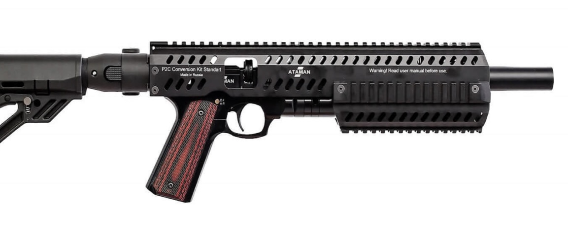

I hope someone is going to capitalize on these shortcomings and offer some nice upgrade parts for the Notos. I’d definitely be in to buy an aluminum top rail/ quad rail similar to what they make for the ataman pistols… and a threaded barrel with front and rear bushings.

I have a PP750 on the backyard duty, and one thing I hate about is the wire stock. A PP750 with a Notos stock would be perfect, lol.

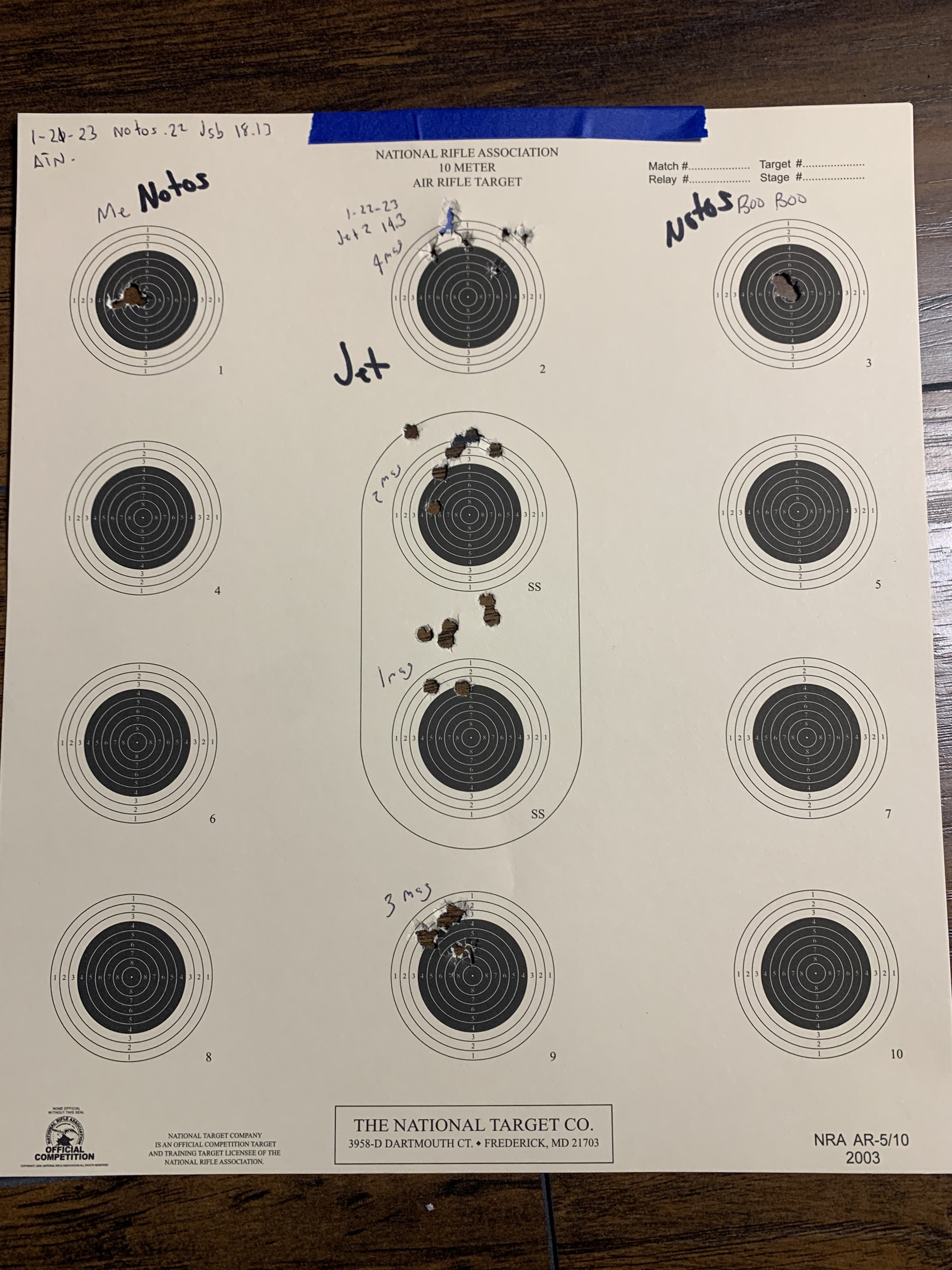

I can tell you guys the fit and finish is real good for $260 bucks, I’m gonna do some porting and hopefully Wes from air gun archery I think it is will have the plenums soon back in stock great budget gun. I have the jet 2 it is nice but my accuracy is horrible I’ve tried everything it seems hit and miss on that one. Some love it and some get shot gun groups like me.
