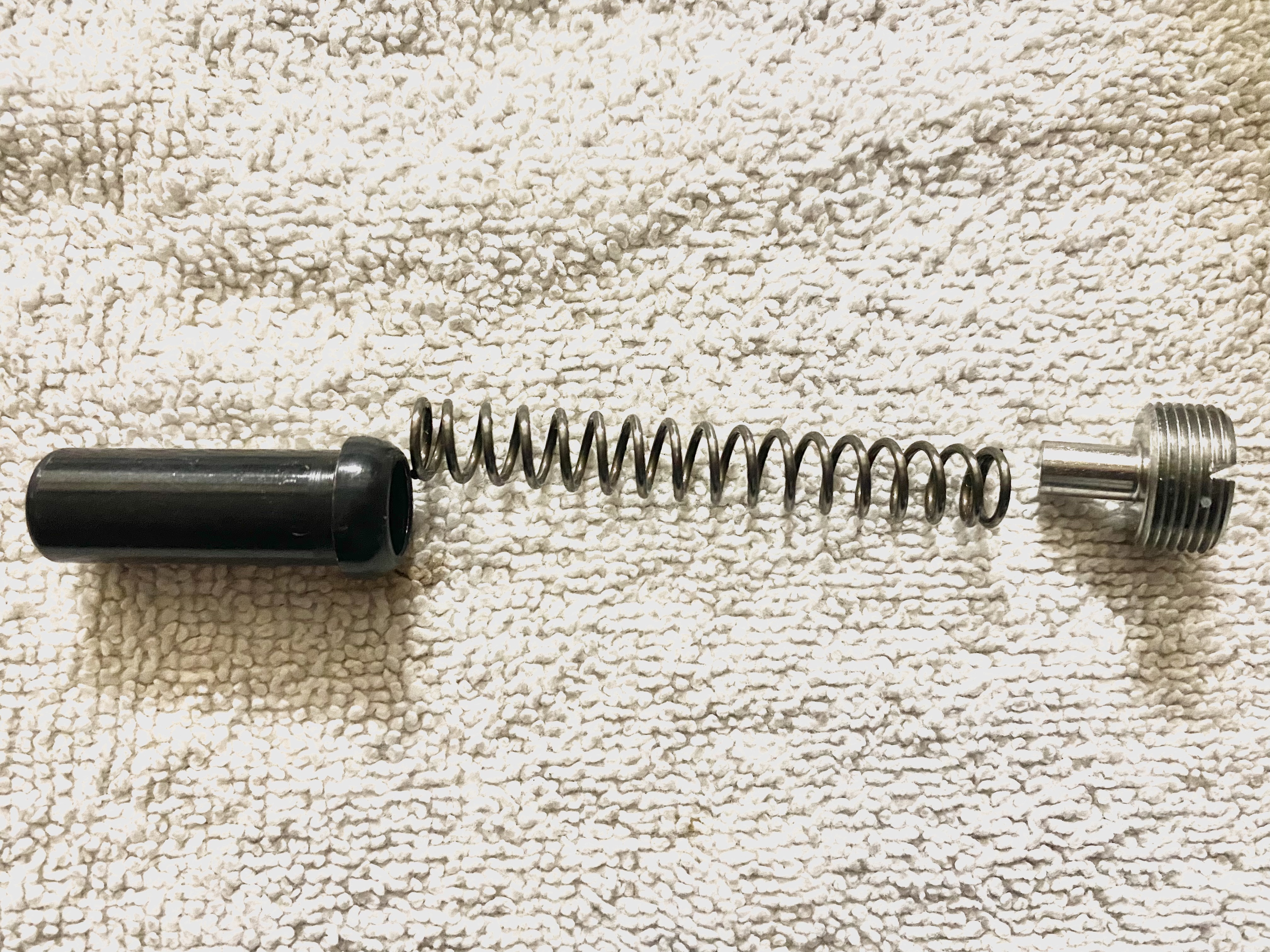

Took the hammer spring and striker out today to see what it looked like inside. It was pretty clean but I wiped everything down with a silicone rag anyway. Played with hammer spring tension and found that it’s best set at about 3/4 of a turn back from full tension. No more fps is gained and it’s wasting air and making more noise.
View attachment 321175View attachment 321176I used my ears and my FX chronograph to get back to the perfect spot it started out at, but I think a person could pretty much set it without a chronograph just by listening to the shot noise. Set it to full and take a shot, decrease tension some more and take another shot, when you hit the sweet spot there’s practically no noise. Just a muted CHUFF sound.
