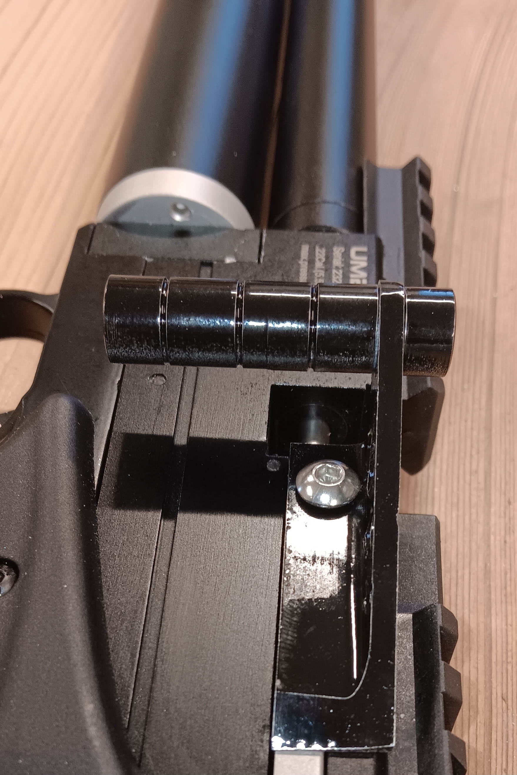

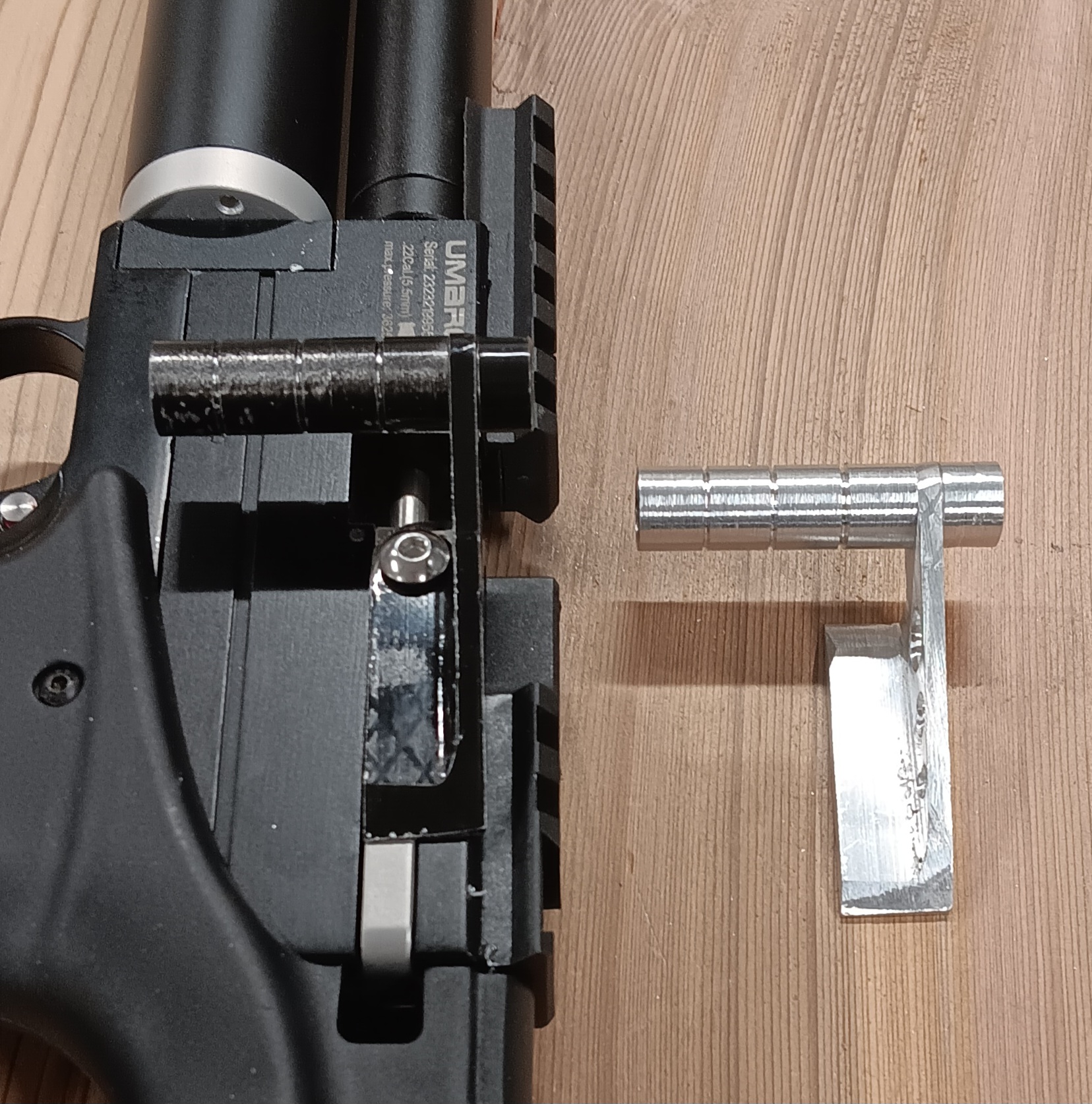

I followed what Kevin did:

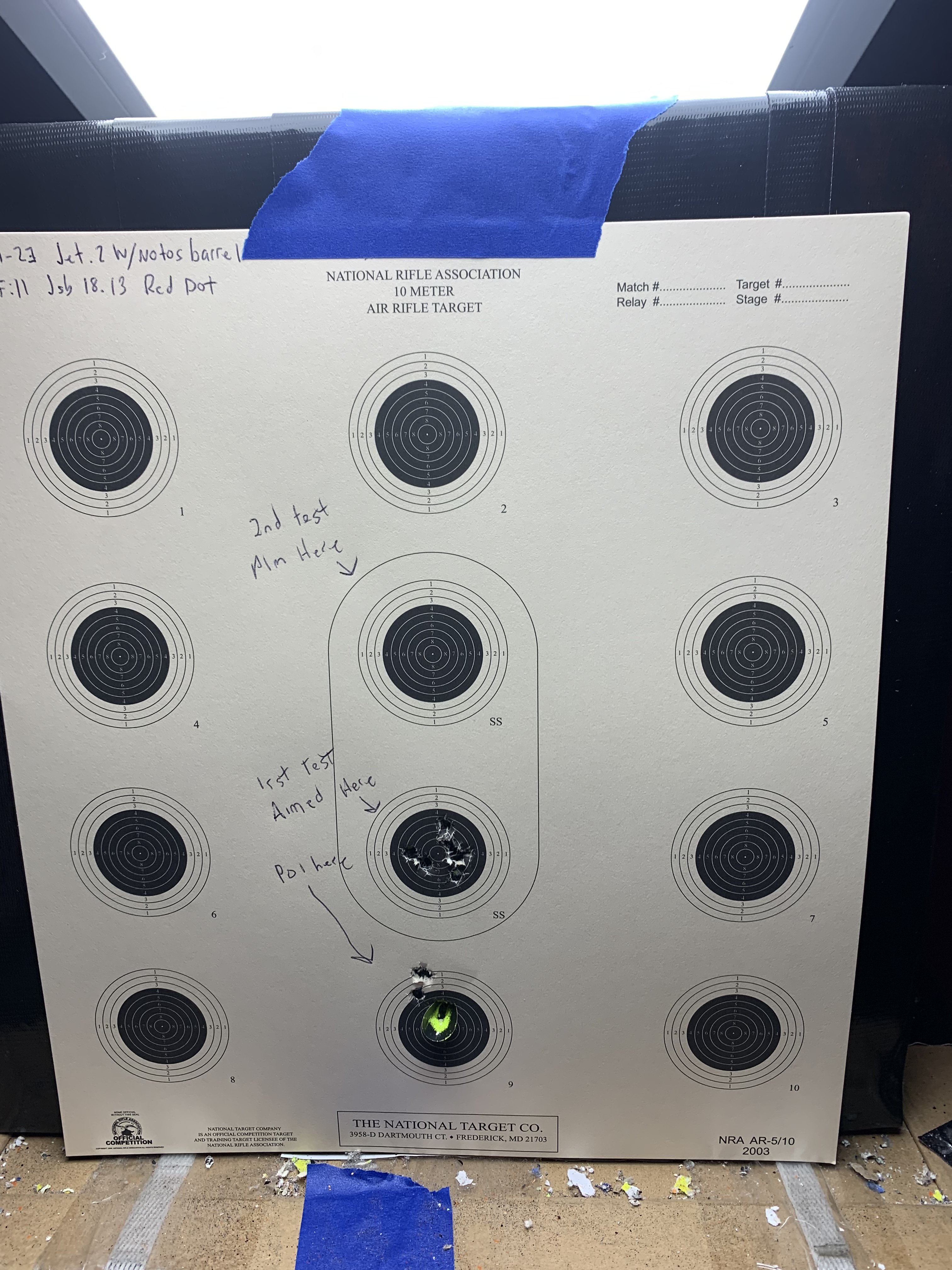

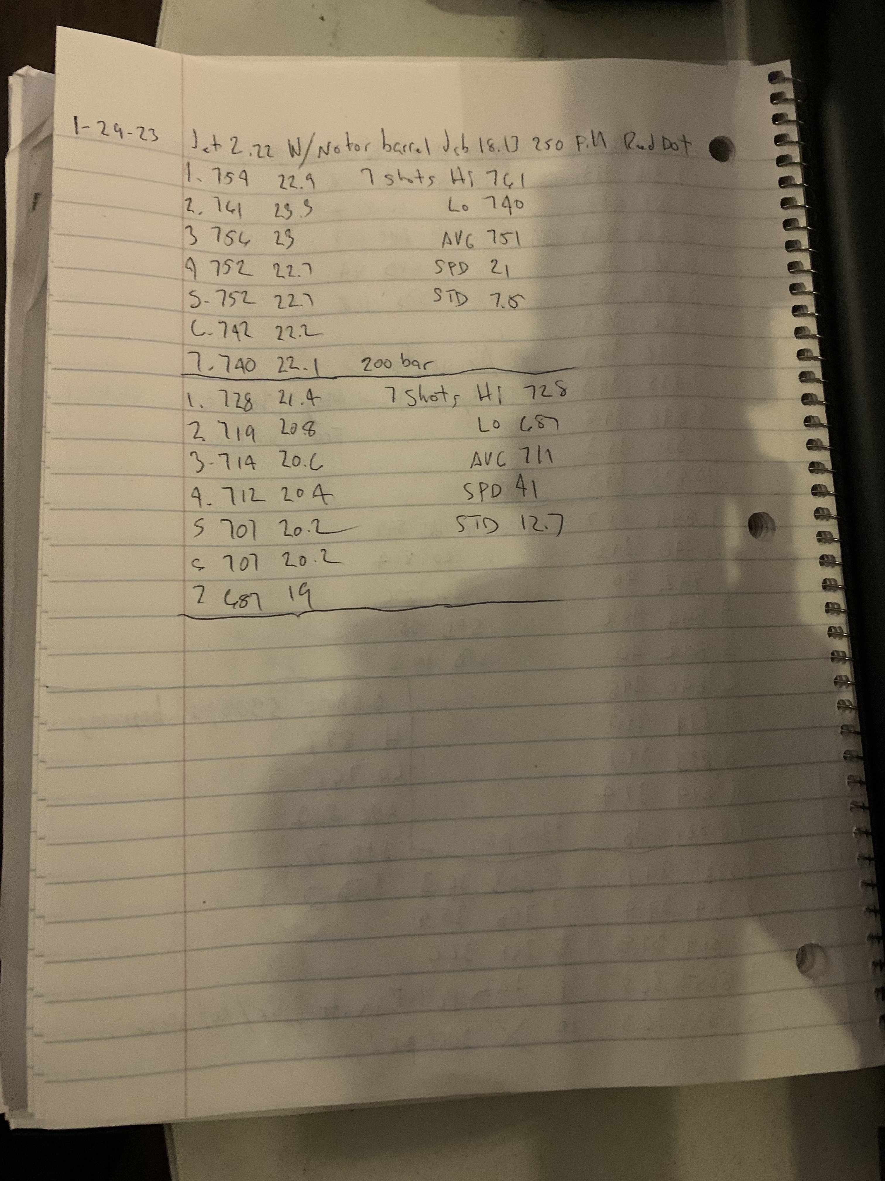

Well for S and Gs I put the notos barrel on the jet 2. Whoa!!!! I tested 2 mags with jsb 18.13 with a cheap red dot i hate red dots since I need magnification but I think I’m gonna get another notos just to be a notos and leave the barrel on the jet 2. It appears the barrel I got was bad!! Form hatsan. I need to re test with a better scope.
Does the barrel tranfer easily? Or is it more than just taking it off and attaching it to the jet?
