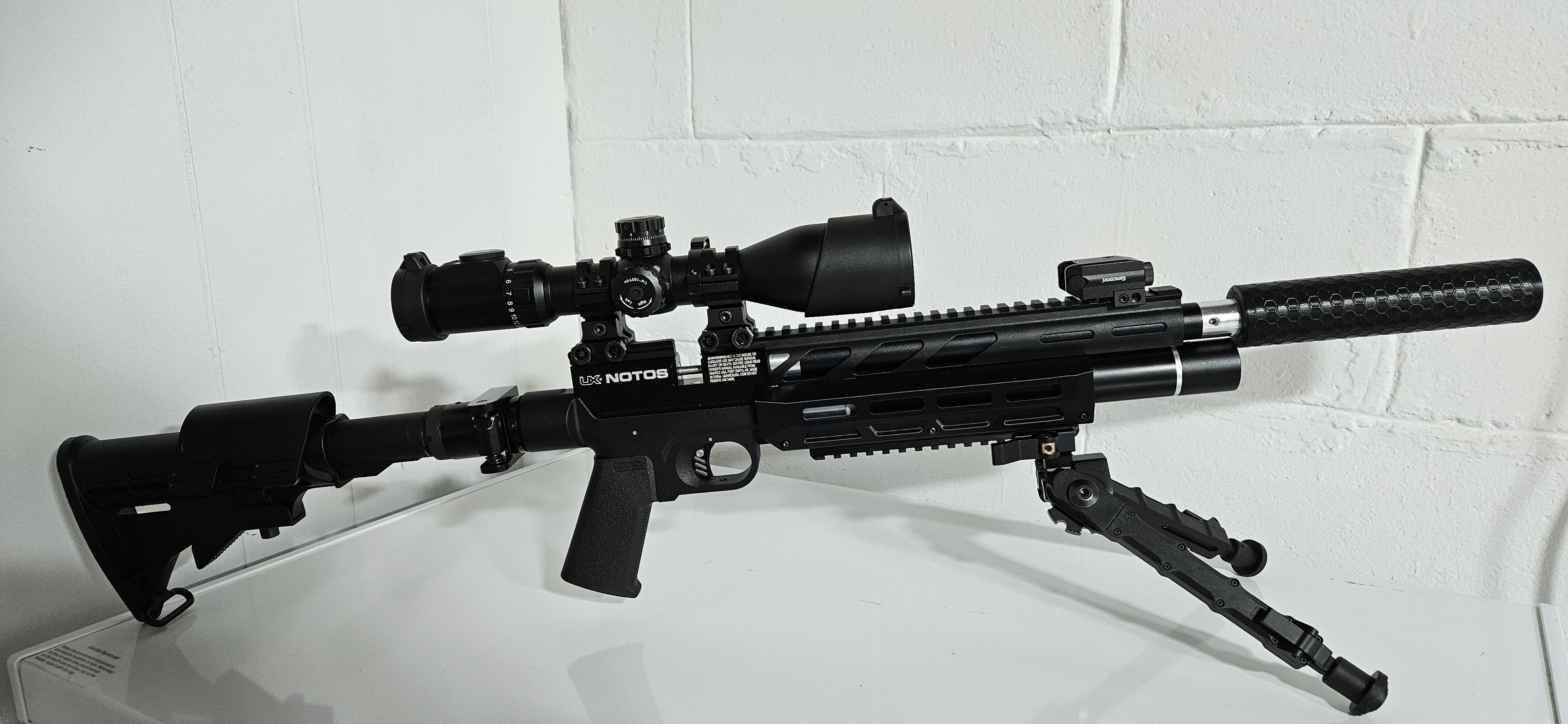

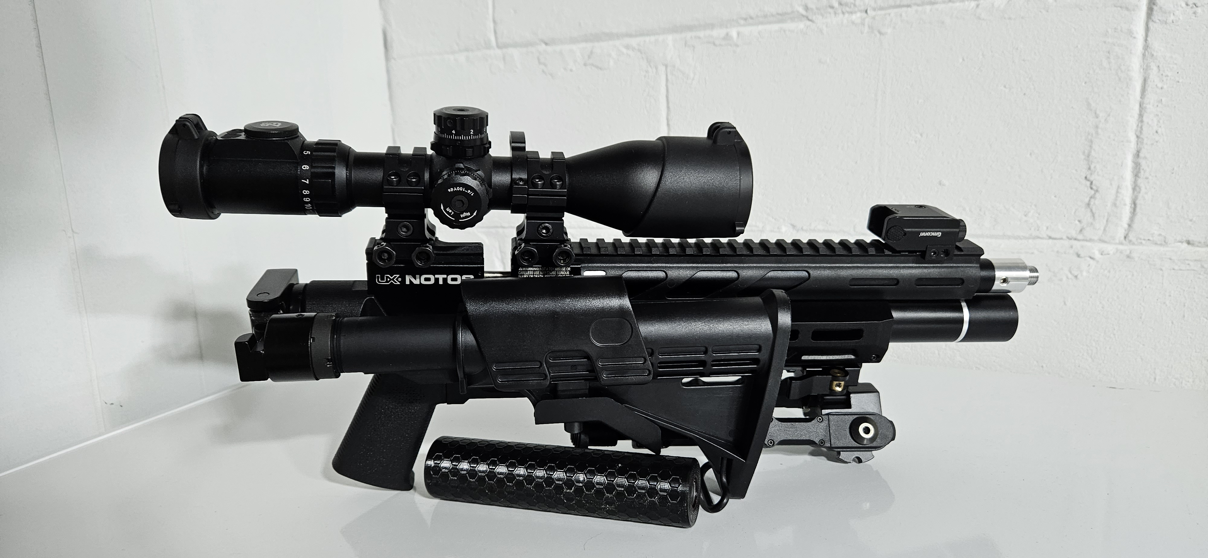

Review of Full Notos Kit.
The folding adapter OD thread height was shorter than the normal buffer tube threads (or they weren't deep enough/notos receiver ID slightly bigger?) so it was not as tight as I would like. Tried Teflon tape to tighten up tolerances but obviously that made it more slick and either way I couldn't get the lock ring to tighten without the adapter jumping threads in the printed receiver making it crooked. Also the folder has a hole when folded and probably would need enlarged in order to access the hammer spring adjuster screw when folded, you could get a long 1/4 driver through maybe.
I made it fold right since notos cocks on left so it can be folded and use my laser and shoot as a big pistol. Probably would work well if it were tighter threads.
All that had me take off the folder but with normal solid buffer it is great, very solid! (Sorry no photo). No folder does shorten it enough that buck rail is right in that you'd want the 308 tube, I just ordered a butt pad to get more LOP coming tomorrow.
Also my hand guard was a little loose like side to side play but I do have the plenum kit installed so maybe something with that caused the fit difference. I put some grip tape stuff in between and it's better. No issue with installing his mlok picatinny rail, the longest one he offers on bottom. I do like the handguard for my big hands it fills it better plus the benefit of the rail for a bipod.
With big hands I am really not a fan of the k grip that came with the kit. It will work but it's short and skinny. I like the more vertical angle than oem though. Obviously you can put whatever grip on you want. Just reviewing as is.
Downside is the buffer tube screws in right over where HS screw is so not accessible with tube on and then there are 2 screws that hold on the printed receiver and one of them is also in there by the hs under the buffer. So gonna be hard to adjust stuff with stock on but once all set up it'll be fine.
Overall it makes the notos personalizable especially when buck rail comes out with flat dark earth but best part is the handguard I'd say.

Good idea but once you get your kit you'll see why I can't glue the folding adapter in. One of the two screws that holds the grip adapter/receiver on to the "upper" is under the part I would be gluing. You could never get it off meaning you could never get the trigger group out or the hammer / spring out.
Or adjust the hammer spring (unless you enlarge the hole I guess)
