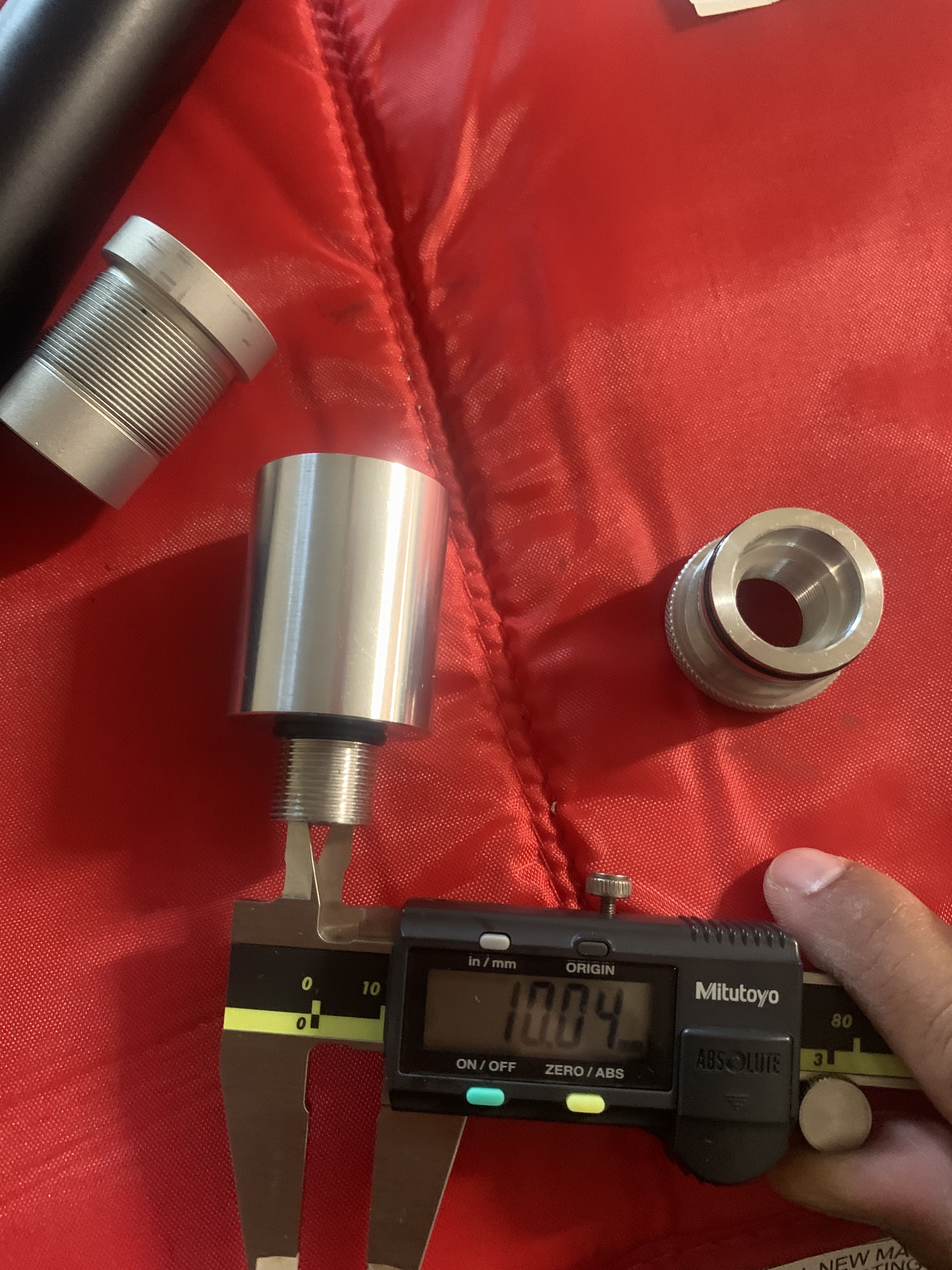

That plenum kit looks very interesting, do you have any concerns about it's integrity to hold 3600psi?
nope, the machining is superb. thick walls, no wiggle, no burrs, just nice smooth snug fitting long threads. i can post images of dimensions with caliper measurements when i get a chance to empty the air out.
i was short on time so i just took a bunch of pictures. the matte silver is the oem.

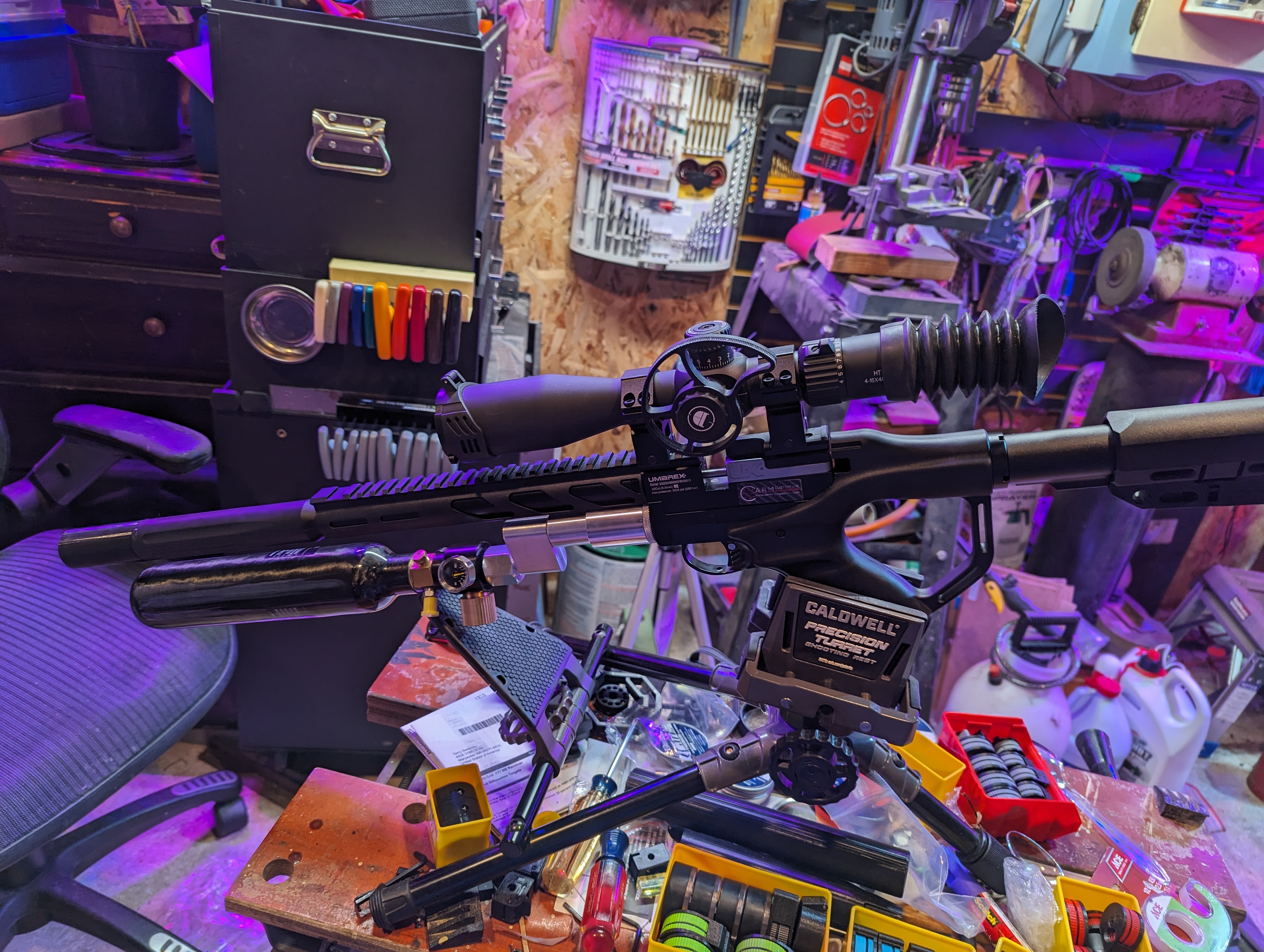

Got the drop block from Froggy's installed plenum then block then 300cc bottle with an adjustable regulator set @ 2000
How does the balance of that feel now? Would assume by the bottle being almost to the muzzle it would be front heavy. But maybe your big scope brings the balance point back.
Bet you can crank that thing to 25 FPE and still get 100+ shots haha

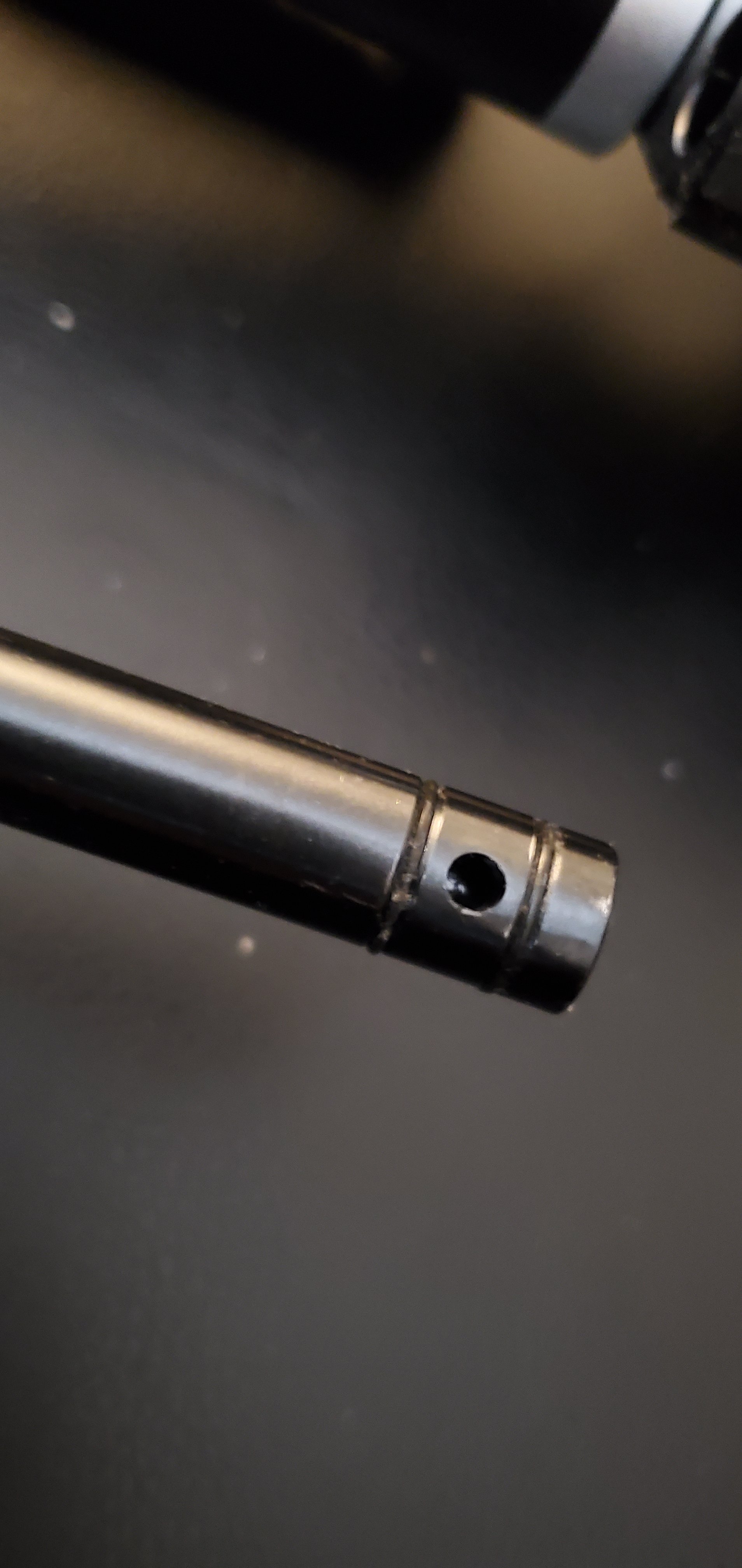

OMG! Here I was looking for another hole and grub screw! Same hole! And I even looked as hard as I could in there the first time! 🤪
Boy this is a funky way of doing it. Those o-rings are so thin!
PLEASE NOTE: the barrel is not keyed in any way and the set scew is full of locktite. Mark for ease of reassembly and use heat as necessary for removal to prevent rounding of set screw.
Allen
What does the end of the barrel that goes into to the receiver look like (i.e. as if looking through the barrel? Is there a seat for the breach/probe o-ring, is it flat, or something else?
If anyone can share a pic that would be awesome too.
NOW, NOW, NOW, I will buy a Notos. I've been waiting for a proper drop block. My 2240 drop block from Froggy's is solid! I'm certain this is too! Thank you sir!!!
