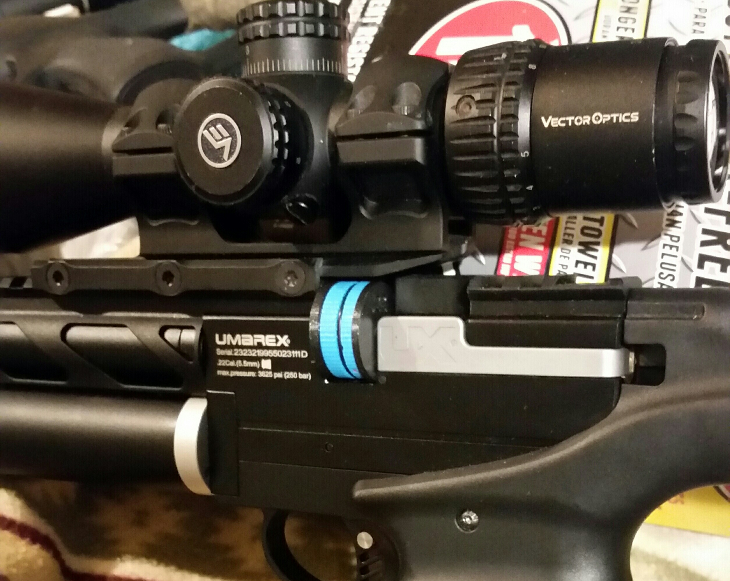

What side are you ordering and why ? Left or right ? With left side lever on NOTOS I would like mag to stick out on right side and on PP750 would like mag to stick out on left side. Which is good for the NOTOS ? Anyone have an image of the differences?
I ordered LH for Notos cause that's the way the OEM one goes in.
the small 6 round mag,,, I had to grind a little off the clamp bar for the mount
