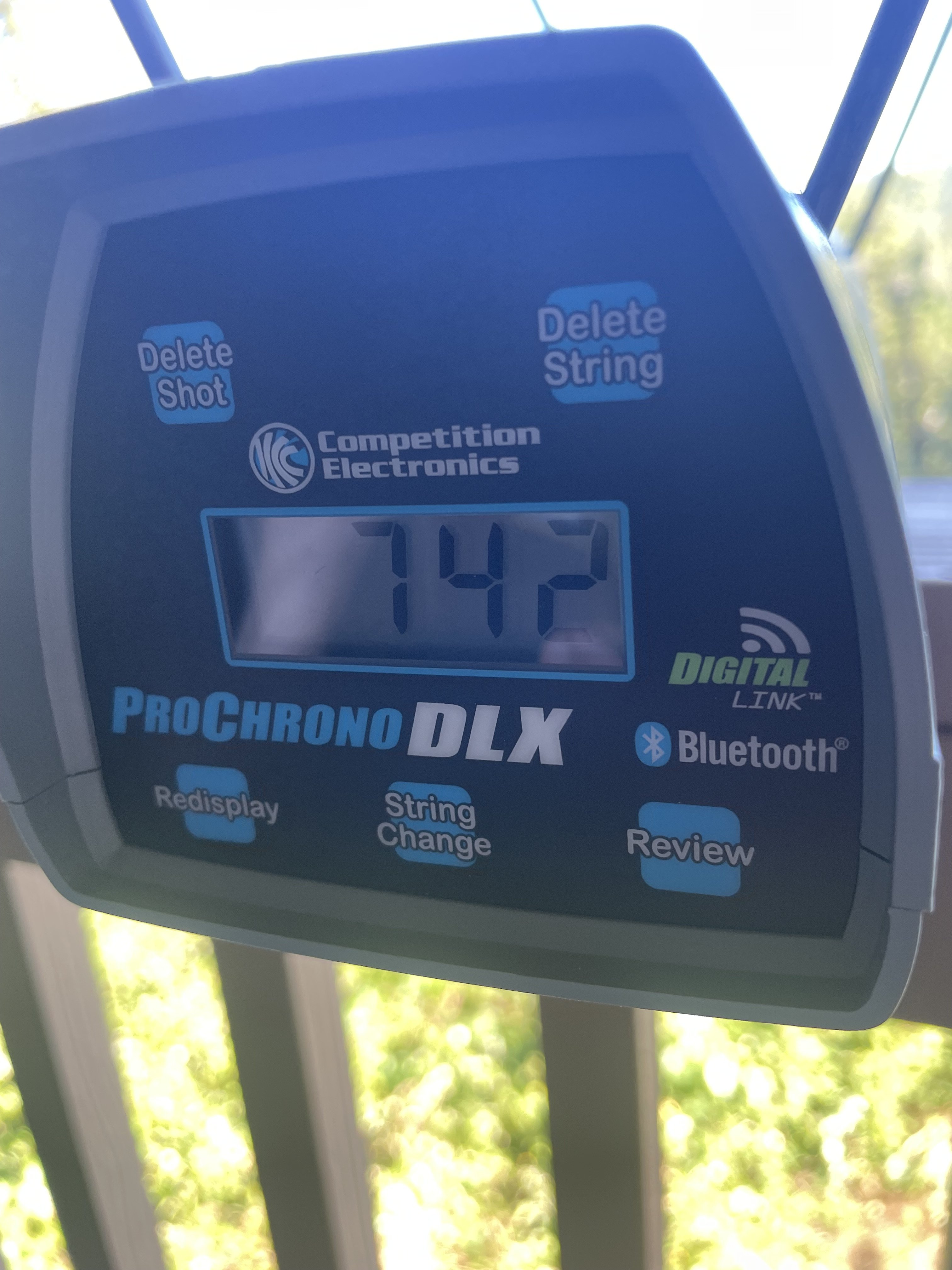

Tuning Umarex Notos has arrived.
Notos with mods
15cc plenum
1/2 unf thread front end cap
5gram hammer 4mm preload
Barrel port bore to 4mm (stock 3.5mm)
Jsb 18gr 740fps

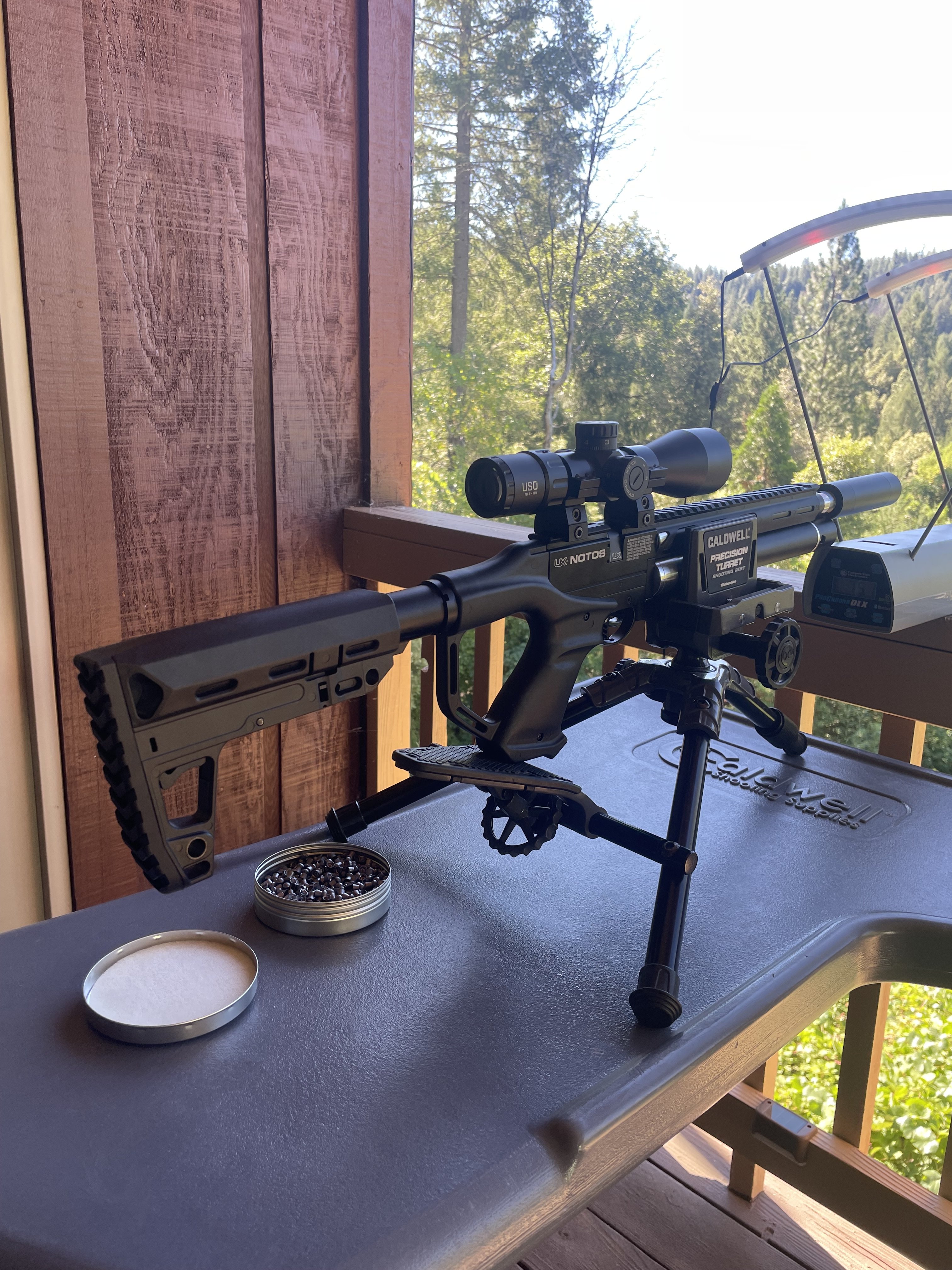

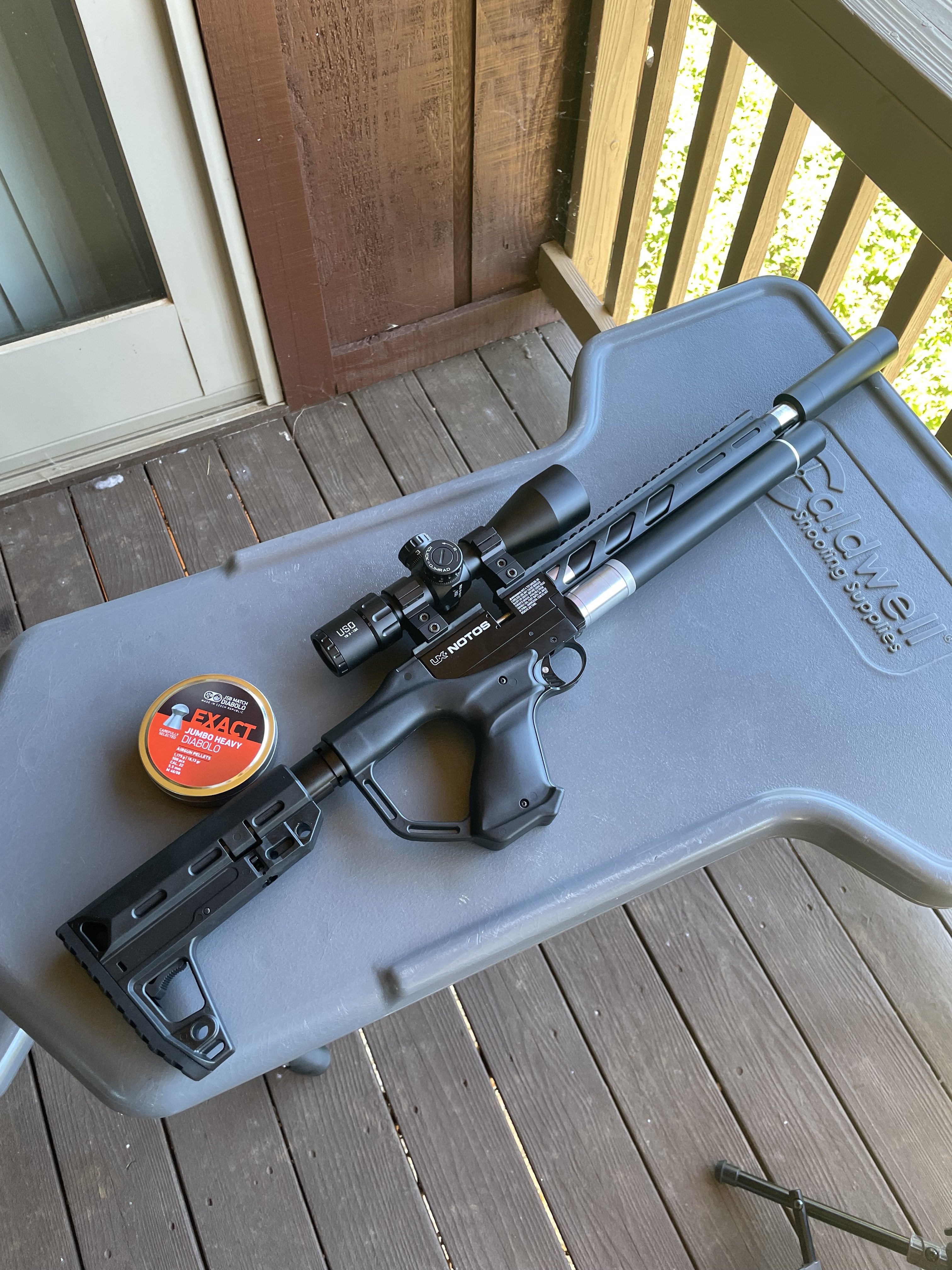

Put almost 75 Hades rounds through at 30 yards. Hand pumping it with my cheap four uncles ;)
The Notos is awesome!
The 3D printed moderator is superb. If only it were that simple for other firearms.

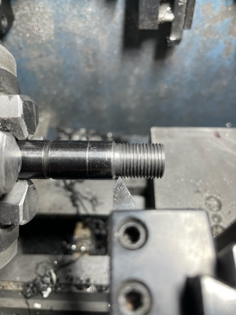

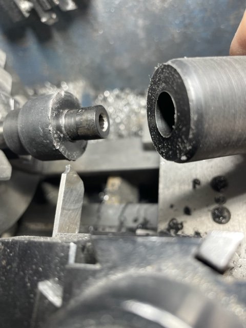

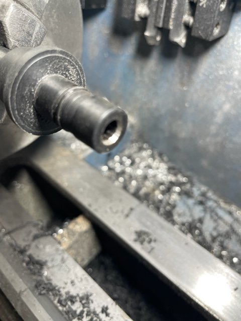

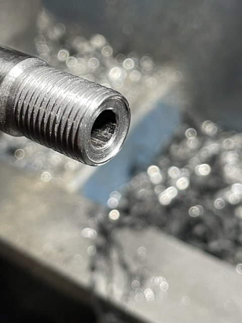

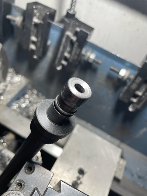

I went ahead Sunday morning to test my dual tank Notos and I was very disappointed with the accuracy. I couldn't get a decent group after trying 4 different pellet weight. I decided to cut the moderator and saw how bad the crown was, eccentric and chatter marks. I faced it off and put a light 30 degree chamfer. I'm also going to make an air stripper for a functional shroud. Since the barrel is 12mm, it's under size to thread for 1/2" unf, I turned it down to 11mm and thread it M11x1 mm. Tomorrow I will machine the air stripper/barrel tensioner end cap.
