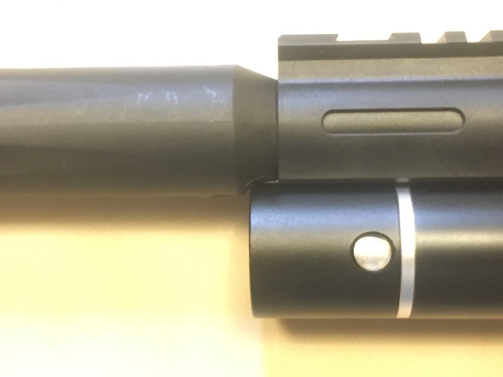

I just installed Wes' (from Airgunarcheryfun.ca) PP750 gauge block on my Notos. I went from 750fps to 850fps!
A little POI change but not much.
Excited to tune this thing now.
Edit - added pics of the gauge block and a pic of the spot I hit with a grinder to make clearance for the air cylinder where it was touching the moderator

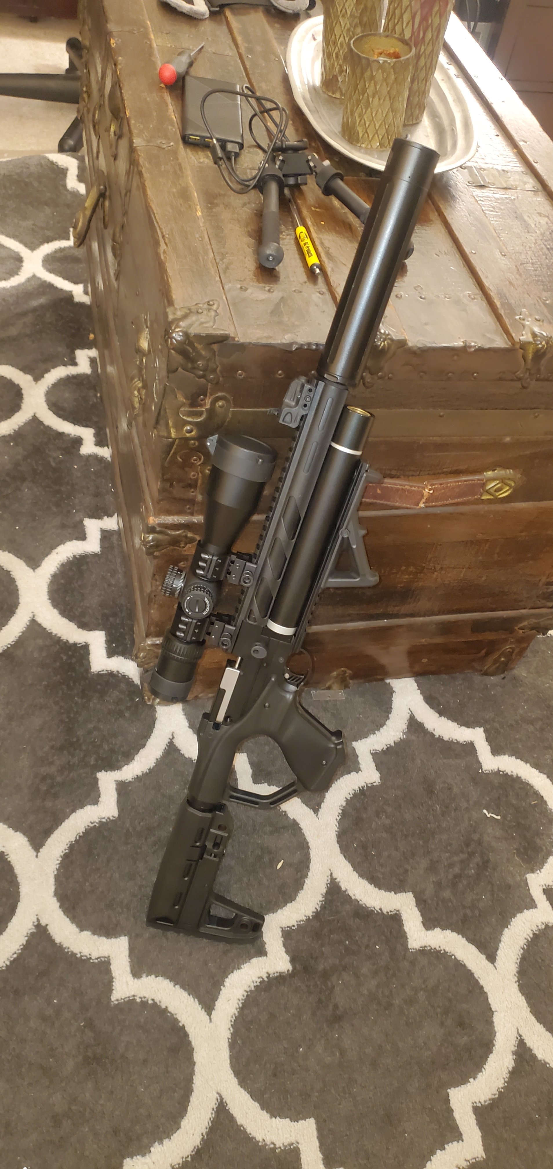

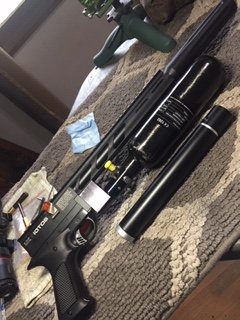

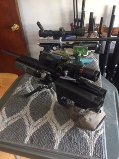

Hello All, new member here. Just want to post the current mods on my Notos. I made a drop block to install a carbon fiber bottle (370cc) for more shot count. Then I decided to change to a longer barrel, 350 mm (13 3/4"). External reg set to 2K, this gives me 815 f/sec. on 18.13 JSB. Trigger has been reworked a lot. I drilled and tap another hole between the 2nd stage and safety spring access. this reduced the 2nd stage pull quit a bit. I also machined the hammer shoulder to removed the radius by the sear. Then I bought a folding stock hinge, but I had to reduce the adapter thread down to 1.128" as it is very under sized for Mil spec. My brother has posted this along with his Notos on the Notos owners group. Also forgot to mention, I modified the side lever to a biathlon style. Much easier to cycle the action using Carm magazines.
View attachment 345974View attachment 345975
Hi, nice looking rifle! ..Can you please, tell me how can I take the barrel off? ..I want to make threads on the barrel, for a better silencer.
Thanks and best regards,
Alex
Alex
There is a set screw for the plastic rail you must remove first. Under this is another set screw (M4x4mm) that requires 2mm allen wrench, may be a little tight due to thread locker. Once removed, the barrel and shroud will slide forwards together. The barrel diameter is 12mm, so it's under size for 1/2"x20 unf thread. I recomend using slip on adapter (12mm to 1/2" unf) available on eBay. As stated, "C" clips are molded in with the moderator, so no way to remove with out damaging it. I chuck the barrel on the lathe and used a parting tool just ahead of the dummy pin by the tapered end until it touches the barrel. You can then wiggle it forward to separate from the barrel. I threaded the OEM moderator 1/2x20 unf so I could compare it to other moderators. I you want to retain the shroud, you will need to leave enough on the tapered side and just cut enough to slide the adapter all the way. All this mods are posted on the Umarex Owners group on facebook by my younger brother.
