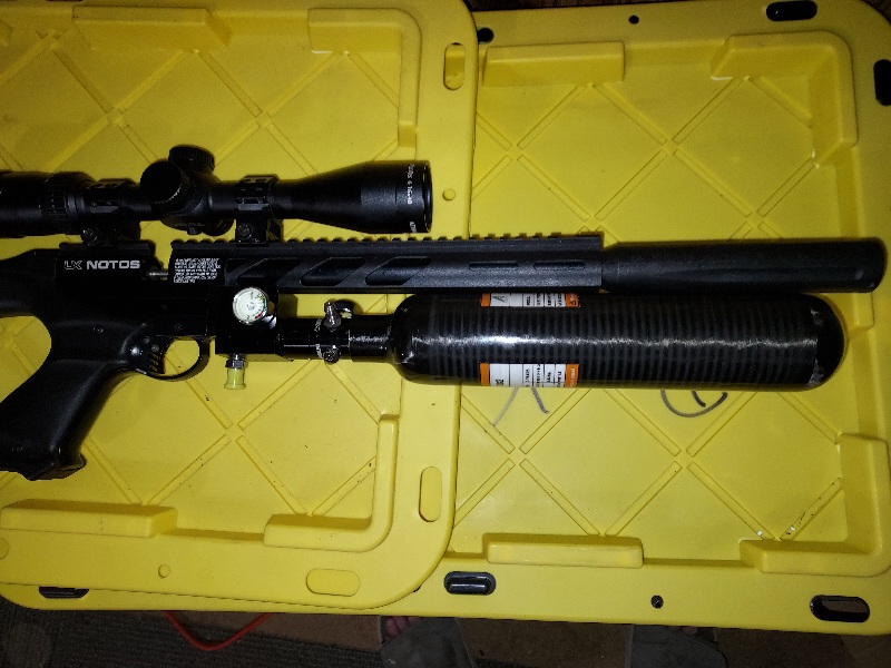

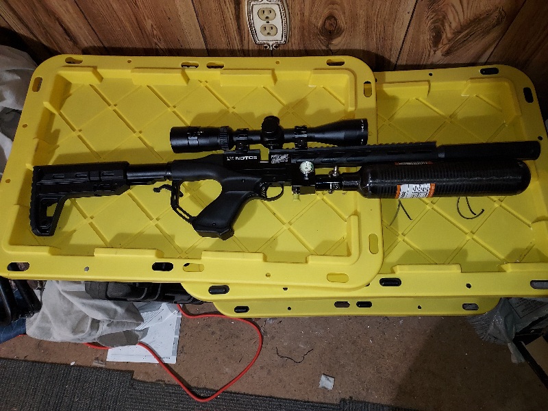

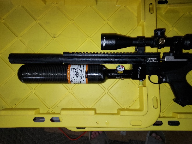

i think you should go with a 22ci carbon fiber bottle. Smaller diameter bottle. I really wanted to build the bottle. But I got 5 project guns and not building any more. I need to tears stuff up and sell all the project parts. I sawed out that angle like your gun hate it hitting my wrist all the time.
Reactions: Firewalker
Can you link me to one of these, I'm having trouble finding one. i can find these aluminum ones https://eastcoastpaintball.com/products/ninja-aluminum-systems-22?_pos=1&_fid=25b1f6c0e&_ss=c , they are supposed 2in/50.8mm. This setup looks pretty interesting and I think I want to try it myself but I'd like to find a smaller bottle like you're suggesting.
