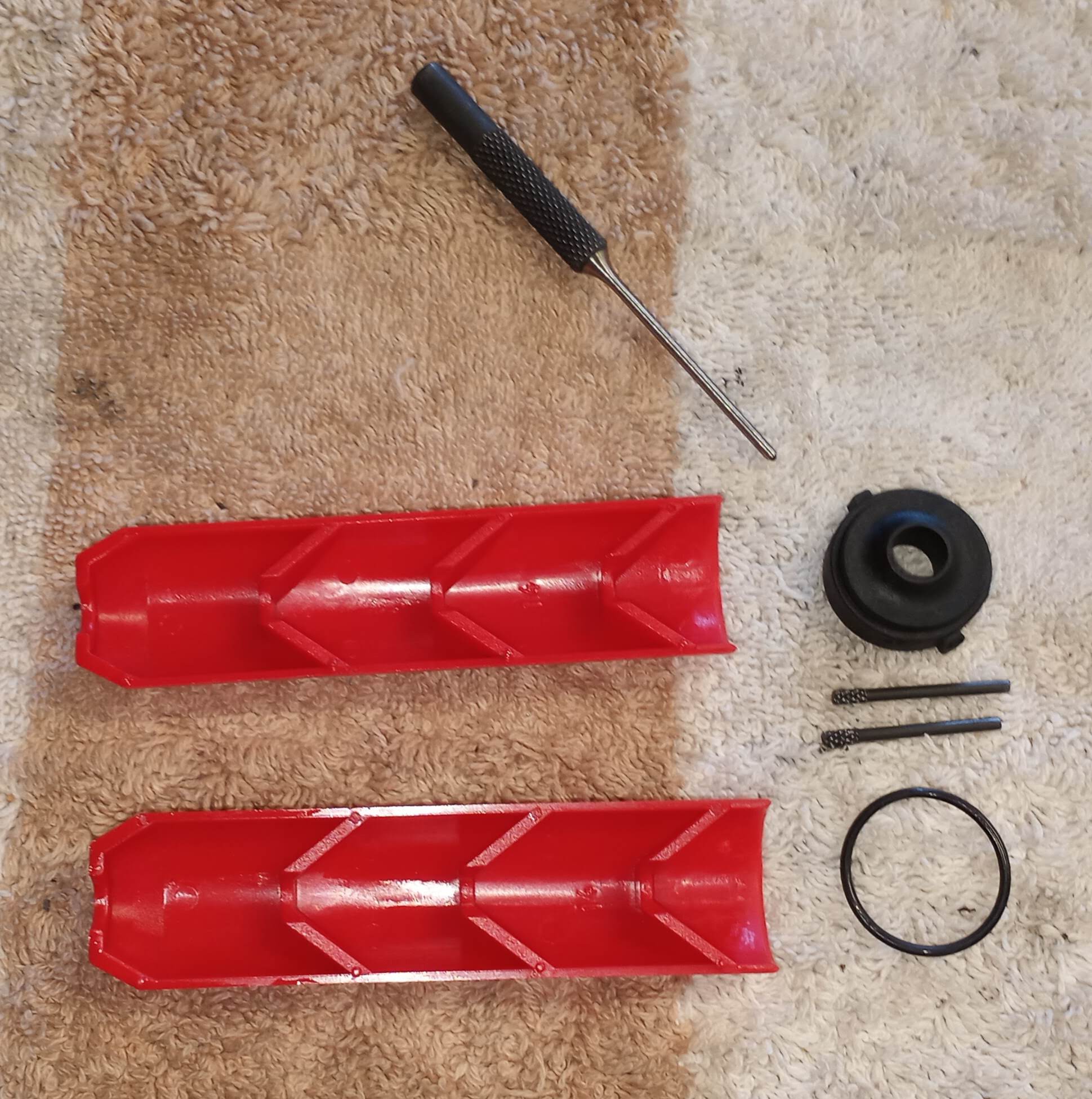

The short and sweet answer though is to look closely at the ends of the pins holding the cap on and drive from the smooth side, pushing the knurled ends out first.
The cap, o-ring and baffle will drop out once the pins are removed.
This setup is IDEAL for inserts!

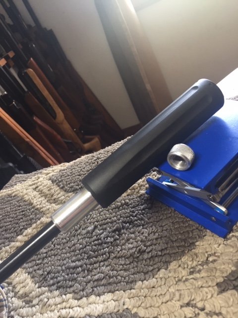

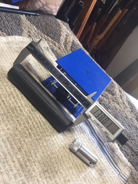

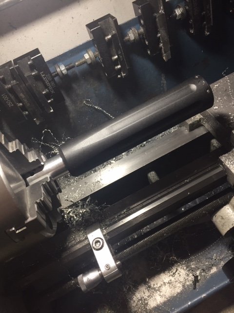

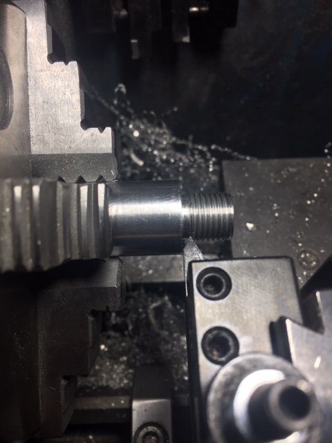

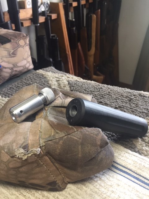

I the beginning, I always wanted a better moderator. I decided to take the barrel off and cut the moderator just ahead of the dummy pin towards the barrel. Then I cleaned up the Notos moderator to 138 mm long, I then tapped it 1/2 unf. I made an adapter for the barrel (12mm to 1/2 male unf) so I can try different moderators. When I saw how bad the barrel crown was, I faced it off and champer it again.
I don't have those tools or skils.
Otherwise I would have added an LDC adapter instead of the original moderator.
I printed the insert yesterday.
Today I hammered at the Notos moderator pins for half an hour using a blunt nail as a pin driver.
For now, I gave up on removing the Notos moderator pins.
