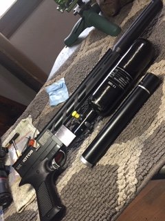

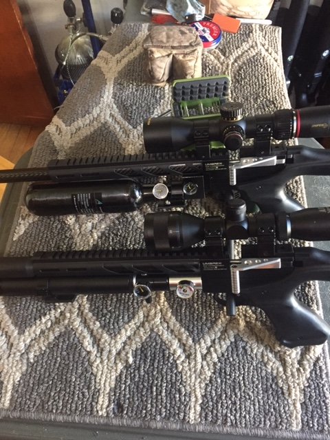

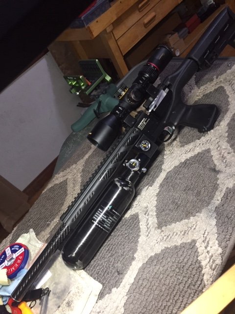

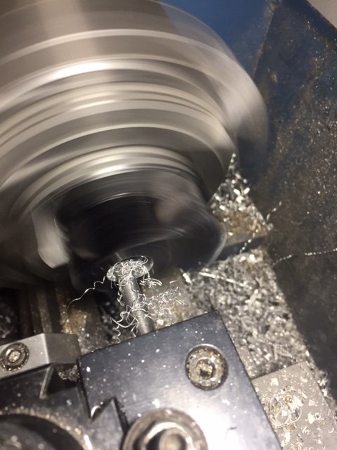

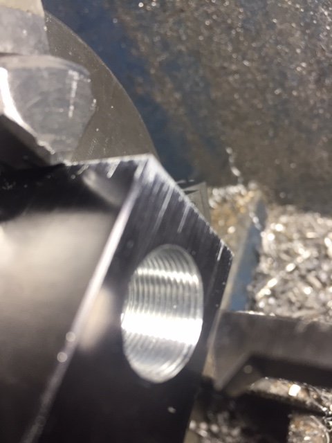

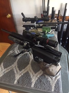

Hello All, new member here. Just want to post the current mods on my Notos. I made a drop block to install a carbon fiber bottle (370cc) for more shot count. Then I decided to change to a longer barrel, 350 mm (13 3/4"). External reg set to 2K, this gives me 815 f/sec. on 18.13 JSB. Trigger has been reworked a lot. I drilled and tap another hole between the 2nd stage and safety spring access. this reduced the 2nd stage pull quit a bit. I also machined the hammer shoulder to removed the radius by the sear. Then I bought a folding stock hinge, but I had to reduce the adapter thread down to 1.128" as it is very under sized for Mil spec. My brother has posted this along with his Notos on the Notos owners group. Also forgot to mention, I modified the side lever to a biathlon style. Much easier to cycle the action using Carm magazines.

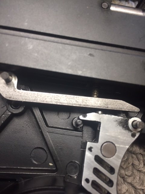

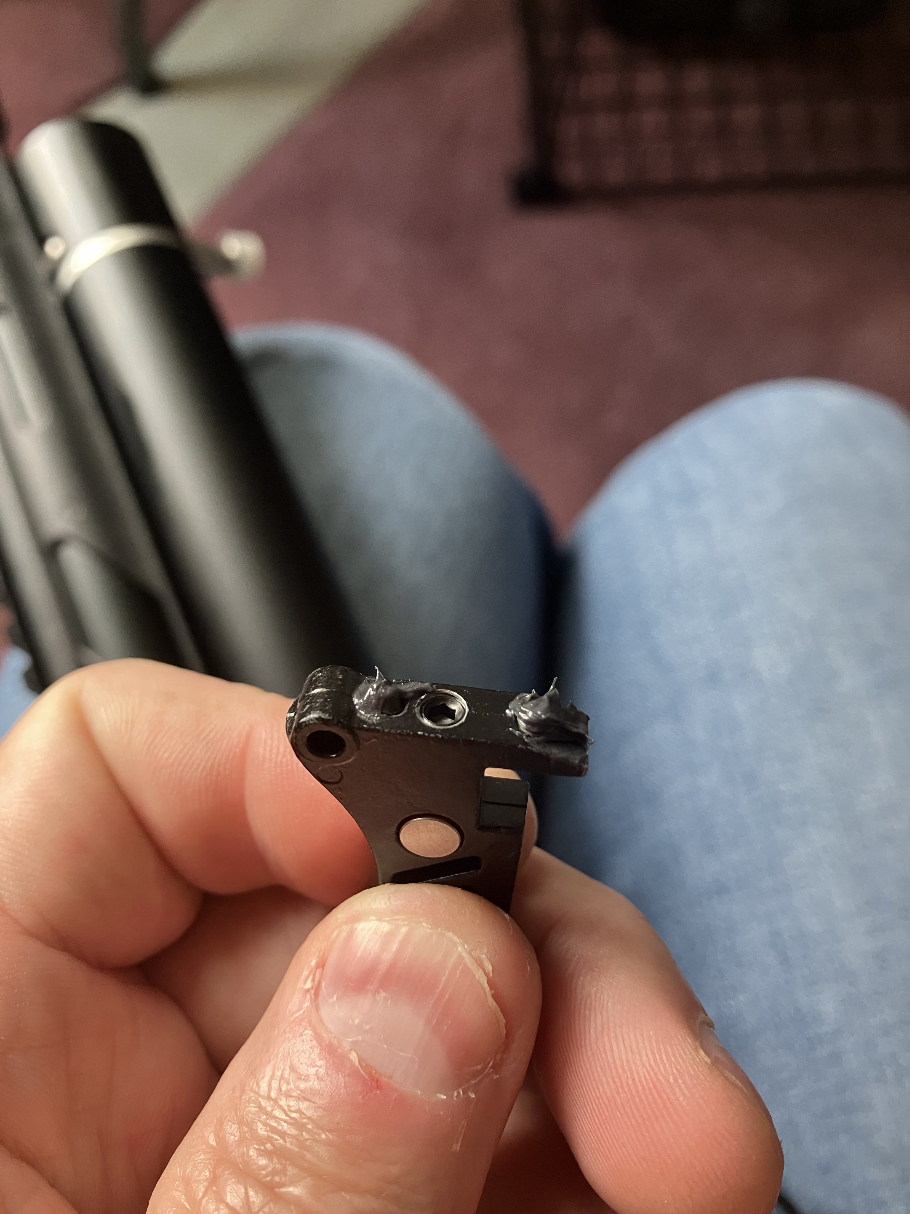

Fixed, put some Moly grease on and a rat file. EZ-PZ
As someone pointed out, the grub screw was originally in the right orientation. It looks backwards when you first look at it, and if it's purpose was to push up on the sear, then yes. But I believe the purpose is to push "down" on a flat bar that's on the back of the handle plate. If you look at the plate it will make sense.
I almost switched mine too after reading these posts, but after looking closer, and thinking why would they install it backwards??? I figured out it's correct purpose.
Hope this prevents others from incorrectly turning that grub the wrong way. I'm sure it probably still functions either way.

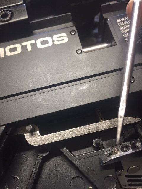

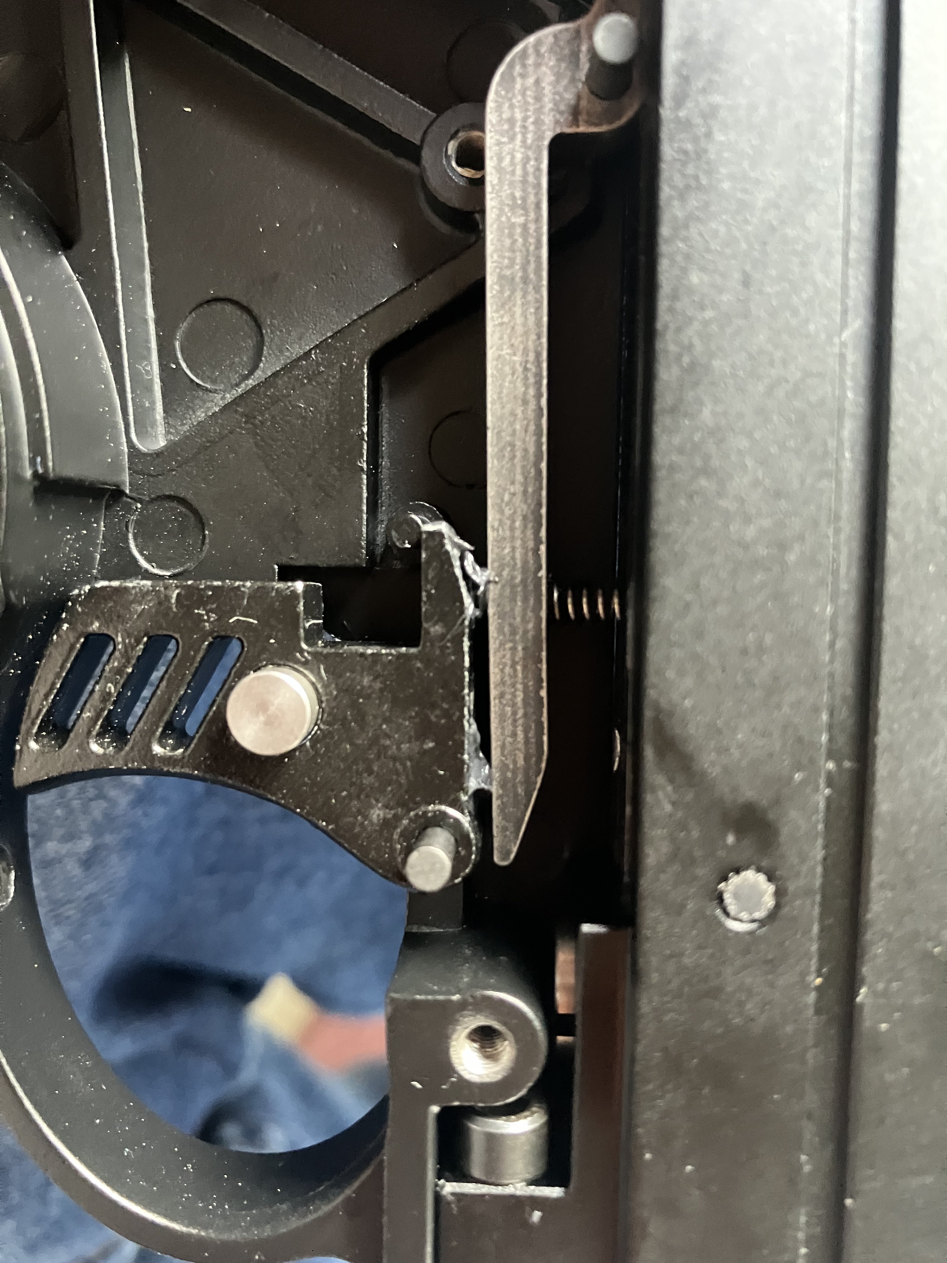

The spring is fine as is, lots of guys keeps turning the first stage screw until it does not spring back. This is unsafe I think as a bump can release the hammer and fire. The second stage screw is too far away from the fulcrum point of the trigger. I drilled and tap another screw (M3x.5) between the second stage and the spring access screw for the safety. Now it has better leverage and reduced second stage pull quite a bit. I also turned the hammer to sear area flat so it's easy for the sear lever spring to reengage when you release the first stage. I also reduce the safety spring tension to make it easier to engage. I will post pics next time I take it apart.

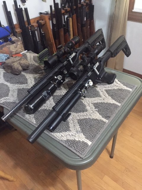

My brother came by to pick up his Notos after I finished the upgrades. I installed a 120 cc tank and external regulator. Original air tank is only 66 cc, but he did not want a carbon fiber tank. I also upgraded the side lever to my current design. His getting close to 40 regulated shots at 22 f/lbs.
I like that side lever
Wow! Great job. Did you make the larger tank?
My brother bought it on amazon. I just modified the end caps as no need for a fill probe since the regulator has a quick connect. I bore out the end caps for a little more volume. This tank has a O.D. of 34 mm, so the adapter must be offset accordingly to clear the moderator. Pictures are in the Notos owners group on facebook.
Today I took the side cover off the trigger to take pictures of my mod to increase the leverage of trigger. The change in geometry makes the second stage a lot softer due to increased mechanical advantage. I am using stock spring and have at least 0.030" of sear engagement. Only other mod is machining the hammer to sear side flat. No noticeable increase in second stage creep. First picture with screwdriver pointing at the new M3 set screw location.

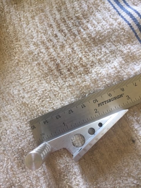

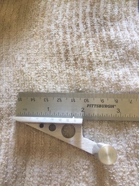

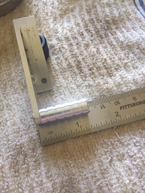

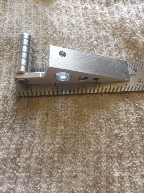

I am posting the proto type Notos side lever extension as some have message me for dimensions. Mat'l is 3/4" aluminum angle and a 5/16" aluminum rod. Very easy to make with file, hacksaw, drill and tap. You can attach it to the original lever with a JB weld. I also drilled and tap the side lever for a cap screw. The lever is very hard material as it is done with MIM (metal injection molding) process. Very easy to crack, so I don't advice drilling it.
