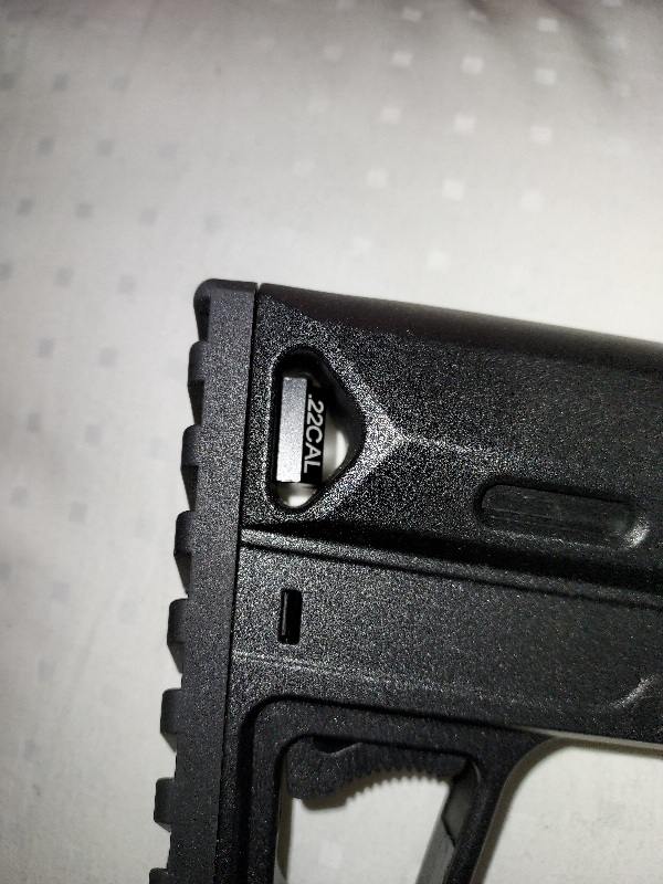

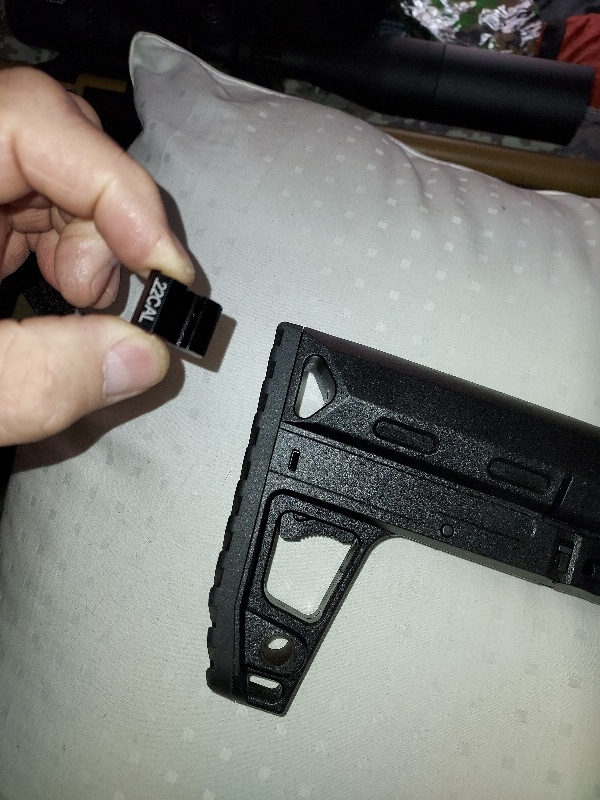

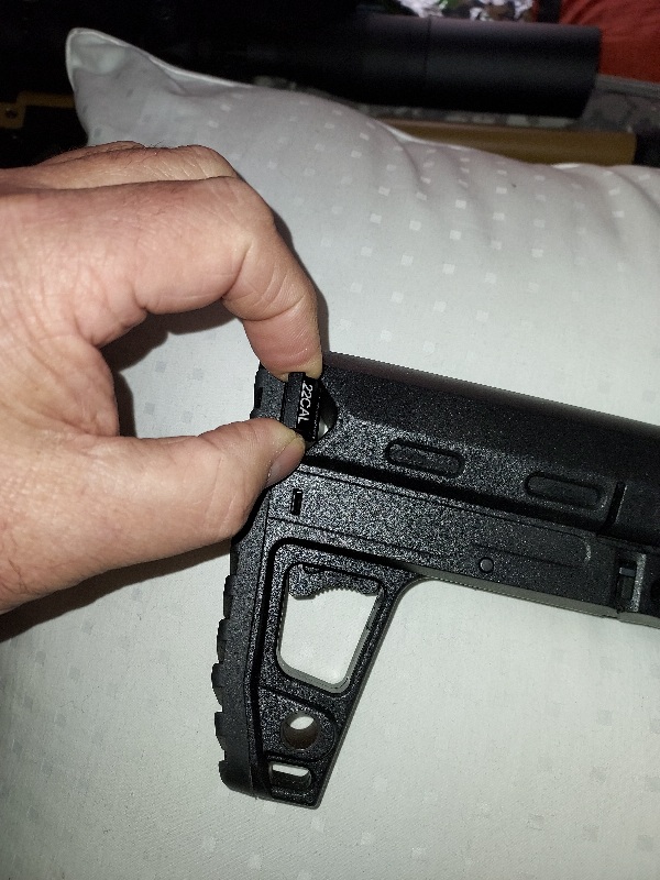

Look what I discovered guy's, a little secret stash spot on the Notos for the Single shot tray.

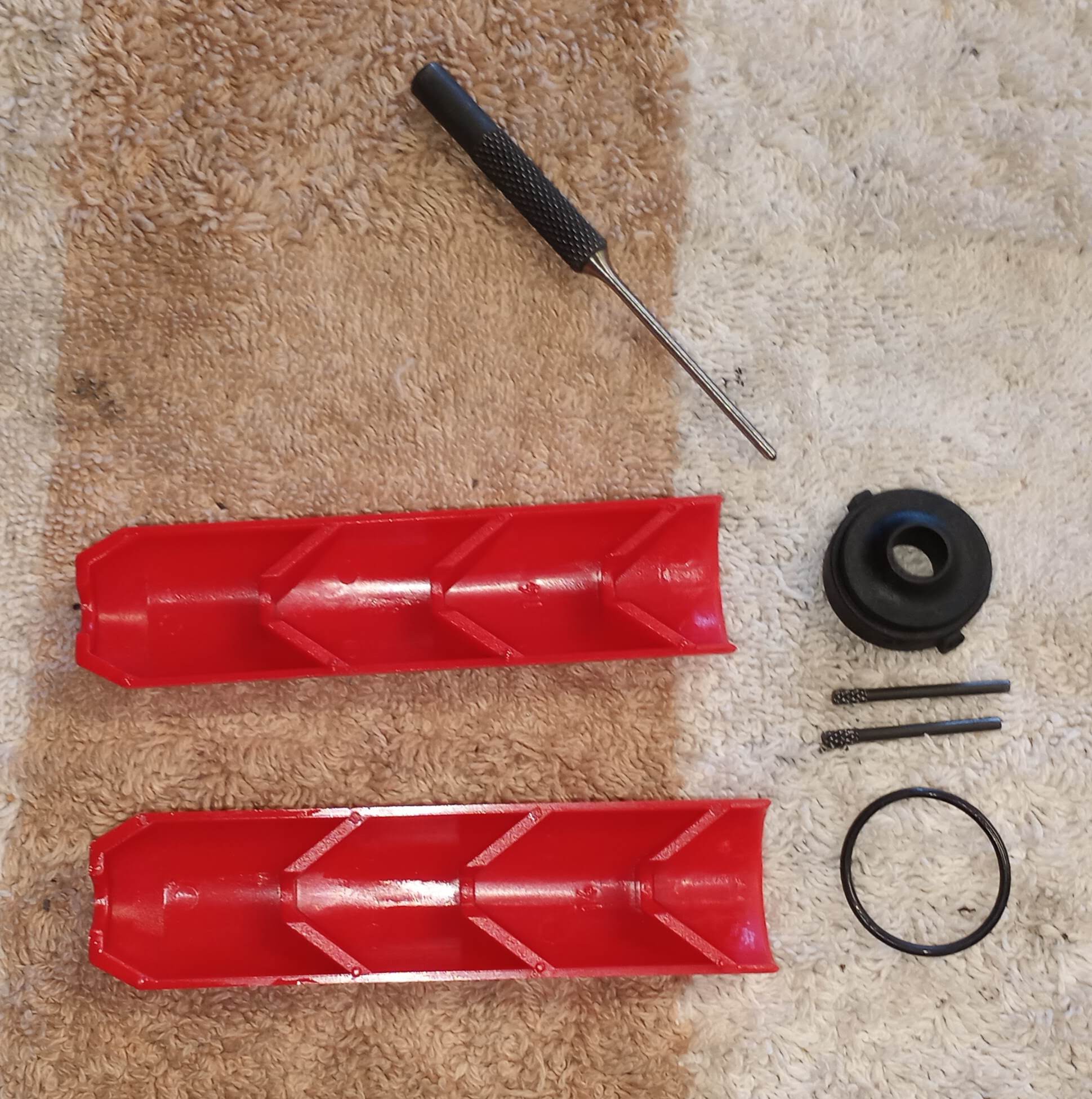

Can you post some instructions (with photos) on how you got the moderator out?
I have posted that over on GTA but am going to upload a more comprehensive review and modification outline this week here.
The short and sweet answer though is to look closely at the ends of the pins holding the cap on and drive from the smooth side, pushing the knurled ends out first.
The cap, o-ring and baffle will drop out once the pins are removed.
This setup is IDEAL for inserts!
Were you also able to remove the outer portion from the barrel without cutting it up? Thanks for posting the innards!
Sorry but no, I was not.
There are no ramps as I was hoping there were for the clips to climb and skid along the barrel.
I put the barrel/moderator housing assembly in my hydraulic press and applied just under 500# of force but there was no creep at all.
I do see the place they inserted the fingers inside the body to hold the rings open while inserting the barrel. 2 opposed slots on either side of the body hole.
This method makes it impossible to open the rings without destroying the molded body but I will try heating the barrel to the plastic softening temperature and see if I can get the barrel end to open enough to allow egress of the clips but leave it cool enough to rebound back to its molded state after removal.
I give it a 25% chance of working.
