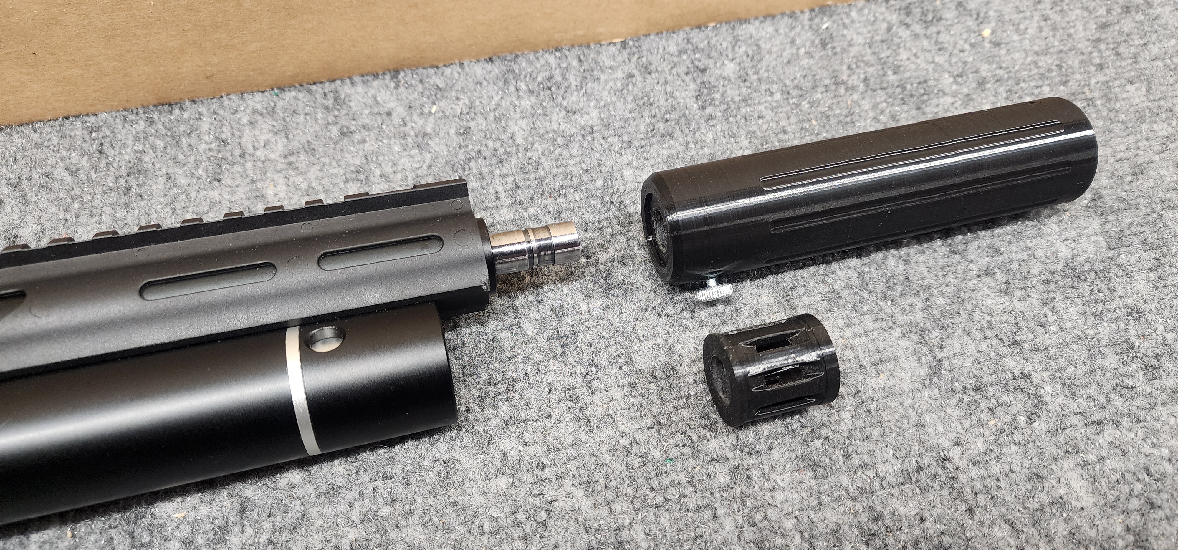

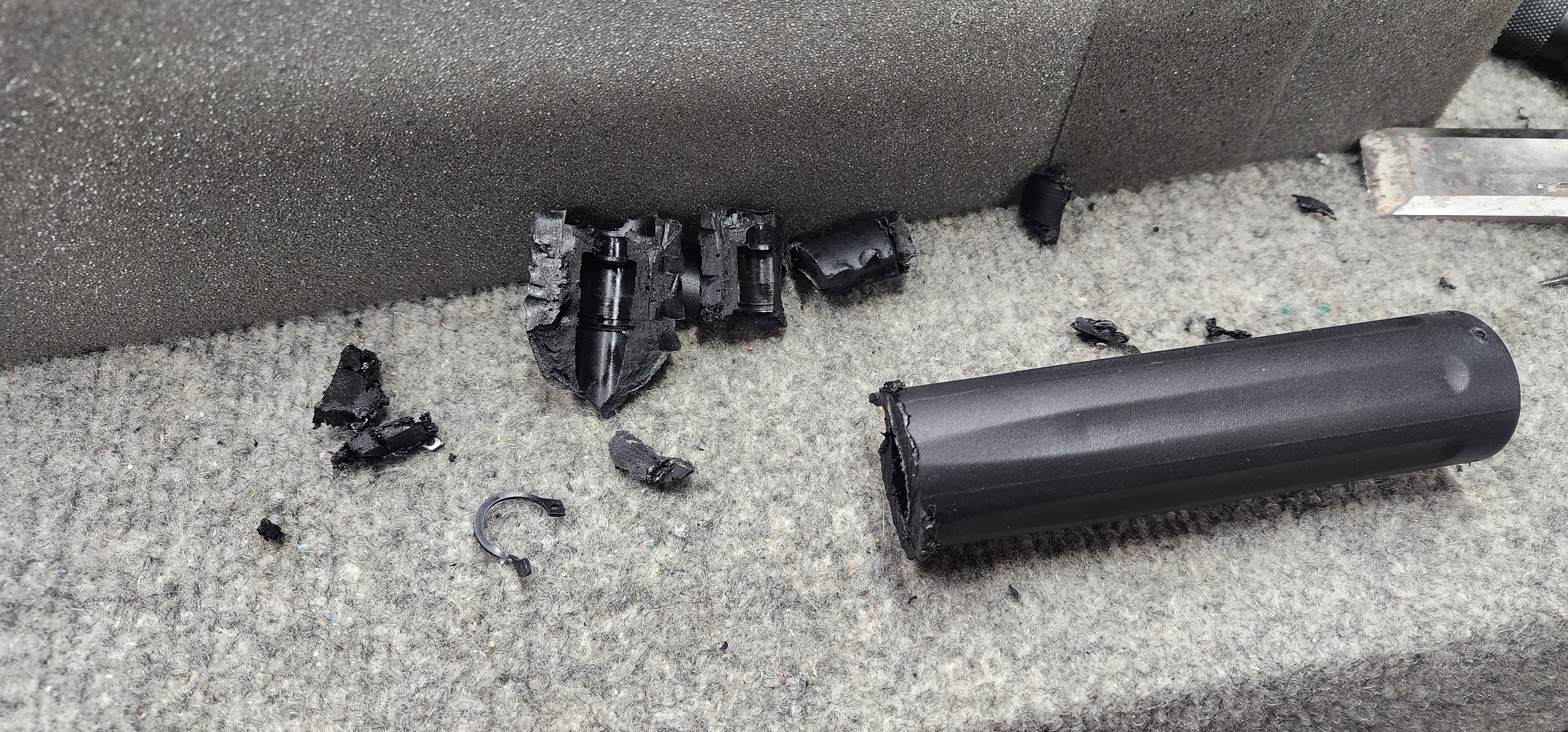

Moderator is definitely not removable, its held on by two c clips that are molded into the plastic.
Can obviously be cut off but you will need access to a 3D printer to make some parts.

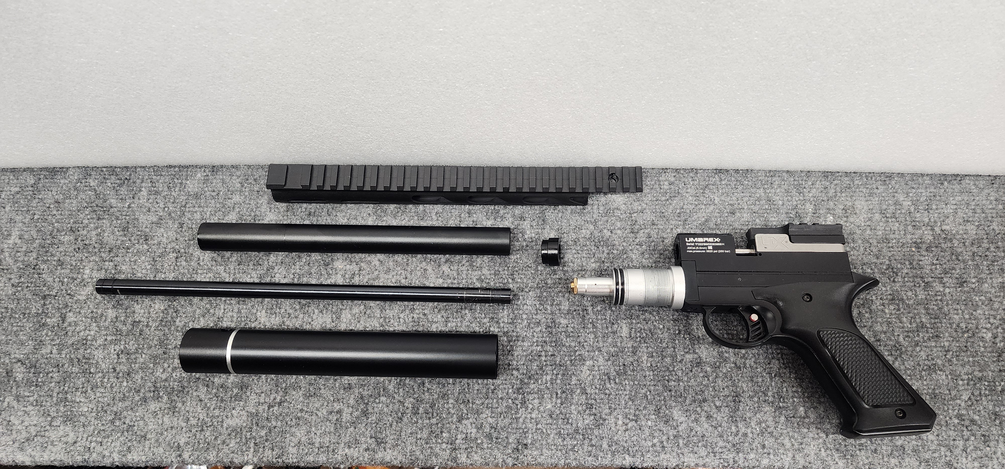

First off,the barrel is not threaded on either end,held by a grub screw on top of the block just underneath the screw to remove pic rail.
After removal, the whole barrel assembly should just slide off.
The barrel shroud is a slip on fit only and was held on by the Moderator.
Just need to hack off the Moderator if desired and find or make a slip on version. View attachment 325772View attachment 325773View attachment 325774
