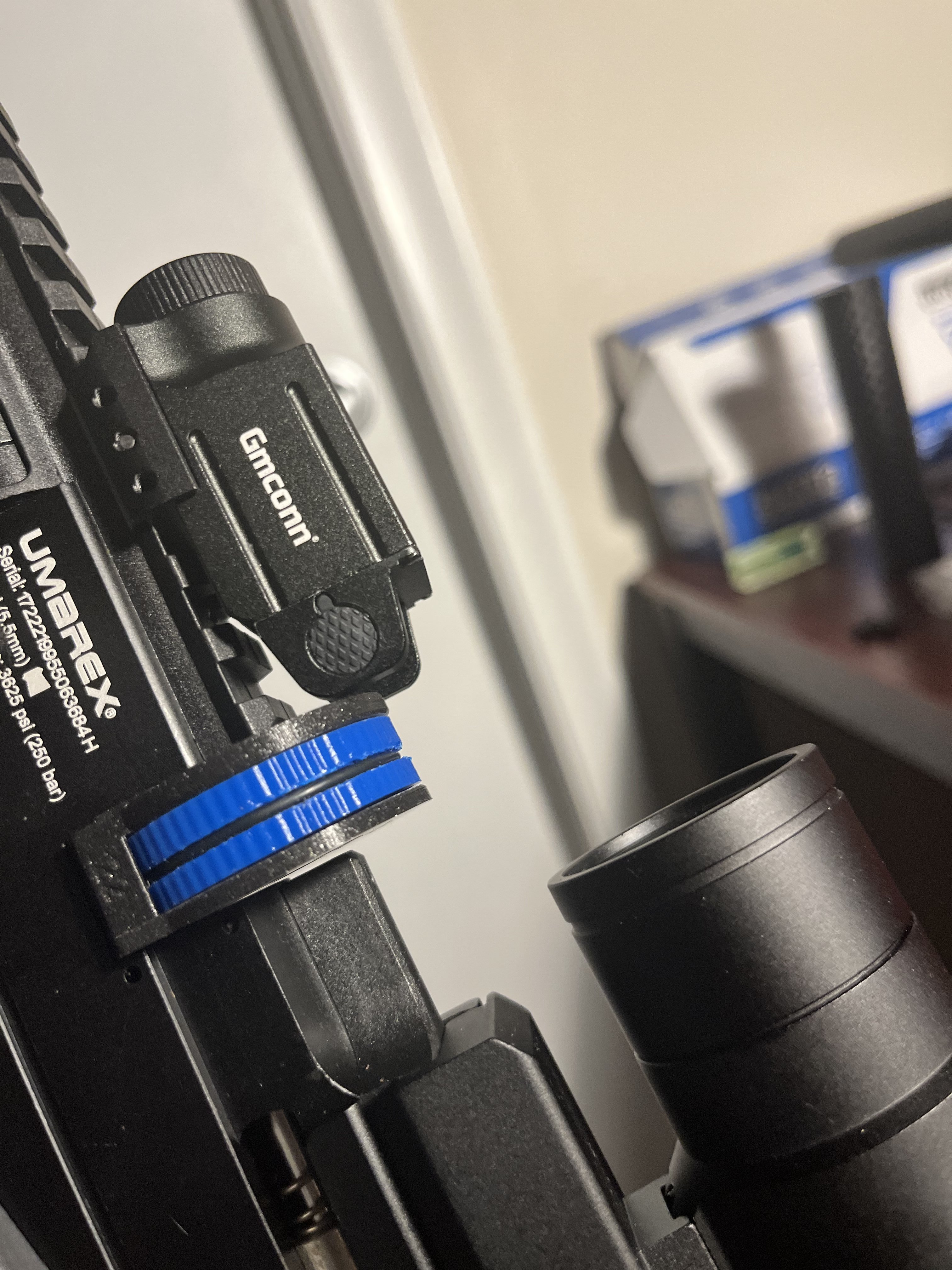

Barrel OD is 11.95mm ish, From post #157
Reason I was curious was the picture of the 2 o-rings around the transfer port reminded me of an RTI barrel. That would have been somewhere between post #157 and #400😉
