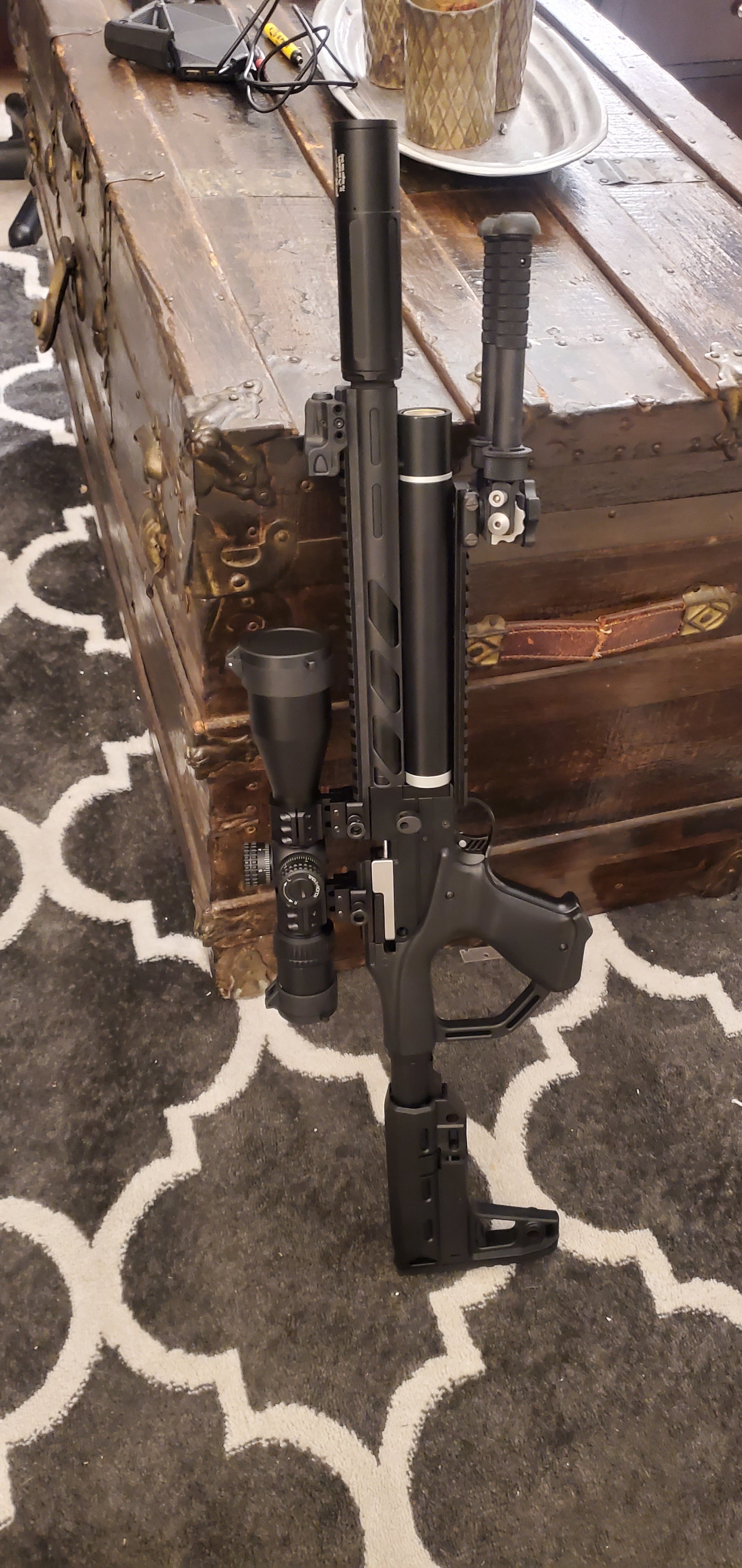

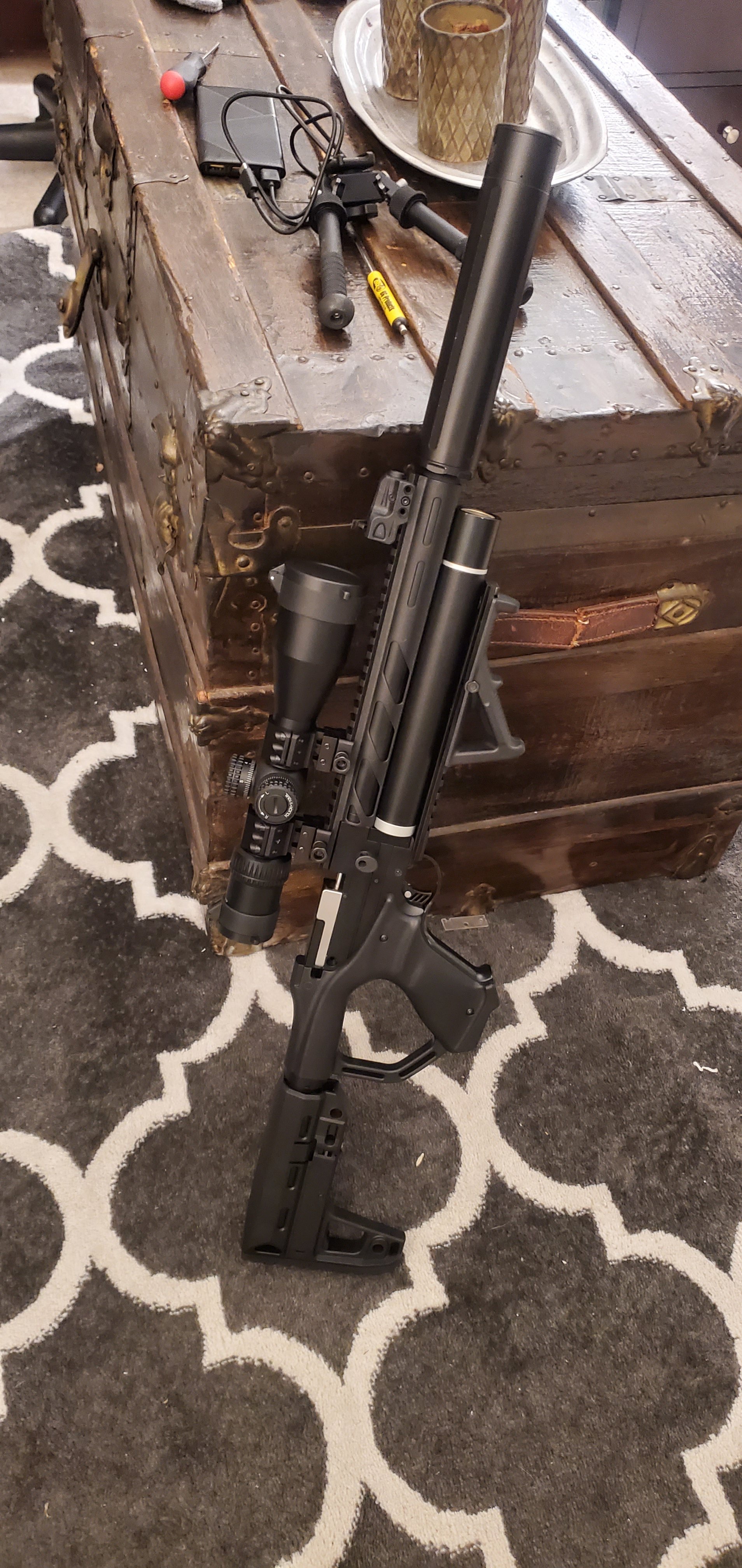

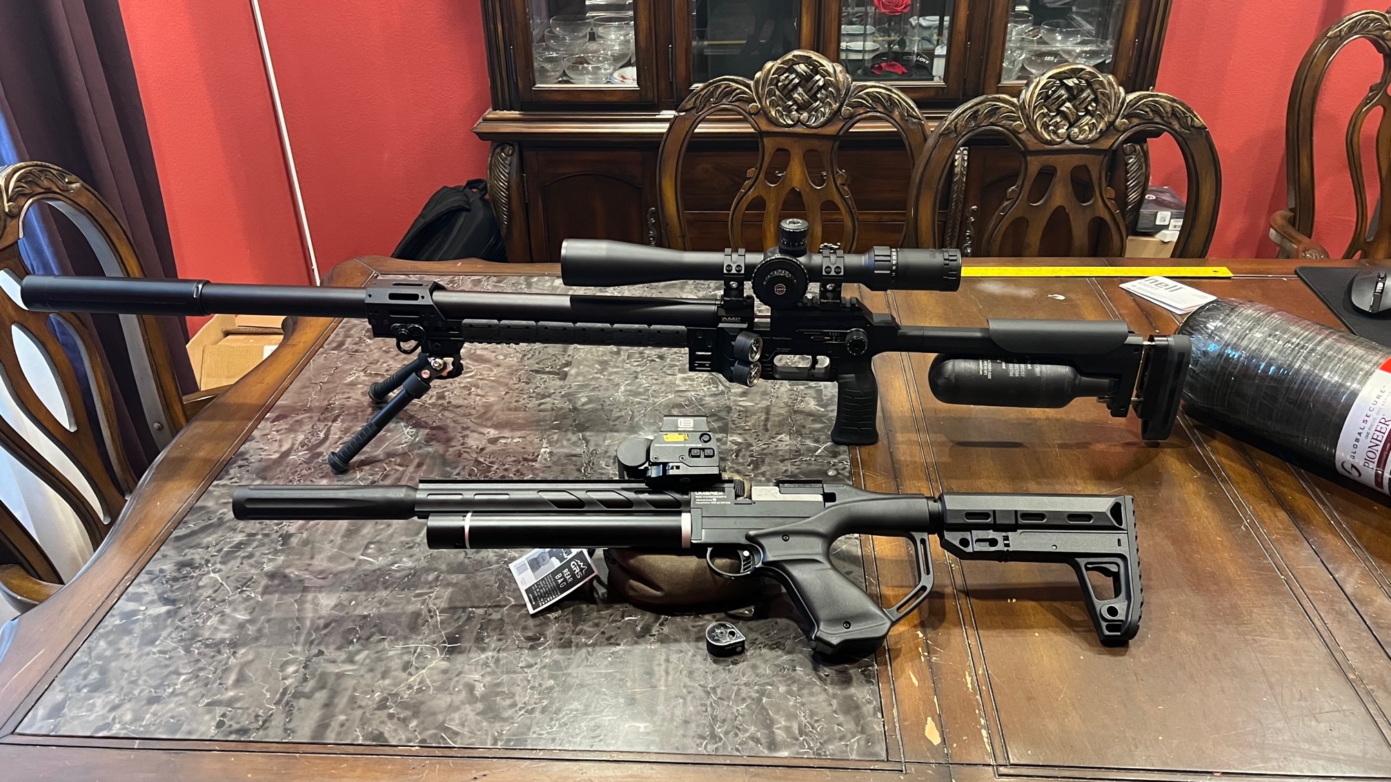

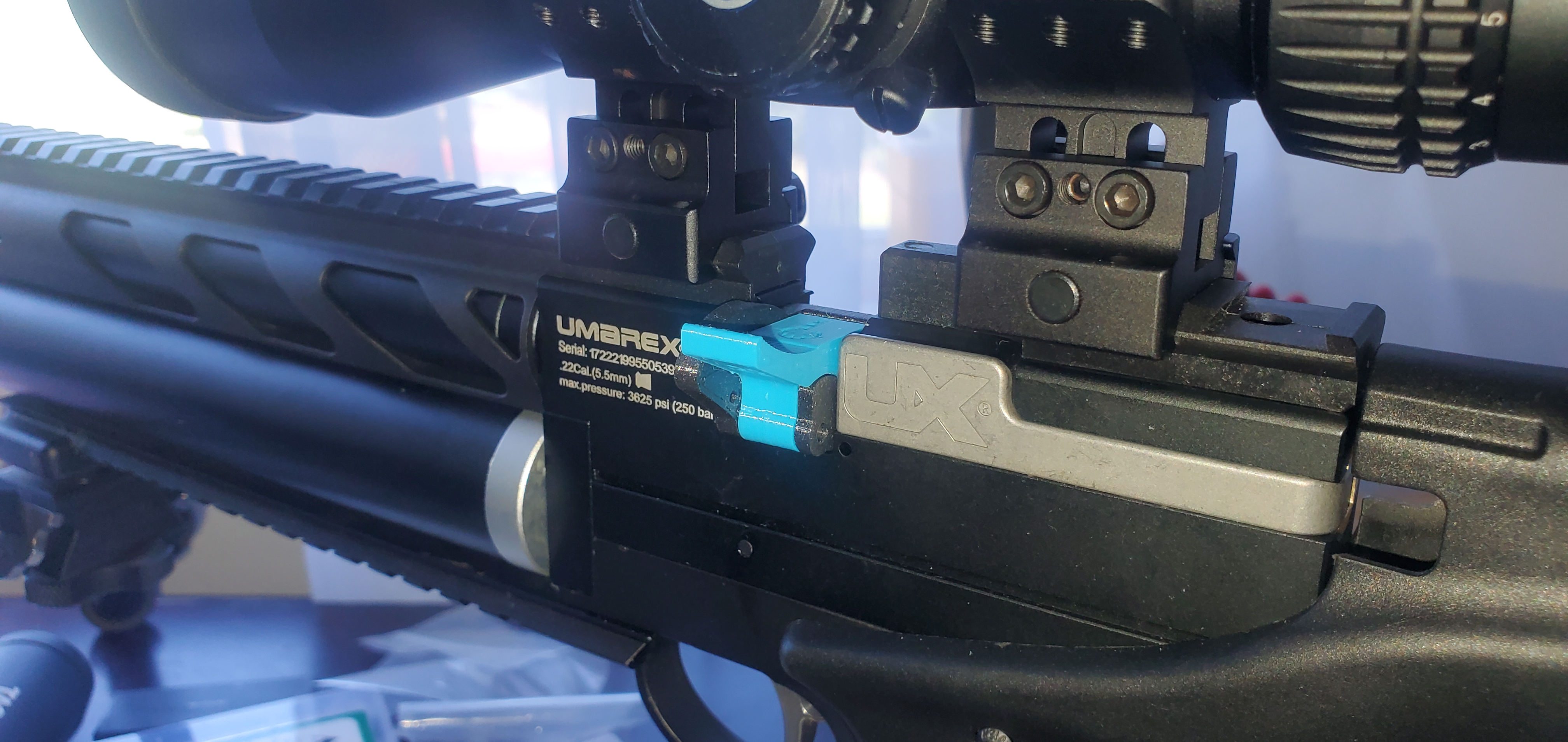

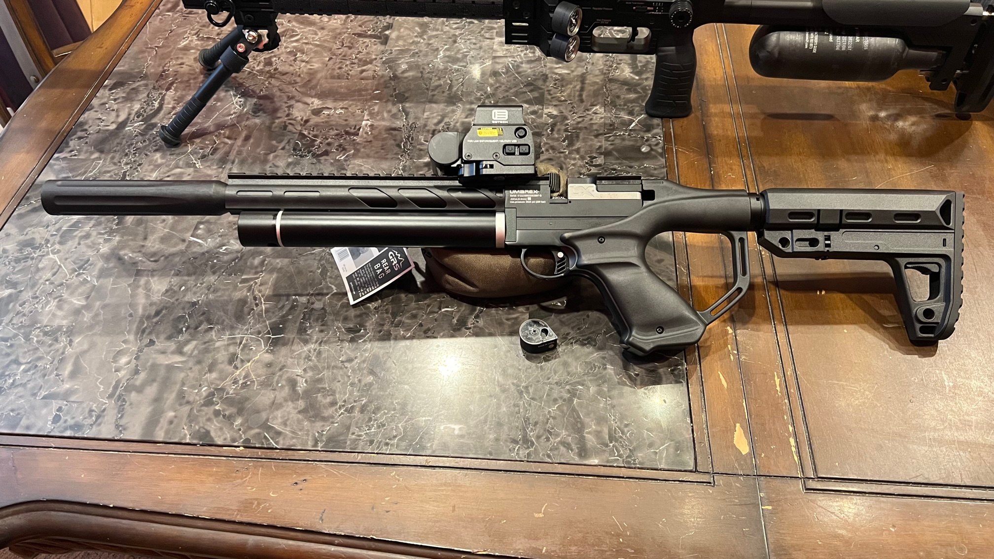

Tuning Umarex Notos has arrived.

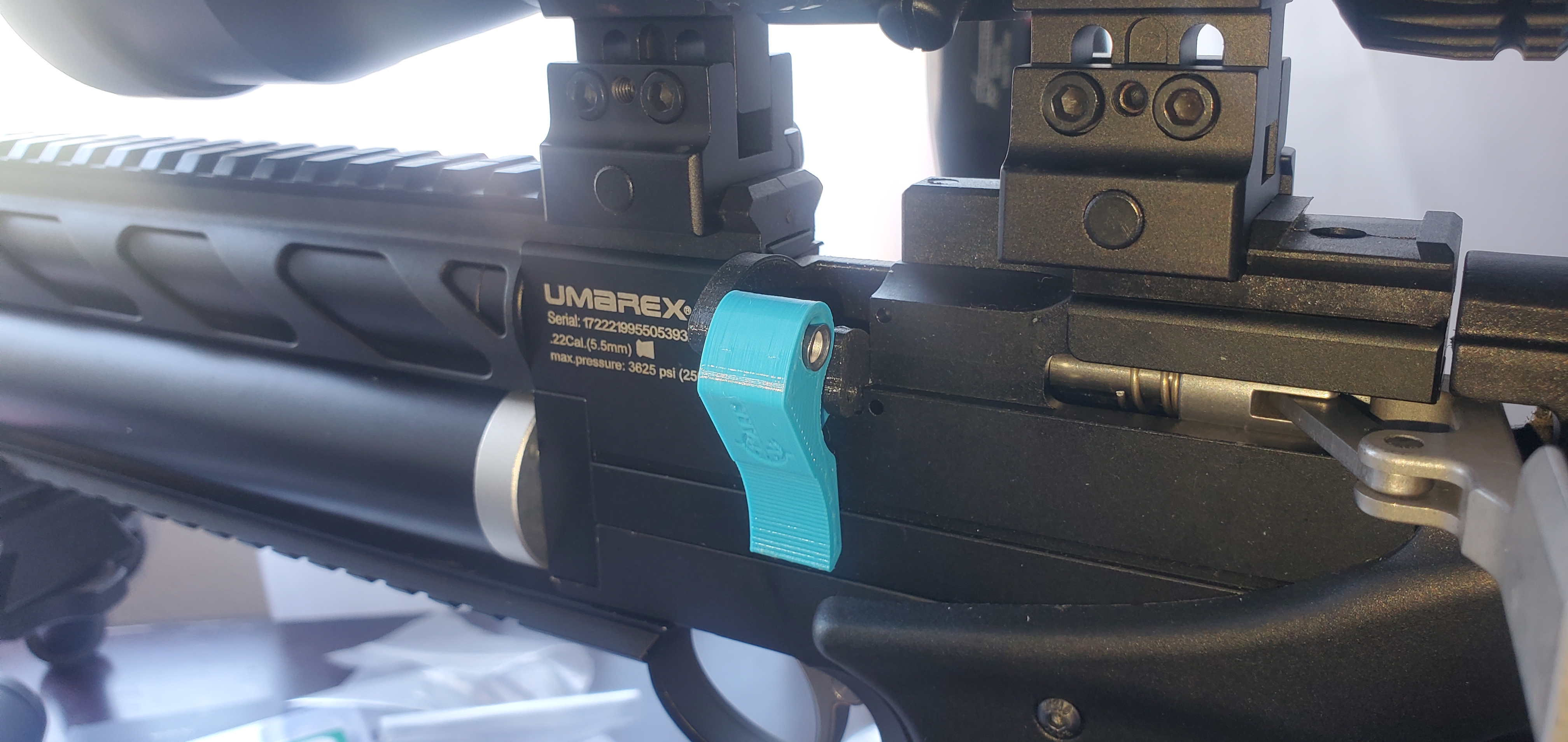

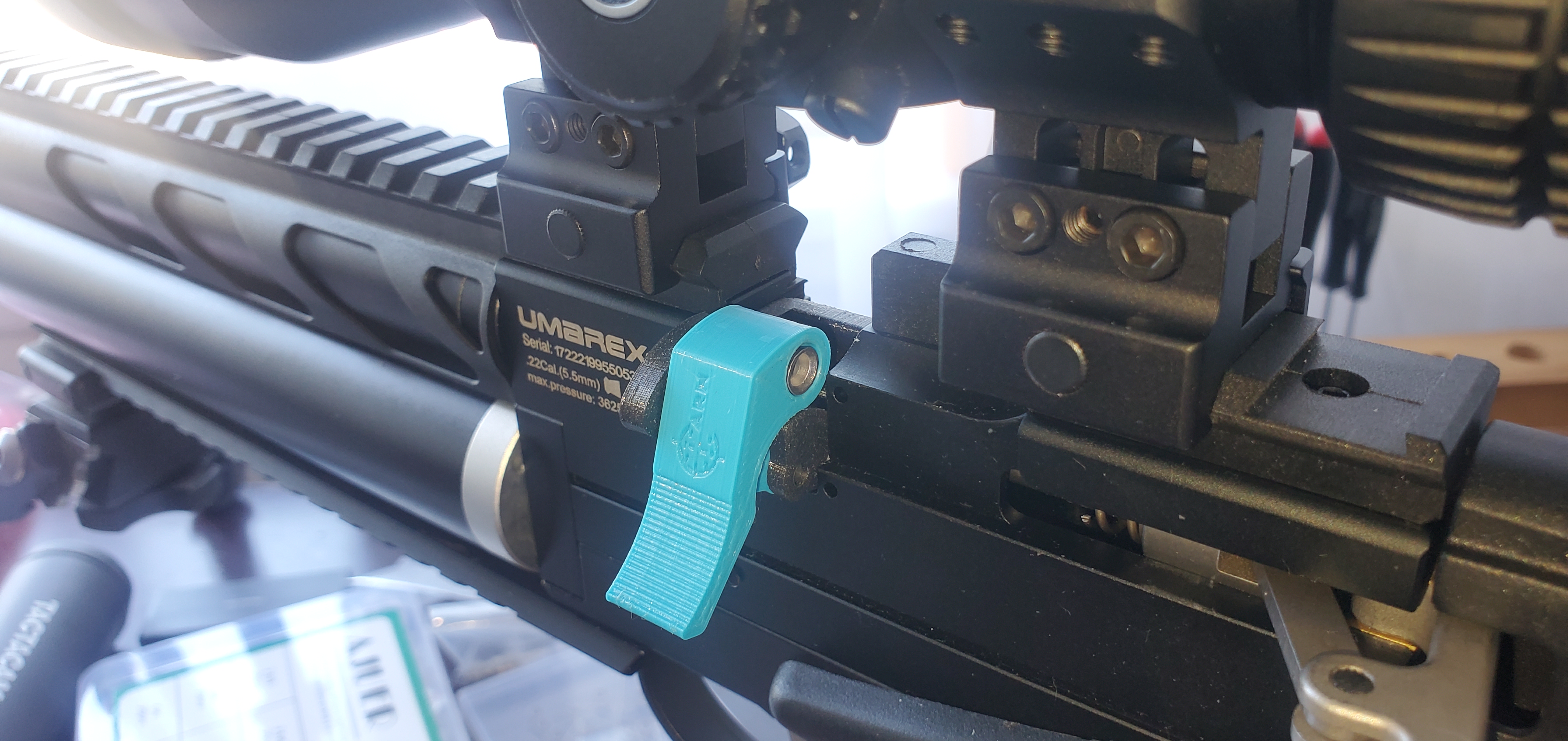

The only thing I did not like, was that it was not available in .177 so I made a few changes 😌
A right side cocking .177 Notos with a screw on moderator!
Allen

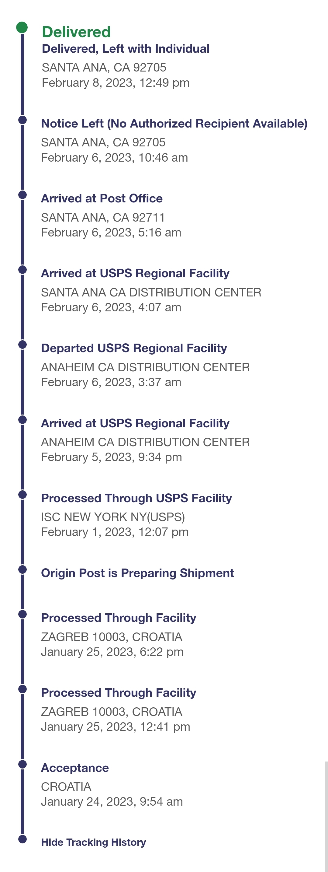

It took a little bit to get to me on the west coast... Then there was a issue with the post man who was subbing, did not ring the doorbell, and just waited out there for 5 mins expecting somebody to notice him. I think he was hoping the notification would tell me to go outside! 🙄
But I purchased online on the 23rd last month. And here is the tracking.

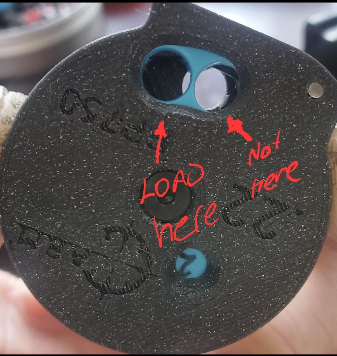

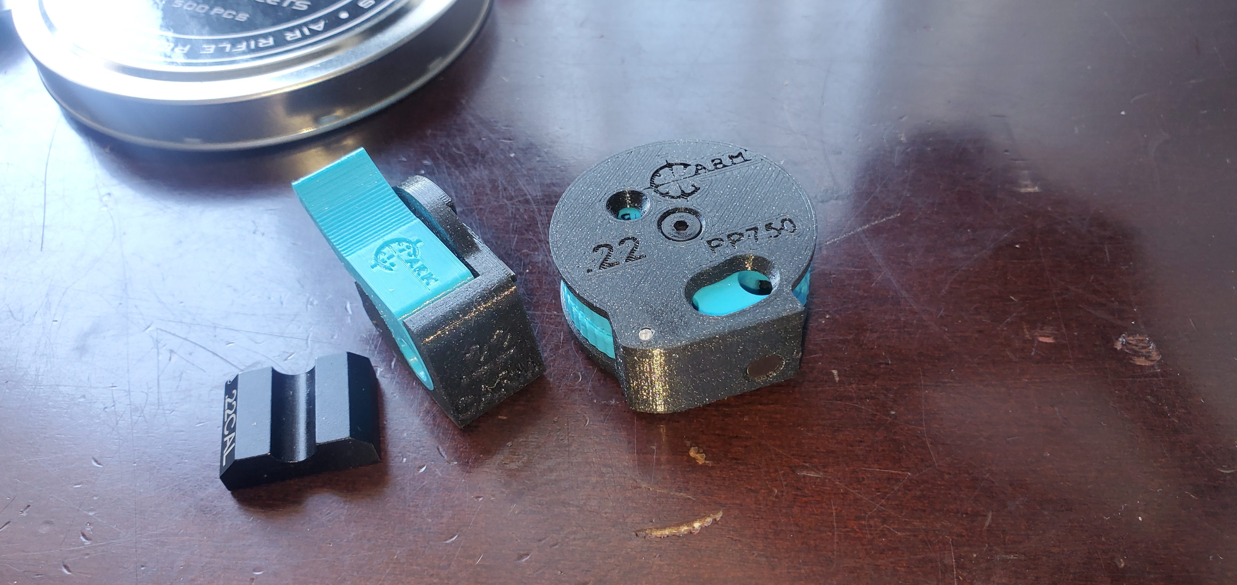

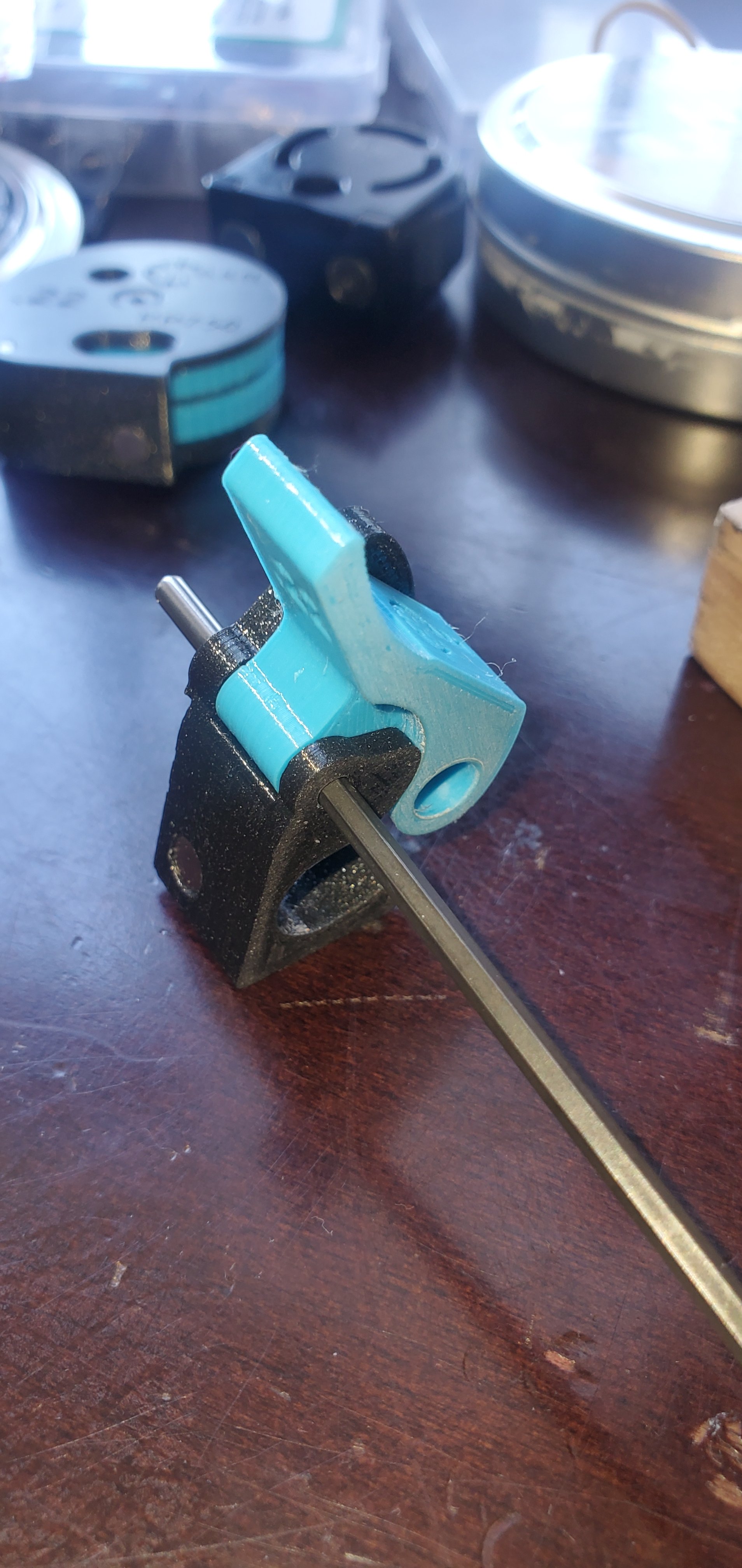

But I like better than the factory mags and the single loader is loads easier than single loading yourself.
Plus you can buy the other mags for your other guns at the same time.
Allen

Will a Polymag fit without binding the mag rotation?
Thanks!
K9
I had to see if i had any..
If it is loaded correctly yes. And this is with the polymag shorts.
Because if you let the tip go into the opening it will not rotate.
In the single loader. There is nothing to hold the pellet in place so it will slide out if tipped back any. Forward movement is not a problem as there is a plastic wall that will block the pellet from falling forward.
Allen

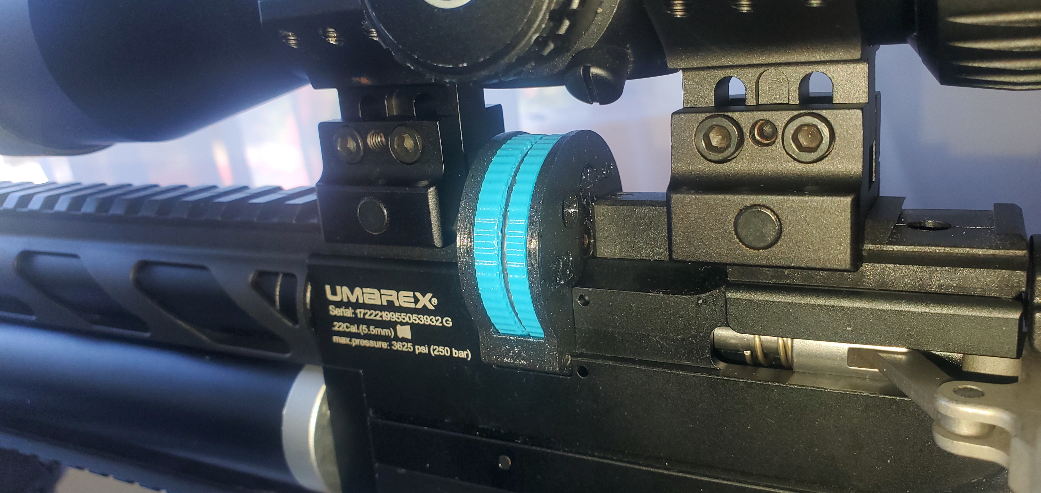

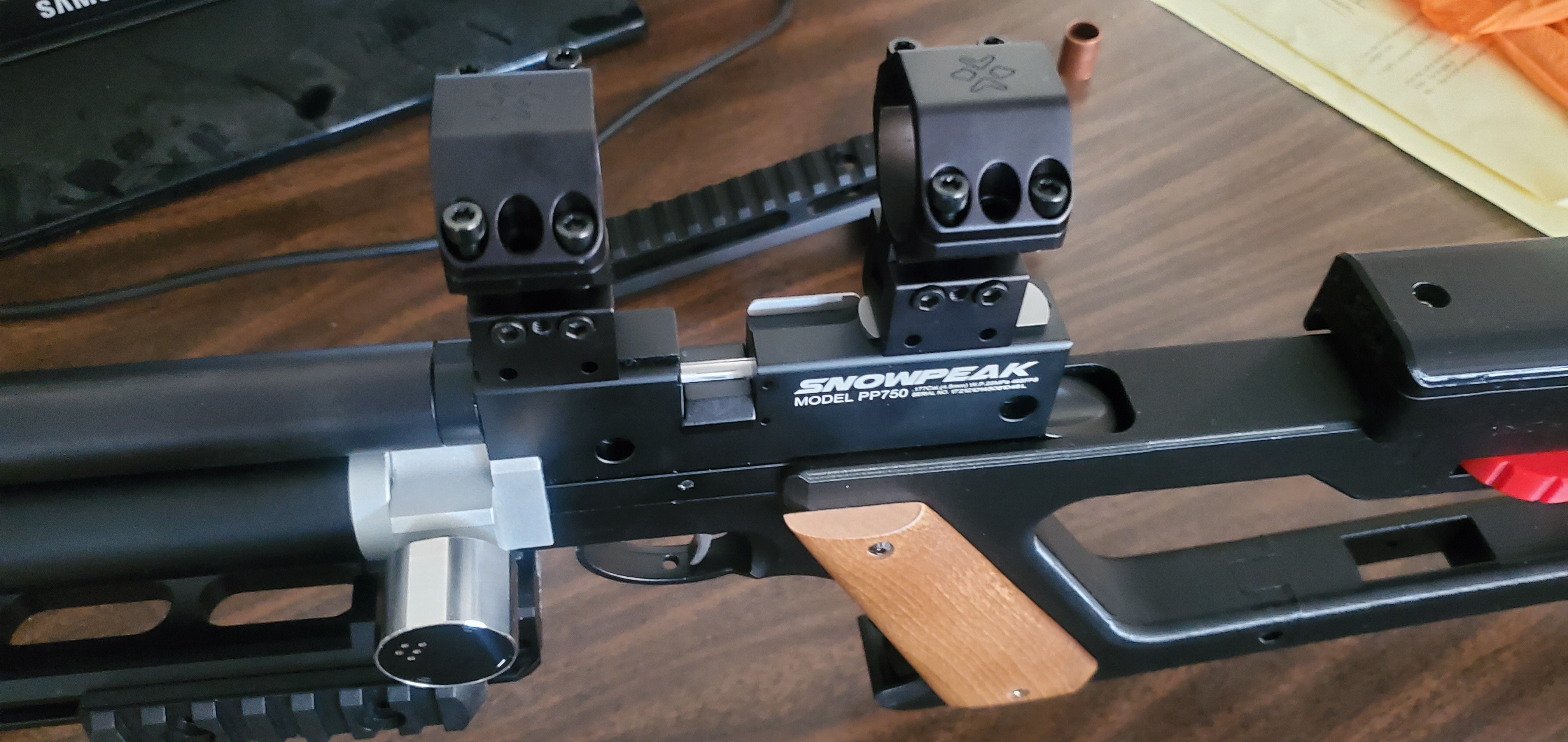

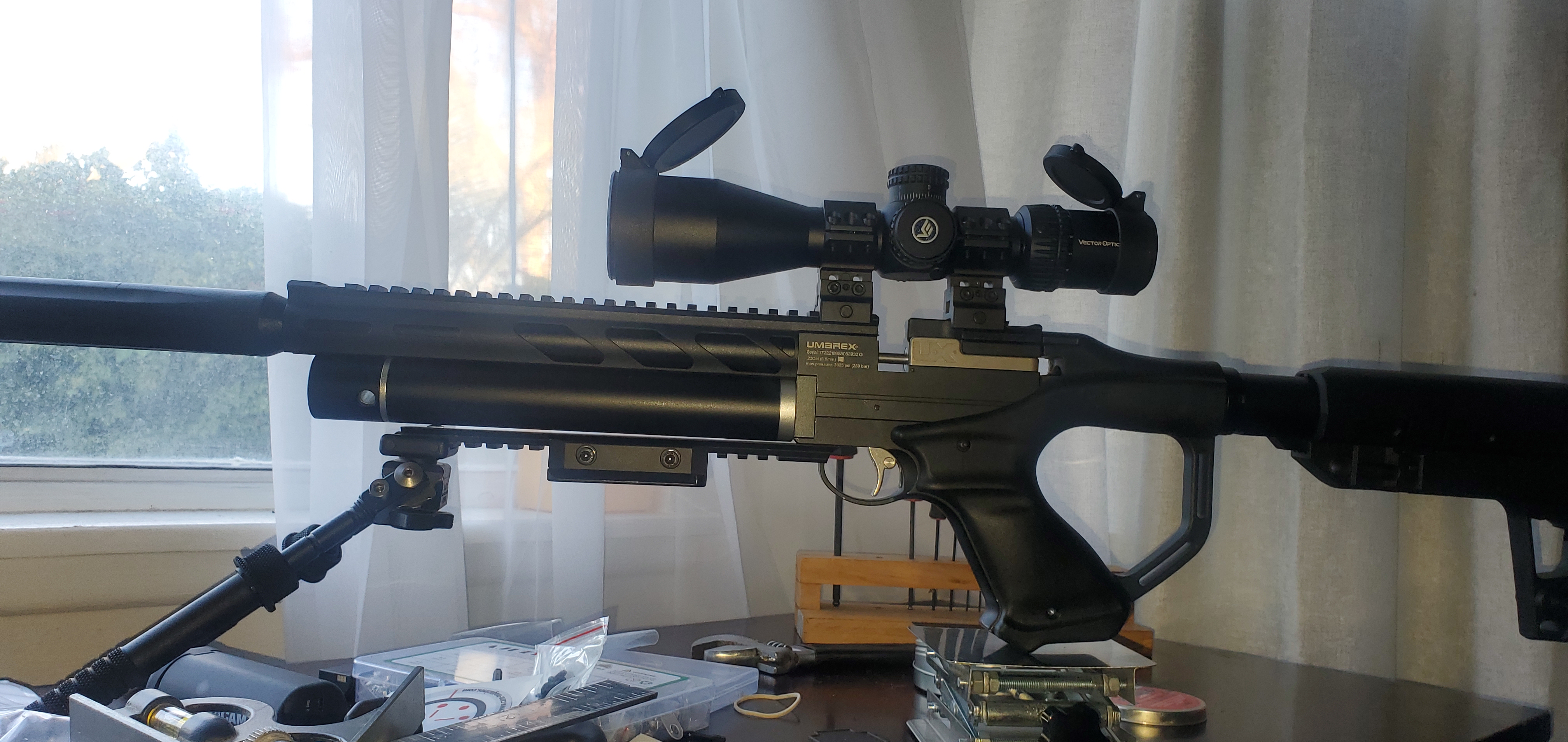

If you guys put a scope on this using both the front and rear scope rail, I recommend using adjustable scope rings as the front and rear pic rails are not perfectly on the same plane as each other. Good enough but not the same. The cheap ones will work on these plastic picatinny rail sections. While not perfect these do work well for my Notos and the pp750. They did not work well on my daystate so use caution.
You can probably swap the torx cap screws with normal Allen screws.
I just used the outer 4 corners for hold down 6 was a bit much for me to screw around with. They are available in both picatinny and dovetail.
However, please note that 2 of the three sets I bought did not come with a tool for the torx head cap screws! I had a regular tool so it was no big deal for me.
