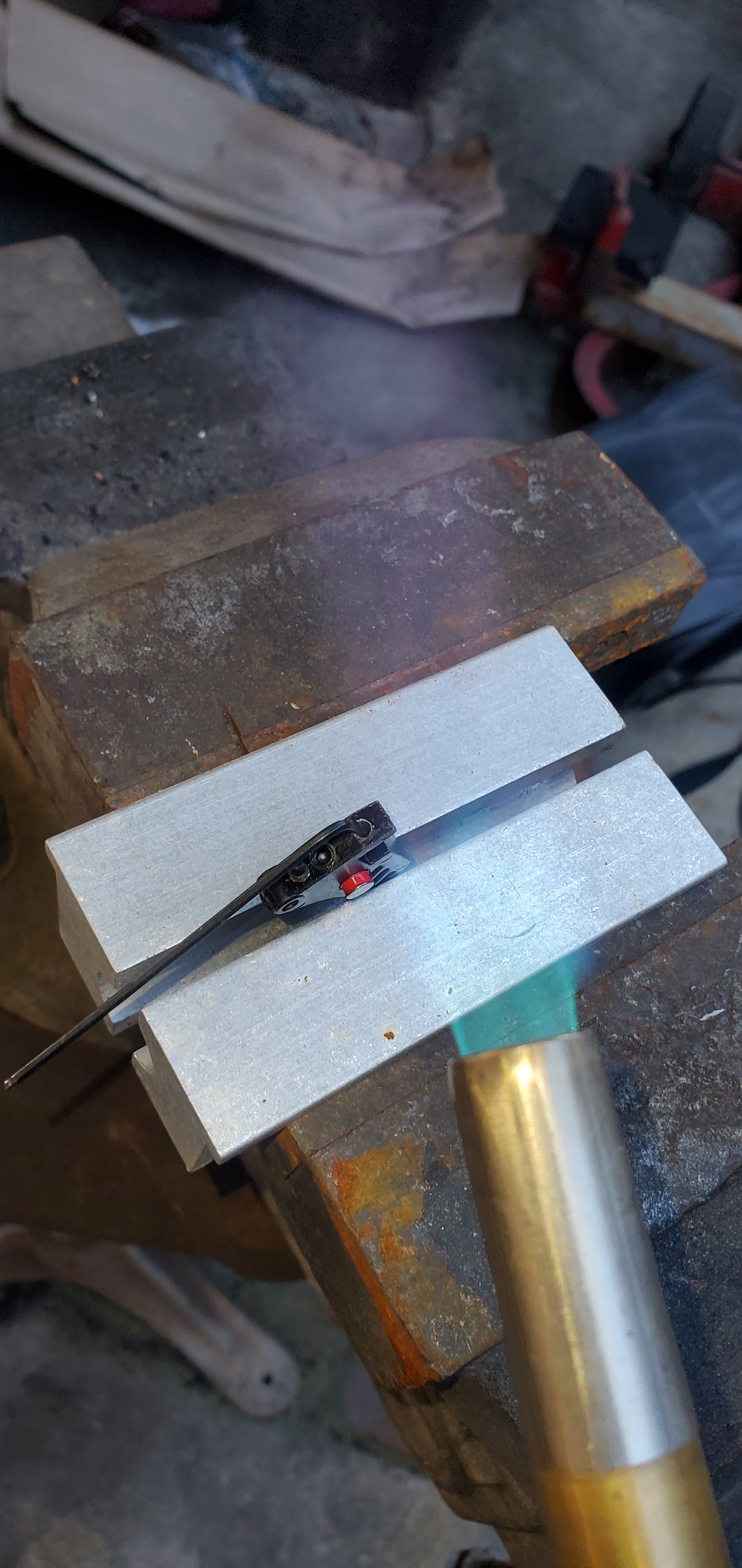

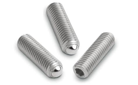

Reading about you rounding off the sharp point of the set screw in the trigger made me think of these ball end ( rolling,) ones i looked at for a project..
If a guy wanted to spend on maybe really smoothing things out ..

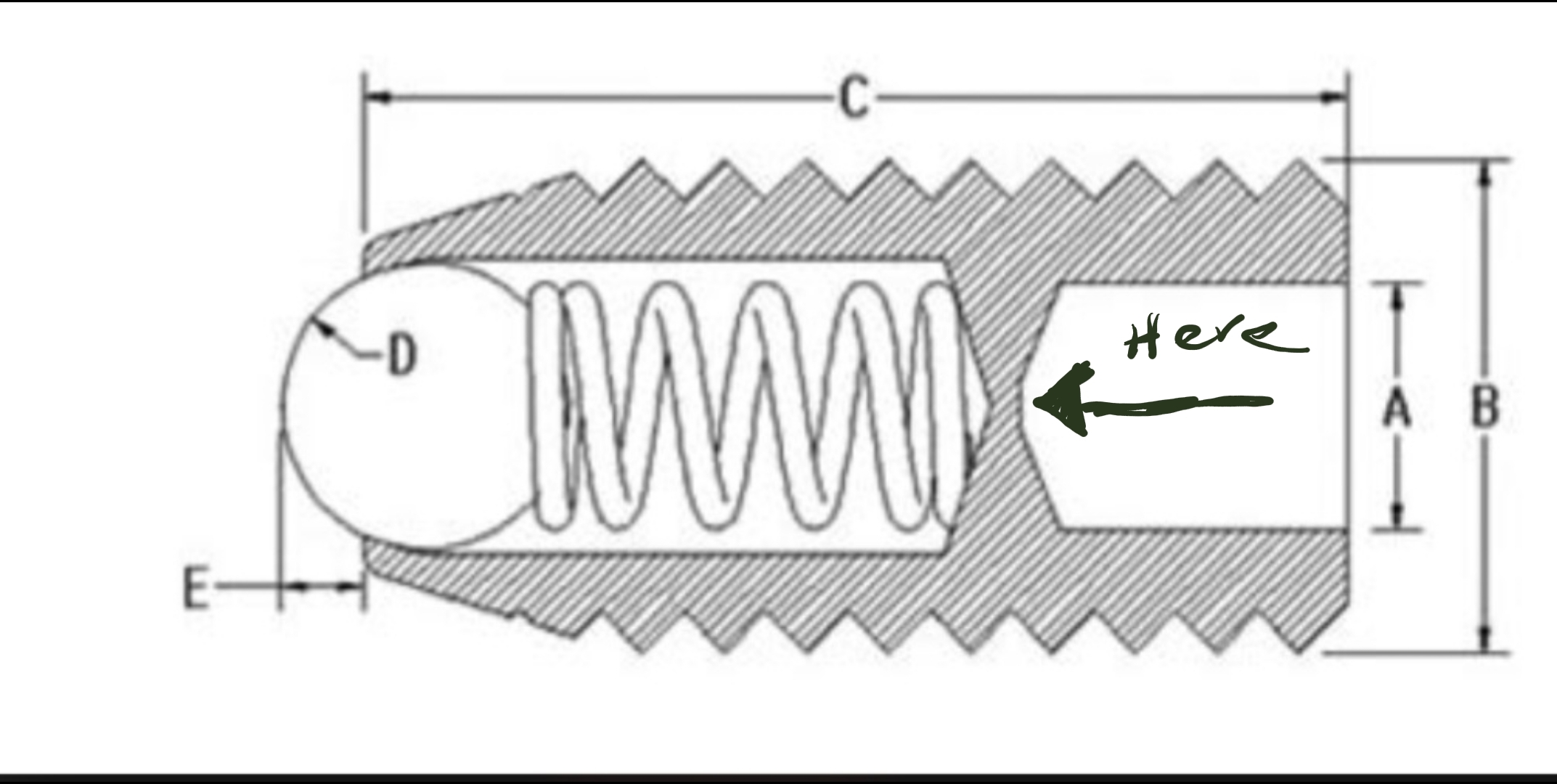

Do those have a spring behind them? Would you happen to have a link to them? Thanks, I was trying to find the ones without. The ones I got in post 218 have a spring behind them. I first cleaned them in a couple drops of brake clean then pushed the tip in and out of a drop of super glue to get the area behind the ball and where the spring is full of superglue. I then spayed some activator and cleaned the excess glue.
I thought the Spring inside them was strong enough to not compress but after playing with the action several times I can see that I was wrong about the Spring not compressing. That's why I ended up filling it full of super glue.

Should. The ones i looked claimed to.. there roller type.
Lol.. in the end i cheaped out and just rounded the ones i had as well... ( I think size was another killjoy)
I just recalled them and put it here for ideas or a option to ponder.
Oh.. there were like plastic/Teflon tiped ones too..

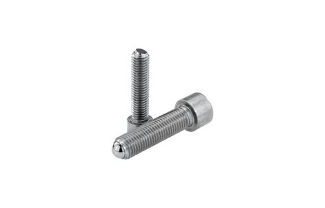

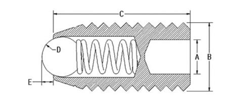

You know it's good you showed the picture
it gives me a better idea to bypass the spring! I can drill a hole on the backside and put a fill material in from there or even knock the ball out and put material in the void! 😊👍
Oh I got mine here on Amazon of course! Amazon is great for lazy people like me!
uxcell Ball Point Set Screws, 20pcs M3 x 12mm High Carbon Steel Metric Spring Hex Socket Grub Screw https://a.co/d/8NzHen4
Allen
