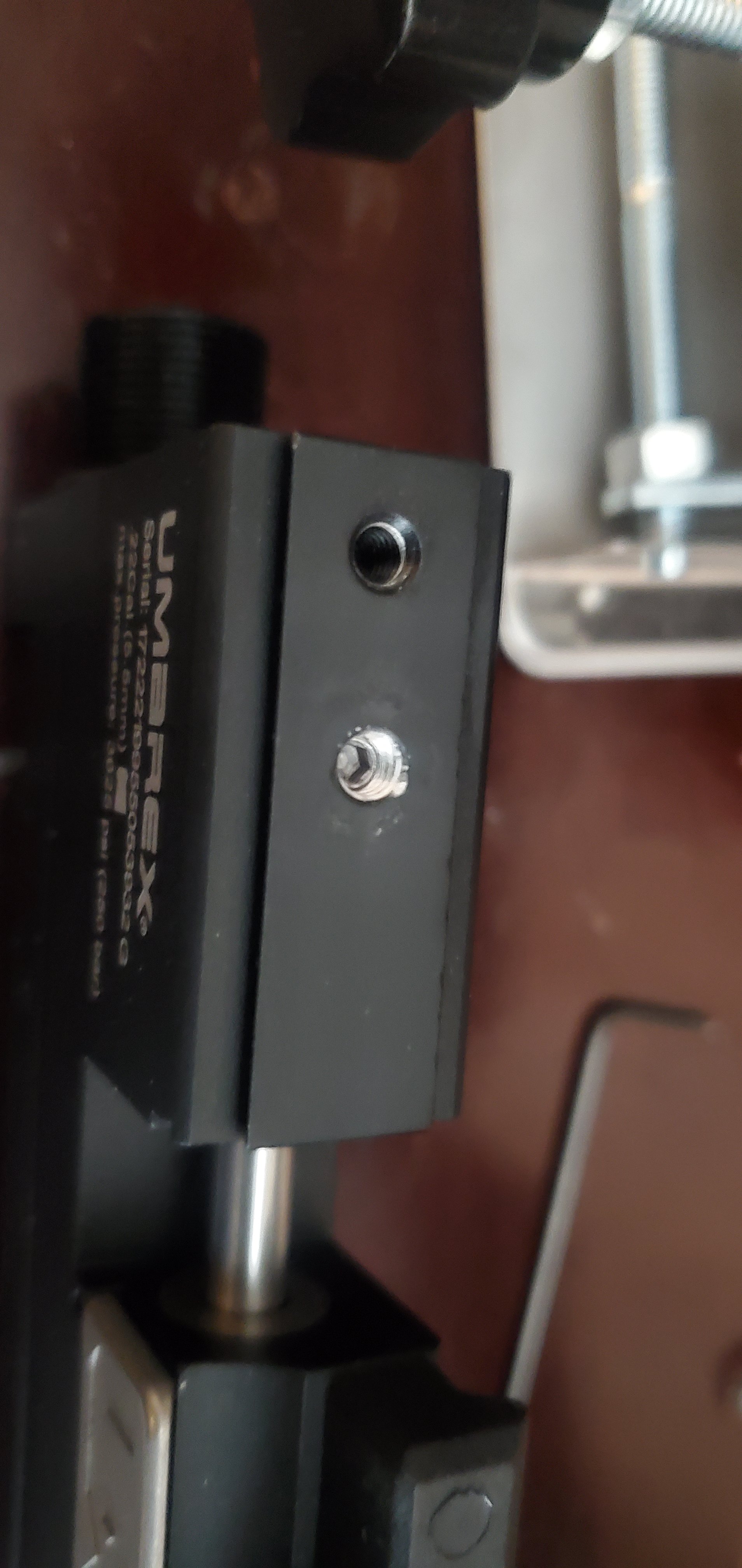

Ok word of warning again for those who decide to pull the barrel. The other night I went to pull the Notos back together and of course the grub screw decides not to move! Worst was my new Allen wrench skipped and rounded off. Ugh! Took it to work yesterday to get a better look and yup I have to drill it out. Took some tools home and put it in the cheap drill press. Note to self, don't ever buy a cheap drill press.

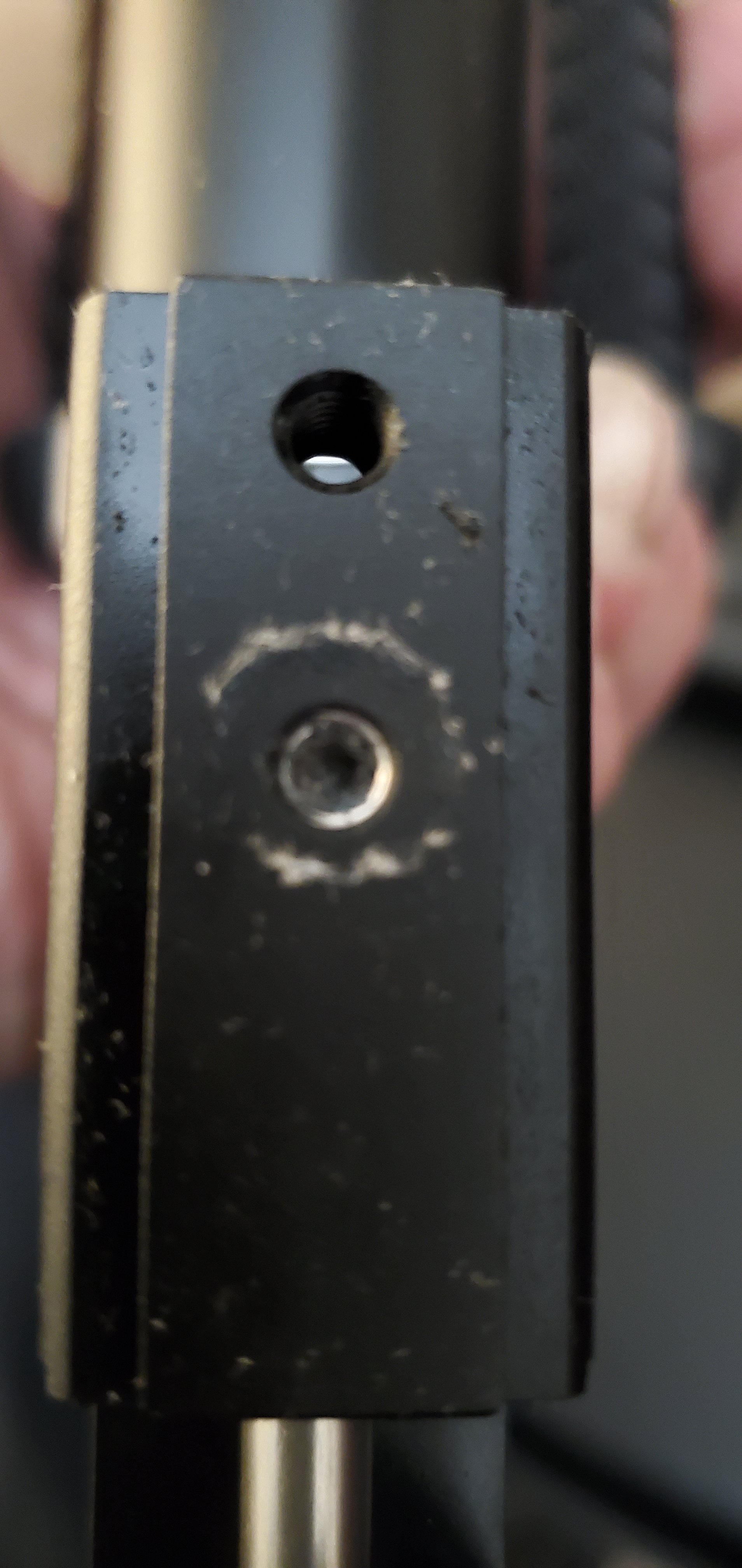

That is excess locktite around the hole and the rounded grub screw. Sorry camera did not focus

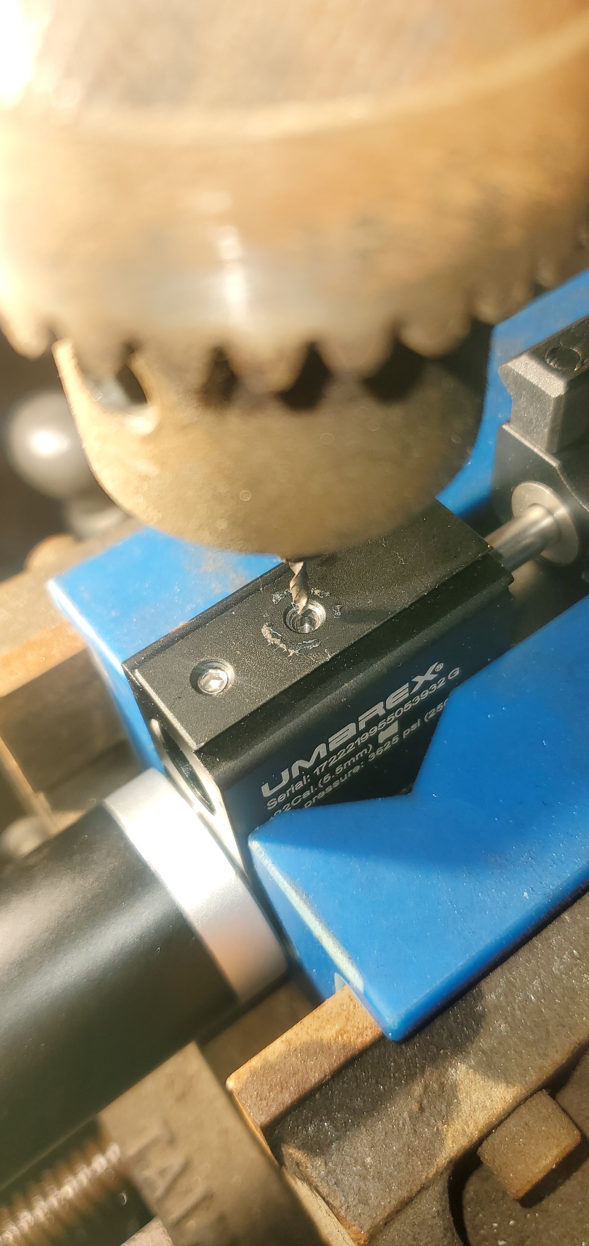

Me carefully drilling out the grub screw. And just so you guys are aware that other hole can probably be used to hold the barrel in. You just need to also drill a hole in the picatinny rail to match.

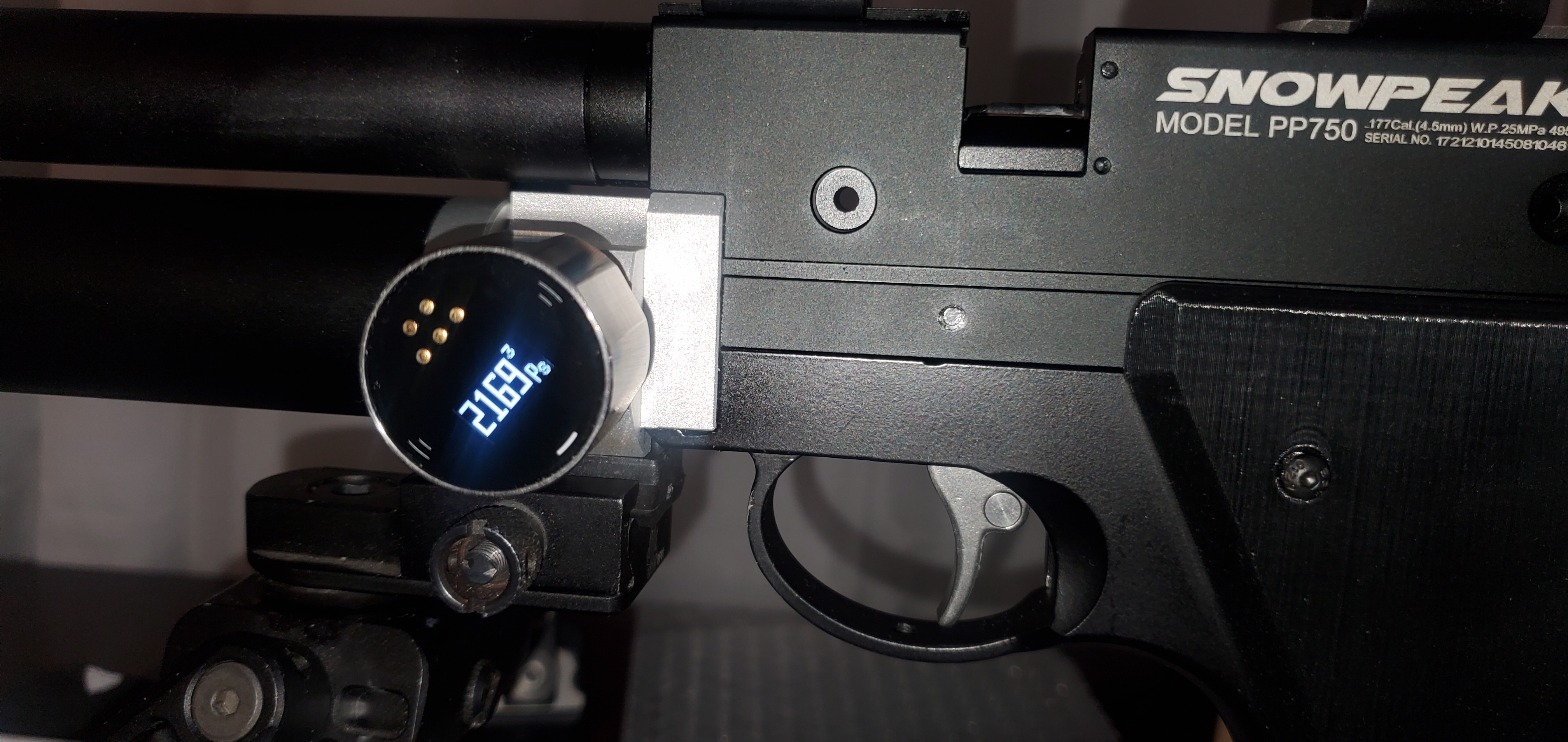

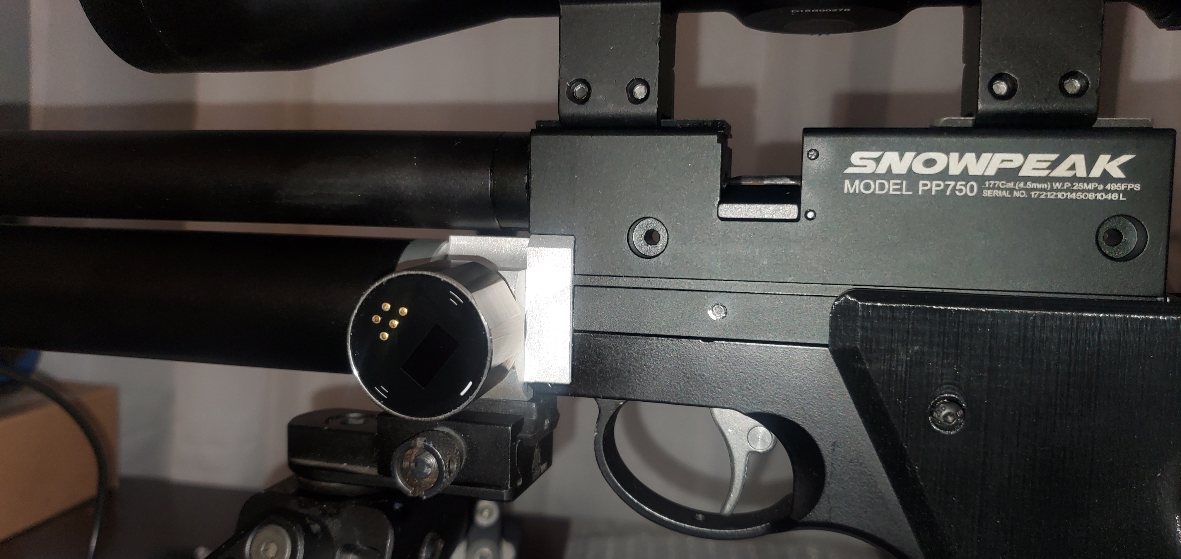

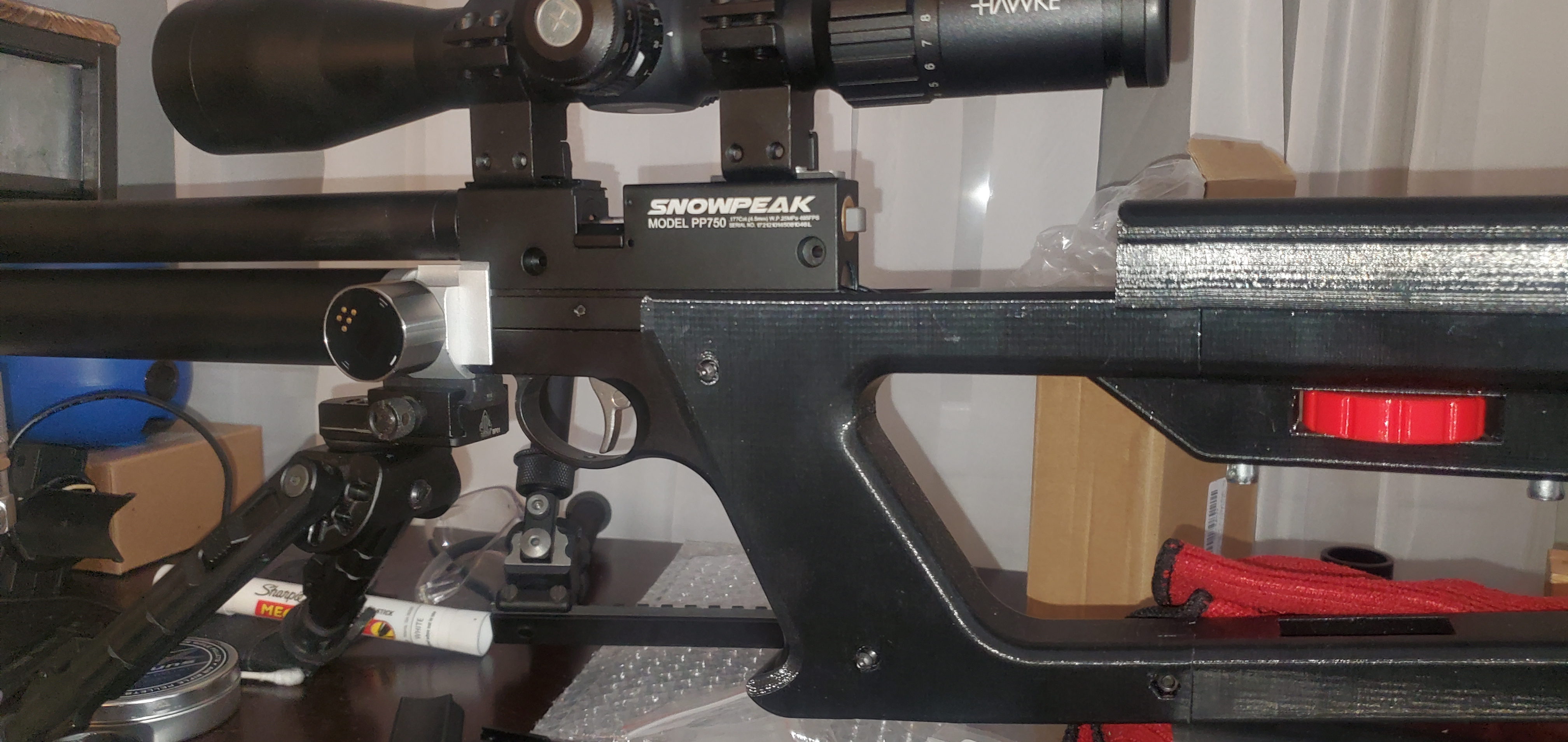

Here is something interesting since I had the barrel and the air tube off I thought hmmm I wonder what the reg is set at? So I pull the other air tube off of the pp750 with the gauge on the regulated air. Oh by the way I also put a digital gauge on inplace of the tiny analog that was on there.
Guess where the notos is regulated at? They gave us a hint.
Oops forgot to put it in but first fill to max it went...
About 147 bar.

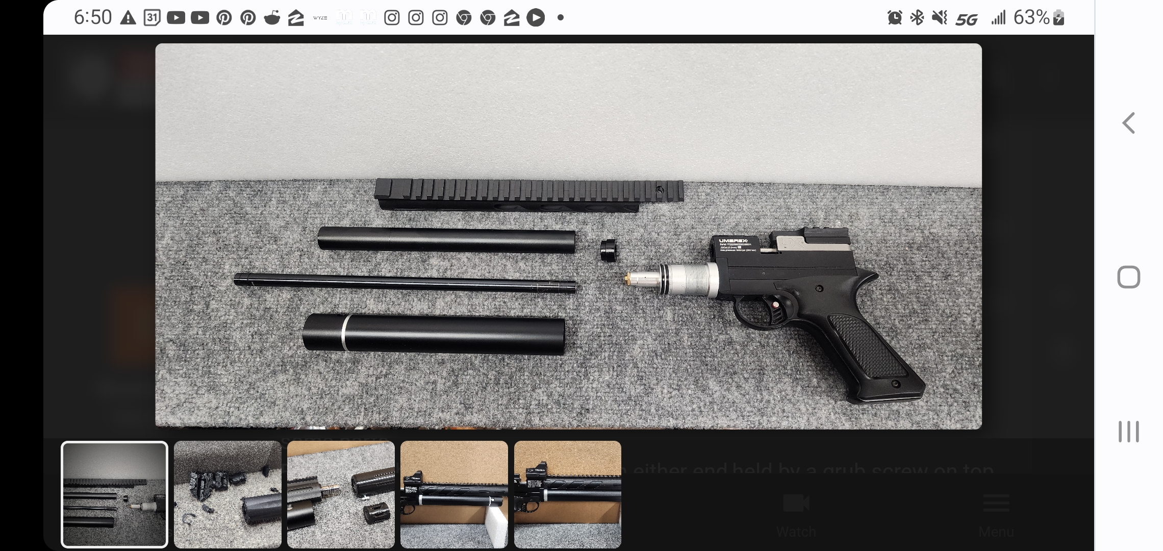

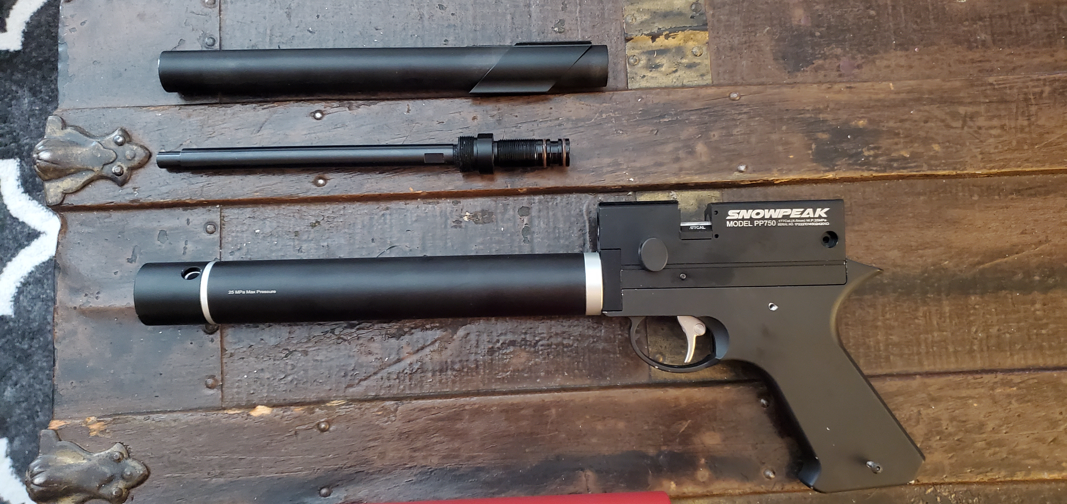

The pp750 has a shorter barrel. Longer barrel allows more time for acceleration.
However the shorter barrel allows baffling in the shroud. The Notos does not have any baffling at all in the shroud.
The Notos barrel is actually longer than the barrel shroud and extends into the moderator.
The Notos barrel is actually longer than the barrel and extends into the moderator.
About 147 bar.
Allen
I think the published fpe numbers and shot count on pyramyd would be true with the reg set at @1900 psi… I would guess that’s probably what they originally intended.
