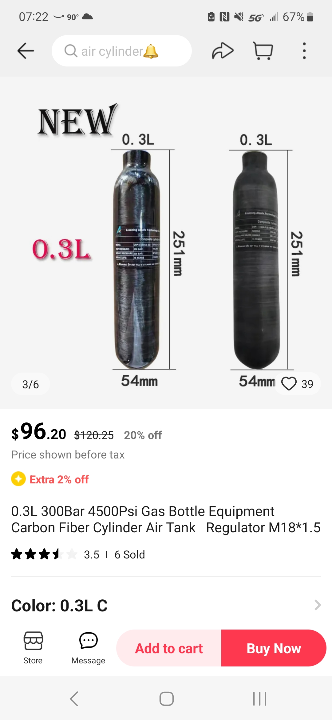

I will be switching to a .22L bottle (smaller OD) this winter for weight savings and to shorten it up some. I have also found another adjustable regulator that is shorter I will be doing trials on when it arrives so that we have more options in the future.
Found this on AliExpress, also with a smaller OD
