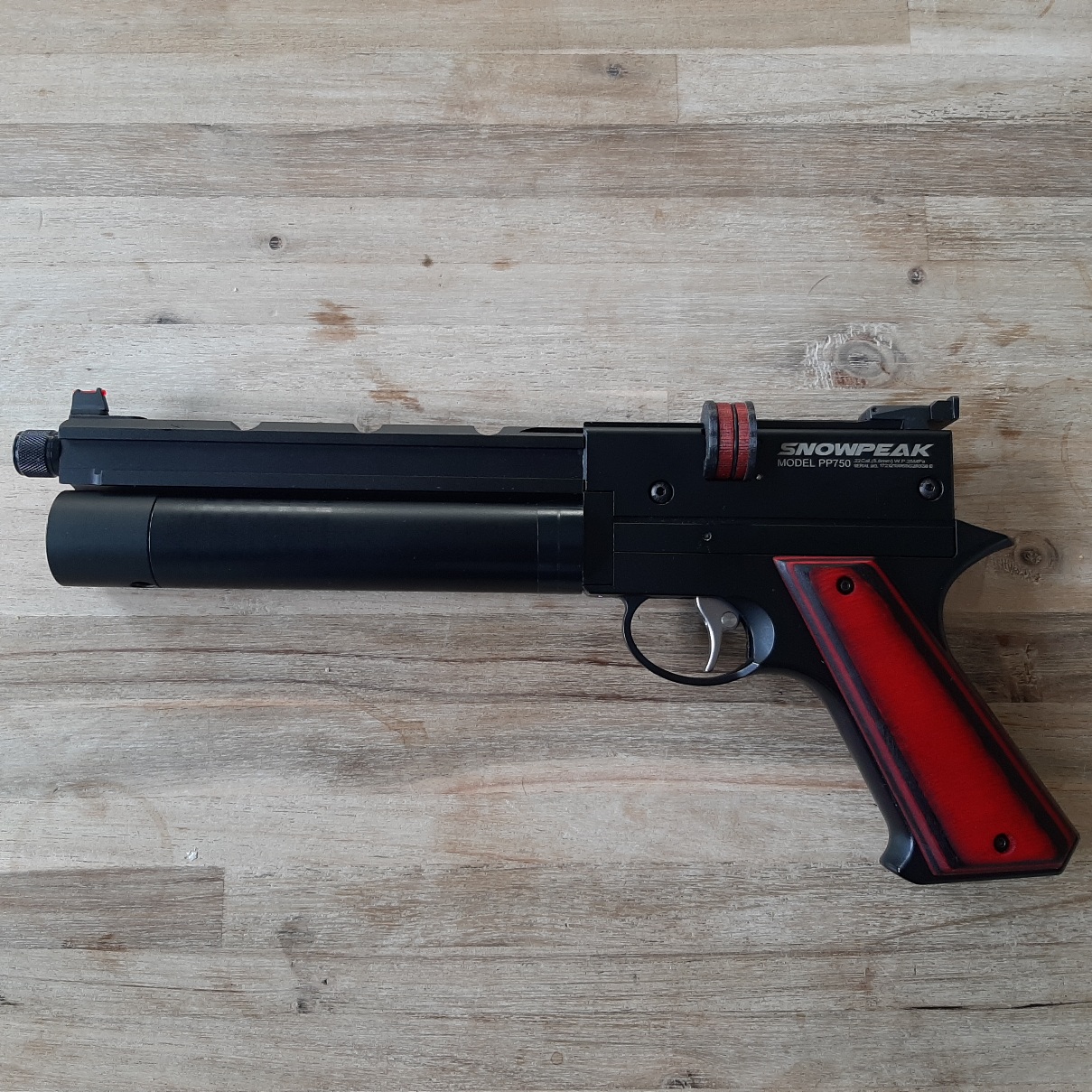

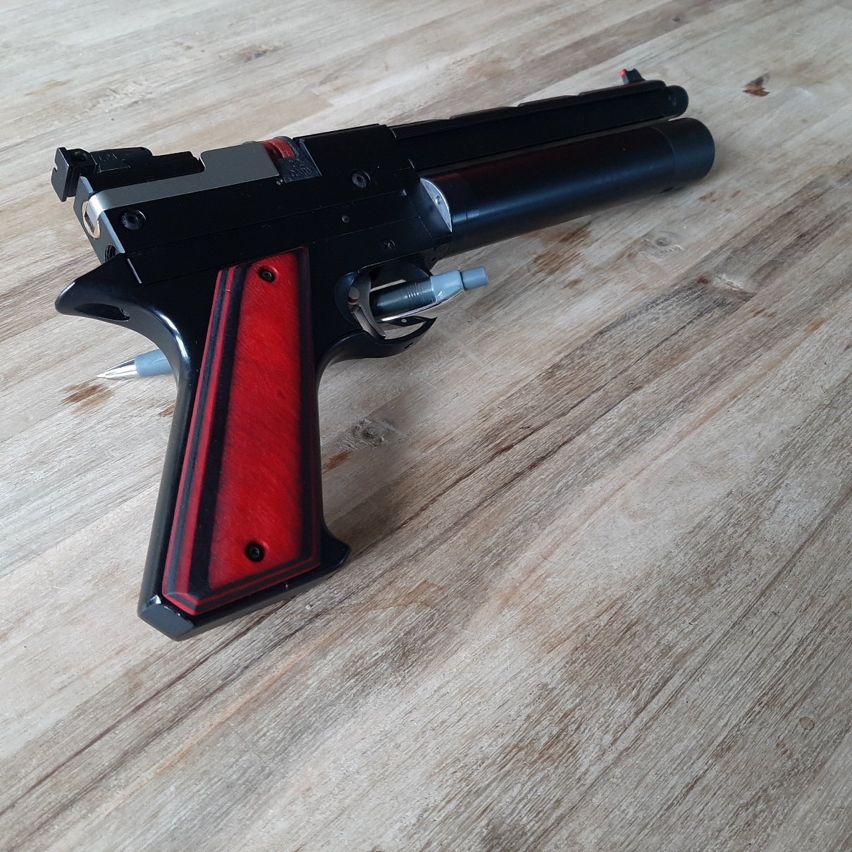

I own a PP750, wich the Notos is based on.
I modified it, made it 5cm shorter so it is better balanced.
Put also LPA sights on it.

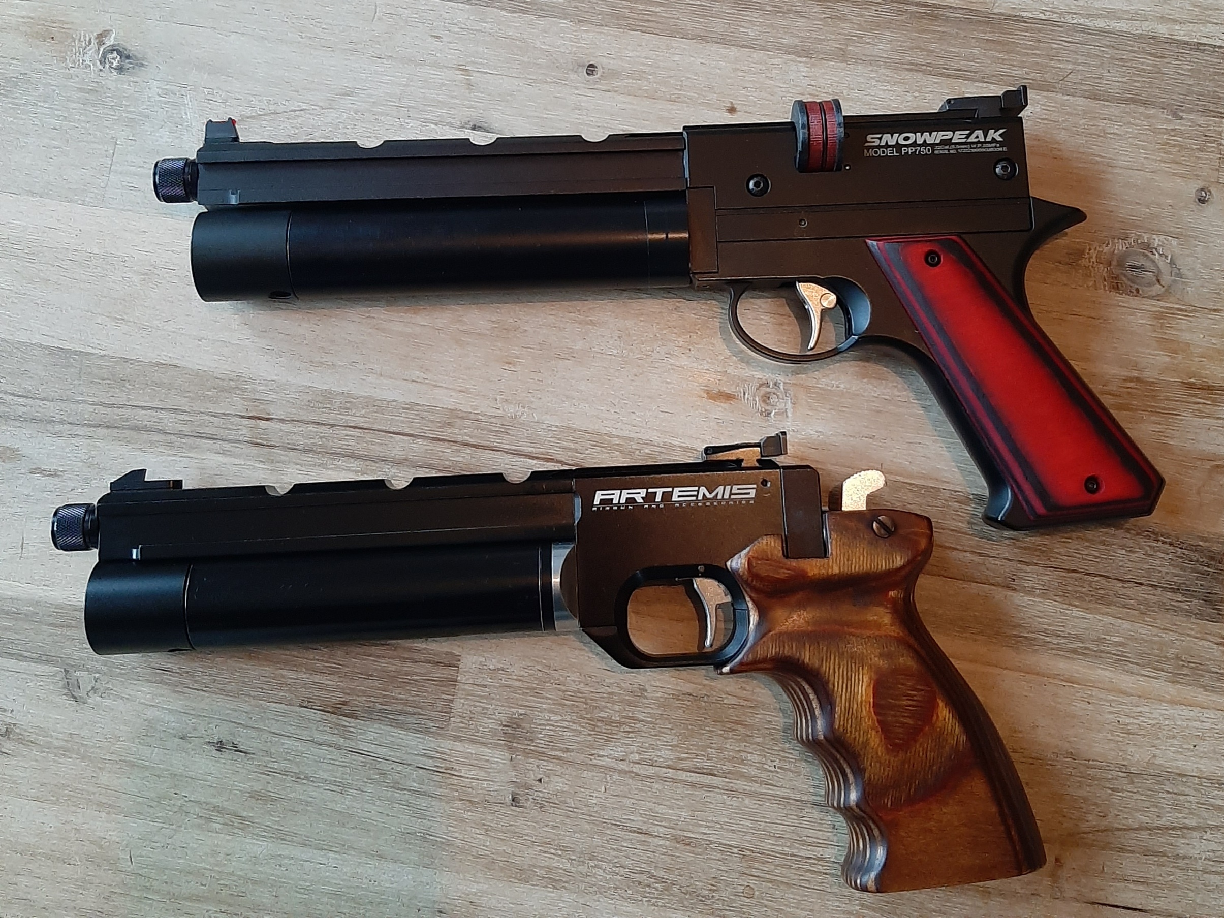

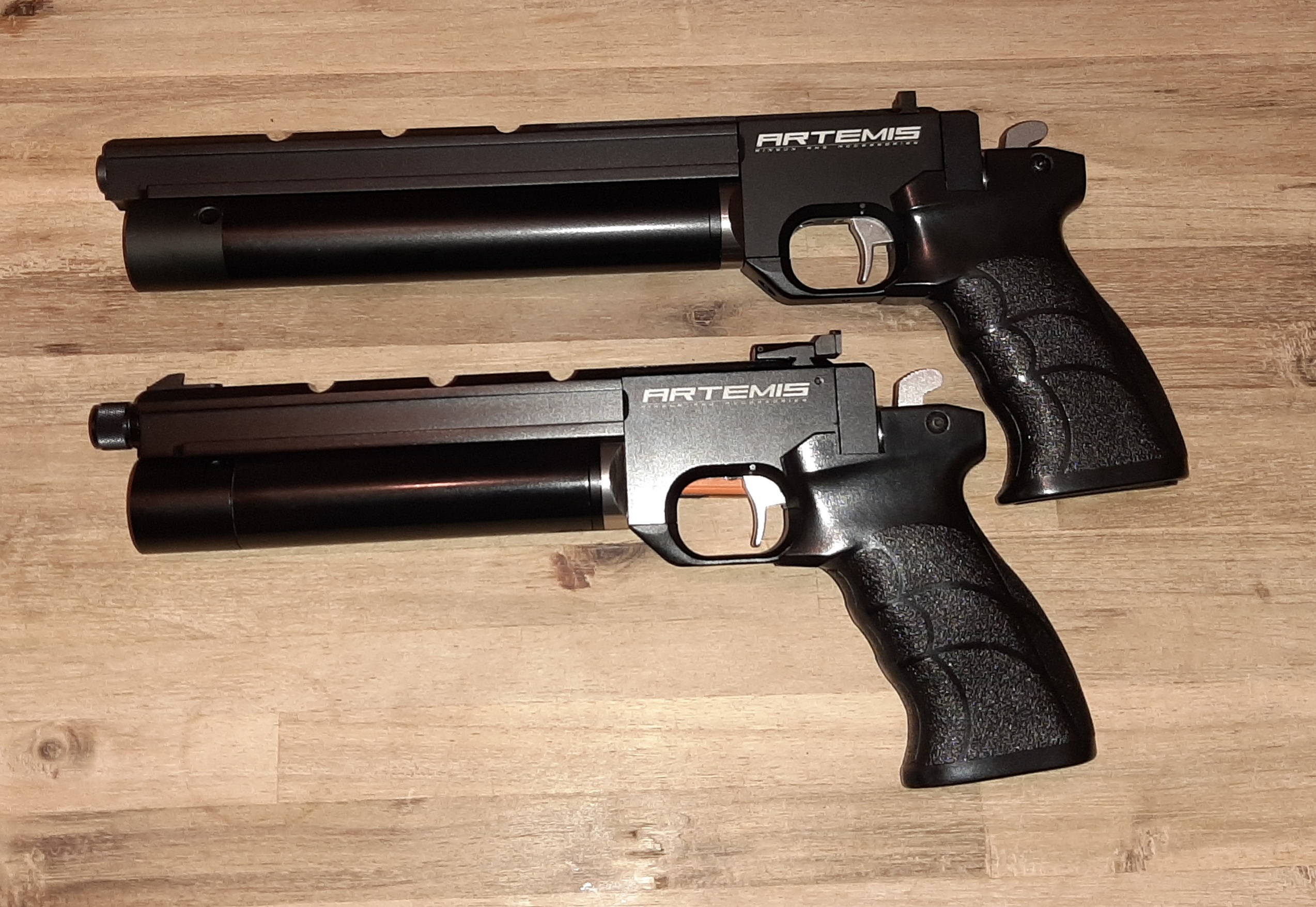

I wanten to have a compact pistol.
I like mine PP700S-A, wich I also made more compact better then the PP750 as a pistol.
A normal version on top, mine compact beneath it.
I made later a wooden grip. Here they are both
The PP700S-A is in Total 32CM long, a bit like the Ataman AP16 compact
The PP750 is 34CM long
