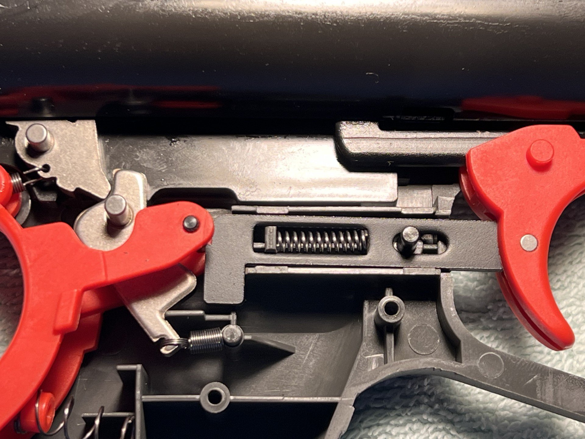

so, opened up it came and to my surprise a very complicated trigger group
you have the grip safety that blocks the triggers rearward movement
it has a forward spring that is retained on the grip safety
has a upper pin that acts as the upper sear reset spring attached
the trigger has a spring in the slide assembly that has to be compressed to reach the lower sear and it acts as a trigger reset
push the lower sear and that disengaged the upper sear
both upper and lower have reset springs
so why is the trigger so heavy because of the main sporing pressure on the upper sear
can the grip safety be pinned YES
can the trigger be made lighter yes some the trigger return spring can be lighten and at the same time engagement can be made to happen faster HOW
use lighter spring and fill the inside of the spring with a grub screw
now the rest
you can make the area that the upper and lower sear engage less, making the trigger pull fast
all the lower sear is doing is clearing the upper sear

SO COULD THE TRIGGER BE IMPROVED
YES

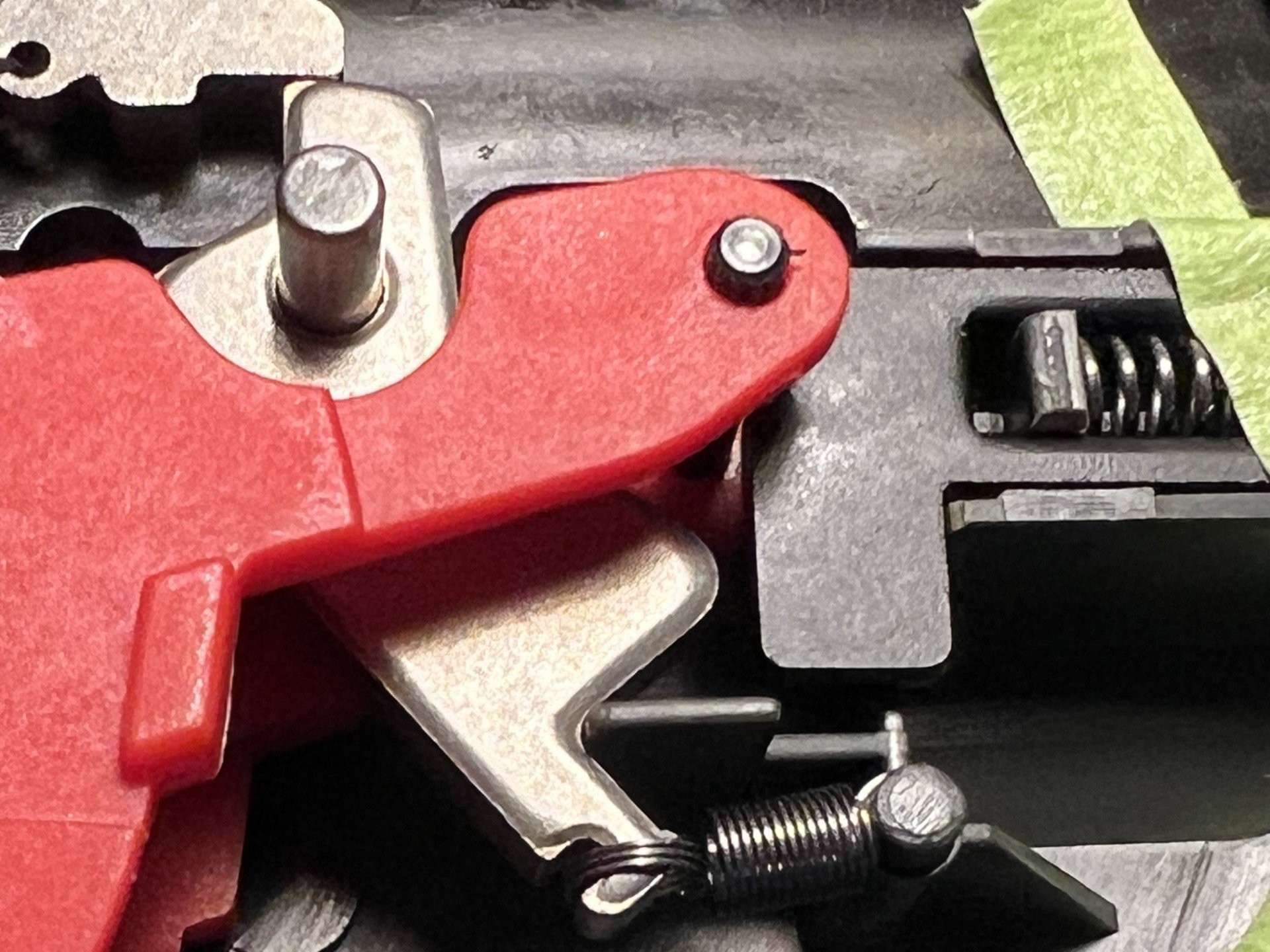

first off, the 2 sears are very well made, they are thick and smooth high quality piece
terminality
upper sear
lower sear
trigger bar
changes
the upper sear had its contact point reduced 0.8-1.00mm
the trigger bar had a drill end of 1.67mm added with epoxy
the grip safety had the internal pin removed so it no longer stopped the trigger bar
all contact points plus got Ultimox 226 applied
the trigger pull is firm but breaks crispy vs the hard pull that was from the factory

my first trigger bar lengthening was 1.98mm so that .31mm made all the difference
