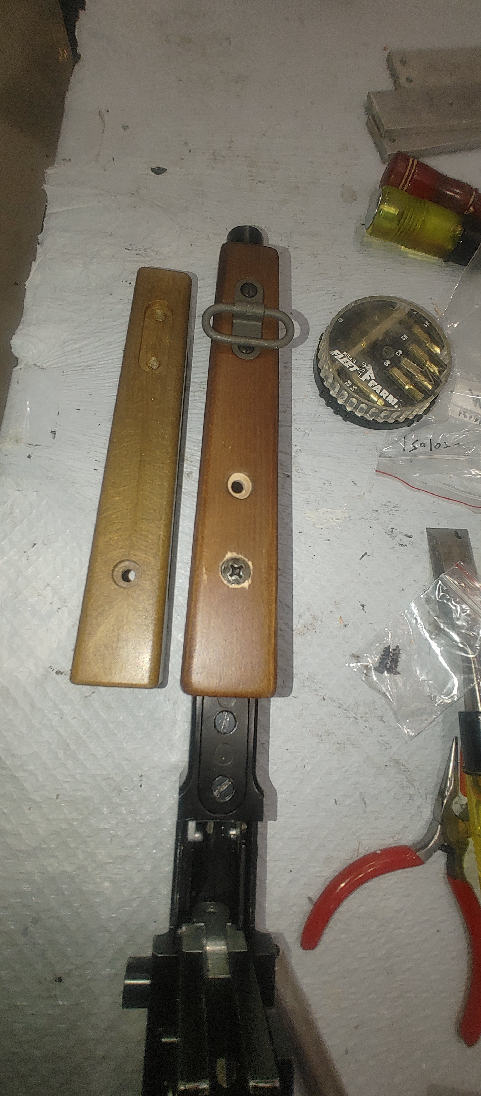

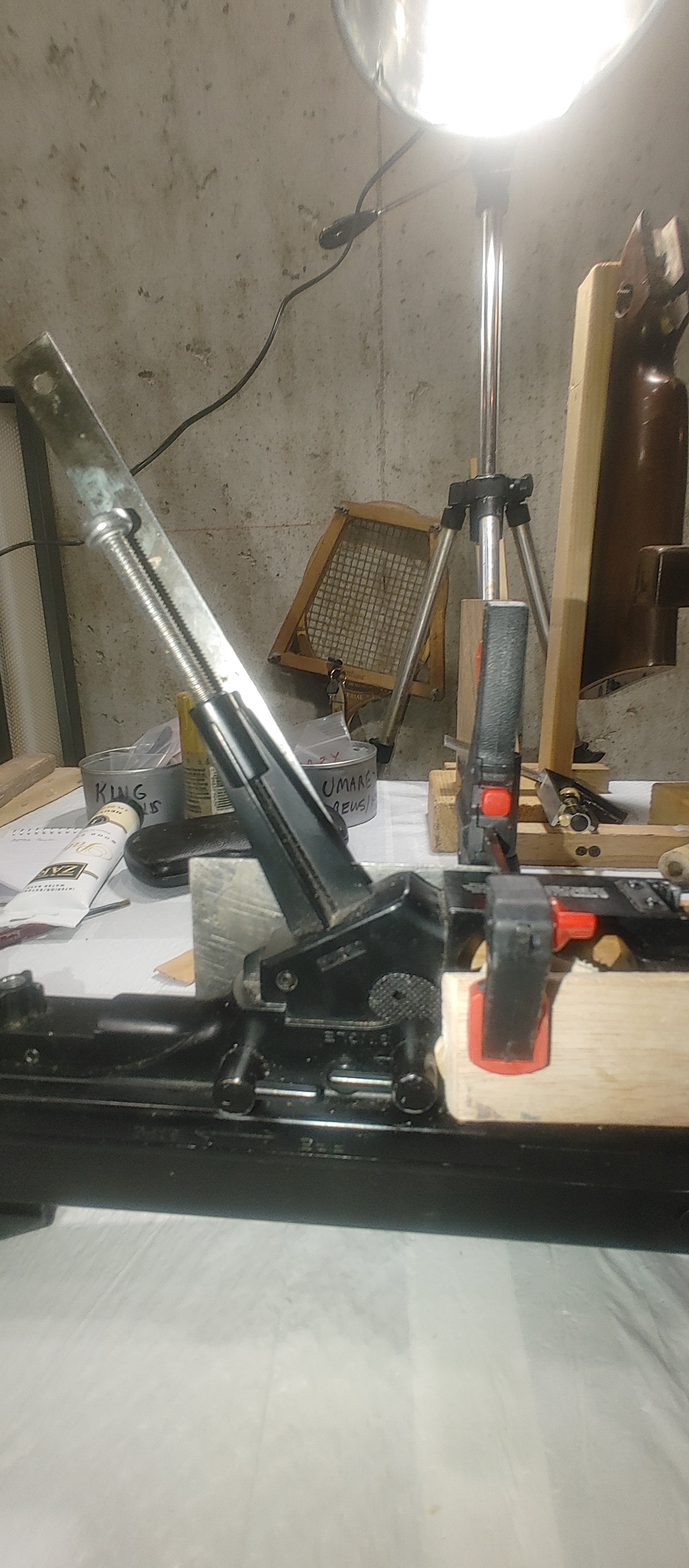

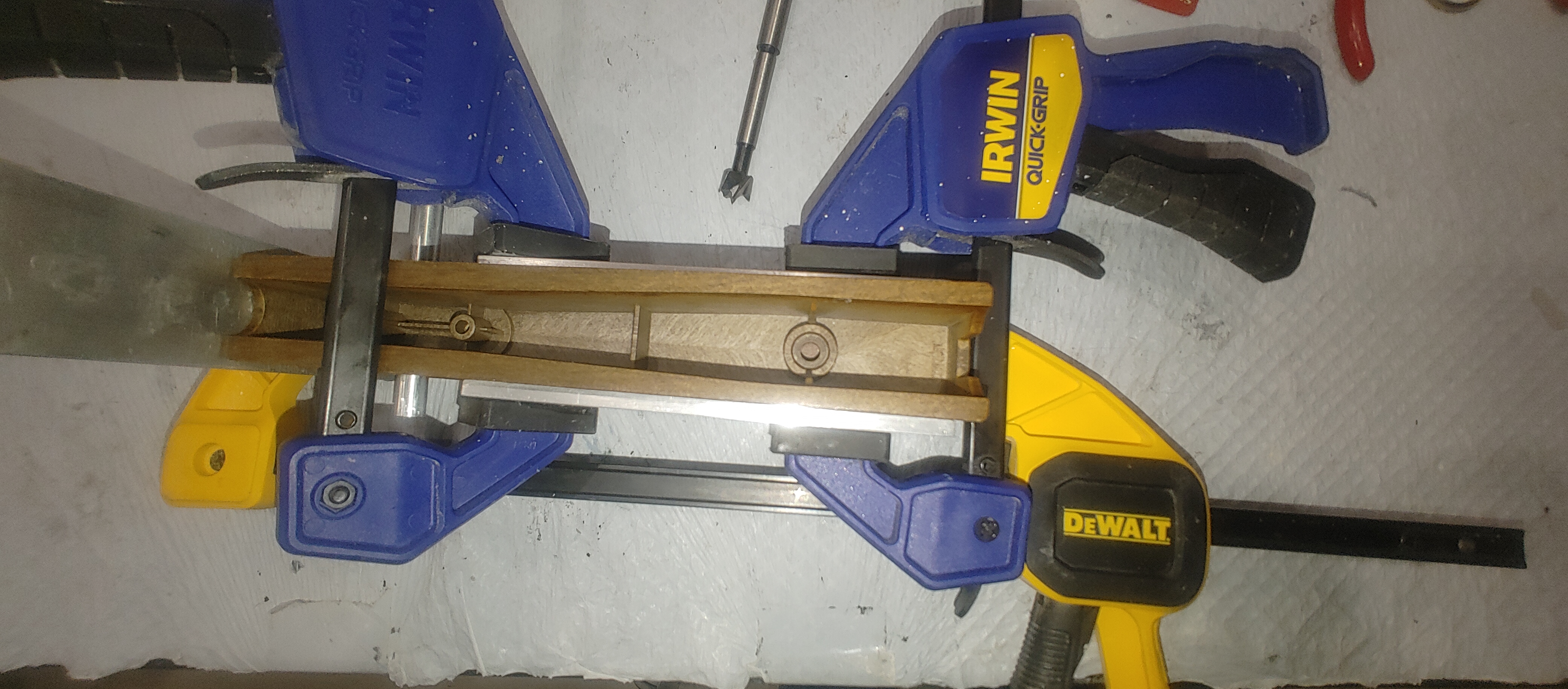

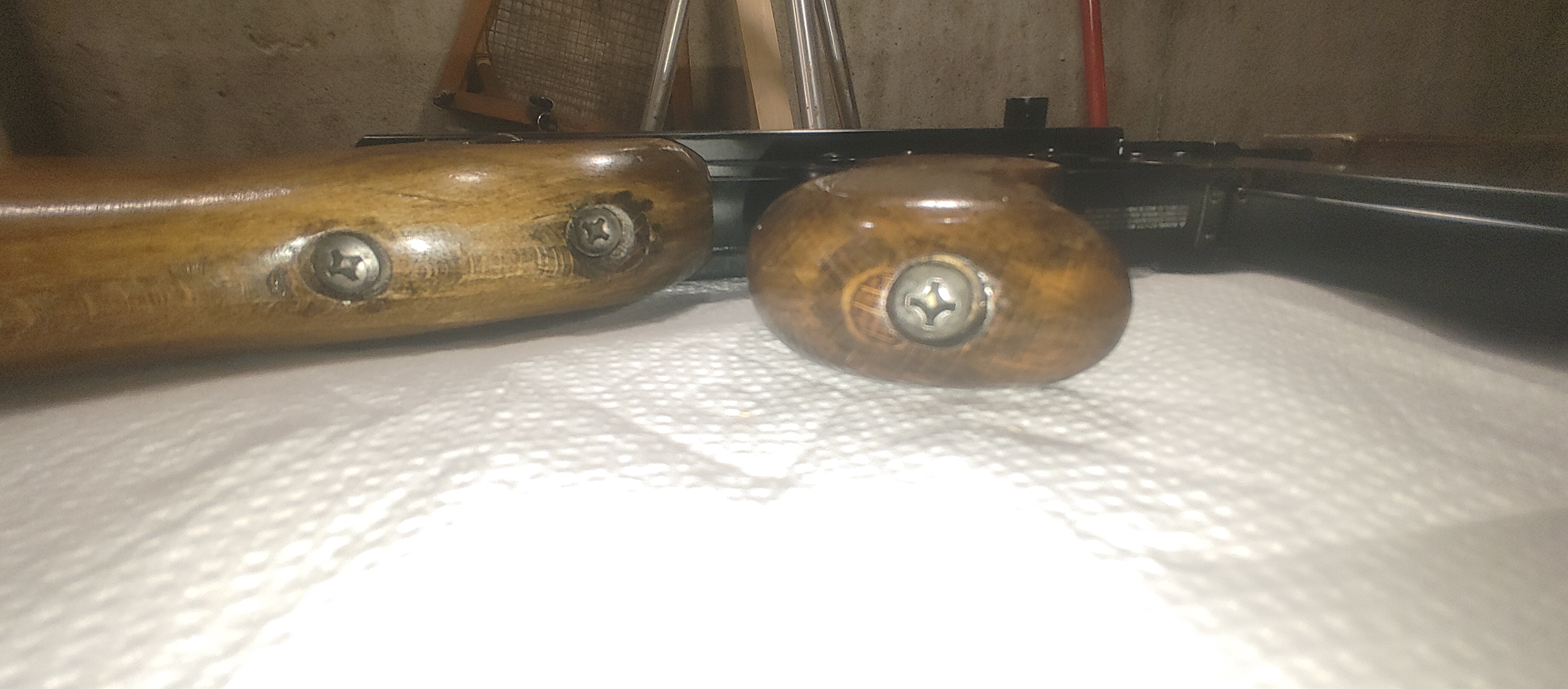

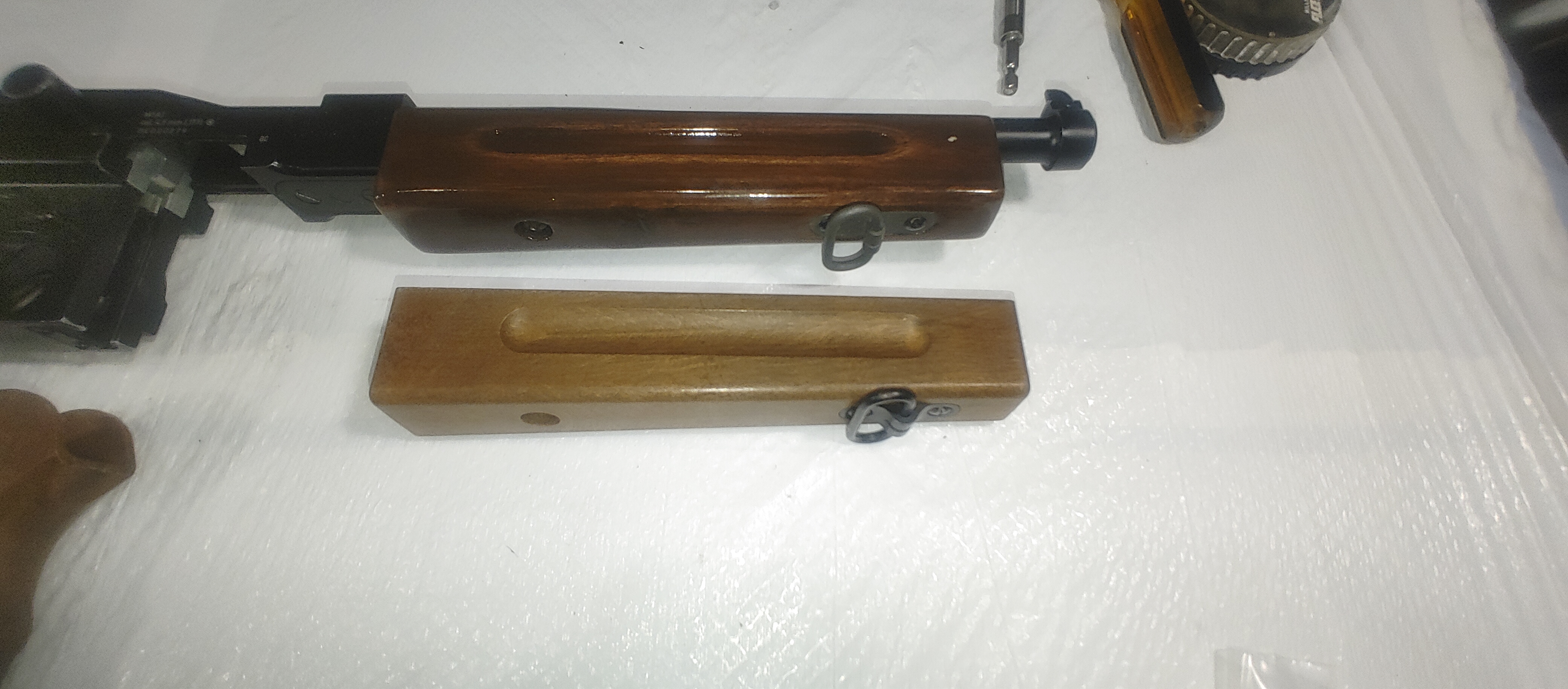

Lets start with the foregrip. This was the easiest one to do. The wood and plastic parts were the same size obviously both companies modeled their grips to match the original WWII M1A1 furniture. Pictures below show how I matched and drilled new holes and countersunk the bolt holes. I then plugged The Airsoft holes with wooden pegs/dowels. I did not want an extra hole in the foregrip.
Just pictures for now; I am changing to a new video editor so no videos for now. I aligned the UMAREX with the woos King Arms foregrip drilled the hole countersunk the outside hole and test screwed in the M6-1.00 25mm bolt. I thought to myself "Wow, that was easy." I did not care about the finish as I planned on doing that later when I had all of the furniture fitted.

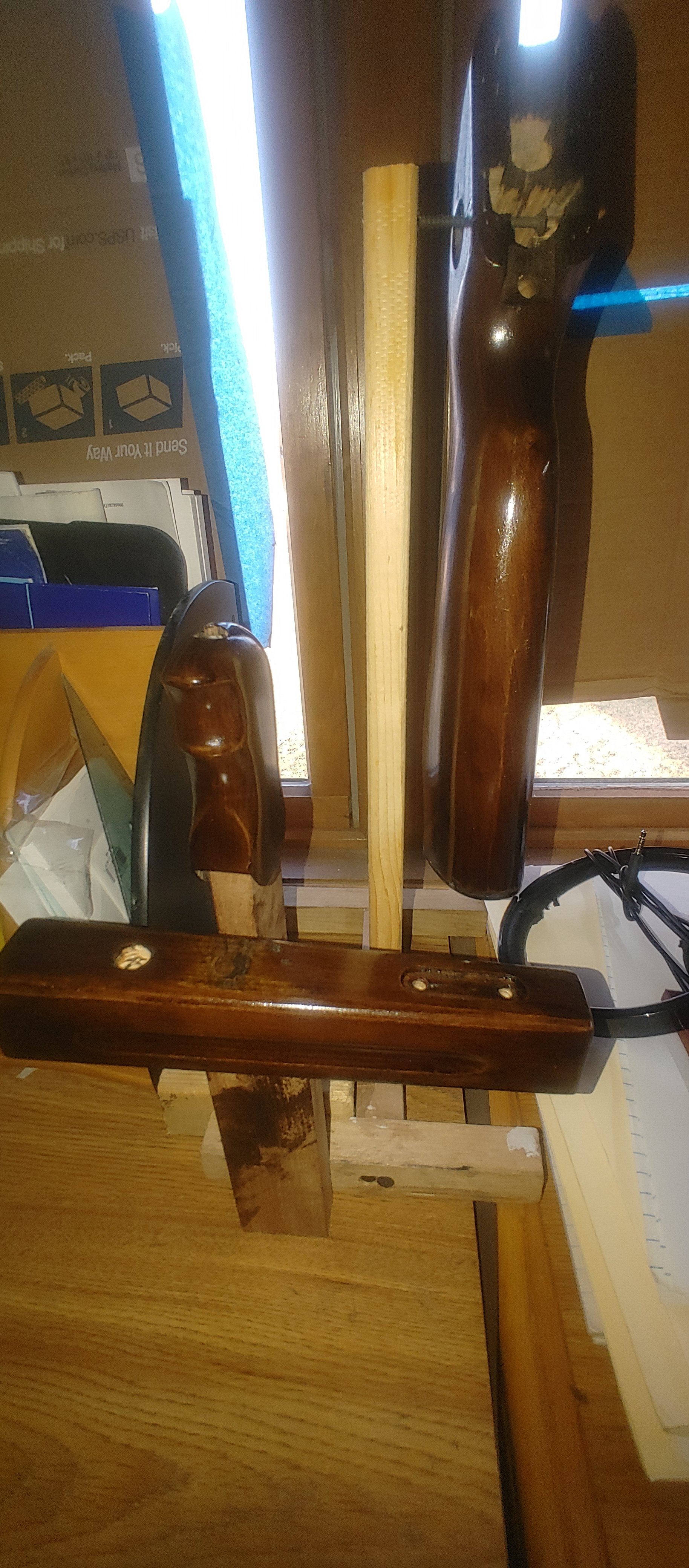

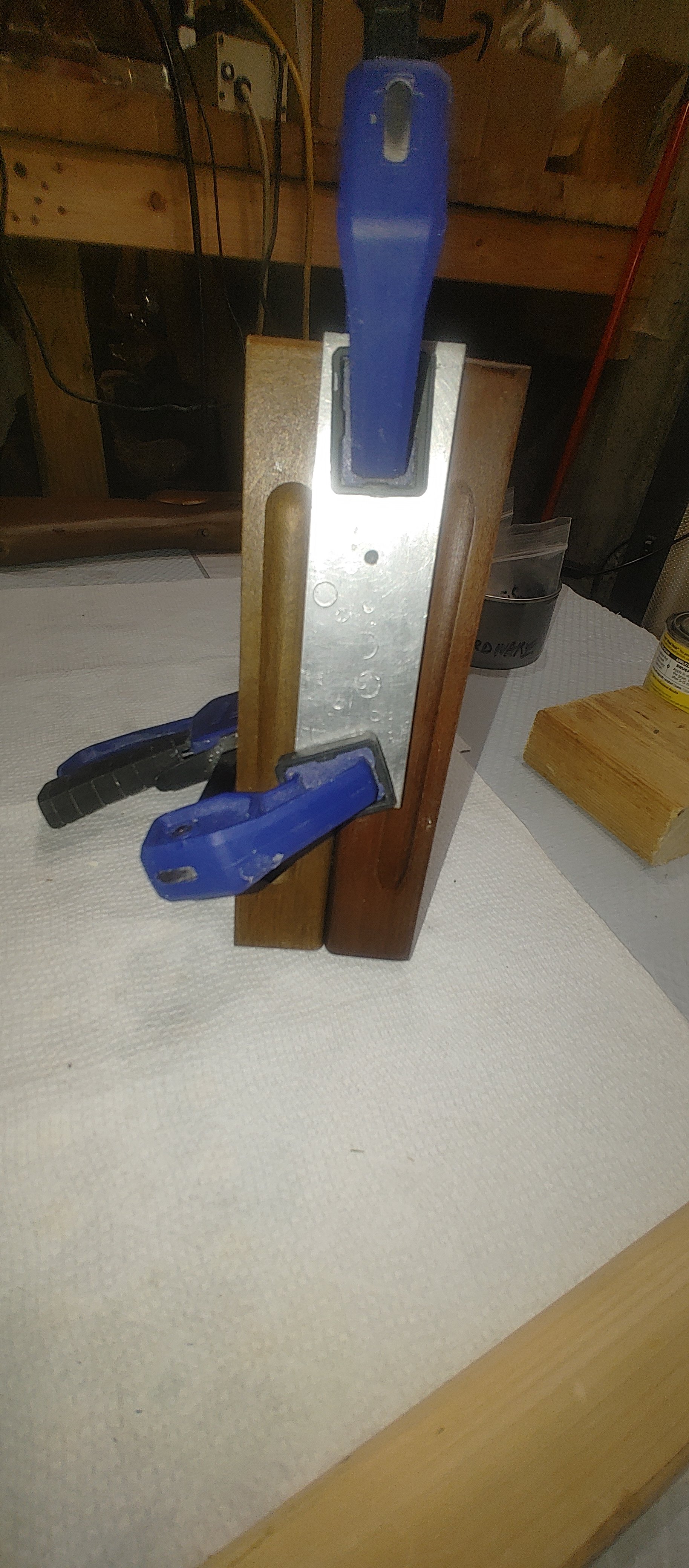

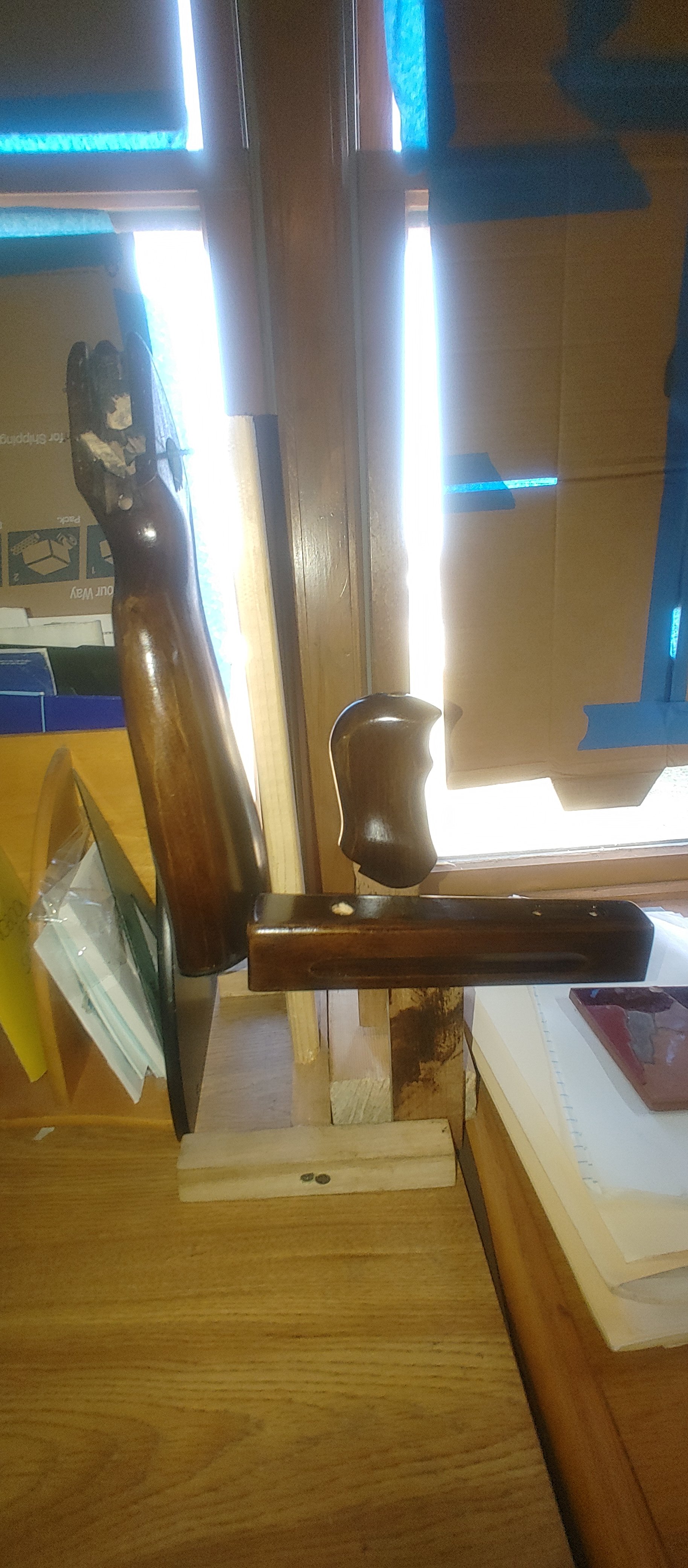

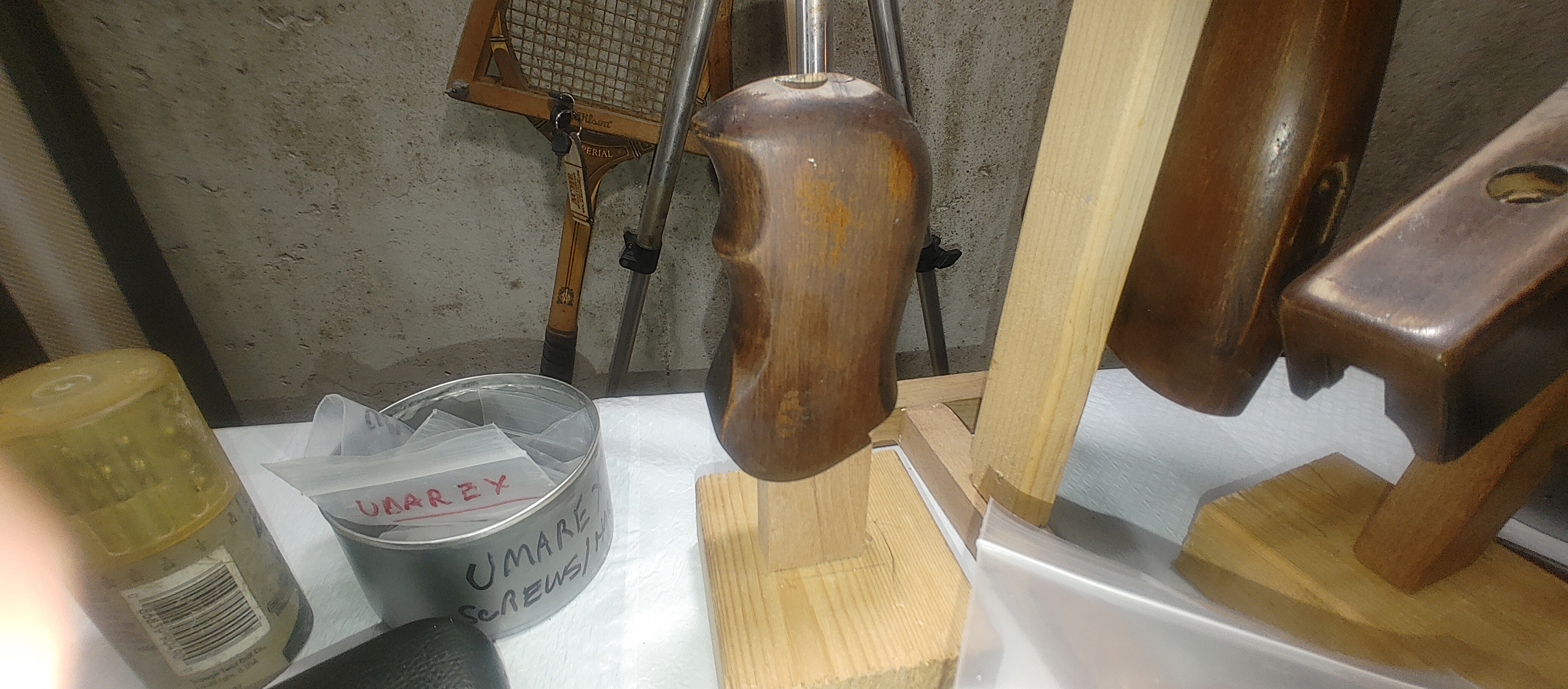

I already did last week. I have an issue (moving to a new video editor) so pictures for now. It took almost a week between stripping, stain, (wait 6-8 hours for drying between coats) and then the final Polyurethane (three coats, 6 hour between sanding/application); so yes, it took a week.
I made a stand for each piece, no touch and no drop. It was also the coldest week we had in awhile.

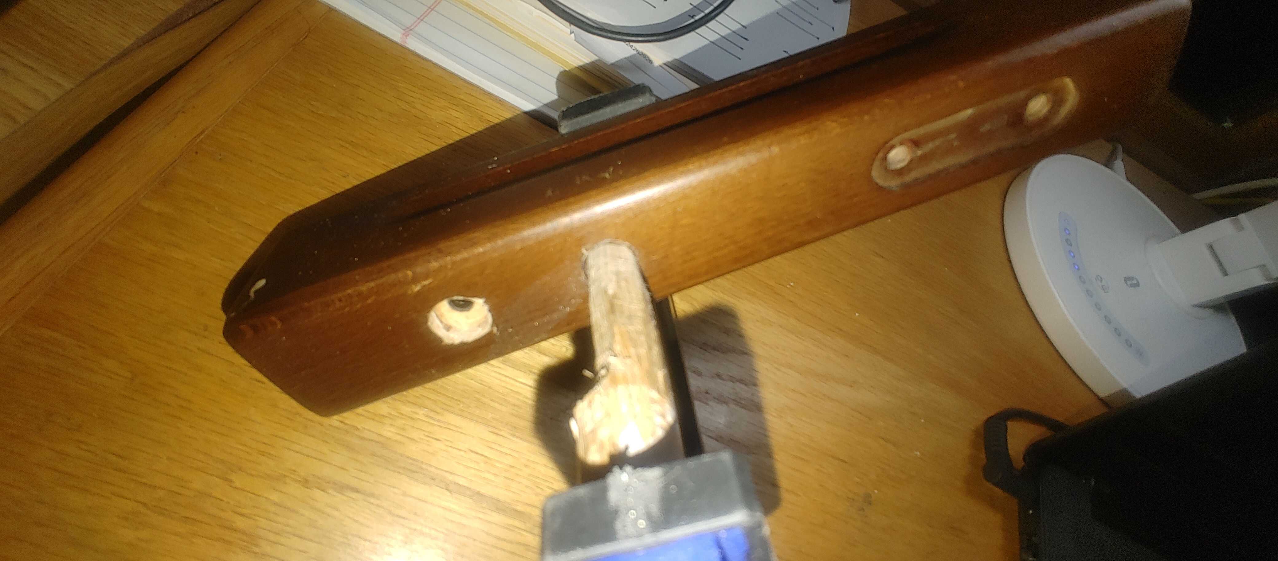

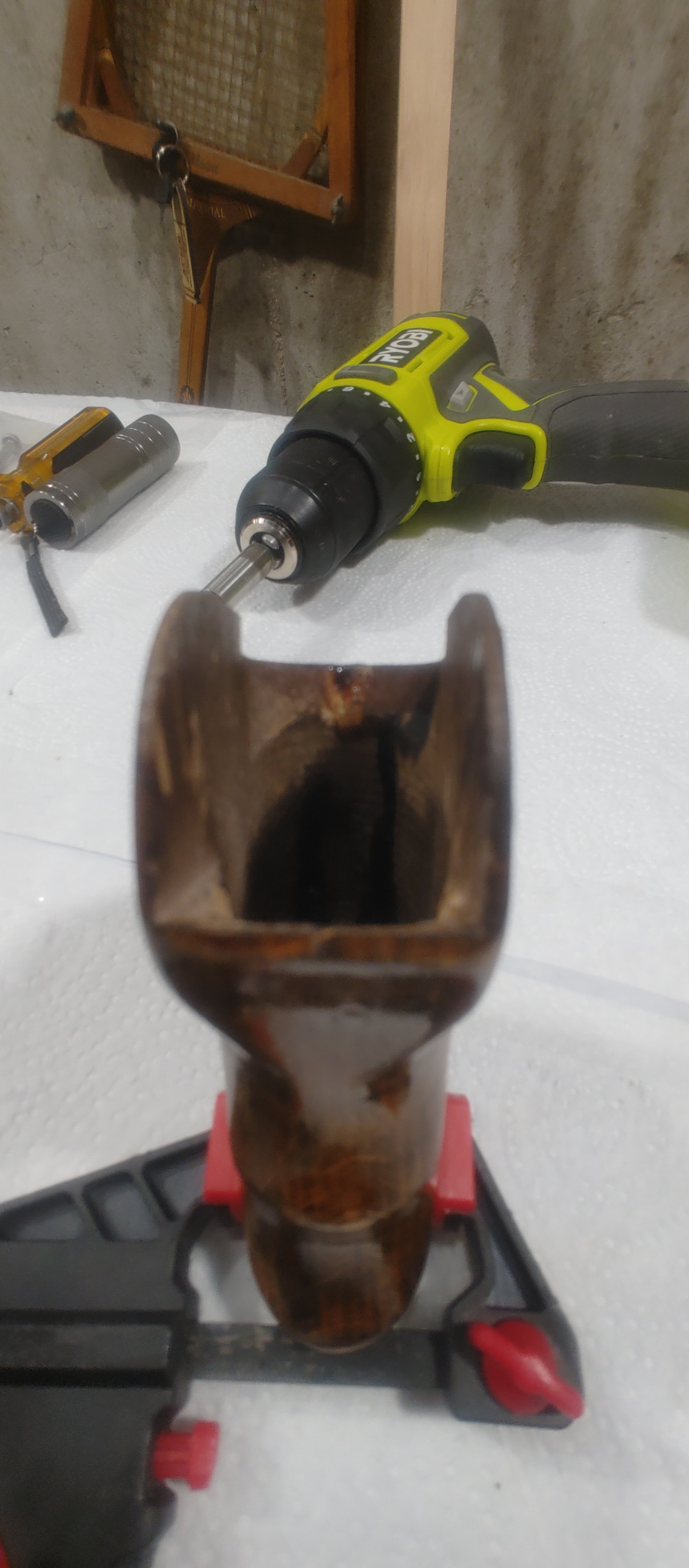

Now comes the the fitting for pistol grip or what some refer to as the "rear grip'.
Again I will pictures pictures to show my work.

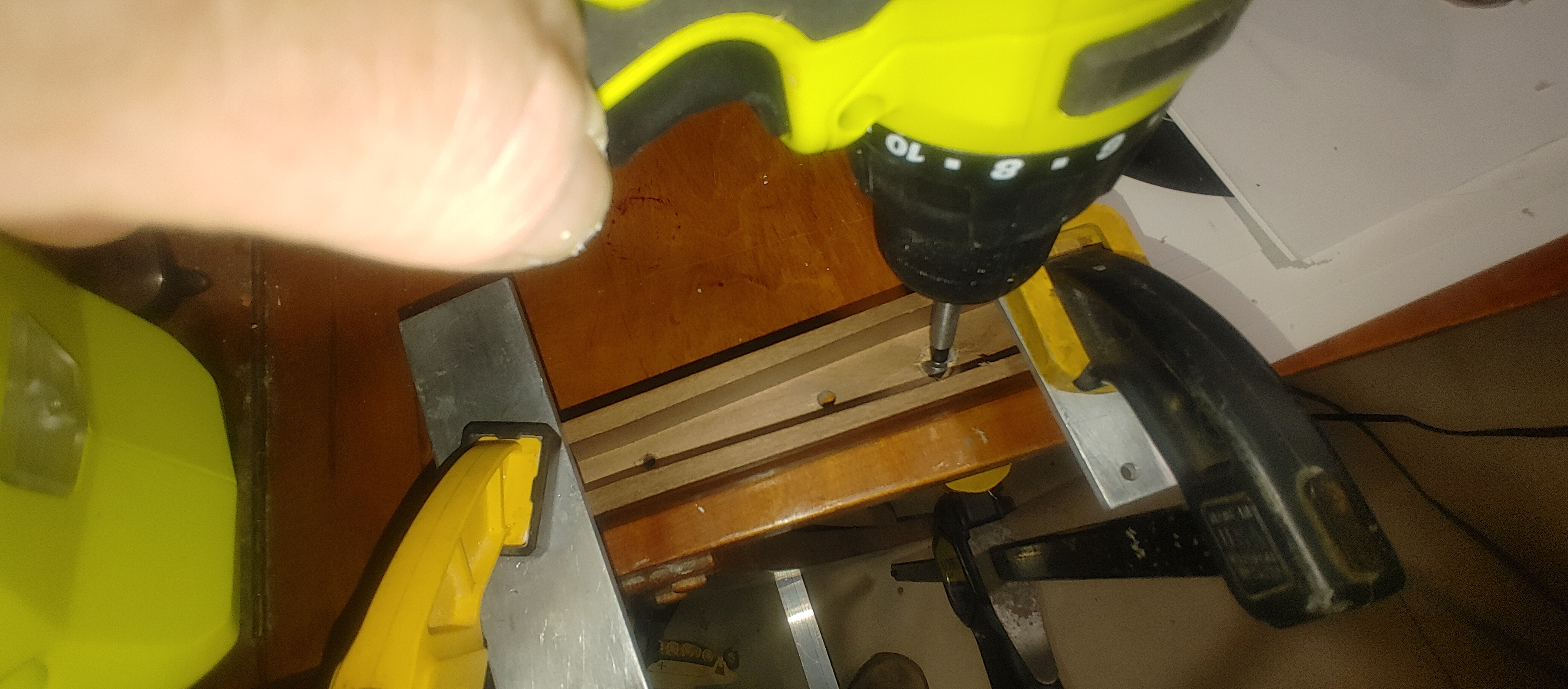

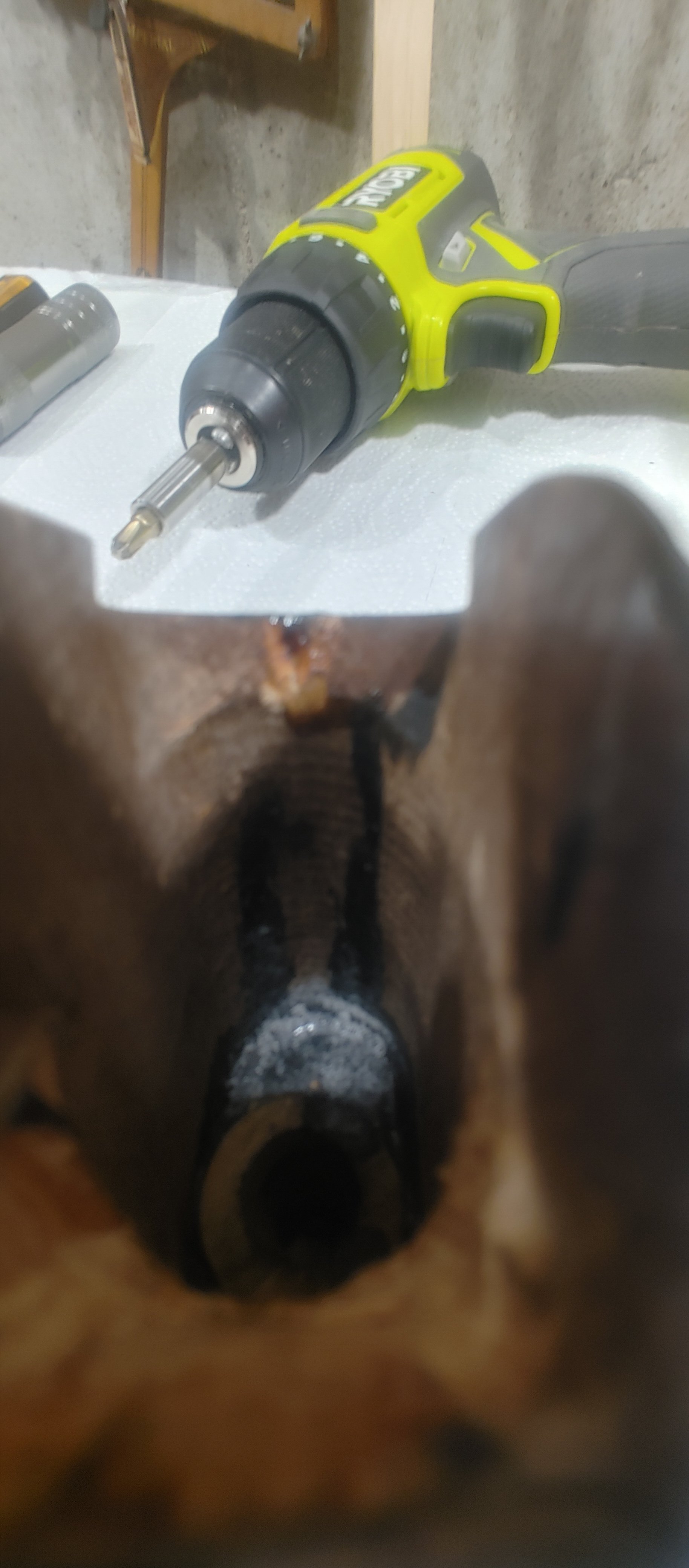

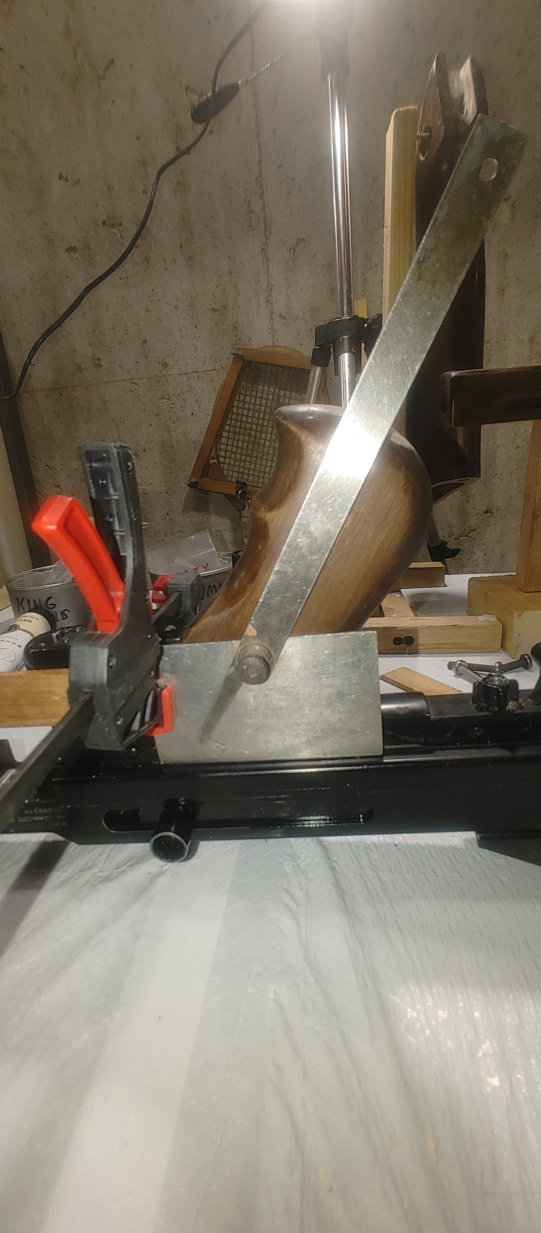

This one presented me with the most challenges; the main challenges are:
1) the sizing of the inside of the grip.
2) the angle and depth of the bolt hole. Both the King Arms and the UMAREX BB gun on the inside of the grip are situated very differently. Specifically UMAREX's M1A1 has a very deep bolt hole in the bottom of the grip on the outside of the grip. I can only assume the the Airsoft gun doesn't.
That means the the bolt has to be longer to reach the bolt threaded hole in the UMAREX BB gun. Secondly some removal of inside wood on the pistol grip needed to be removed as the grip did not fit. Removing the front inside wood was easy as chillising and filing did the trick. When that was finished I used some wood filler putty to make an exact fit.
The hard part came with after filling (wood plug) the original hole then planning to droll a new hole 'WITH THE CORRECT ANGLE". The pictures will show how I did it.
I was surprised to find that the bottom and sides, especially the side,s were quite thin, I used a 3/4 inch wooden rod cut to
to the specific length to cover the distance to the threaded hole in the grip. If this is not done the bolt will apply pressure on the thin bottom of the pistol grip; cracking the grip on the top, sides or bottom or all three. The counter sunk bolt hole has to match the angle of the threaded bolt hole. I measured the angle and drilled. It fit.
I was not happy with gust a small wooden doll at the bottom it needed more renforcement on the bottom. So I filled the empty space at the bottom of the outside of the wooden peg with a hard plastic resin. So the metal part of the UMAREX thread post has all pressure on the wooden dowel \, that is why it needs a longer M6-1.00 bolt.

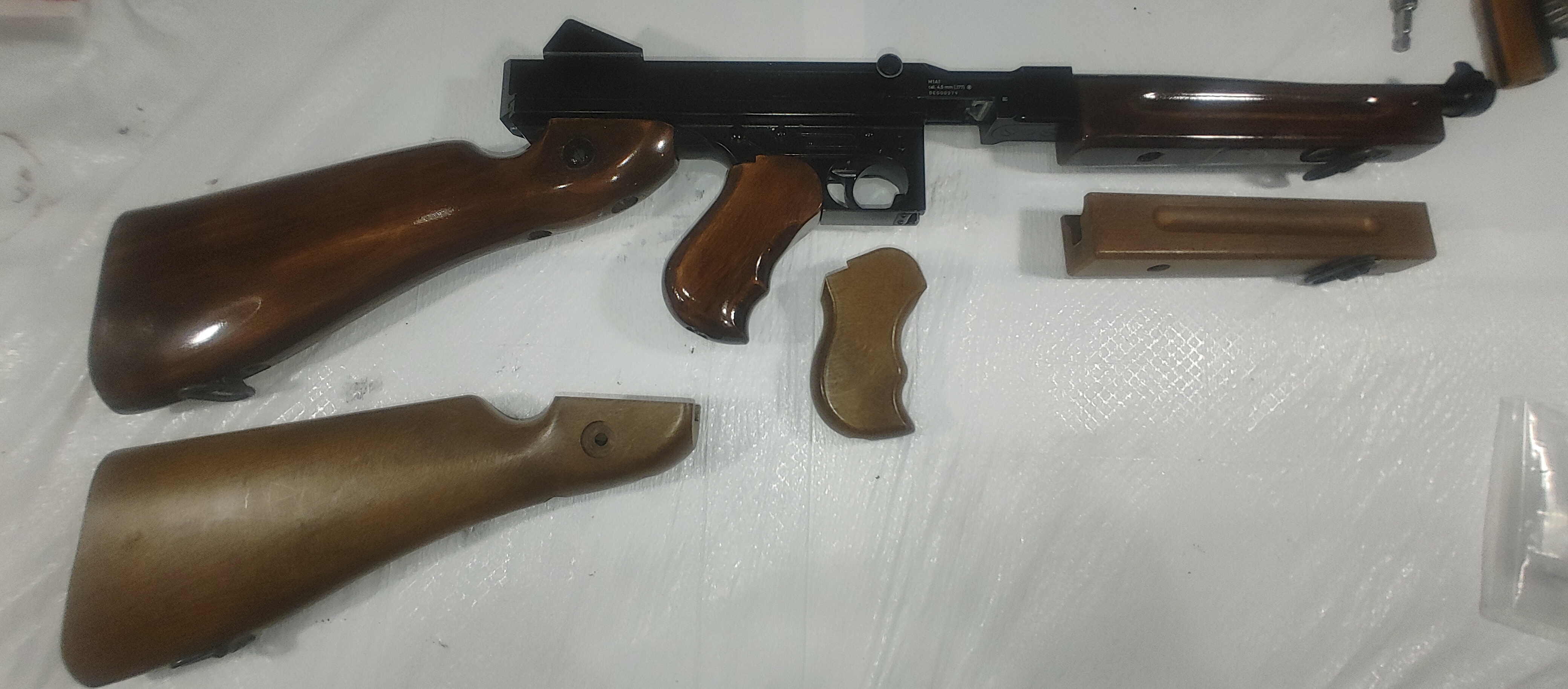

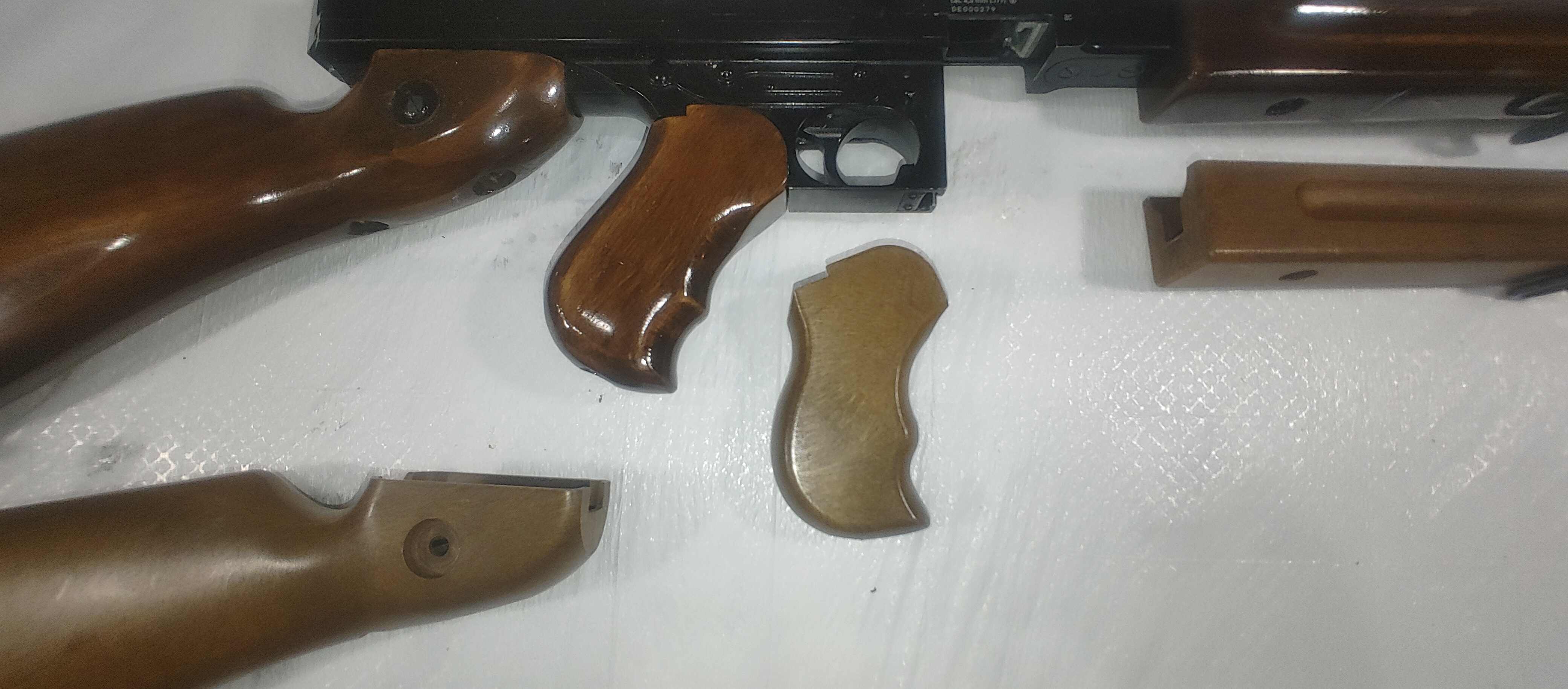

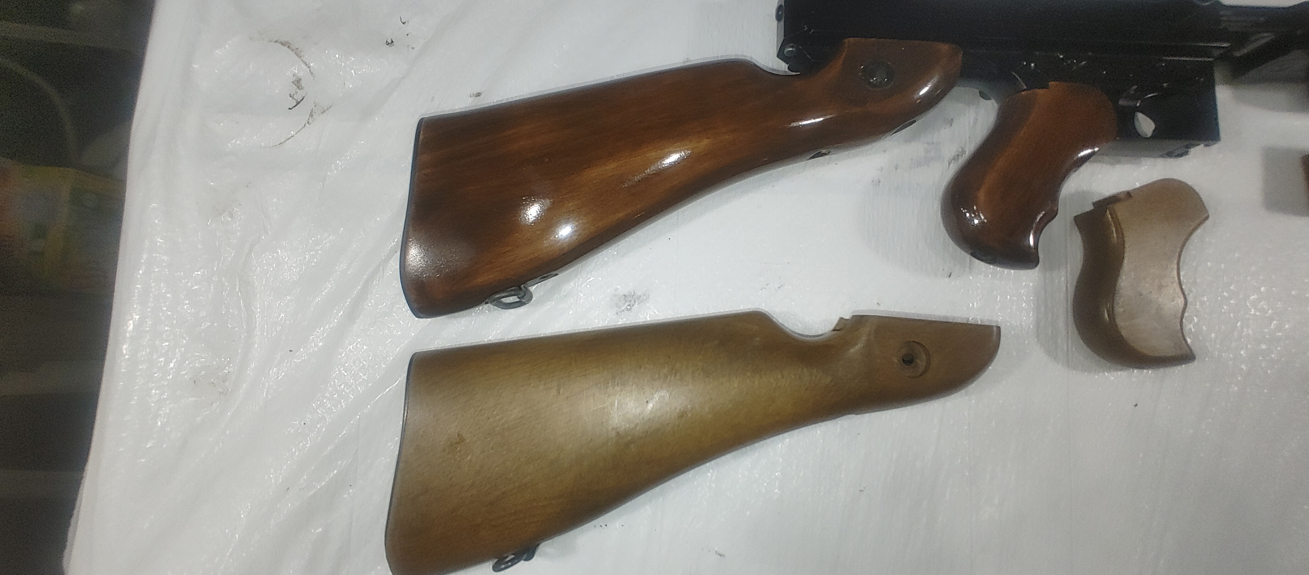

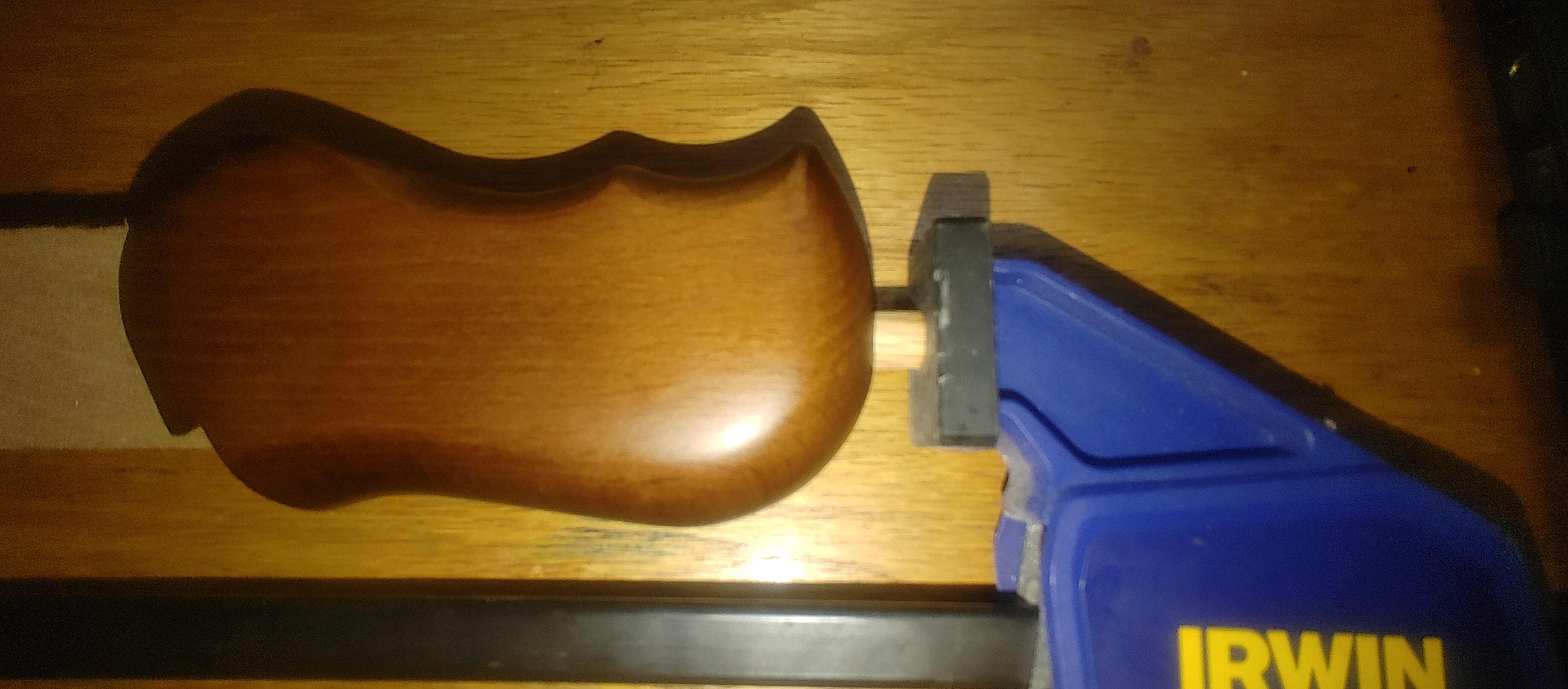

DONE! UMAREX M1A1 Thompson Wood Furniture By king Arms, fitted and Stained!
It has been a little bit of a challenge; it turns out the hard part was the staining, that is because I did not have much experience with staining. I have pictures below of the Umarex M1A1 Thompson with the UMAREX plasticware furniture below as a comparison. The hardest part was the pistol grip, the easiest were the fore grip and the stock.
I do want to remind anyone who cares that I did not alter the UMAREX gun at all. The plasticware is now in the UMAREX box with all of the original hardware (bolts, Trunnion and sling hardware). I can bring it back to factory original at any time I wish.
