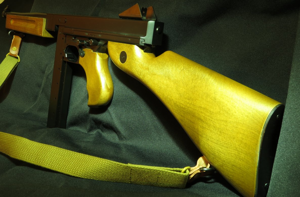

Modifying my Umarex M1A1 Thompson with wood (grips/stock) furniture
This is not really a "Repair" for the Umarex M1A1 however it is a "modification/upgrade' for the M1A1.
Ever since I have owned the Umarex M1A1, more than 4 years now. I have never liked the "thunk" noise that the hollow plastic grips and stock makes that handling the gun; really annoying.
So I have decided to buy a set of wood furniture (Stock & grips) for the Umarex M1A1 Co2 BB gun. I am sure that I will have to do some fitting but I am confident I can do that; the biggest problem was finding a seller which I eventually found and it is on the way now (arriving whenever).
My MP40 is good enough (authentic) as is the M3 grease gun (all metal anyway). But what can I say; I want wood stock and grips for my M1A1 "Walnut Brown"; call me a fanatic but I want wood grips so I do not have to listen to the plastic (thunking) noise that the adjustable Kerr Pattern Sling makes on the cheap plastic furniture!
I was thinking when I get the furniture would anyone like the see the fitting and final gun when I am done?

I have an update on my M1A1 Modification/Upgrade project,
"Shipping notice", I will receive the M1A1 furniture (Wood Grips & Stock) tomorrow Jan 16th. Not bad, 8 days;, if it comes on time UPS, they are pretty good for delivery times. I will start out with a show and tell with my opinion about the product, general quality, color, fit and any other comments I have.
I received the wood furniture for the M1A1 Thompson this week as promised, some modification (fitting) is required, no surprise there so for now. The wood is very good and to my surprise it the correct stain (dark Walnut). I have not decided yet to restain and make it darker or not, I will have to wait and see after the modifications are complete. So far so good.
I do not know if it is a hardwood but is seems so. I do have some other projects to complete but it should not be too long, maybe a week or so.
At that time I will be working on the modifications on the M1A1 project and I will post videos of the work.
On another note the kit did not come with the metal sling hardware for the Kerr sling; I contacted the company and they supplied me with a parts diagram so I could order the parts, (very nice of them). The Umarex hardware is not a correct fit.
I will NOT be modifying any metal parts on the gun, that would not be smart as I want to keep it stock to be able to restore the plastic furniture at any time in the future. After all the gun cost $240.00 dollars (plus tax and shipping). I will only modify the wood parts to fit. I will, when I get the time, send pictures/videos of the wood grips and stocks.
So far only two people are interested in this project, perhaps that will change when the videos start to come out so for now happy shooting!
Almost done with M1A1 Wood stocks etc. Only thing left is the staining and poly coating. First coat done waiting for stain to dry (it takes 2 full days to dry) then the polyurethane so it looks like next week. It has been an interesting project.
