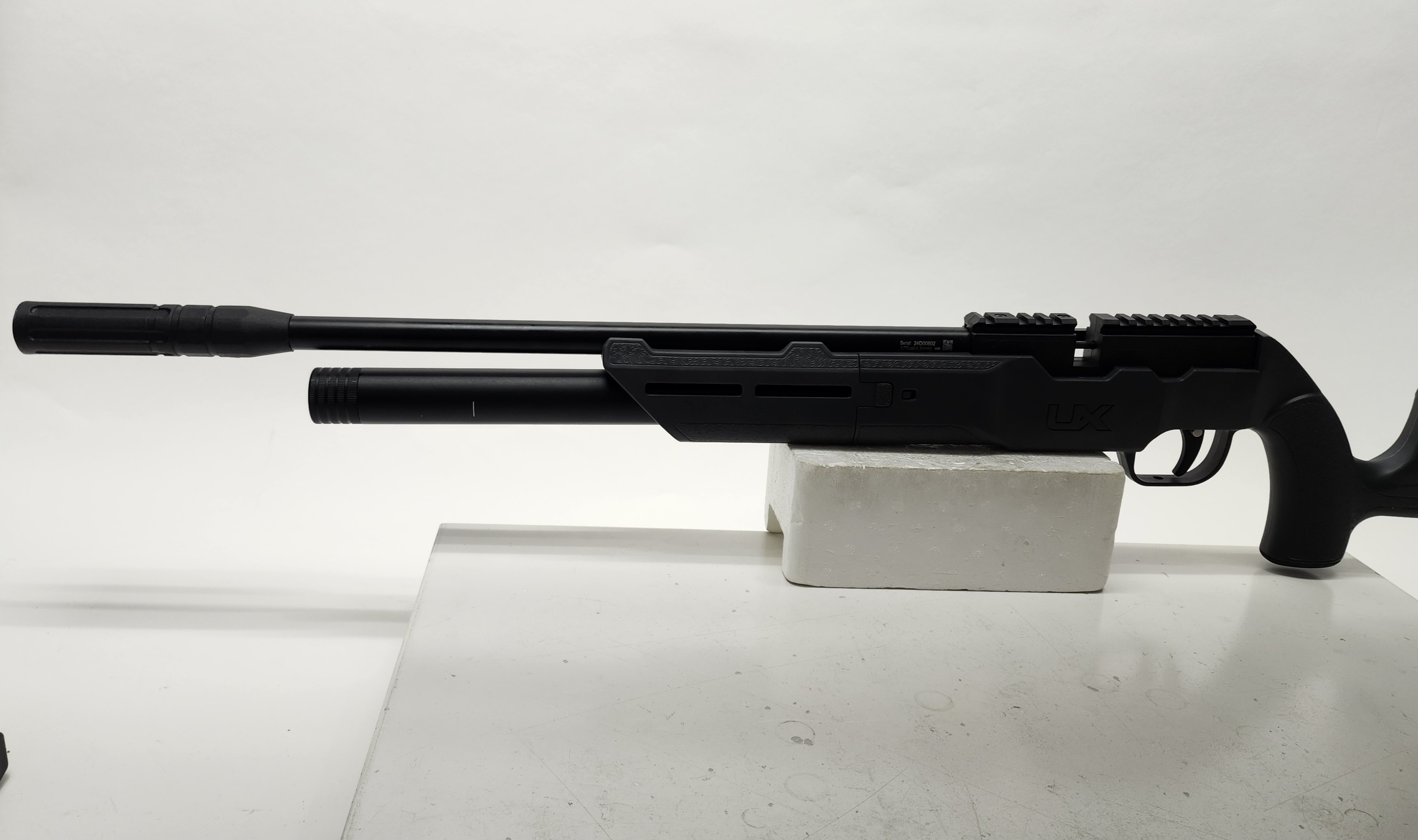

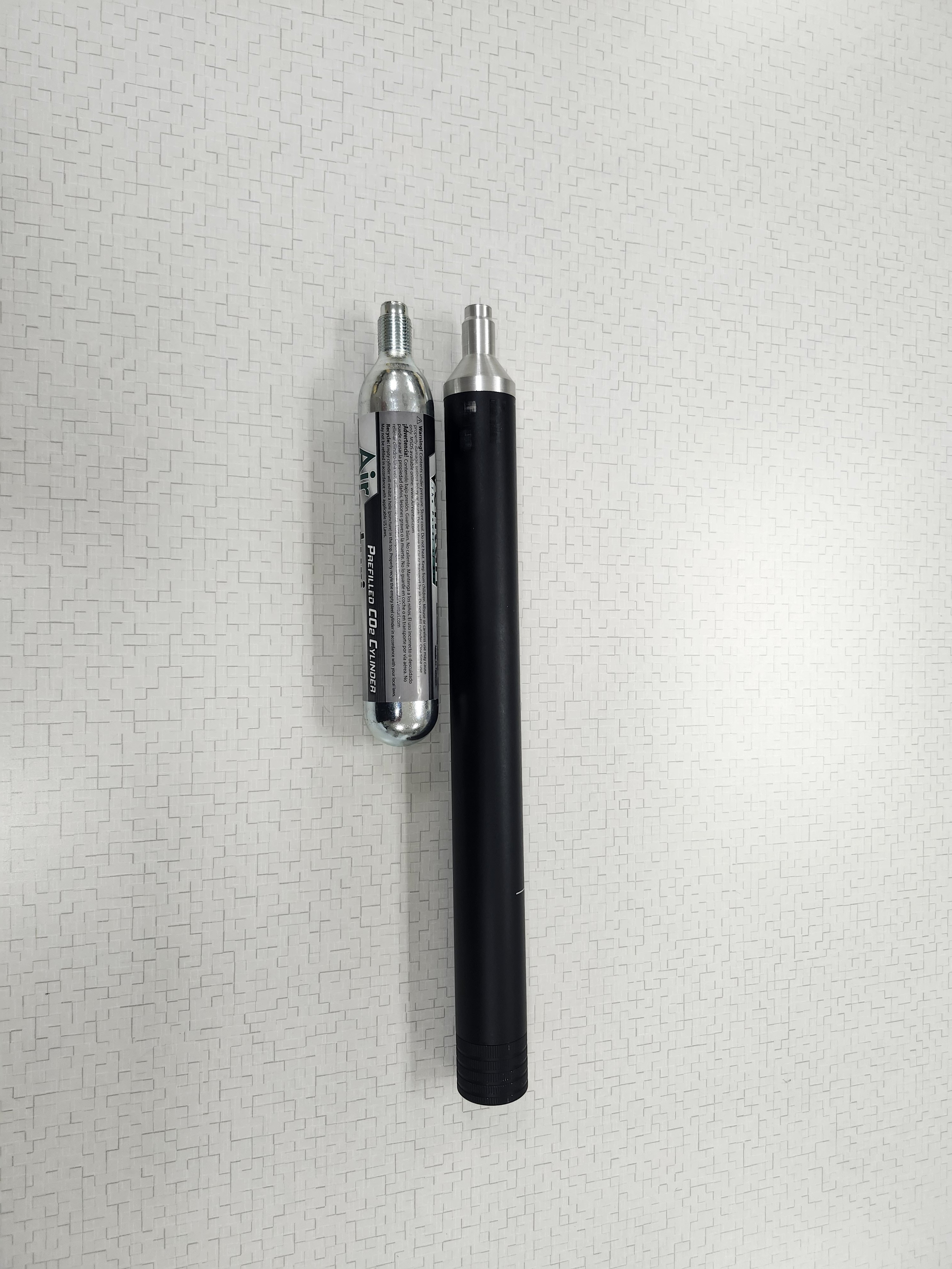

So I bought my own for a knock around camping gun that I didn't have to worry too much about and could carry an extra nitro bottle with no need for a ton of extra things needed. No tank, compressor, or handpump. Works great for that. I ended up liking it far more than just a camping gun. Since I was shooting it more and being so light my kids could use it easily I decided it needed a refillable tube. Last summer I converted it to PCP via an adapter and airtube from the Avenge-X. Shared that with AV/PA. I know it was slated for production and should be available soon through PA/AGD. Thought I'd share it here. I think the production run will be fully finished in black. Makes a great inexpensive regulated gun that you can actually do a lot with. The tube conversion last I heard should be in pretty soon. I'd keep an eye on the PA/AGD website if you already have one or if the idea of buying nitro cylinders is why you didn't already. They should be very affordable.
View attachment 552139View attachment 552140View attachment 552141

Possibly, I have that too. That isn't regulated so the fill pressure would have to stay at less than 1000psi which is still a little high since co2 is at roughly 800psi at a 72ish degrees.

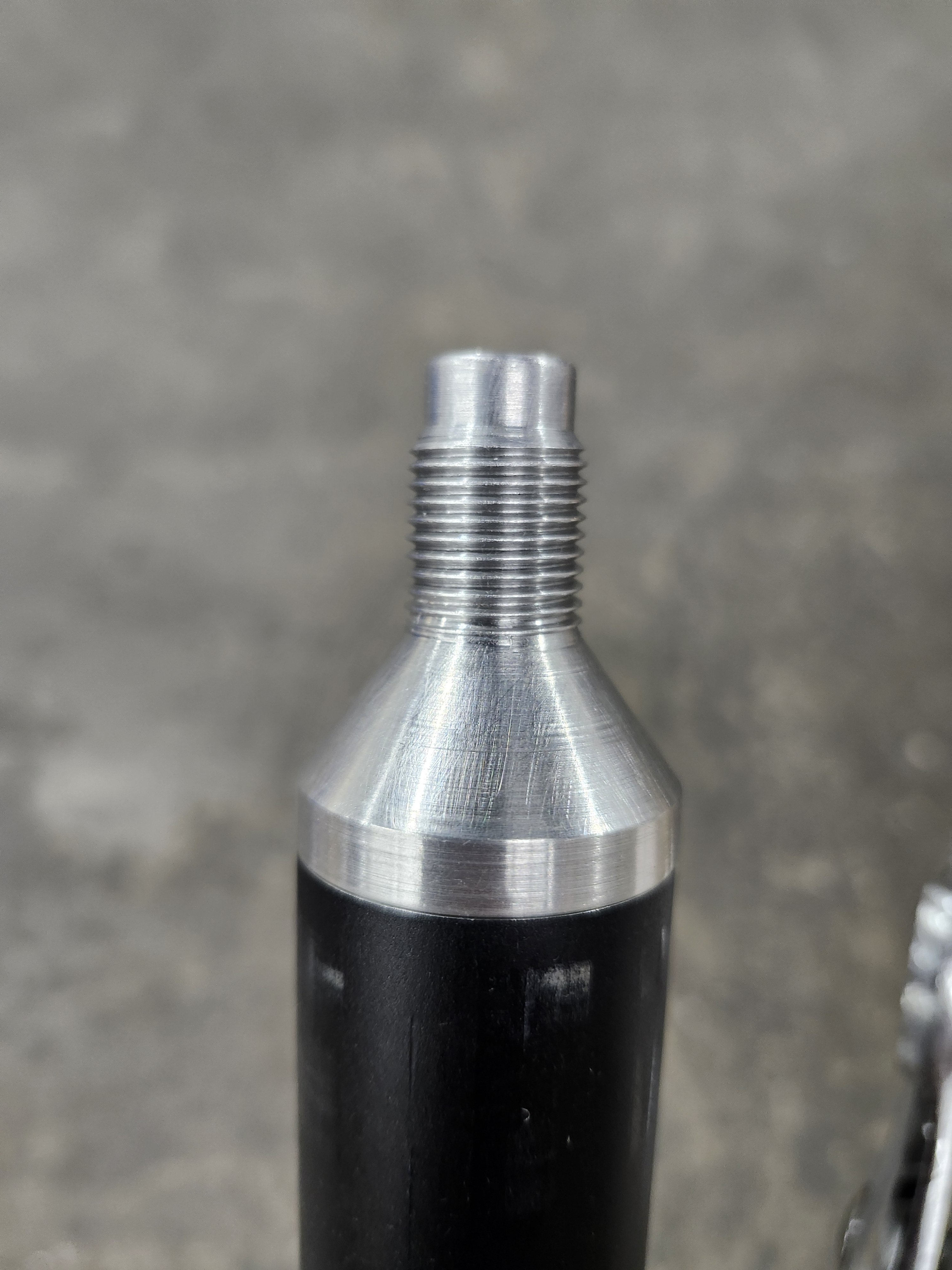

I fully understand. I expect these to be a little more user friendly. No probes. Foster fitting and endcap dust cover. More than double the volume and I'm guessing 1/2 to 3/4's the price. These simply screw on in place of the nitro bottle and stay. No modification. Tested beyond I think 7000psi. Unfortunately it wasn't a priority so just getting here. I built those probably a year ago or more.

They don't have a check valve. Can't be stored under pressure off the gun. You install, fill and leave attached just like most standard pcps.
