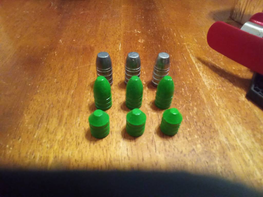

Looking for about 600fpe from a 320 to 375 grain bullet, no desire to fling the massive 550 grain stuff. Even the 450 grain stuff I cast is a little big, it just empties the lead pot fast. I have 4 different styles of mold to try, and two of those were only ordered last night so like 6 weeks out. Shown above is 320gr Lee REAL, 450gr Lee 50-70, and Umarex SLA 550gr. All sized to 0.510 inch. I'll probably tumble lube the Umarex rounds, only got those because I had nothing else to cast yet.

What is the green stuff on the slugs?
