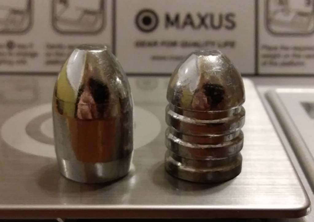

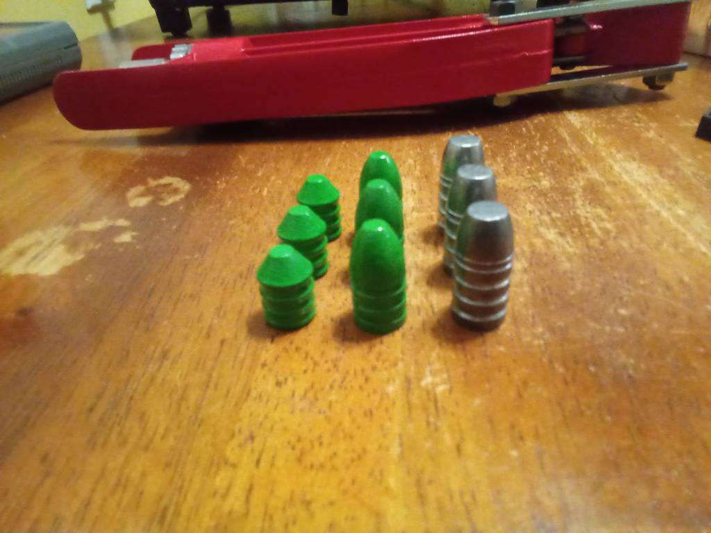

First image is the Accurate, 385 and 370 grains, next is the REAL and 50-70 shown with an Umarex 550 grain purchased round. That Accurate Molds is really nice, I'll do business with them again!
