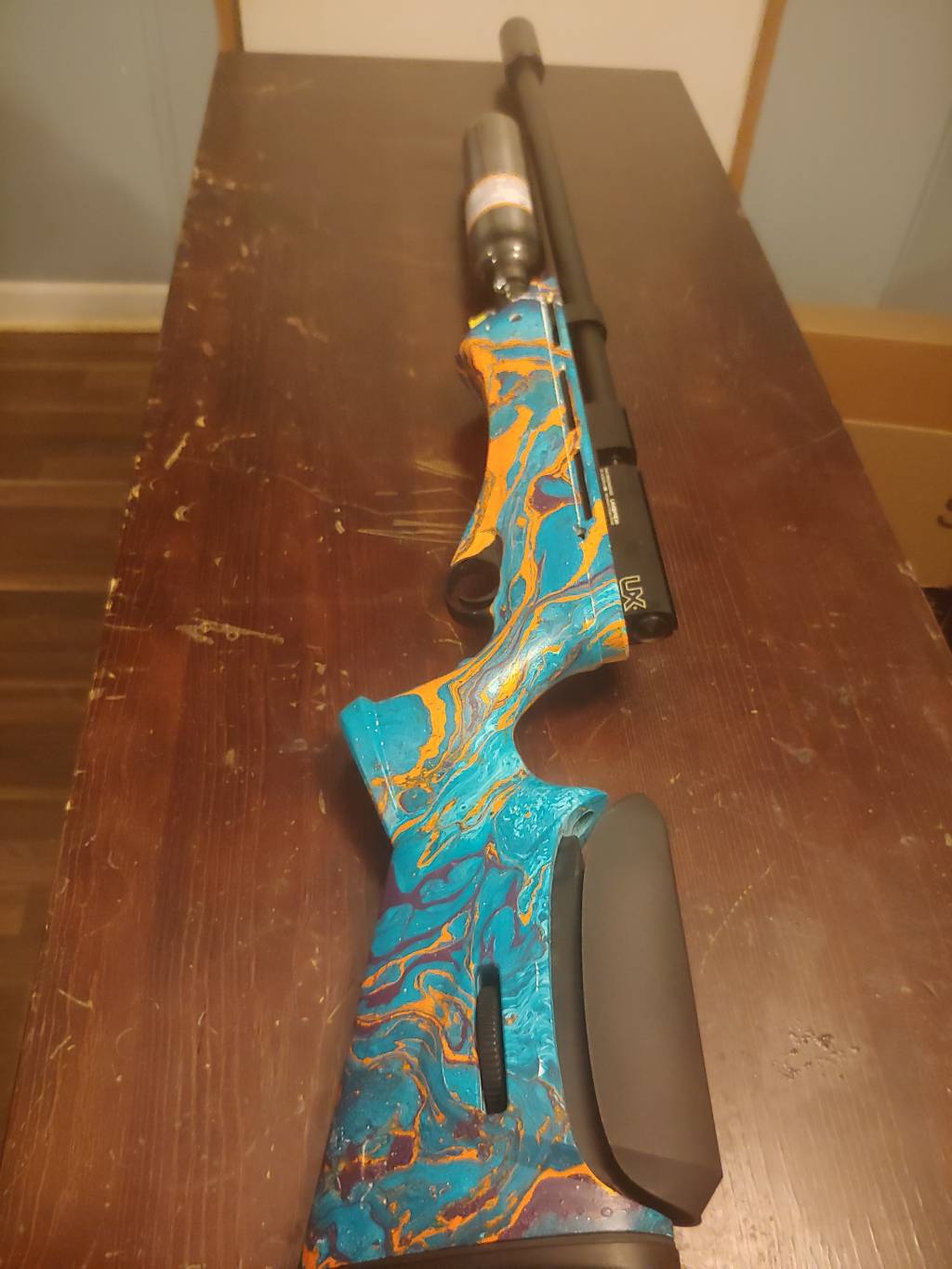

I now have the ninja adjustable reg on mine and it works great. You could also get a cheapo reg off ebay set at whatever pressure you want which I did first with my 25 cal with a 2200 reg that worked just fine and was consistent too. I ended up getting the short shroud with a metal stripper and thats it. Ended up taking the donny off because it was just too long for me. It is loud in this setup but doesnt bother me(I can shoot .308 ak off my back porch). It is a good gun for the money and fun to mod. 500cc 4500ps
ii bottle really gets the shot count up and weighs about the same as the tiny stock bottle
